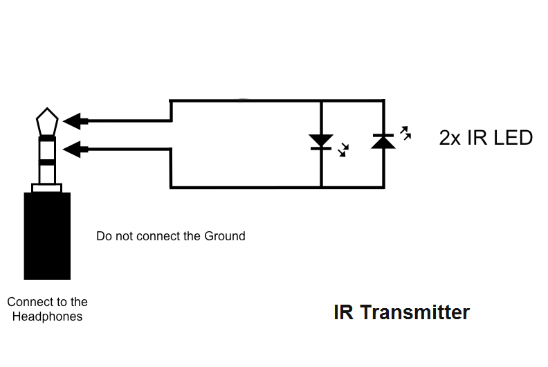

                    #129
                    Re: Just picked up a 55 inch LG 4k OLED for $50!
                    This is why you have to search for the service menu entrance mode, it don't want to prevent tinkerer to use it but the normal user, a tinkerer have knowledge to repair it..(hope)
                    The normal method to enter it is to use service remote, you can't have it, so start searching a wav file that reproduces the entering key...(i already said..)

                          #132
                          freak i've said earlier in the posts, search back, play wav file with a led on the jack..
                          i've also already said that is better to search well for all the possible eeproms i don't think the main eeprom is not powered
                          in standby, a typical funcion of it is to store the previous state of the tv when mains have been unplugged.

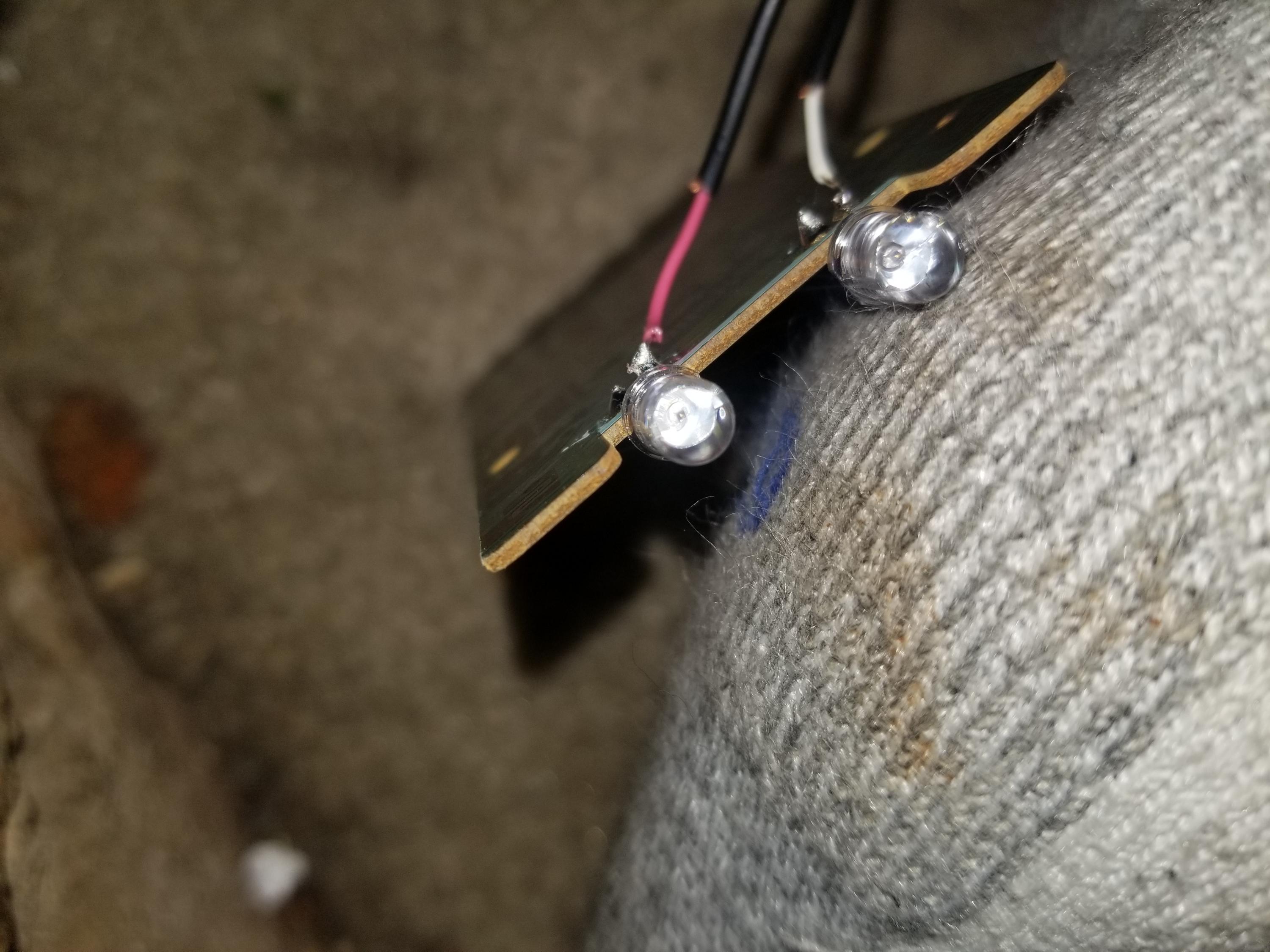

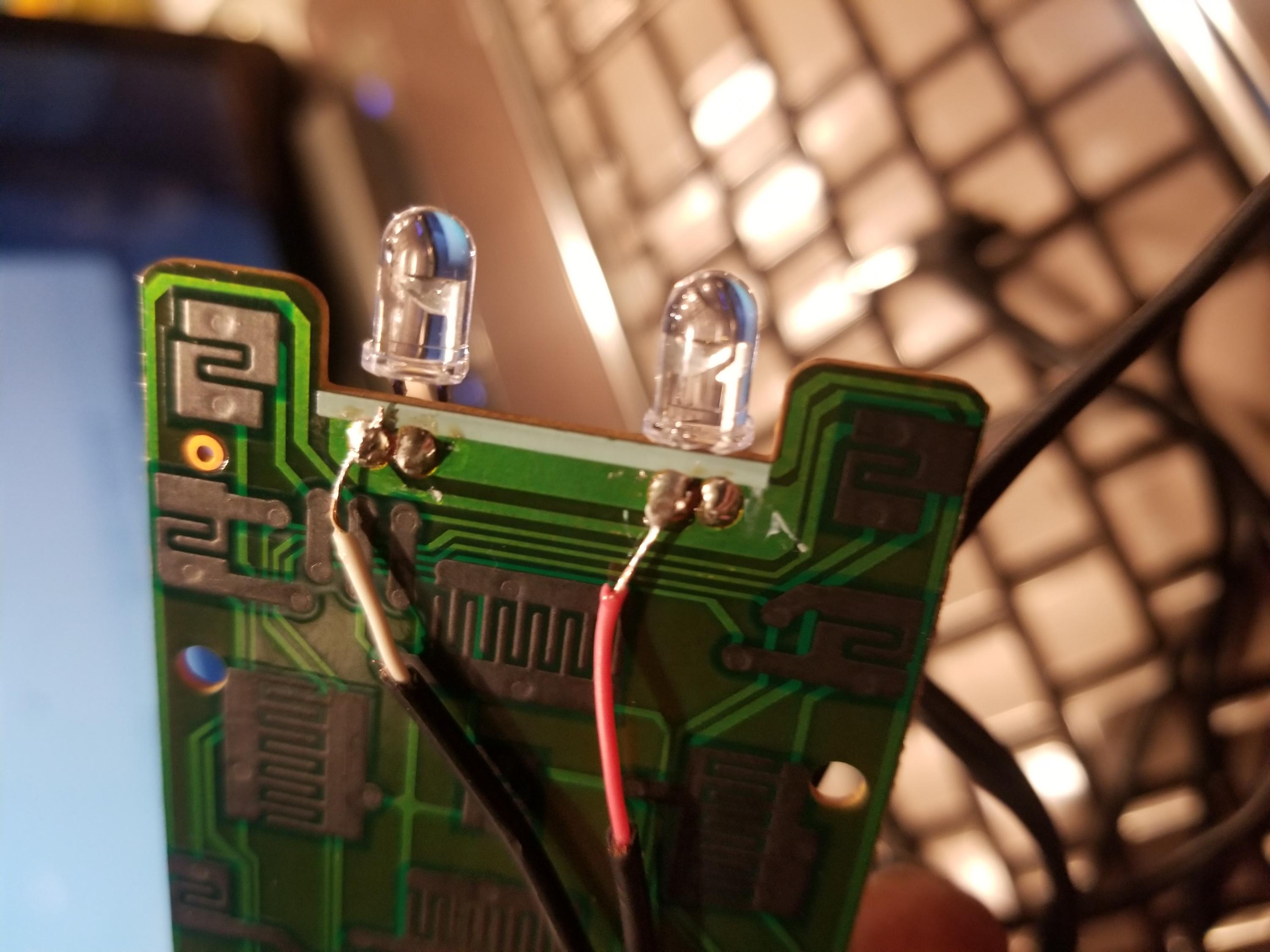

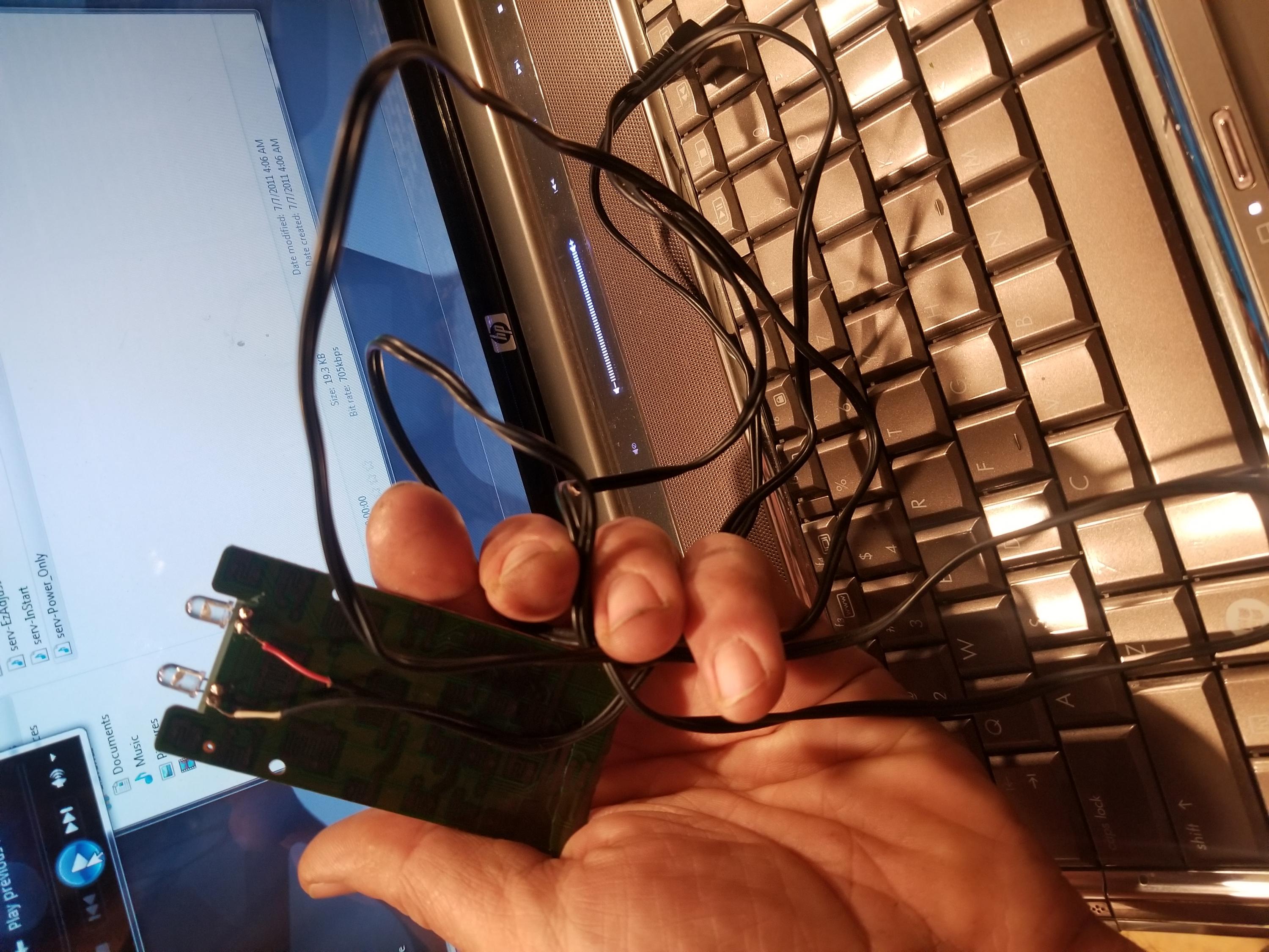

                                #135
                                Well tried the wav file trick. Honestly with this set up in the volume pushed to Max on my laptop I can see the infrared working through my camera but honestly it's not very bright.
                                Needless to say it doesn't work. It was a good try though

                                  #136
                                  Can you please link me the page for the service entering that you used? Why 2 IR? I have seen with only one in the past.. however your schematic is different from your execution (watch the terminals inside the bulbs, them are paraleled not antiparalleled).
