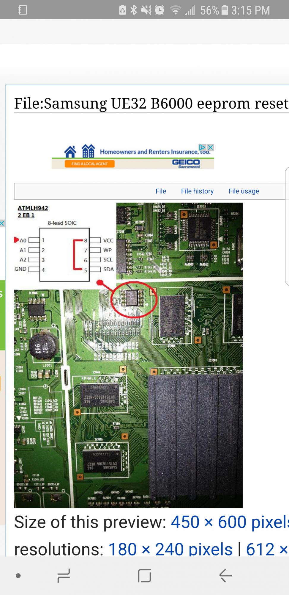

    Re: Just picked up a 55 inch LG 4k OLED for $50!
    The ATML eeprom is on this board. This looks promising except I'm not getting VCC so this would essentially be pointless. Obviously it's not reading eeprom.
    Courtesy of Samygo

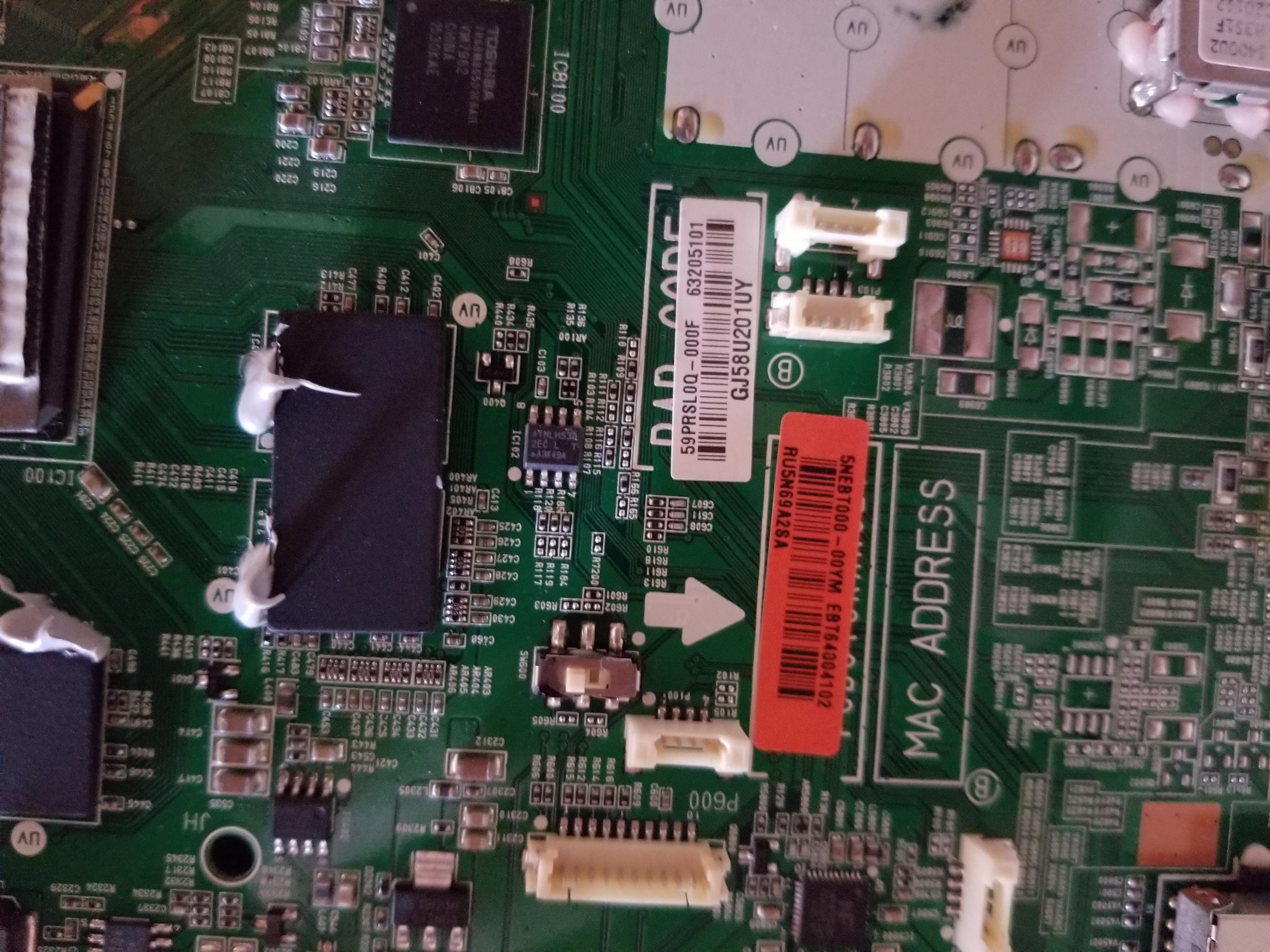

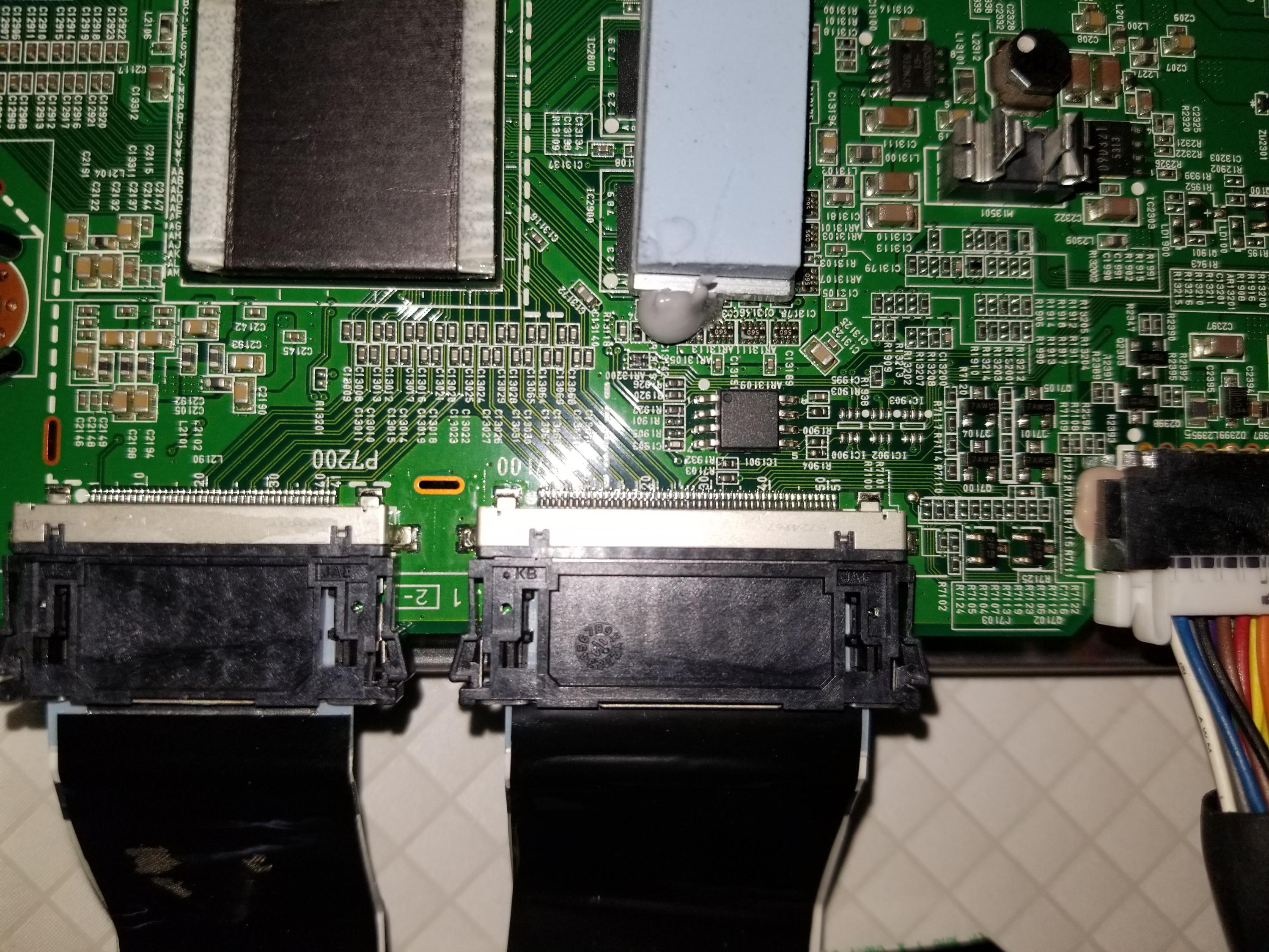

                  #68

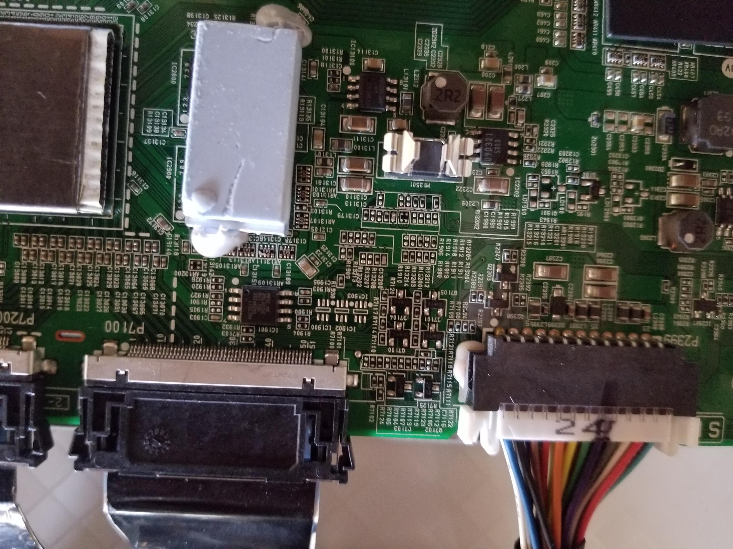

                  OK here are some pictures of the main board with the heat sync removed.
                  • freakaftr8
                    • Oct 2012
                    • 3743
                    #69
                    IC402 seems to be eeprom. IC9101 is serial data possibly? Anyway none of these are getting VCC

                      #70
                      I don't see well the marking on the chips, you make faster if you transcript here all the markings on the 8 pins ics, even that shrinked types..

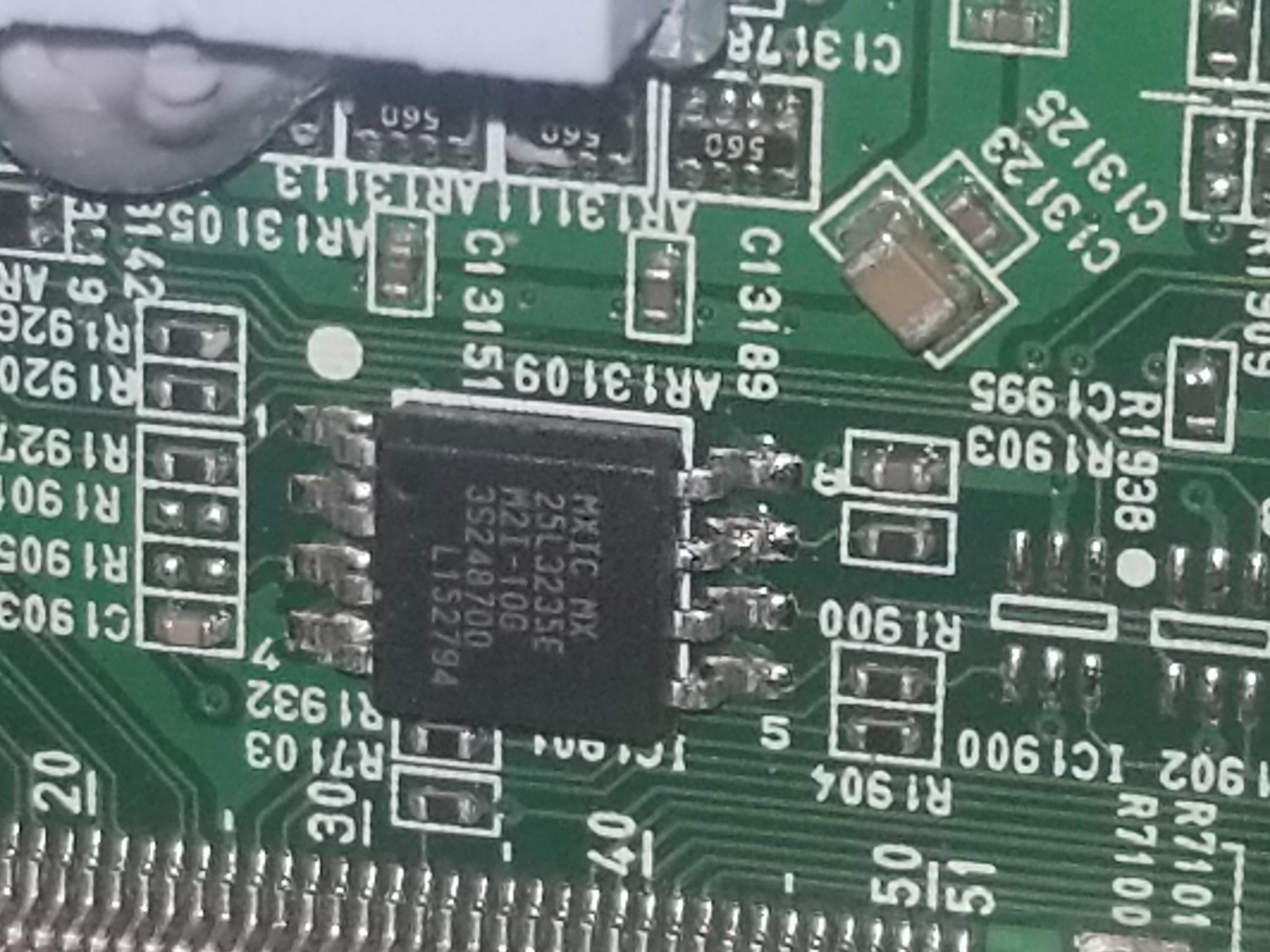

                        #71
                        These two.

                          #72
                          ATML is a eeprom, 25L33 is a flash, are there any other? Have you tested any pins of the flash for the vcc? Is the vcc pin of it connected to a fuse?
                          • freakaftr8

                            #73
                            Yes i cjecked vcc ot both. And I haven't seen any fuses.

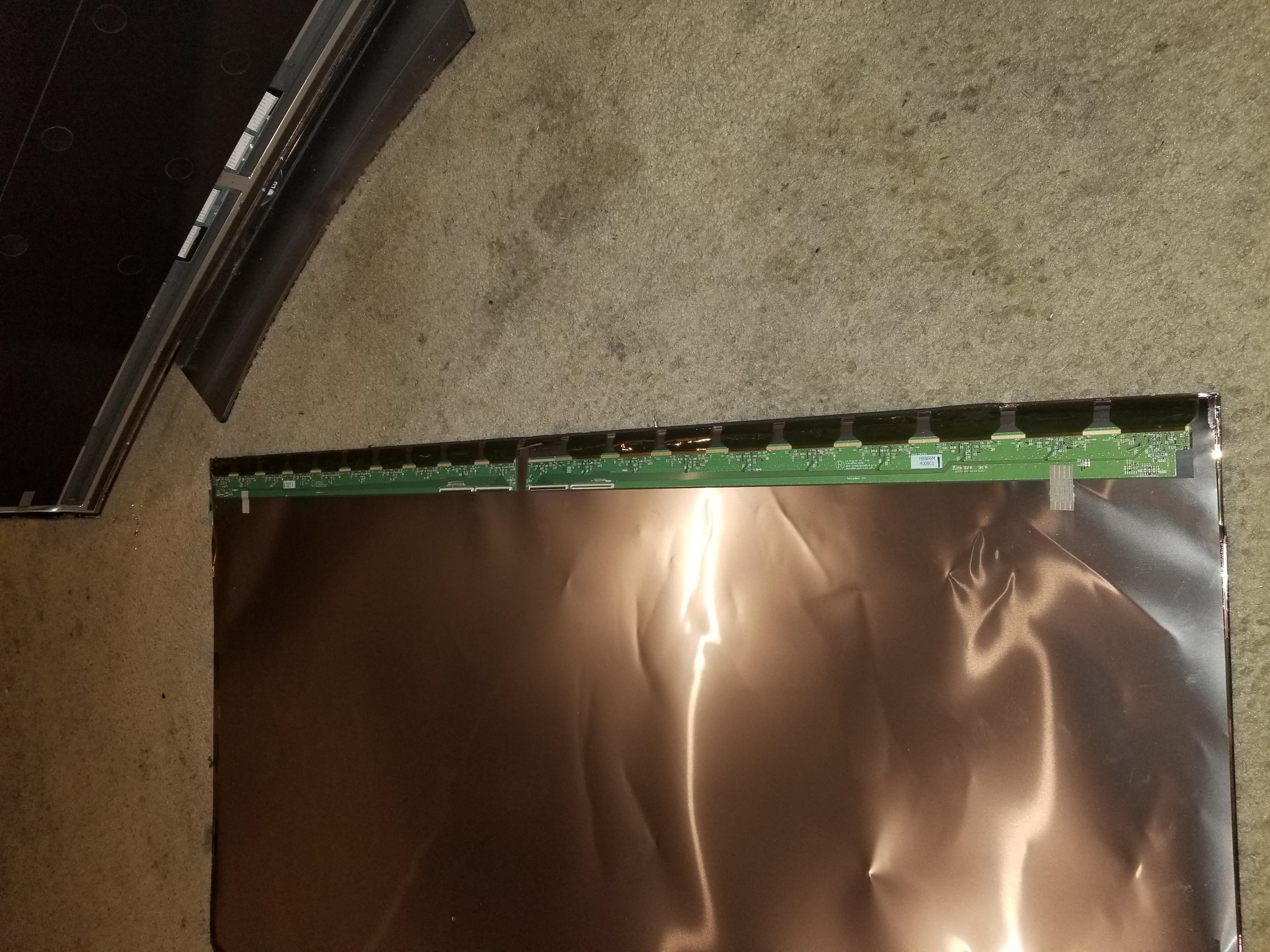

                              #74
                              The other guy settled on 60 bucks. He is bringing the broken OLED to my house right now.
                              So maybe if I figured this one out I can somehow get the other panel figured out somewhat, And in turn Put the guts from his TV on to the other panel that I removed from mine..
                              In turn I'm going to strip the cracked busted panel out of that one and take plenty of pictures of the ribbon drivers and Chip on film and driver boards that run the OLED panel since its rubbish anyway.

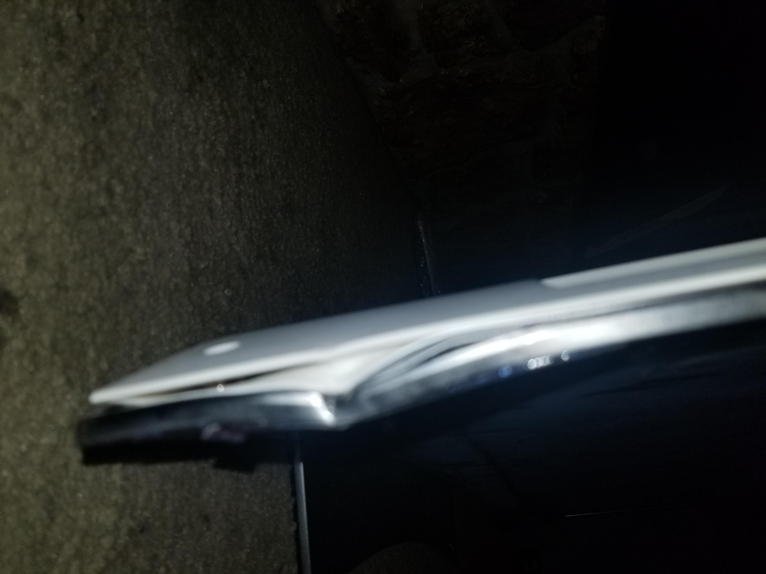

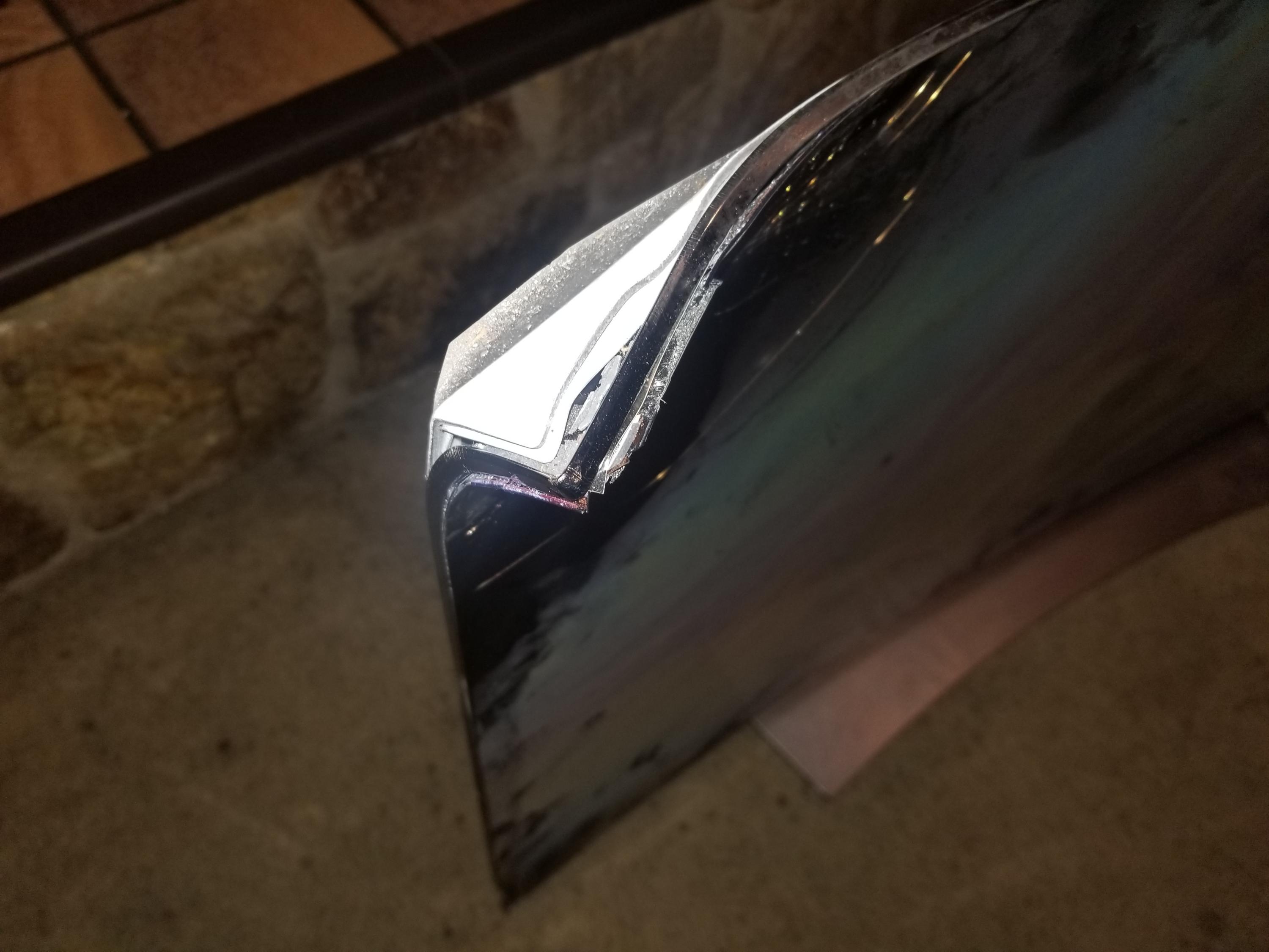

                                #75
                                Got the damaged one. Can somebody say oopsie. Shipping damage?

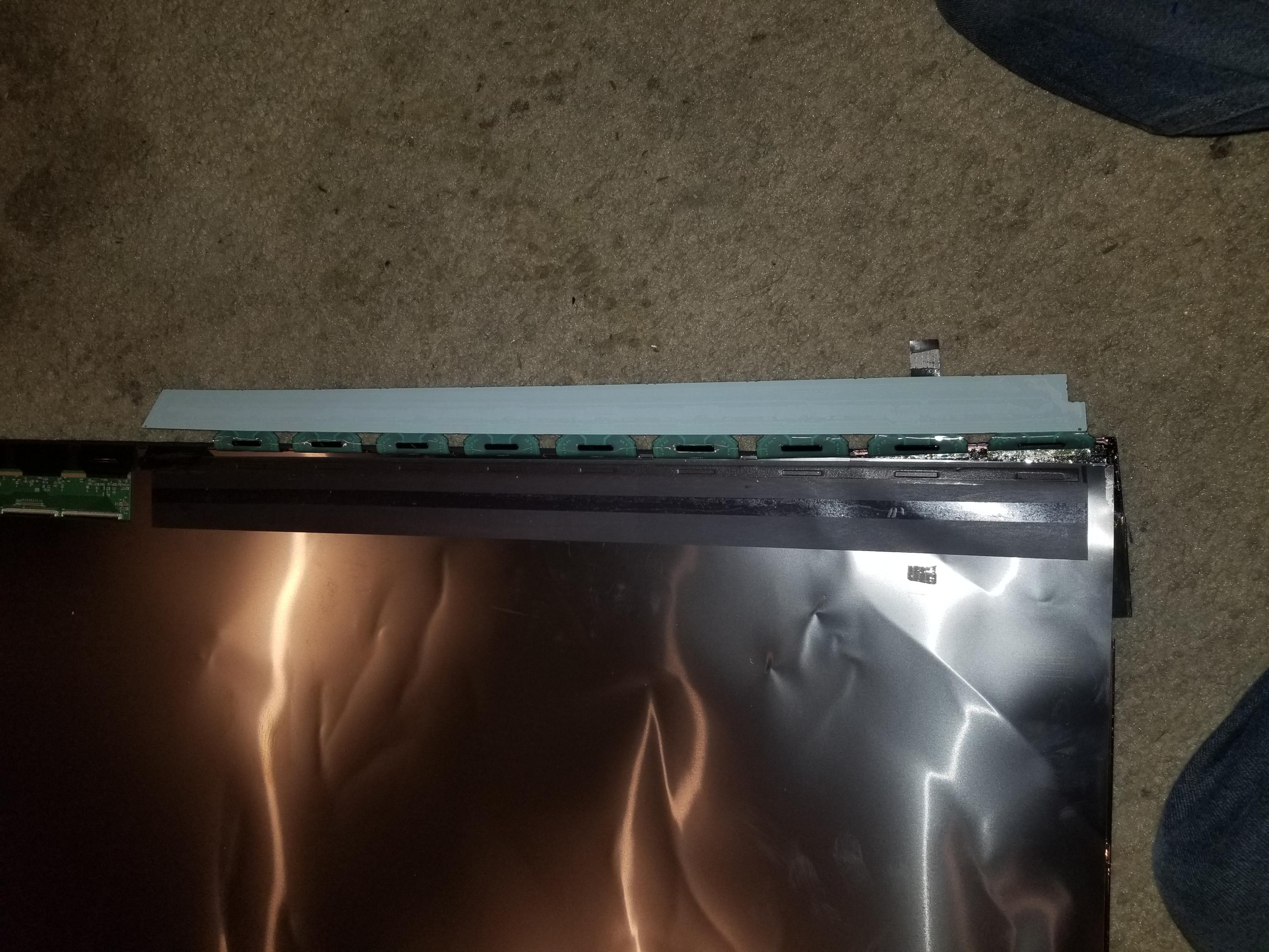

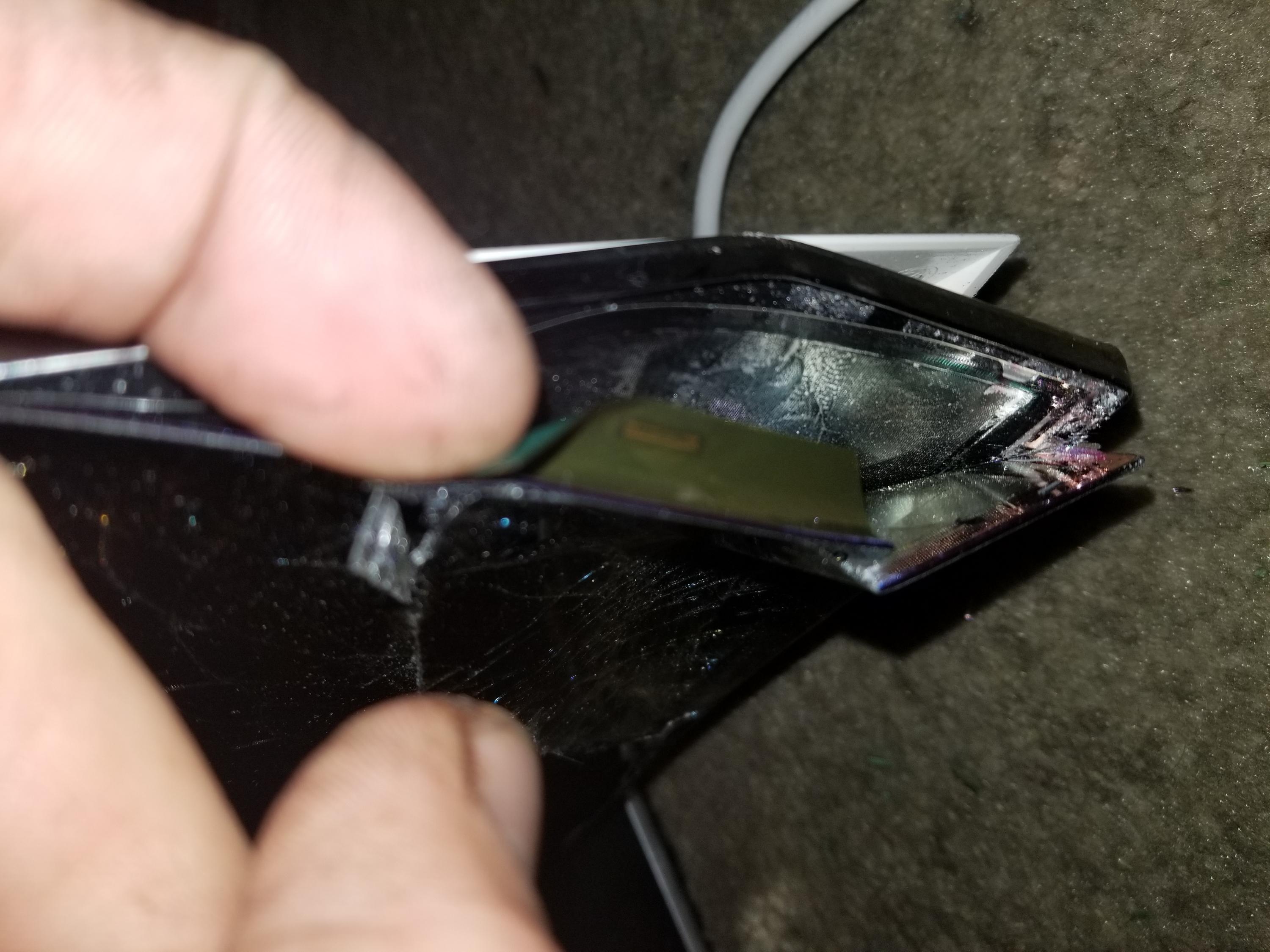

                                  #76
                                  Yes folks, it does have side gate drivers.
                                  • freakaftr8
                                    • Oct 2012
                                    • 3743
                                    #77
                                    And here you have it! A look at the workings of an OLED panel.
                                    Strikingly similar to LCD except the organic compound on the back side of the panel. Mated to the LCD.
                                    • freakaftr8
                                      • Oct 2012
                                      • 3743
                                      #78
                                      The panel is for certain not designed to remove If you have to access the driver boards. It will crack. Believe it or not the whole thing is held in by double sided sticky tape in 8 areas.
                                      I found the LCD layer to be extremely fragile like typical LCD's but the organic LED or OLED layer behind the LCD was super flexible

                                        #79
                                        It's a TFT layer...not quite the same as an LCD.
                                        Interesting that the ELVDD power passes through the source drivers, and disappointing... is that the only supply path for ELVDD? (The 24V supply from the PSU, which supplies the current for the OLED pixels).
                                        Also interesting that the pin-out of the drivers is similar to PDP address drivers, something LG would have had experience with. Unlike normal source drivers, there's a high-power path for OLED current. I was hoping that it would be supplied directly to the panel via a pair of dedicated pads.
                                          #80
                                          IC8100 is your eMMC device which holds the TV's operating system. It's a Toshiba part so bets would be that it's failed. They were notoriously unreliable after few erase/write cycles when used by my former employer.
                                          IC1901 is probably for the FRC controller, which is some kind of advanced DSP. May also be a problem.
