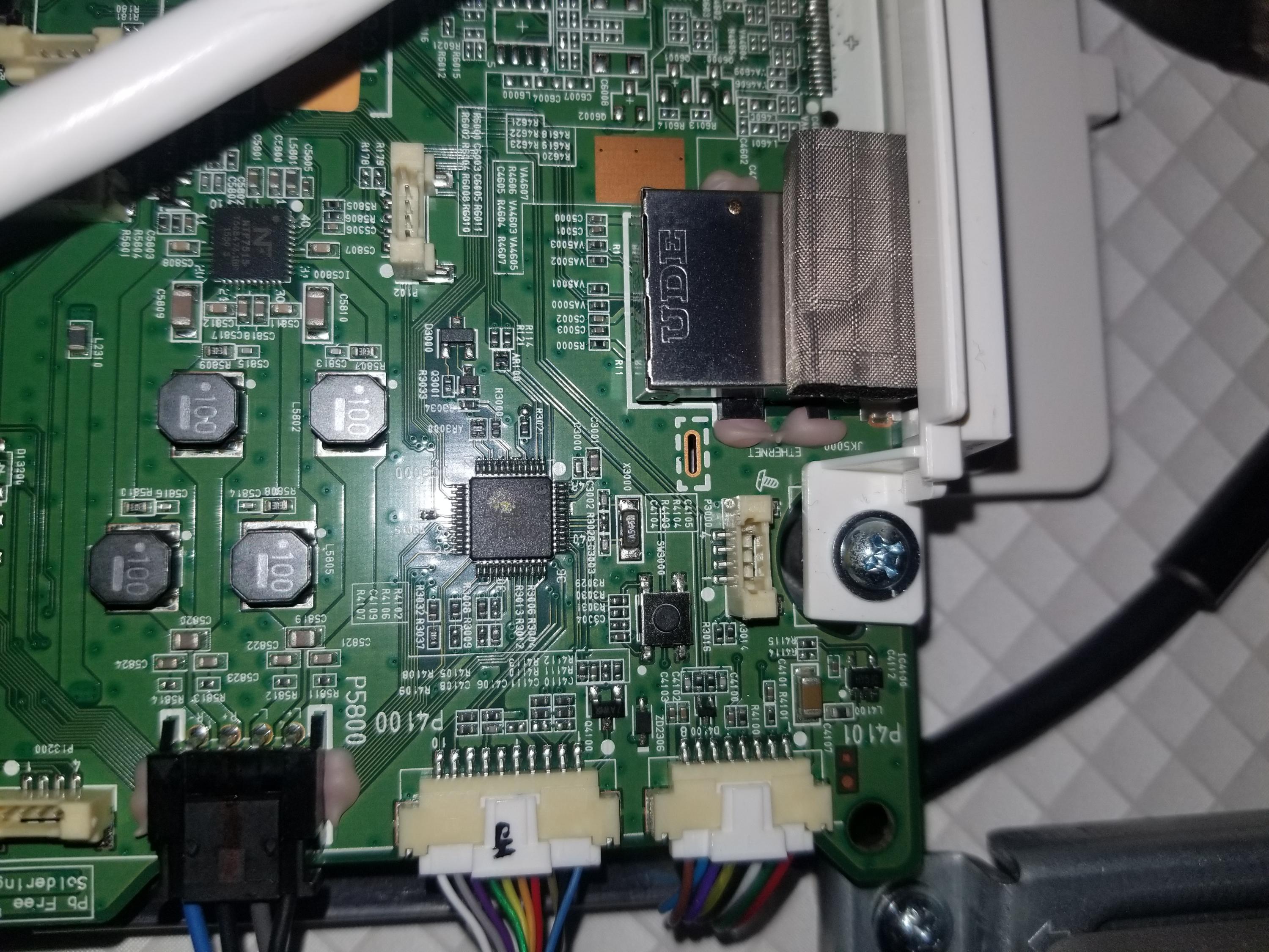

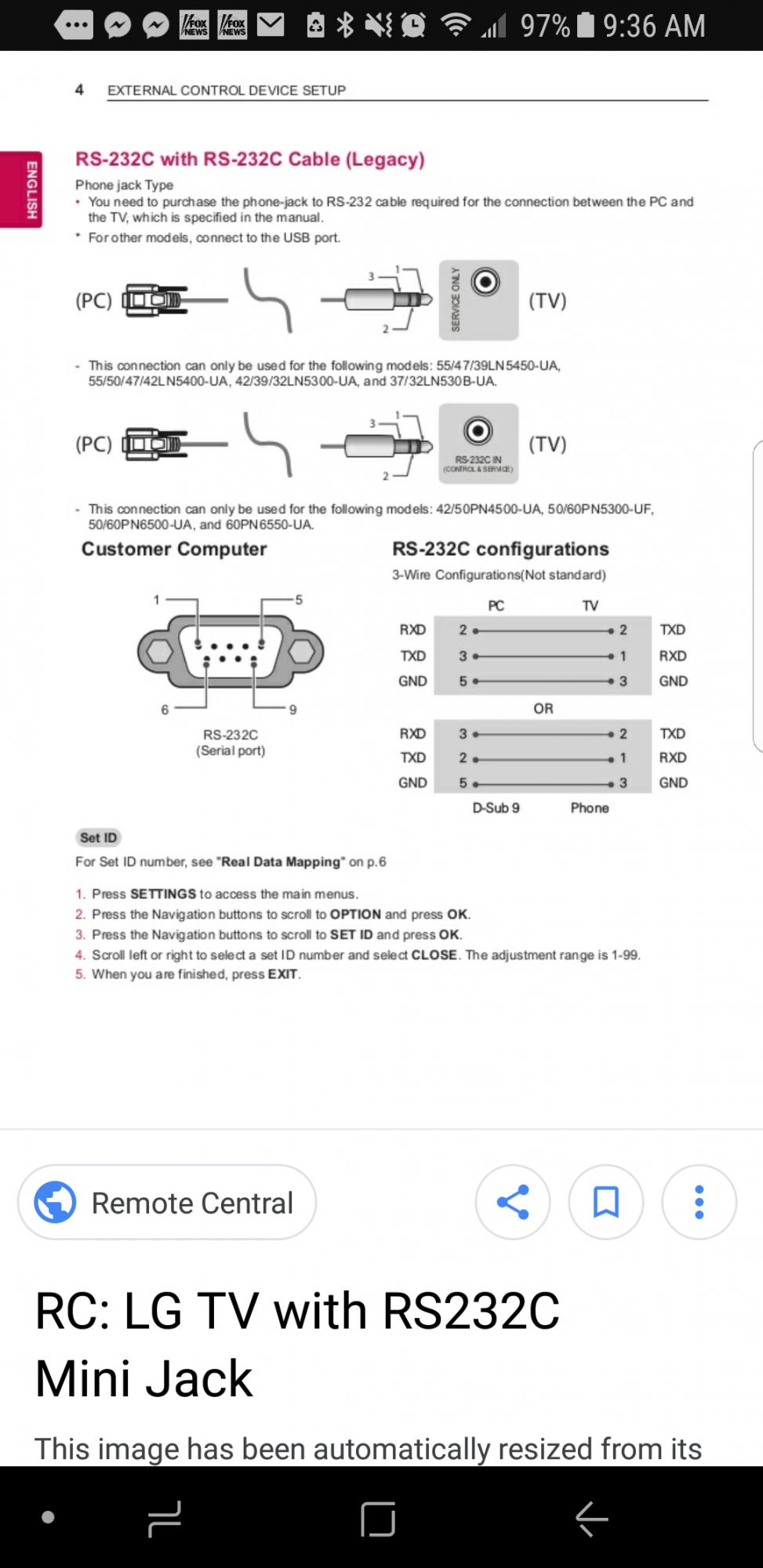

    I'm going to test some more on this board. I noticed the not so handy rs232-in-a-headphone jack. Wonder if this is how LG writes to the board to reload the logic or reset it when it fails like this situation. Of course none of this I have.
    The USB ports have no power in this Present situation

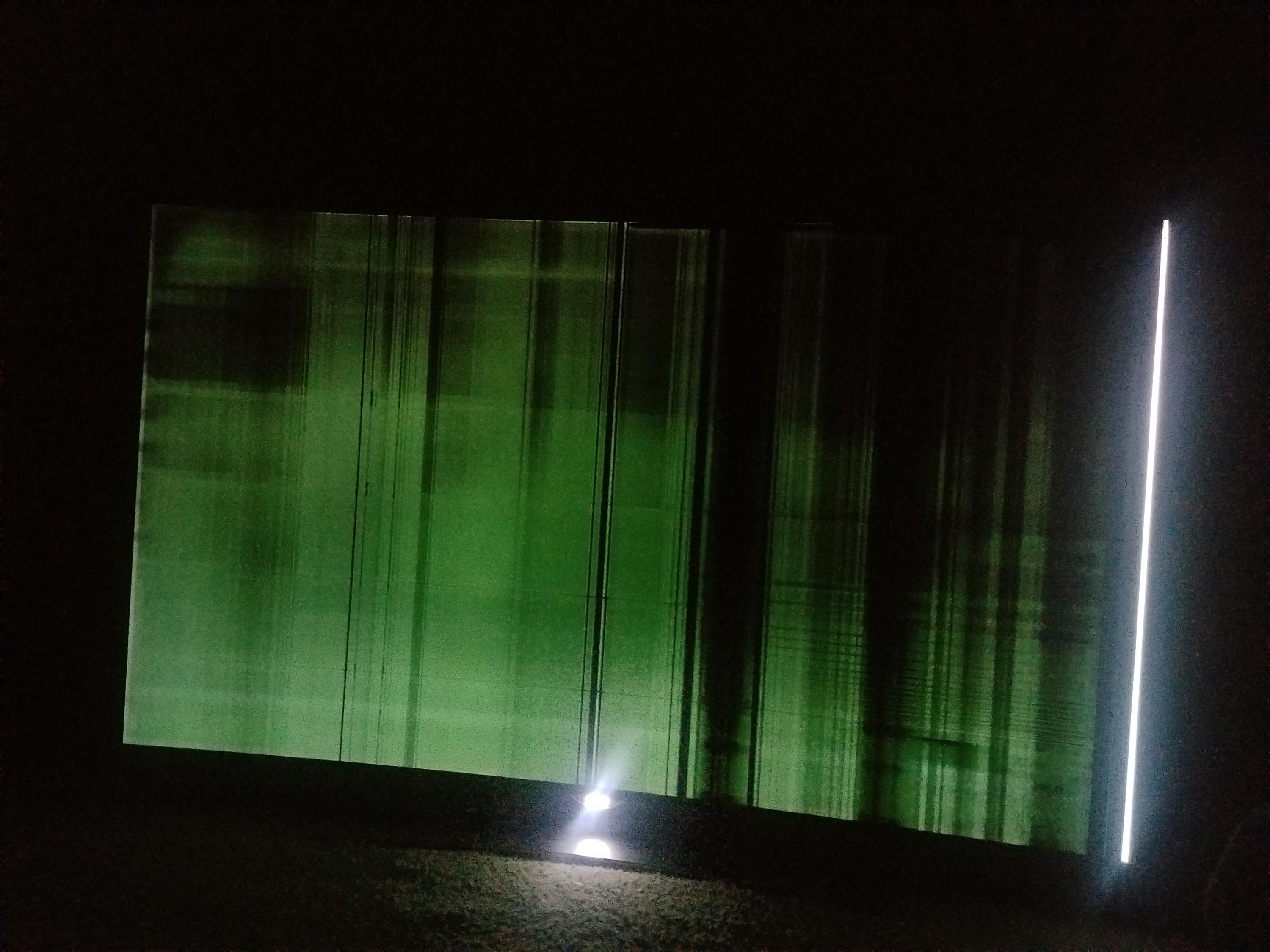

      I decided to take the guts from this busted screen tv and swaps them onto the defective line screen for shits and gigs since I had them anyway. I forced ps-on, 12v on and drv-on. Even thou mainboard is defunct, I get this andf every time I power down and plug back in, the screen changes a bit. Still have a dead mainboard thou.

        So finally is this a good purchase or not? I think starting a new technology experiment with a giant tv it's a risky business, i maledice myself when i have take this 60 inches without testing it well before buy, now is sitting in the garage to take dust.

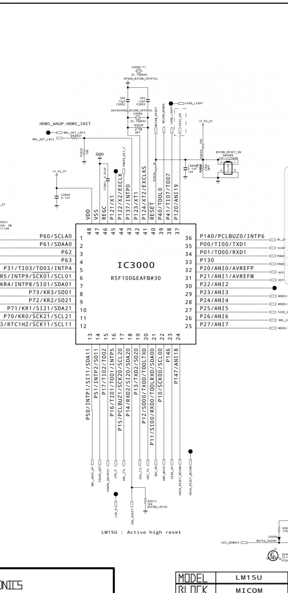

                  The TPS54527 transforms 12v in +3.3V_NORMAL that also lights up a led,
                  but this is unactive until MICOM don't set RL_ON "ON", IC3000 is a MICOM i.e. standby cpu, it controls IR & KEY board and there's a reset switch SW3000 (how it works?). You can try this reset or there's something that blocks this Micom to switch everything on, maybe standby firmware corrupt or need a connection to a pc for Micom debug through P3000..

                    You read my mind and I was just about to post about the SW3000. This enables MICOM RESET AND MICOM DEBUG.
                    This is part of the p3000 connector. , It looks like LG uses this for something they would plug a jig into.
                    However I have pressed the button and it eliminates the power light or the flashing I've held it down I pressed it nothing happens when I release the button it goes back into his present state

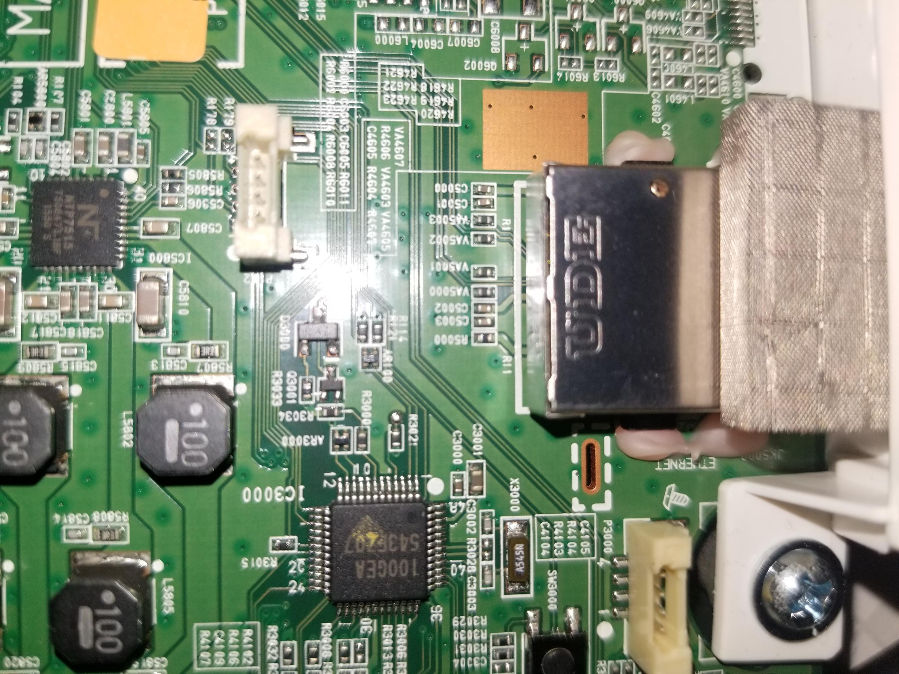

                      It would appear that MICOM is powered or at least the standby section for MICOM IC3000
                      Between pins 2 and 4 of p3000, I get 3.5vdc when SW3000 is pressed.
                      On IC3000 I have 3.5vdc on pin 48

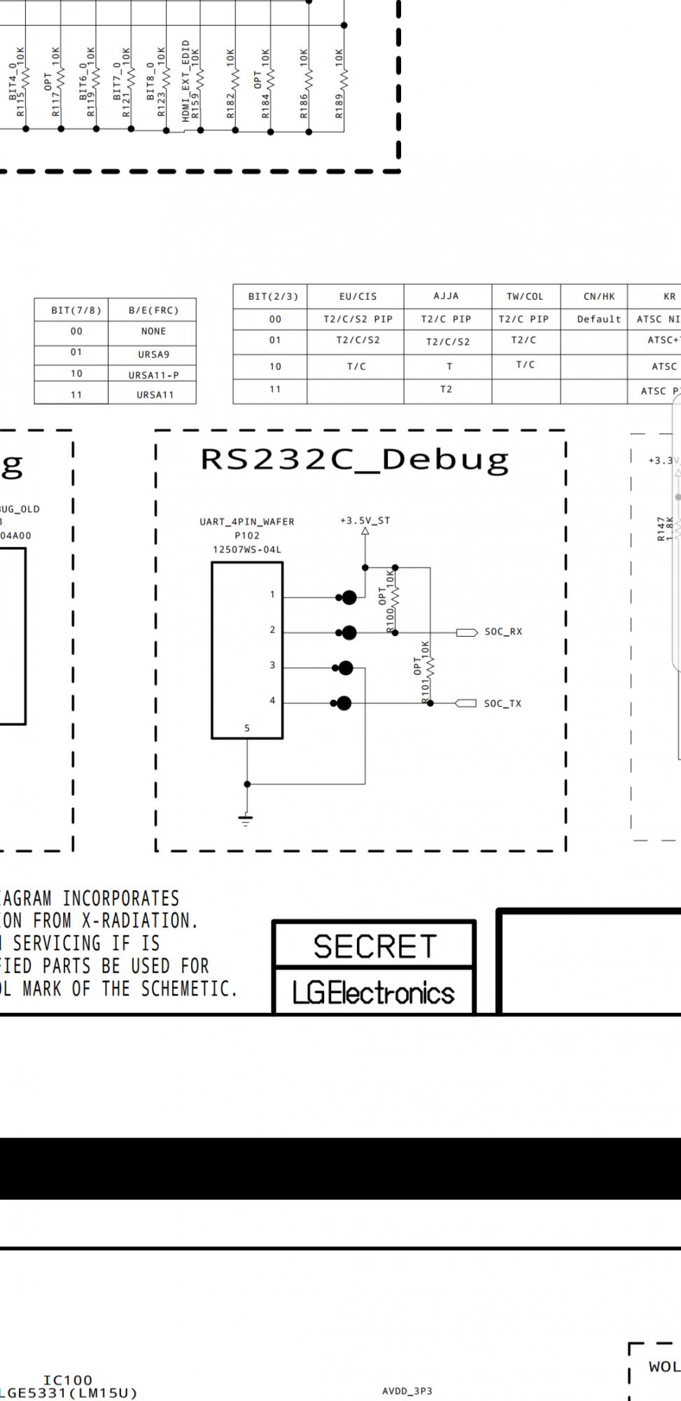

                        This is interesting
                        P102 IS OBVIOUSLY an LG proprietary jig. Some TX RX signals there. Maybe for programming MICOM reset?

                          not sure but have you checked all the "conditions" associated with the regulator to see what state it is in (what pins are getting what). If everything looks "reasonable", then just enable the regulator with a battery and see what happens. :-)
                          Of course, you might have to isolate the enable pin from the exiting circuit depending on what the path looks like (resistance wise or otherwise).

                            That would be a good theory was kind of what I was thinking but I'm not sure where to enable.
                            However I did come across this portion of the schematic and this shows what SW3000 is doing.
                            Surprisingly pin 36 for RL-ON is energized. 3.5v on IC3000

                              Have you got a Scope? Can you probe the signals at P4100 (VS IR-key board)?
