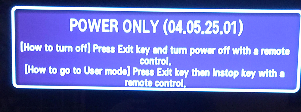

    Ok. Are you currently at the no power condition lockout? LG emblem dim lit. Remote power button causes flashing LG emblem. Power on tv does nothing.
    You should not have to do anything except for get yourself out of power only mode.

      Re: Just picked up a 55 inch LG 4k OLED for $50!
      What happens new use the power_only command? What should happen is about an 8 second paus after I hear the initial relay click.
      After the 8 seconds you should see the screen power up. This is where you see the command for in start?
      On the main board since you have a UA main board, Behind the metal shield, There is a push button. Once you power up the TV using the power only command immediately hold down this button.
      This is in a sense an E prom hard reset

          Right, normal power button from remote causes flashing emblem, power button on the tv doesn't do anything. The power-only command gives me the click, and this picture pops up. If I follow the instructions for user mode, a white screen pops up, and my tv shuts off.

              Yes this is the message that I got as well after I used power_only. The only difference is I did not have the 2nd sentence about in stop mode. What I did is I Turn off the TV by the remote without hitting exit unplugged the TV plugged it back in and then hit power and that message disappeared
              Only difference is my message was a black Box floating around a white screen.
              I never hit the exit button on the remote at any time when I saw that message though. I got this message a few times every time you lock out the system and force started with the power only mode this seems to pop up

                  I hit power to get out of the message, then I unplugged/replugged. It succeeded in giving me the click when I turned it on with the normal remote, and actually gave me an input picture and then turned off.
                  I'll give the button-reset a try this weekend. Thanks for the help

                    Ok. I would also check the LVDS cables. They require I2C feedback from tcon to mainboard. If this is not there the mainboard will shutdown. This is because OLED uses high current through the tcon and if mainboard is not happy with the signals sent back to it, it thinks there's a short. Then shutdown.
                    All eeprom related. There is an eeprom on the tcon and one on the mainboard for serial communications.
