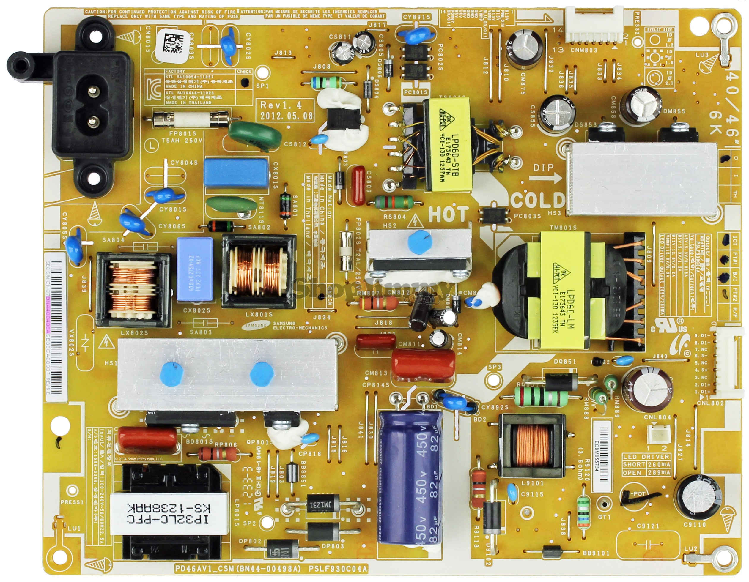

    Okay, so after looking some more on this forum for general samsung troubleshooting, I went ahead and measured voltages.
    BN44-00498A PSU
    Backlight Connector CNL802
    D1+ - D1-:
    -main board unplugged, Backlight lit up 240v to both.
    -All Boards plugged in, over 400v to both at moment of blink.
    -backlight unplugged, D1+ - Ground reads 300V to both
    S+ - S-
    Always reads Zero volts, every condition
    S+ - Ground reads Zero volts, every condition
    With the led backlight connector plugged in, Measured from D1 to -D1 I get a brief spike of >400 volts, when the backlight blinks on. Remember it only blinks on very briefly then cycles all over again. There is also a loud hum when I do it this way. I'm pretty sure all of this is normal but I'm documenting it anyway.
    To Main Board Connector CNM803
    Odd Numbered Pins
    1. 12.7v
    3. 12.7v
    5. 12.7v
    7. 12.7v
    9. 0v
    11. 5v
    13. 5v
    Even Numbered Pins
    2. 3v
    4. 12.6v
    6. 2.8v
    8. 0v
    10. 5v
    12. 3v
    This is all I have found as far as what to measure so far, with the exception of a possible fuse on the Tcon board to check, but I have not found it. I have read a few posts that say that the backlight leds and power supply are in working condition if the backling turns on when the main board is unplugged. Is this correct? I should focus on the tcon and main board now right?

                So your power supply board is BN44-00498A?
                I do not see any Backlights ERROR signal pin on the power supply board that goes back to the Main board to tell it to shutdown if there is problem with backlights circuit.
                • farnswerth
                  • Mar 2013
                  • 17
                  Re: Samsung un46eh boot loop
                  YEah BN44-00498A
                  I dunno if you need the full number printed on the board, but it's PD46AV1_CSM (BN44_00498A) PSLF930C04A
                  And the Main BOard is BN94-05758C

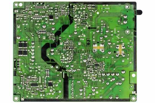

                    Can you check the DC Voltage between the two legs of that main filter cap 82uf 450VDC when everything are hook back up and turned on? I want to see if the Voltage will be steady at around 390VDC or not or if it is fluctuating.
                    Pictures provided by shopjimmy.
                    • farnswerth
                      • Mar 2013
                      • 17
                      I checked the voltage with everything plugged in, with just the main board unplugged and with just the backlight unplugged.
                      With everything plugged in, it hits 390-400, then starts to slowly come down to around 340 before going back up. I believe this is the tv powering down, as it's always right after the lights blink that the voltage decreases, and right before the chime that the voltage increases.
                      Unplugging the main board shows a constant voltage of 393 volts. Unplugging the backlight shows a constant voltage of 393 volts as well.

                        If the it powering down it would have drop down to around 160VDC not 340VDC because when TV is powered down the PFC Voltage booster circuit will be shutdown.
                        But we still need to know if the control Voltages are also going up and down or not, so monitor POWER ON/OFF pin 14 of the power supply connector to see if it goes up and down in sync with boot loop or not.

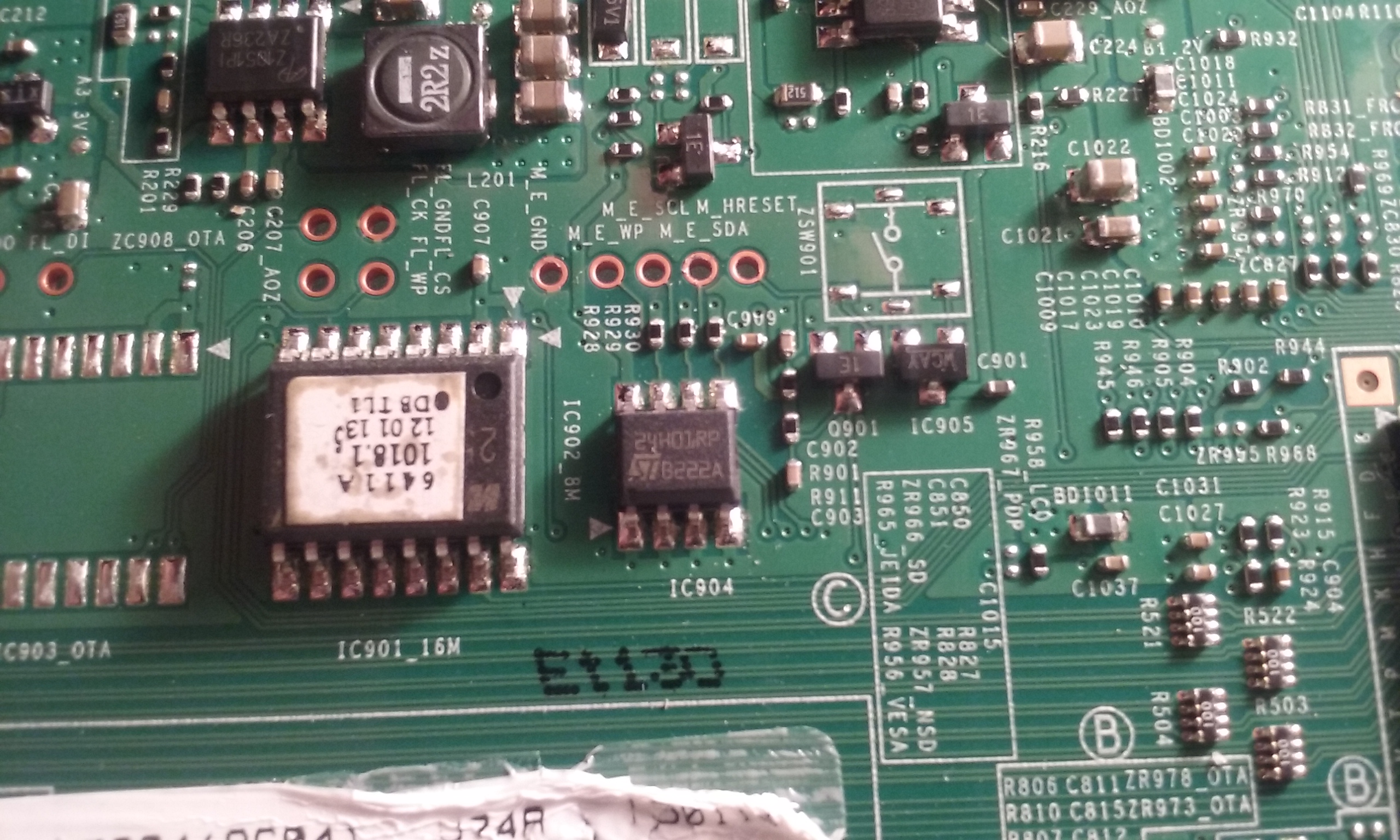

                                I have just fixed a Samsung that was in a boot loop. It's a slightly different set with Smart and as well as the EEPROM there was also NAND.
                                There are some holes neat the EEPROM, join the reset and SDA together and power on the tv, let it power on and reset, then remove the power and remove the join.
                                I believe when the reset is enabled it loads new firmware from the memory.
                                It might be a similar arrangement on your TV and work investigating although my TV stayed on for about 5 seconds before restarting.

                                      Thank you. I think I found the ic on my board, and it looks like its pretty different than those examples. There is a pinout here, but I can't make out what the order is supposed to be, it's confusing me.
                                      • farnswerth
                                        • Mar 2013
                                        • 17
                                        Okay so I tried multiple combinations to jump the eeprom to reset. The last three pin holes look to be (1) M_E_SCL (2) M_E_SDA and (3) M_HRESET. I tried every combination of those three holes but got nothing new to report.
                                        I thought I was on to something with this post Because the last post is a mention of replacing the TCON board fixing the problem, but I misread a few comments before, and it turns out that solution fixed a completely different problem than mine.
