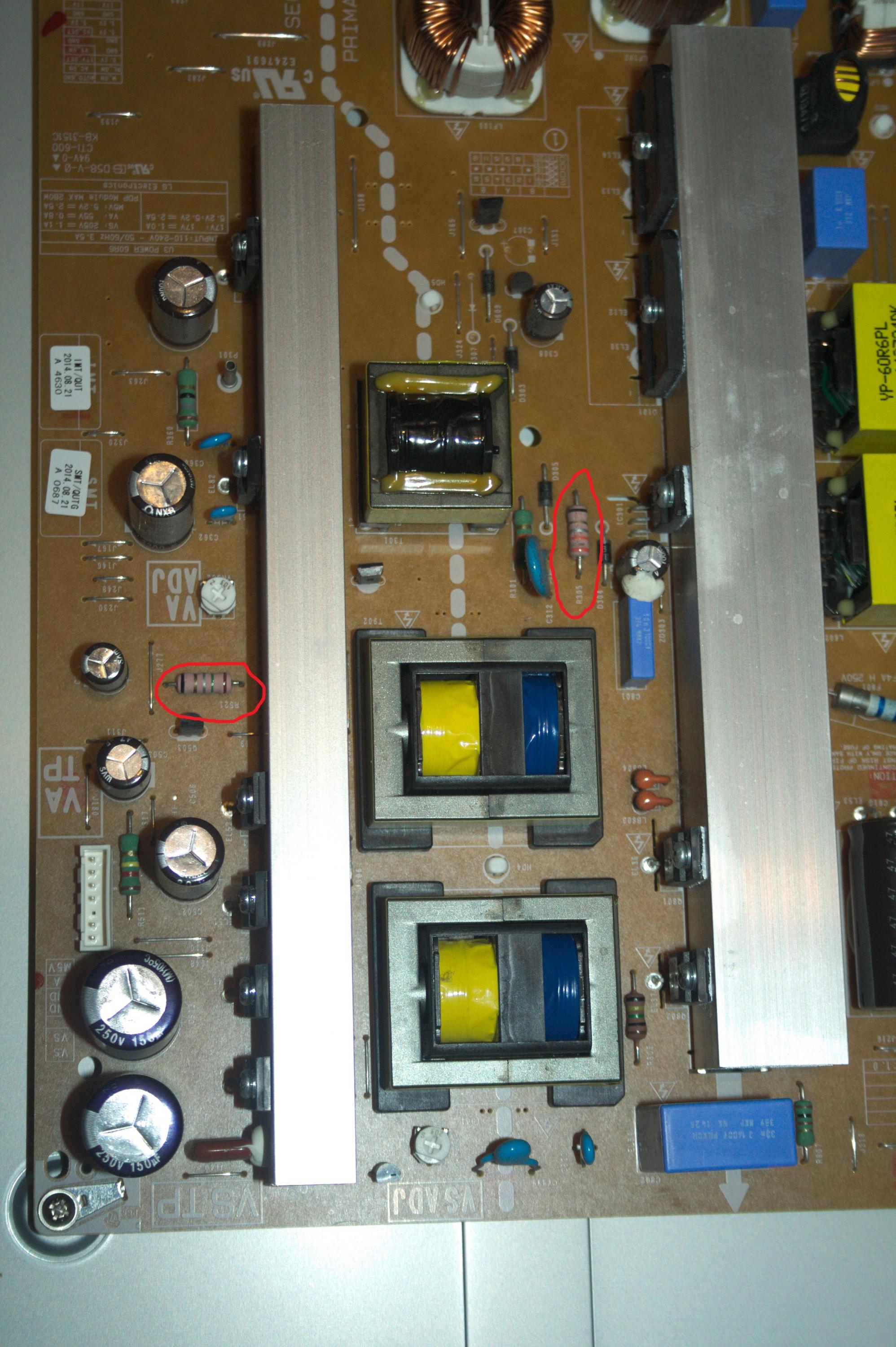

        I have tried to include some pictures of the power supply board. I have also measured the resistance of the 2 highlighted resistors (without desoldering them) Both resistances were close to 0.

          That Vs is far too high but should be tested while loaded. You can try and check resistor values with colour codes on net (good luck!!). You may be able to find a tutorial similar to this one by search.

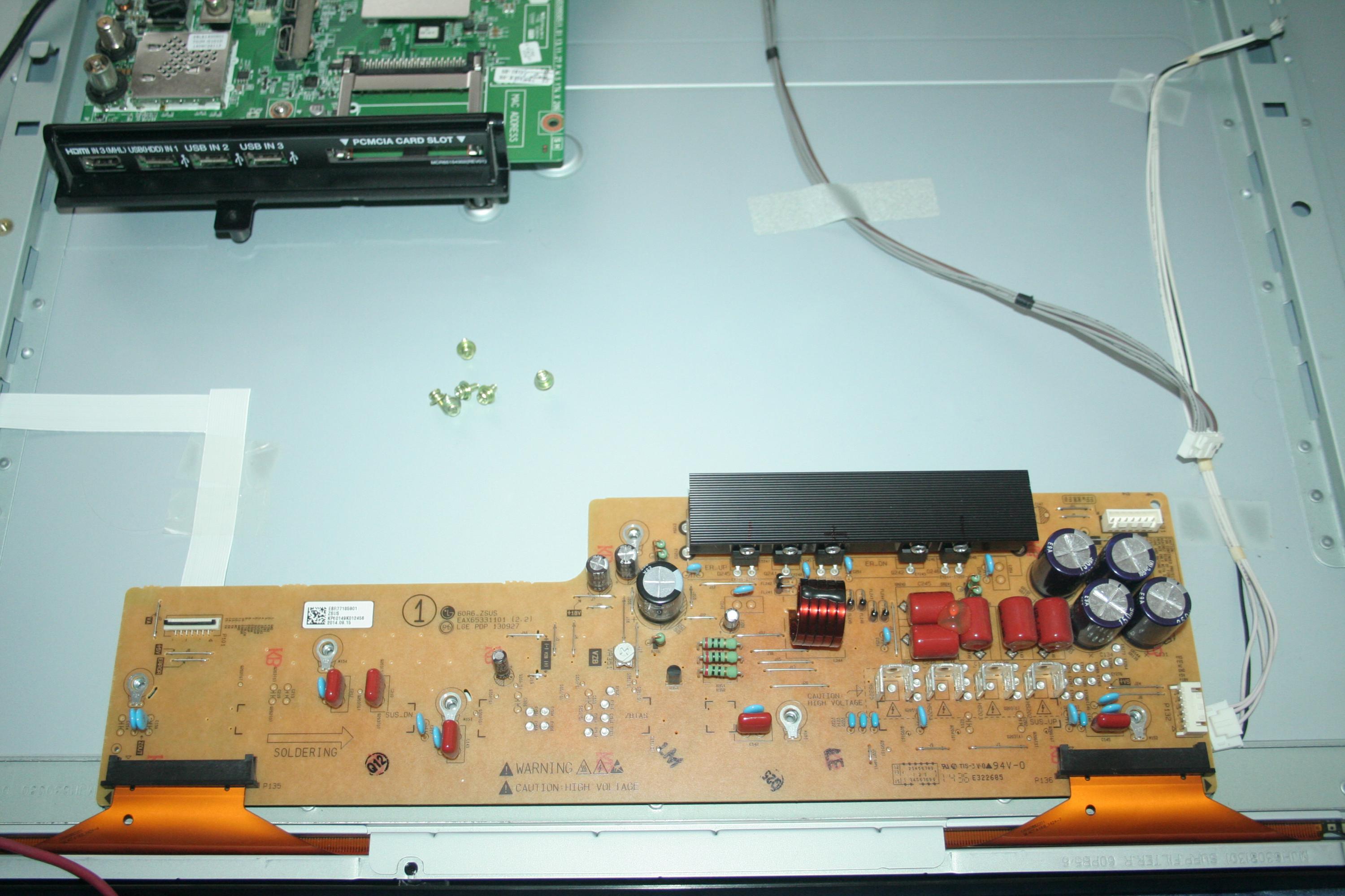

                    And this is why you're supposed to post a pic of the WHOLE back of the panel so we can see ALL the boards and how they're connected together.
                    The 18v line is usually created on the YSUS and delivered to the ZSUS.

                      This model is commonly known to have a Y-sus failure. I would check all transistors on the Y-sus including the ones on the back side of the board that look like the ones found on the newer Panasonic SC boards.

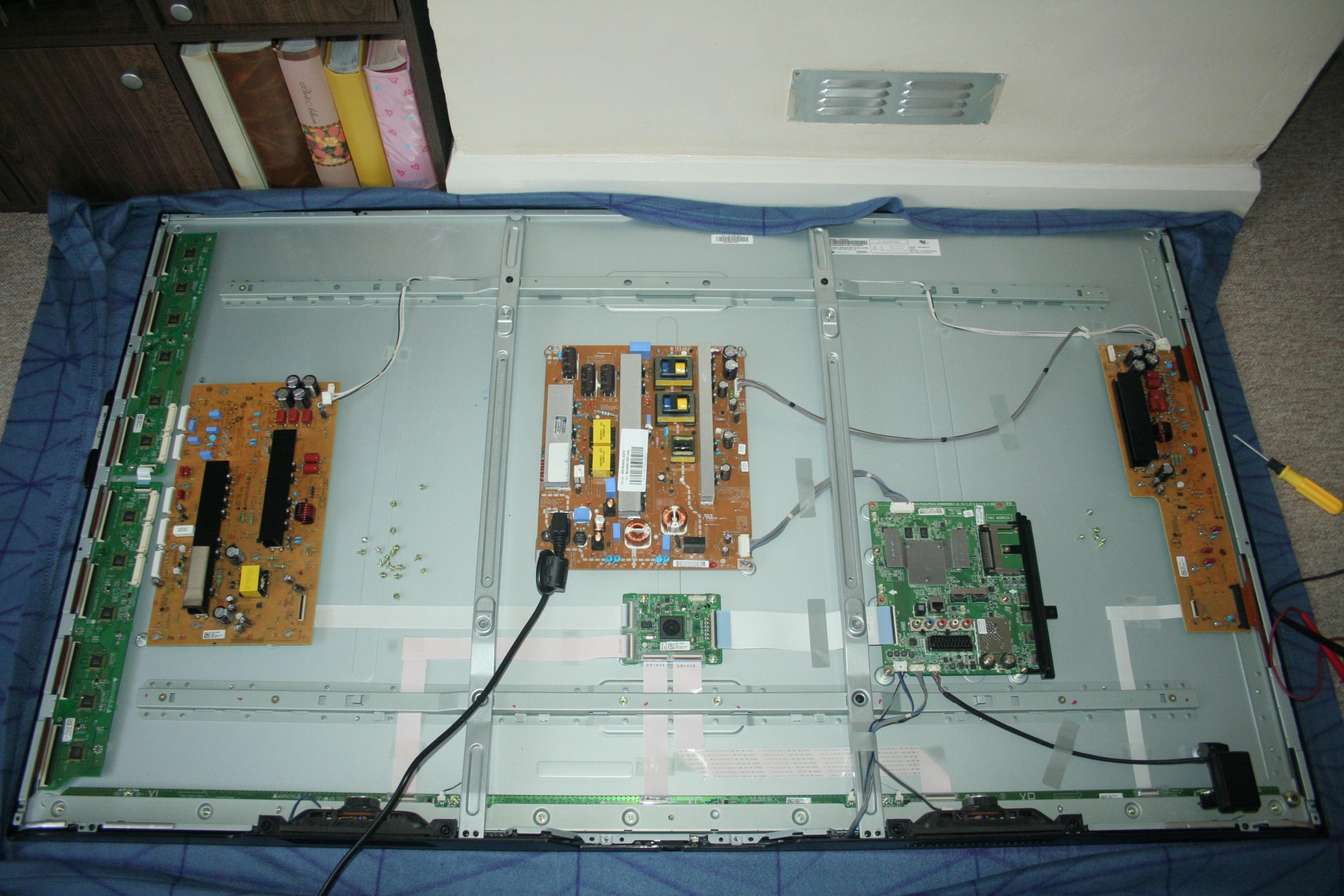

                        I have attached the picture of the tv layout. Some boards are disconnected as I am still trying to pinpoint the fault. I have also attached ZSUS picture with 18V test point visible. There should be also 18V output to the YSUS, but I have only measured 5V there (outside pin of the connector, labelled 18V)
                        I have already checked the transistors on the YSUS by using an ohmmeter and by measuring the resistance between connectors of the transistors (without desoldering them). I have checked all large transistors which have heatsinks. I did not find any shorts. The only short I found was between outside pins of the diode D443. I have also found a short between pins of the other diodes but outside pins of those other diodes are simply connected to the same point on the PCB.
                        I still don't know why there is no 18V on the test point on my ZSUS. I tried to measure this voltage with just ZSUS board connected to power supply and all the other board disconnected.

                          I can't be 100% sure, but it looks like the 18volts comes from the Ysus, I cant make out the transformer location number but it is the one next to the VY adjustment. That transformer supplies D203, which connects to iC201 which I think is the 18 volt regulator
                          I think that transformer also supplies the VY voltage

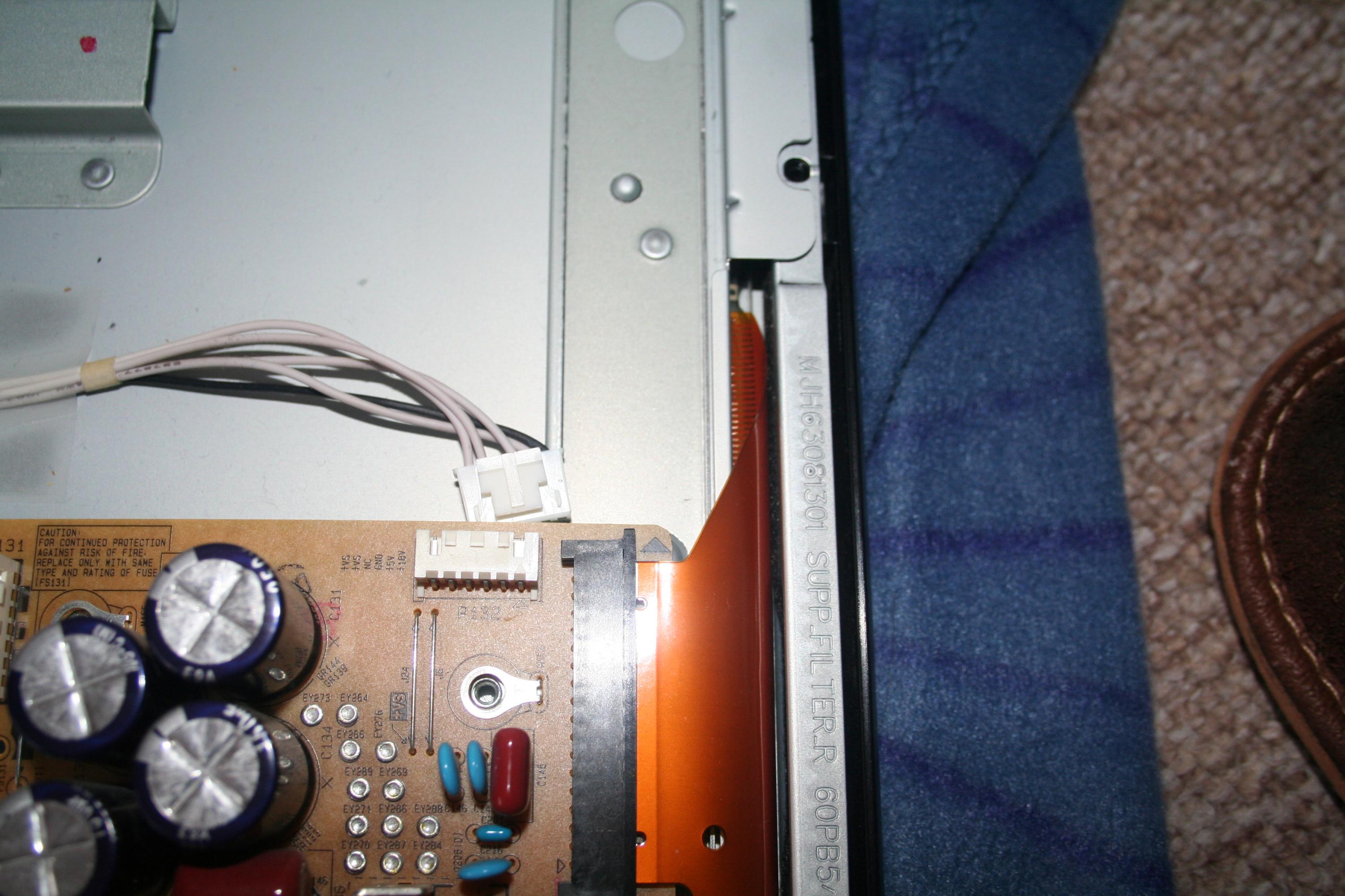

                                  I have included pictures of the ribbon socket (which goes to the control board) P100 on the YSUS. There is nothing about 18V on the label of it. I have also included the picture of the power socket on YSUS (which goes to ZSUS) P130 which has 18V on the label. I am thinking about removing 18V wire from the plug going to P130 and then checking if I have 18V on the P130 output from the YSUS. This would allow me to see if there is a fault on the YSUS or if the ZSUS is dragging the voltage down. Does that sound like a good idea? I am planning on keeping the mainboard disconnected from the power board and buffer boards disconnected from the YSUS while I search for the 18V.

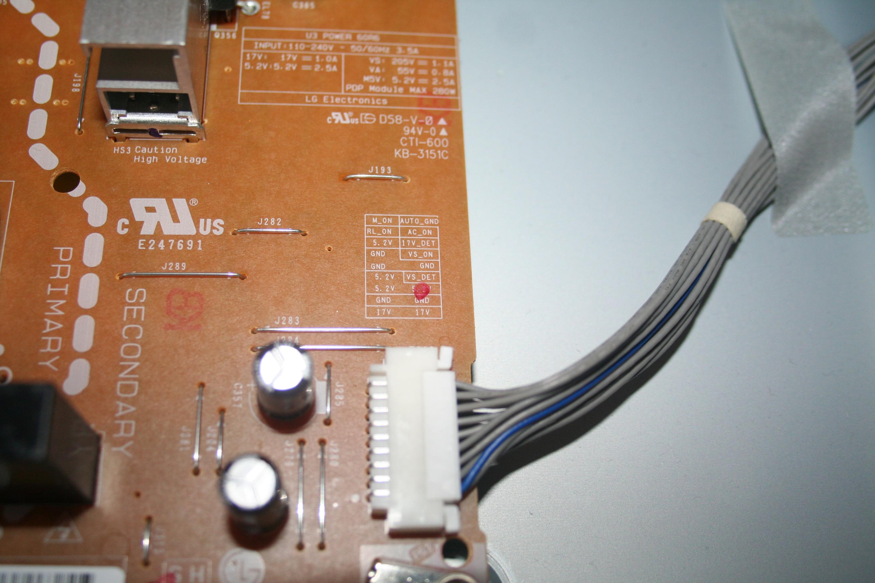

                                  M_ON - 0.6V
                                  RL_ON - 0
                                  5.2V - 5.3V
                                  GND - 0
                                  GND - 0
                                  5.2V - 5.4V
                                  5.2V - 5.4V
                                  GND - 0
                                  17V - 17.7
                                  AUTO_GND - 3.6V
                                  AC_ON - 5.3V
                                  17V_DET - 2.4V
                                  VS_ON - 0.7V
                                  GND - 0
                                  VS_DET 2.8V
                                  5.2V - 5.4V
                                  GND - 0
                                  17V - 17.7V

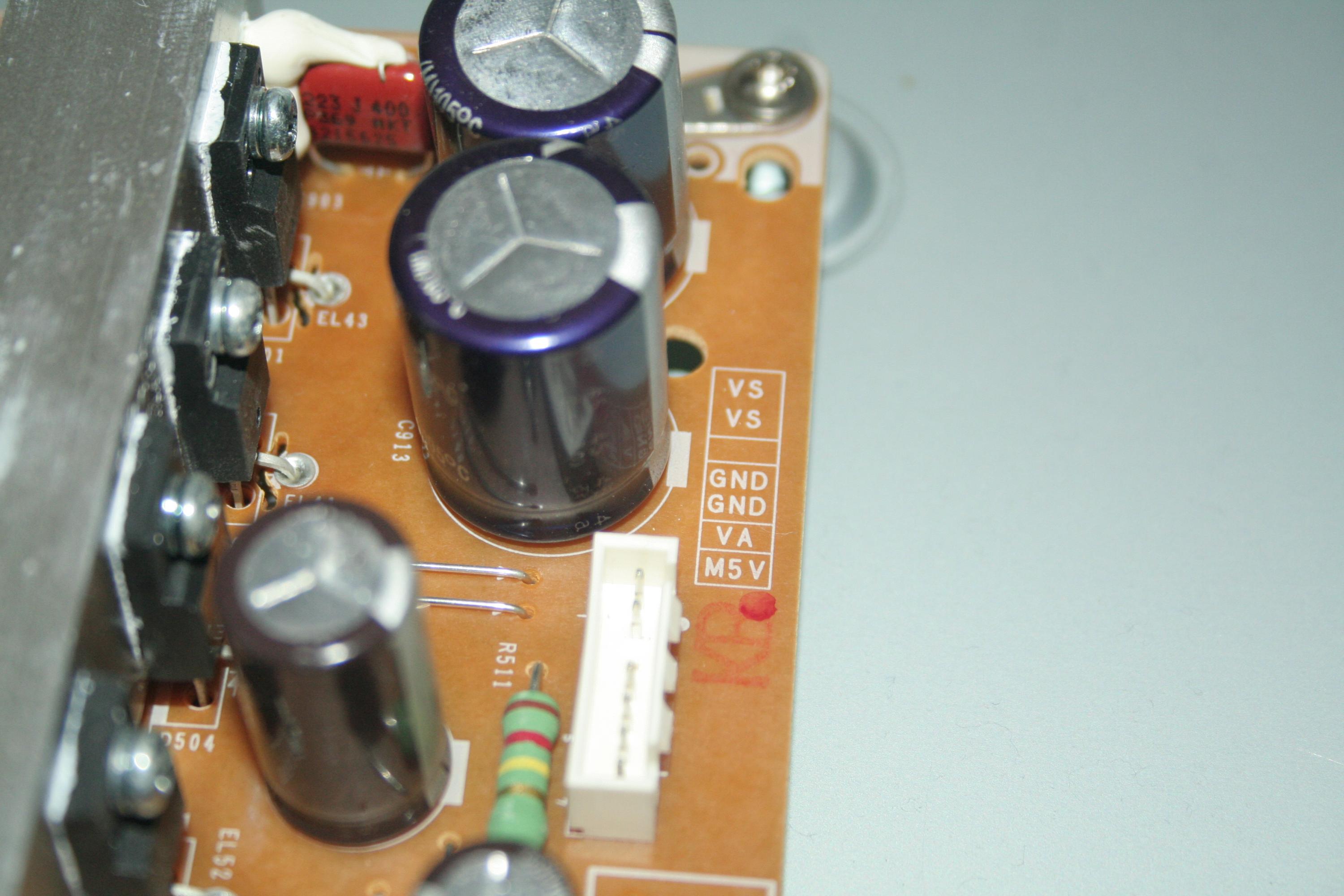

                                  And the following on the socked going to the ZSUS:
                                  VS - 229V
                                  VS - 229V
                                  x
                                  GND - 0
                                  GND - 0
                                  VA - 61V
                                  M5V - 6V
                                  I am not sure what 17V_DET. Do the voltages look OK to you?
