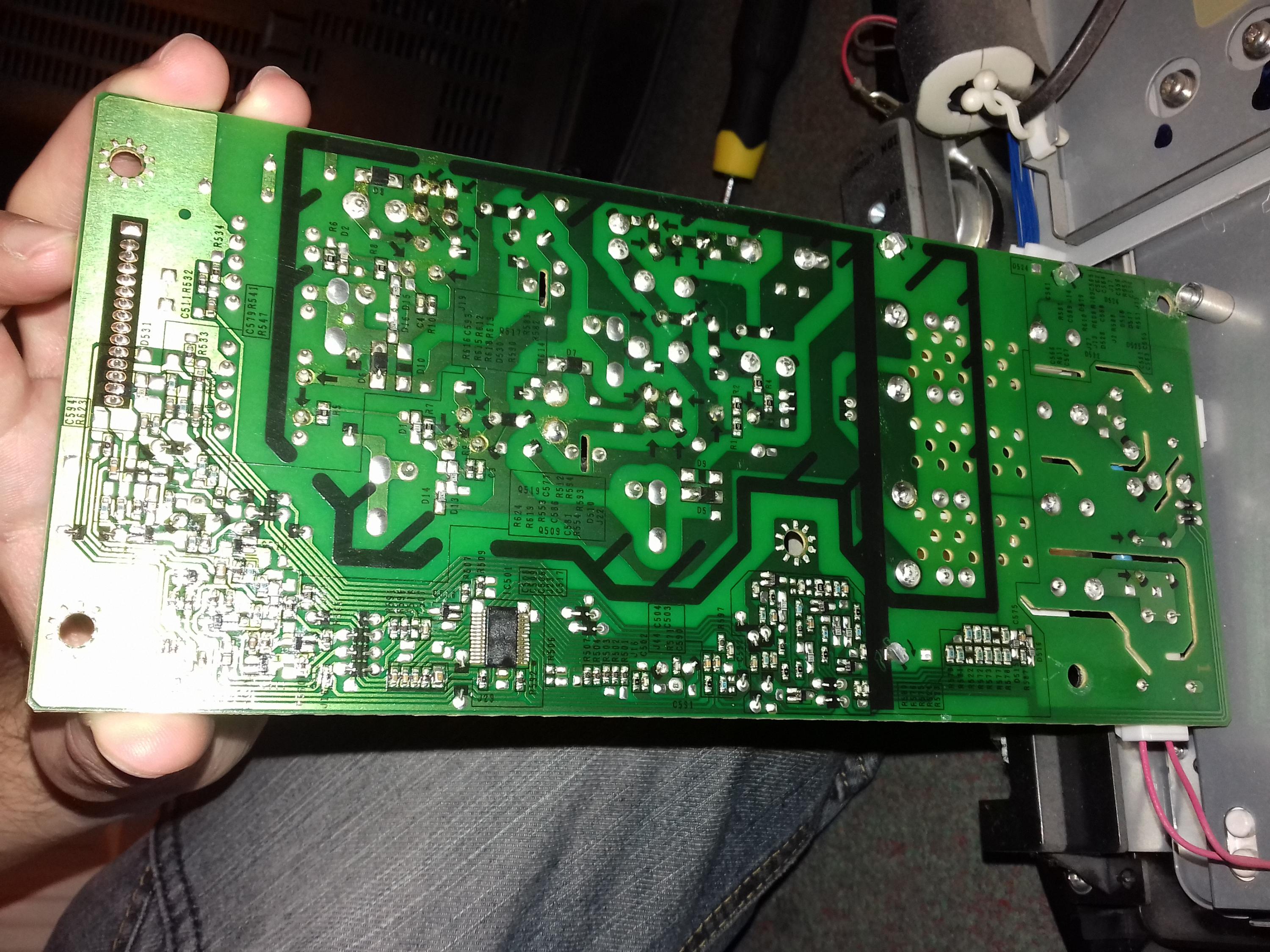

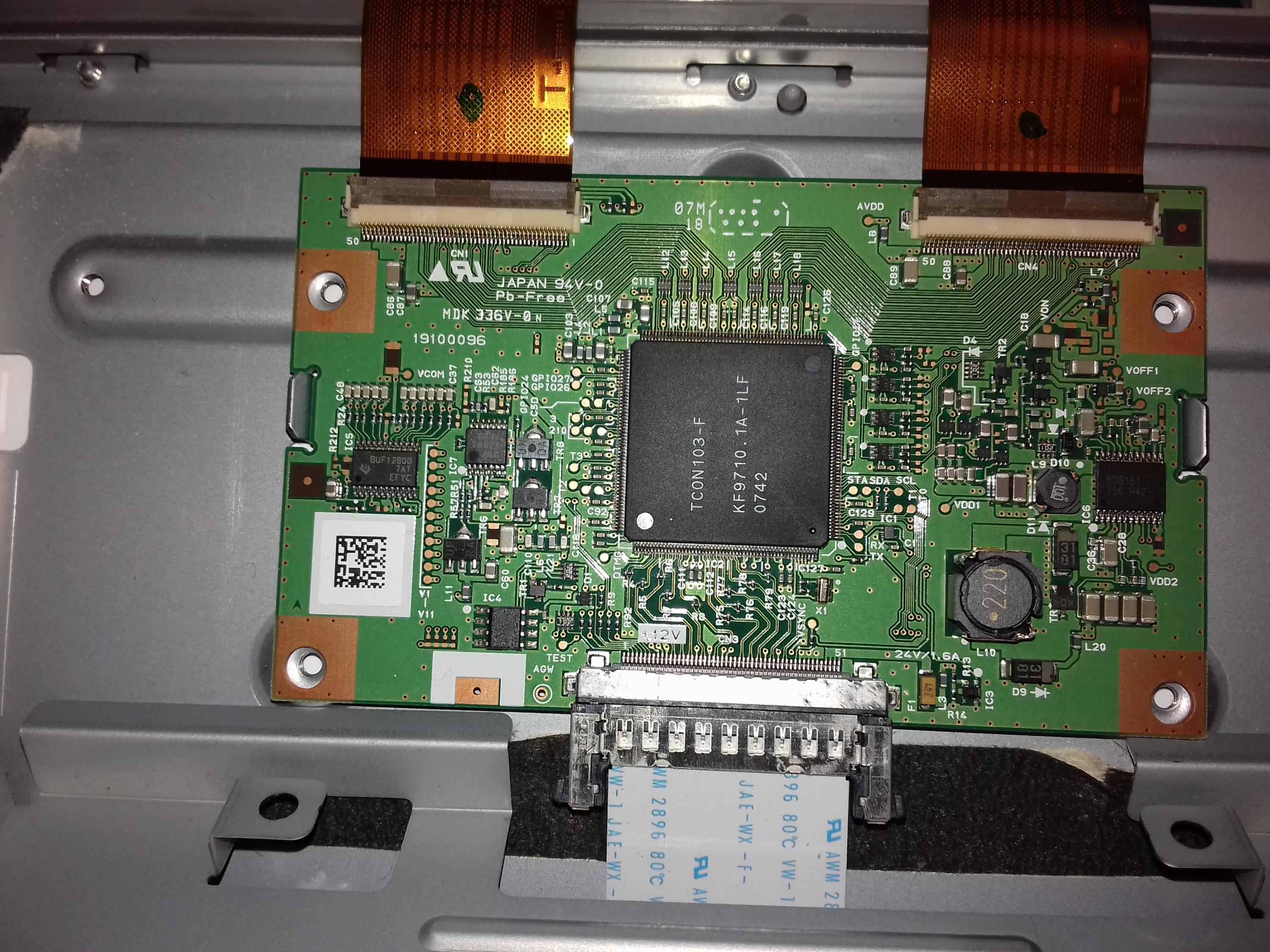

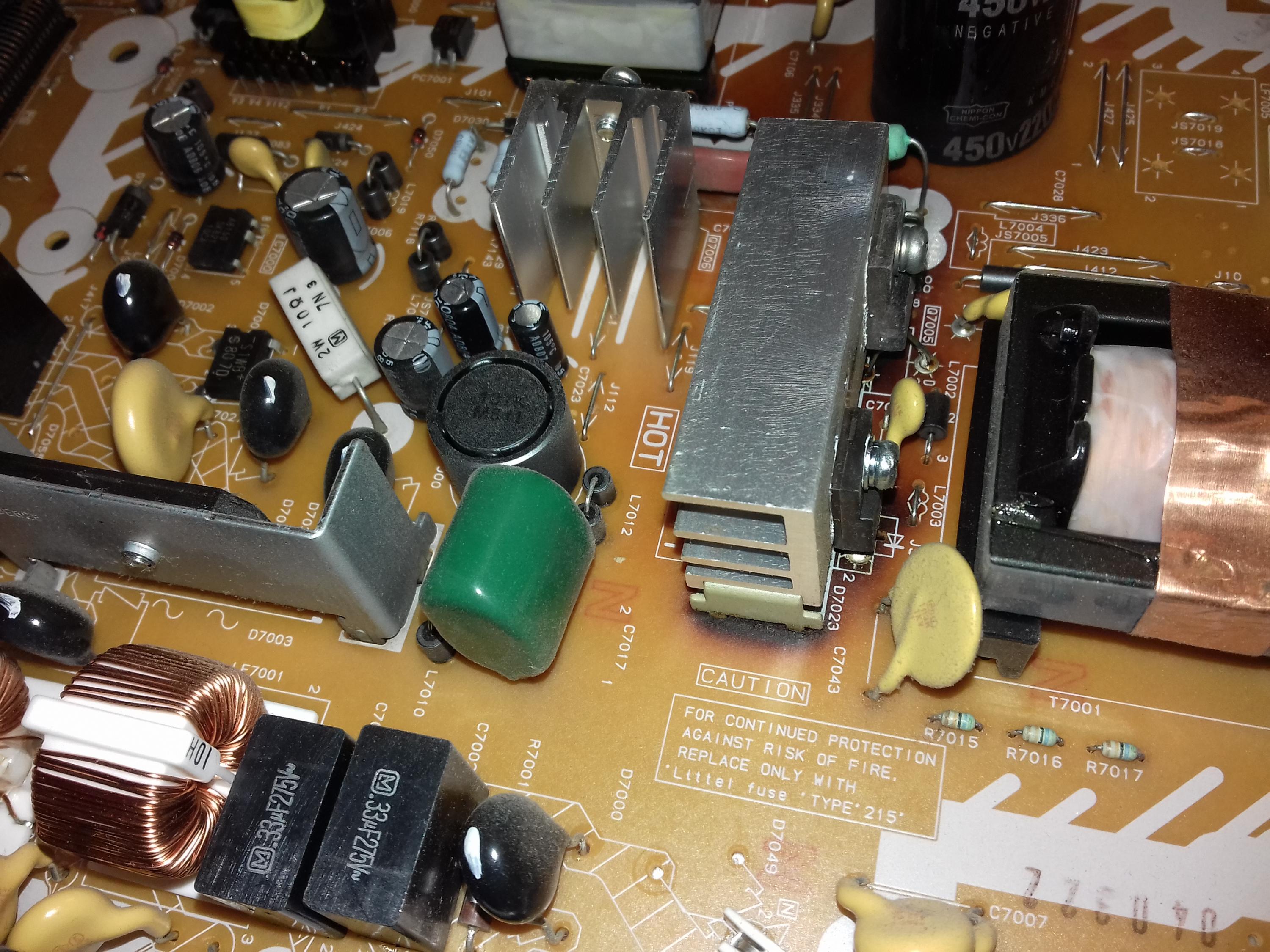

    I have just gotten a Panasonic TX-32LZD80 TV for free, the owner said she thinks the light/bulb is blown, but I'm not sure that she actually has any idea what's wrong with it. I immediately put a new fuse in, but there is no sign of life whatsoever after I plugged the TV in and tried to turn it on. When I press the on switch on and off, nothing happens, there is no green or red ON/standby LED, absolutely nothing. I hear nothing happening either. Pressing the on button on the remote does nothing either.
    I have read the only other thread about the TX-32LZD80 and the fuse in the T-Con area seems fine, I'm not sure how to tell if its blown but it doesn't look obviously blown/bulging or burnt.
    Is there any other simple things I can try to try to fix this?
    thank you!

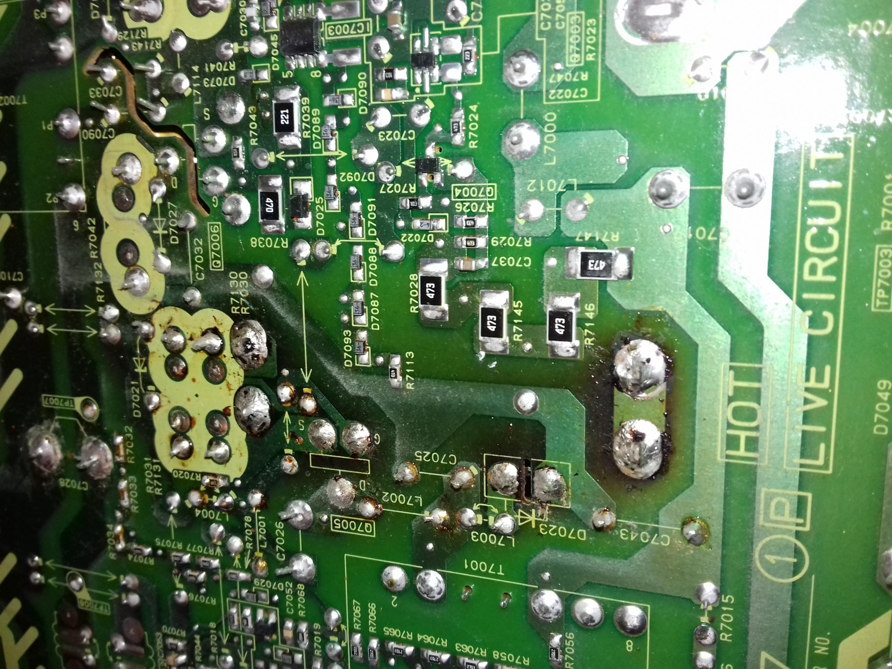

        Re: Panasonic TX-32LZD80 - Seems completely dead
        They have got warm/hot but are not burnt. Unable to say if they have failed without a multimeter. Did you unplug the connectors in photo 3 ?
        Tcon fuse is common on these, but again you need a multimeter to check.
          Yes I unplugged the connectors in that photo 3 to look at the other side of the board.
          Ok thanks. Do you think the Tcon fuse by itself could have caused it to get so hot and caused all these symptoms of it being totally dead?
            No, the tcon has no relationship to the heat on the power supply.

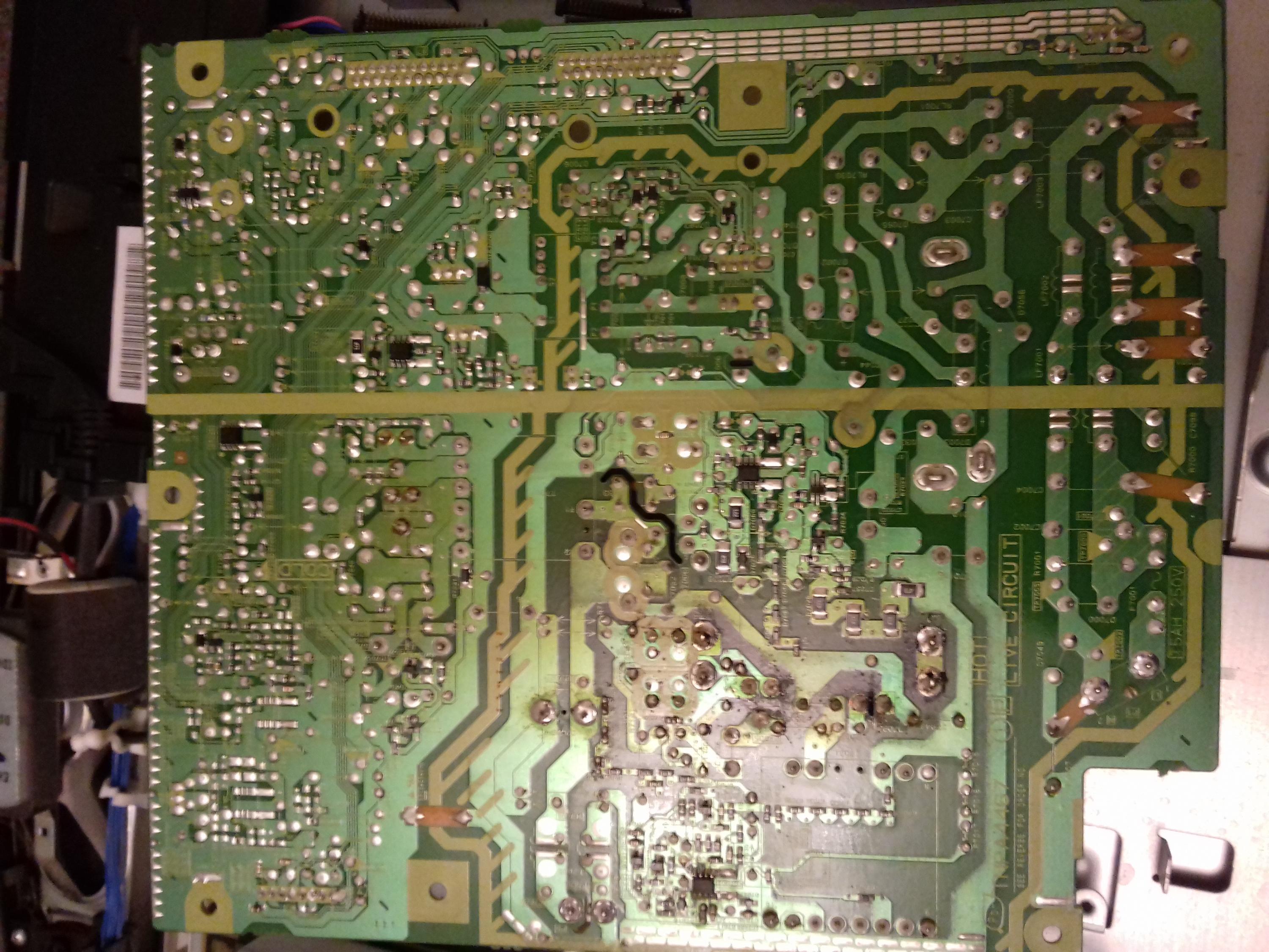

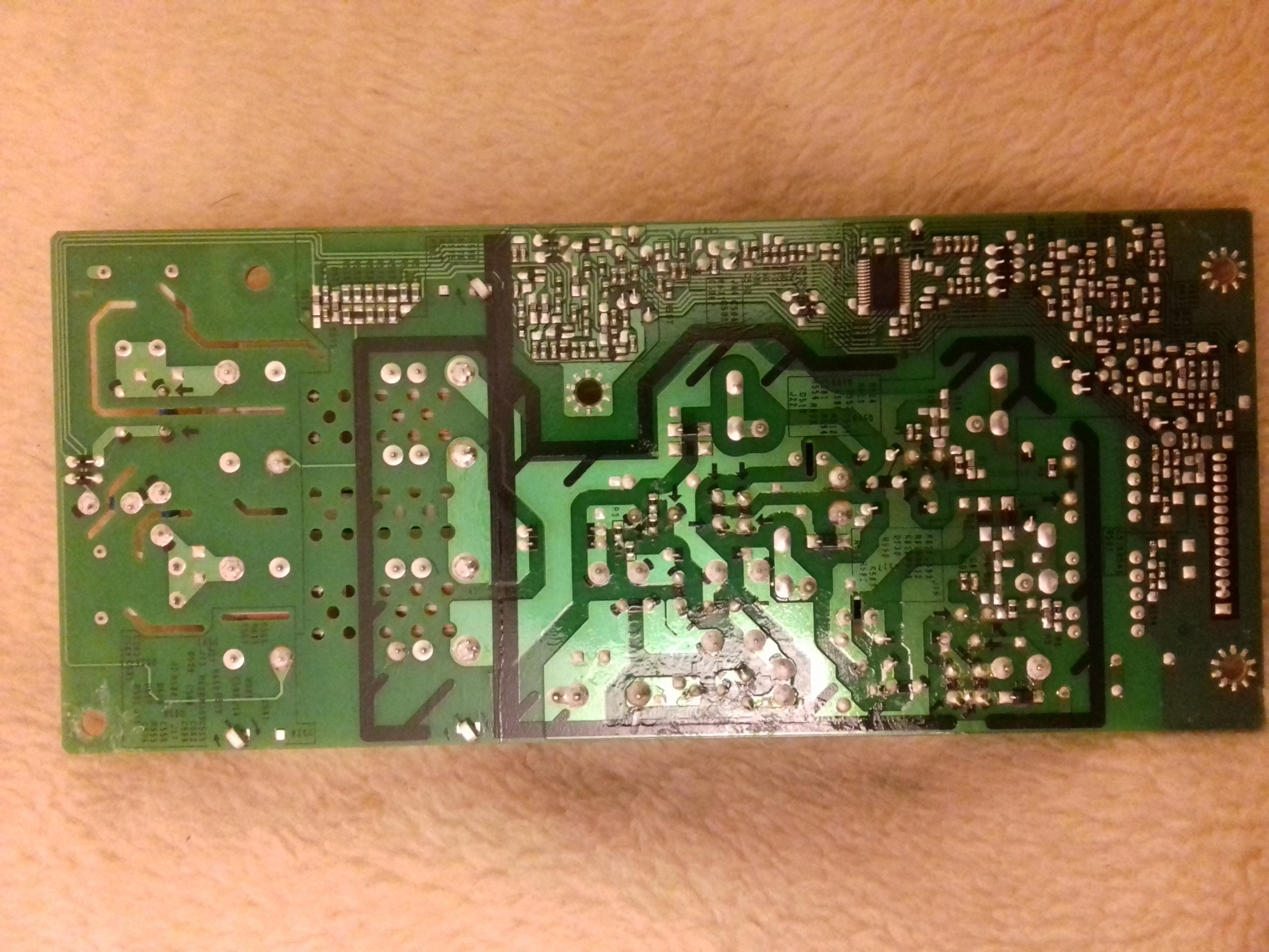

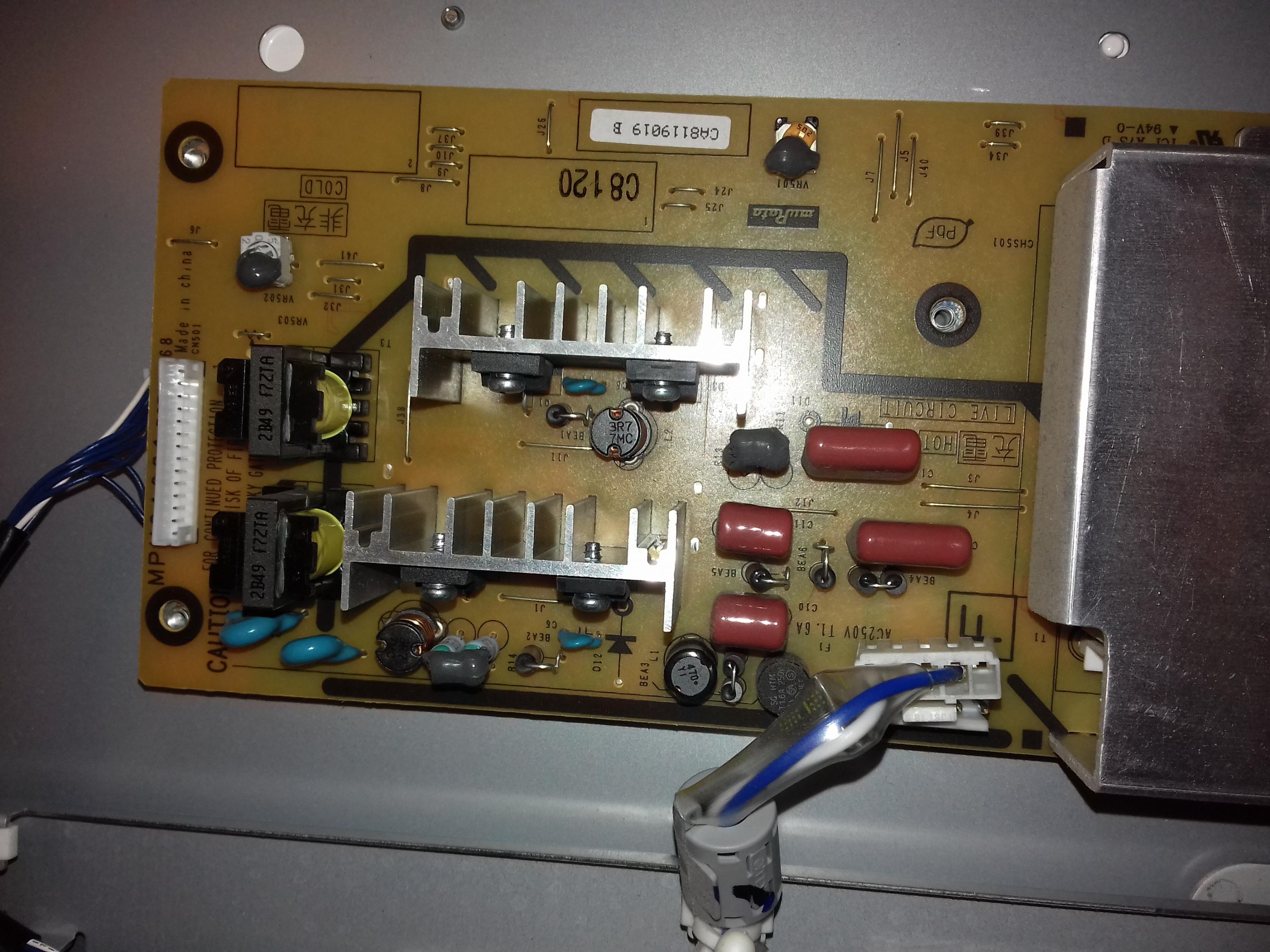

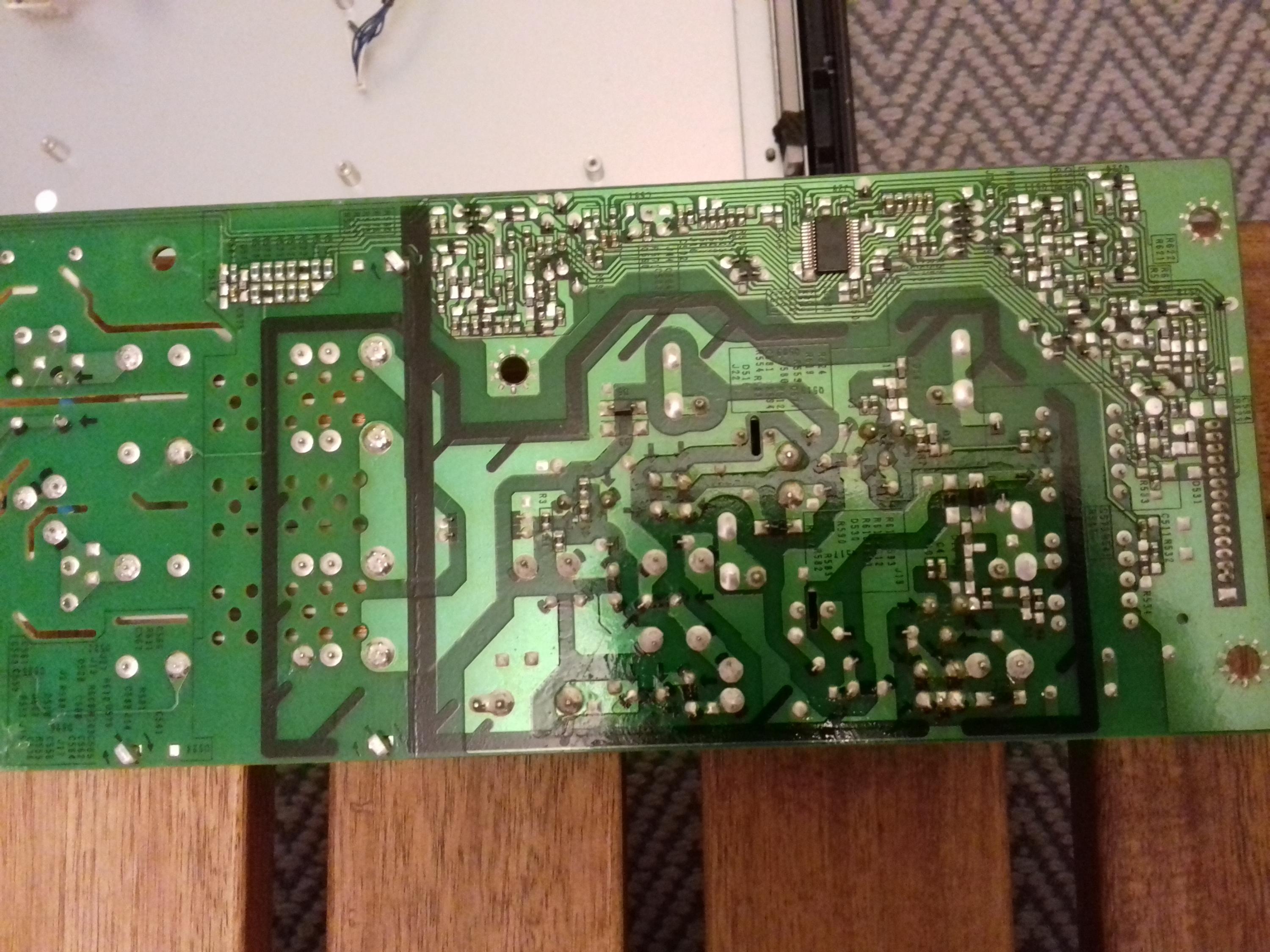

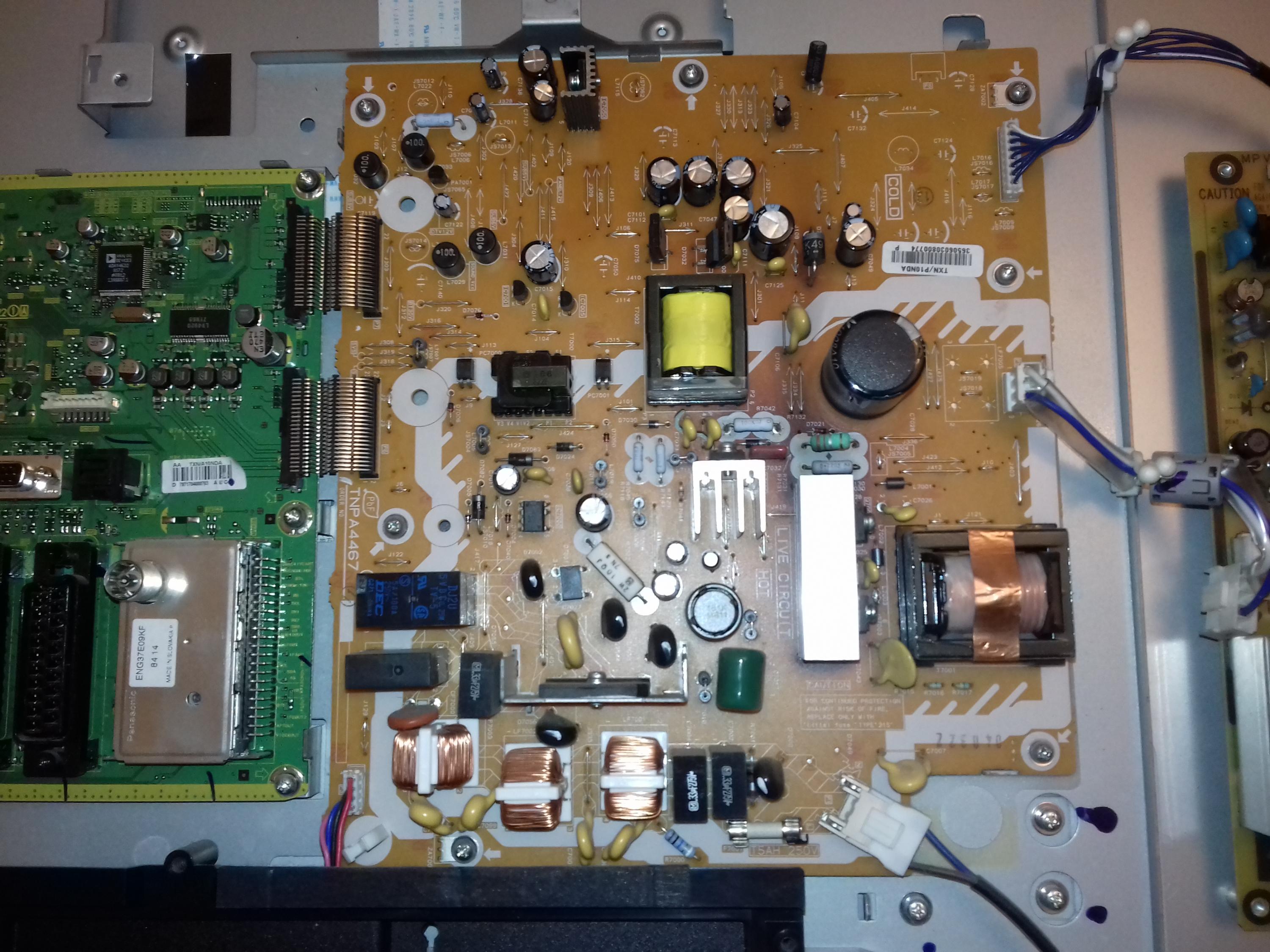

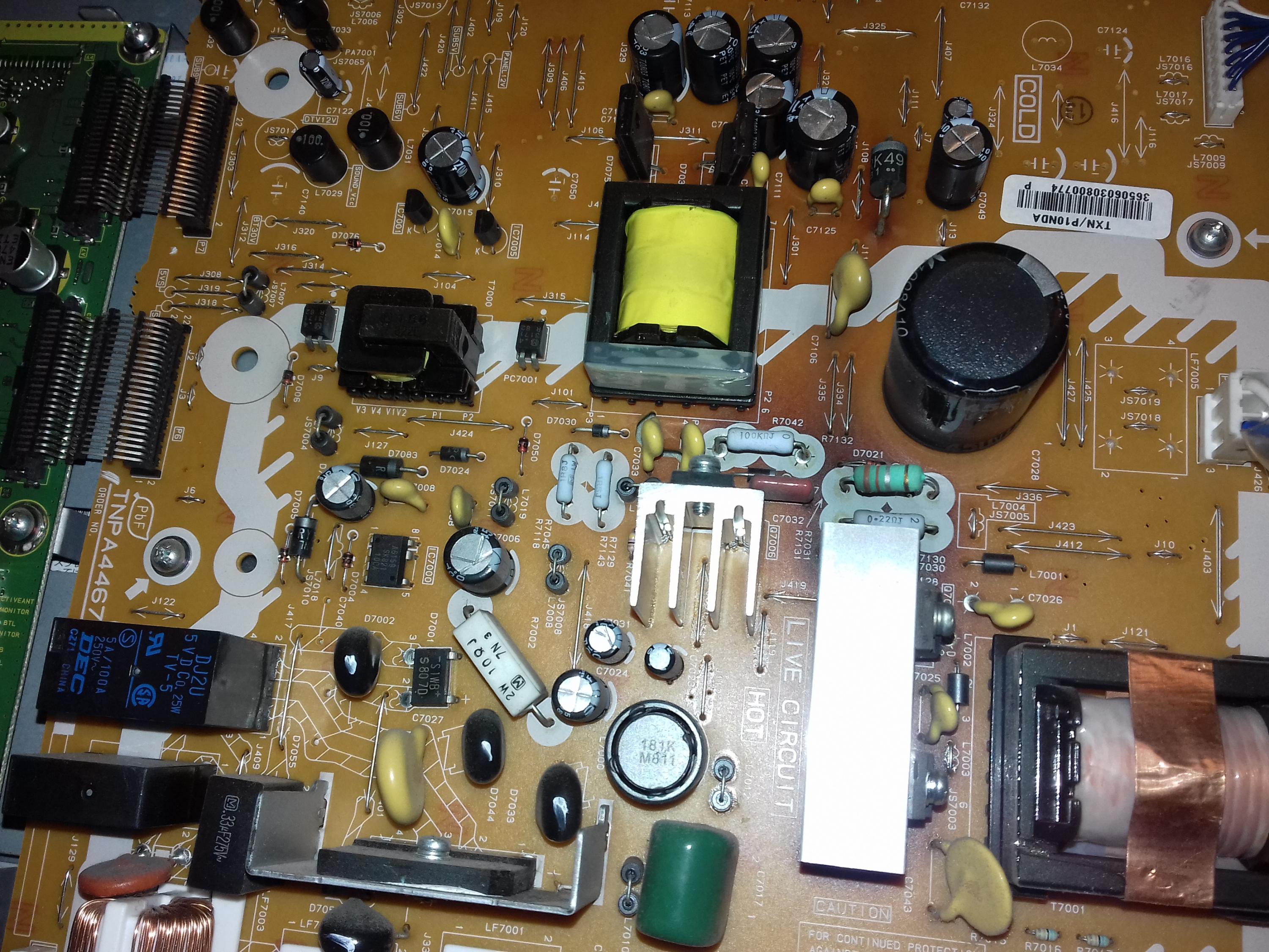

              Can we see the pictures of the whole backside of the TV showing all the boards?
              We also need good clear STRAIGHT SHOT top and bottom side pictures of the main power supply board and the sub-power supply board.
              https://www.badcaps.net/forum/attach...1&d=1512655458
              It that the sub power supply board picture?
              • walkingtv
                • Dec 2017
                • 15

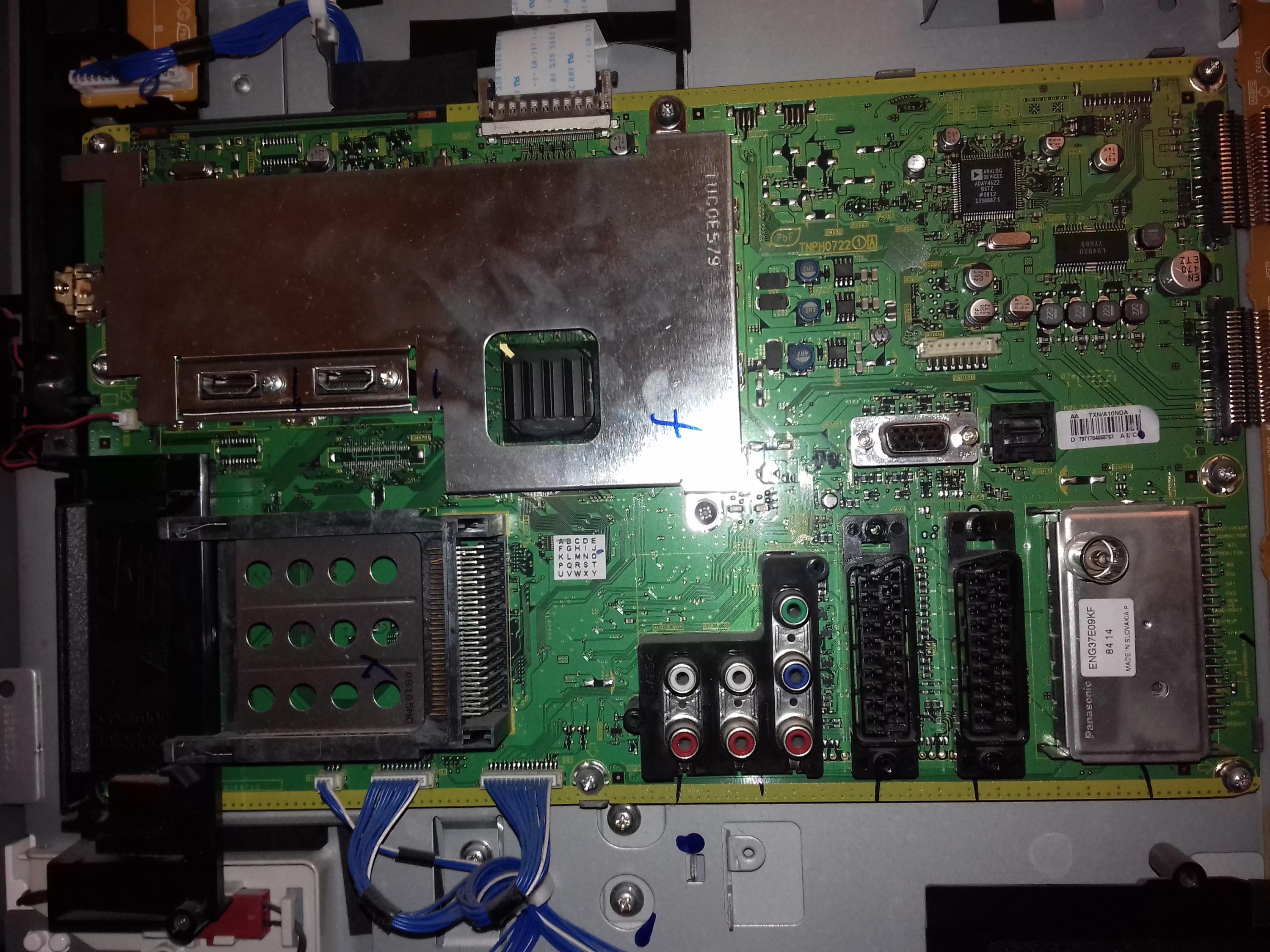

                Ok I've tried to take more clear photos, its night time here though and difficult getting perfect photos. Otherwise I could try again tomorrow during the day light.
                Yes I think that is the sub power supply board picture.
                Here are more photos, I'd tried to photograph what was requested.
                The whole backside of the TV.
                The power supply board close up:
                The backside of the power supply board, two photos:
                The sub power supply board:
                Its backside, two photos:

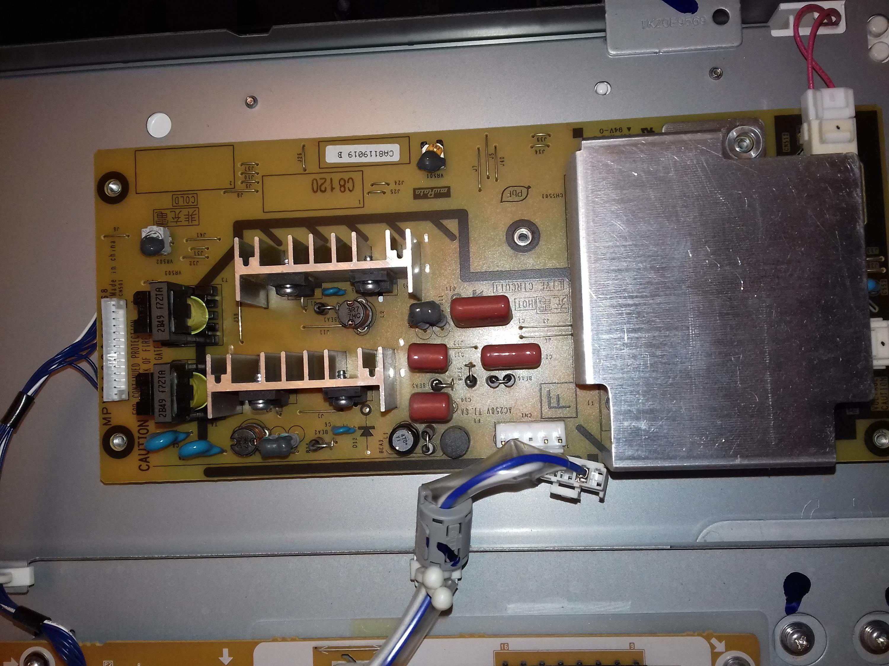

                                yes the fuse must be good as you get some sort of image on the screen if the fuse was bad you would have no image at al,l without a multi meter its going too be hard to find which board/part is faulty. Maybe upload a video of what your seeing on the screen.
                                    looks like you are only getting one side of backlight this is probably why the set is shutting down, i have not worked on one of these sets so not sure if they use two inverter boards.
                                        This set is a older lcd so uses ccfl tubes to light the backlight its usually powered by inverter transformers etc so could be the power supply too it or a bad ccfl tube or faulty transformer as you have not got a multi meter to fault find more, as you say a new tv maybe your best option, you could always sell this faulty tv for spares and get some money back
