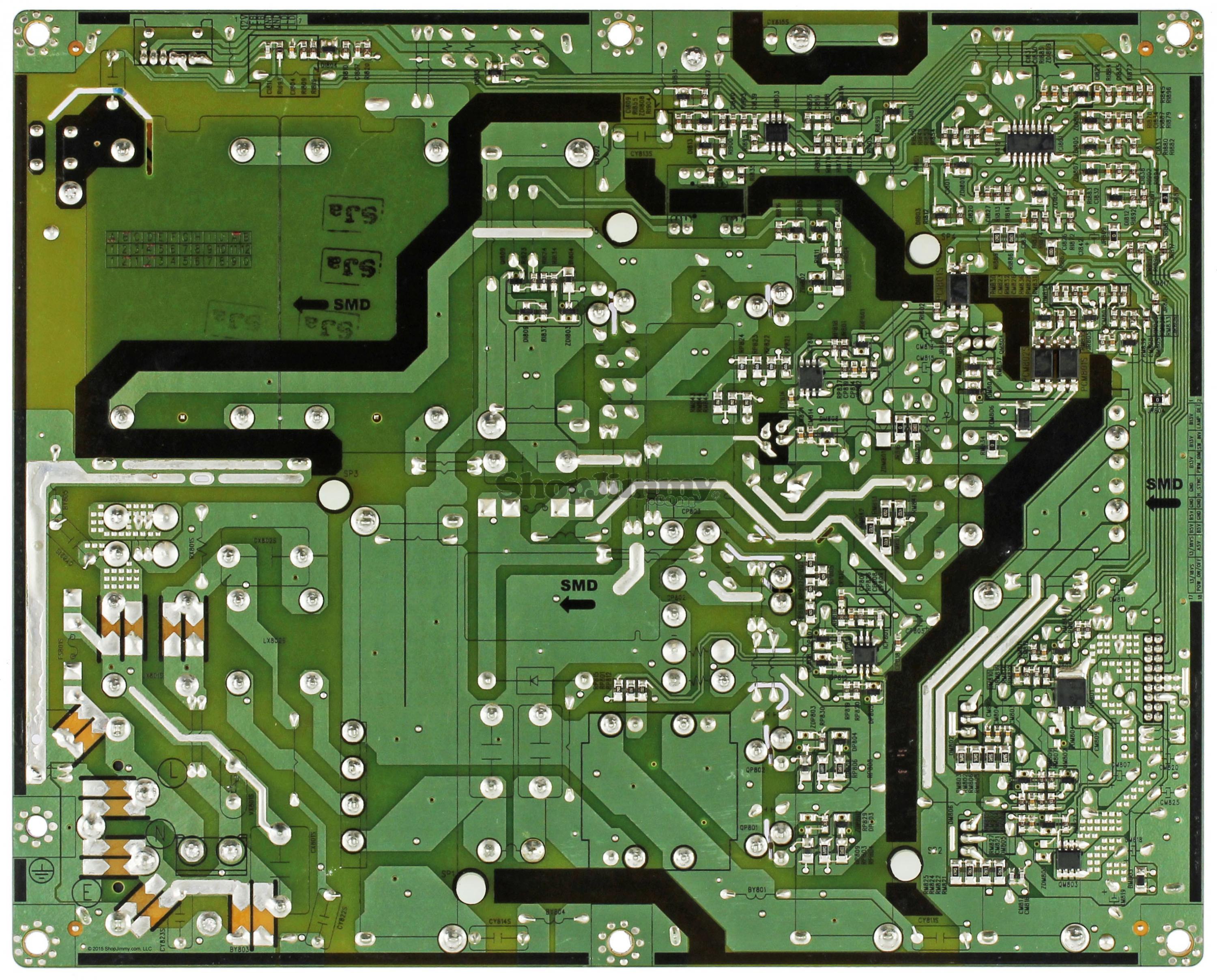

                        BN44-00341B board. This is your board, corrected?
                        The two main filter caps have two exposed legs so you do not need to flip the board over.
                        Pictures provided by shopjimmy.

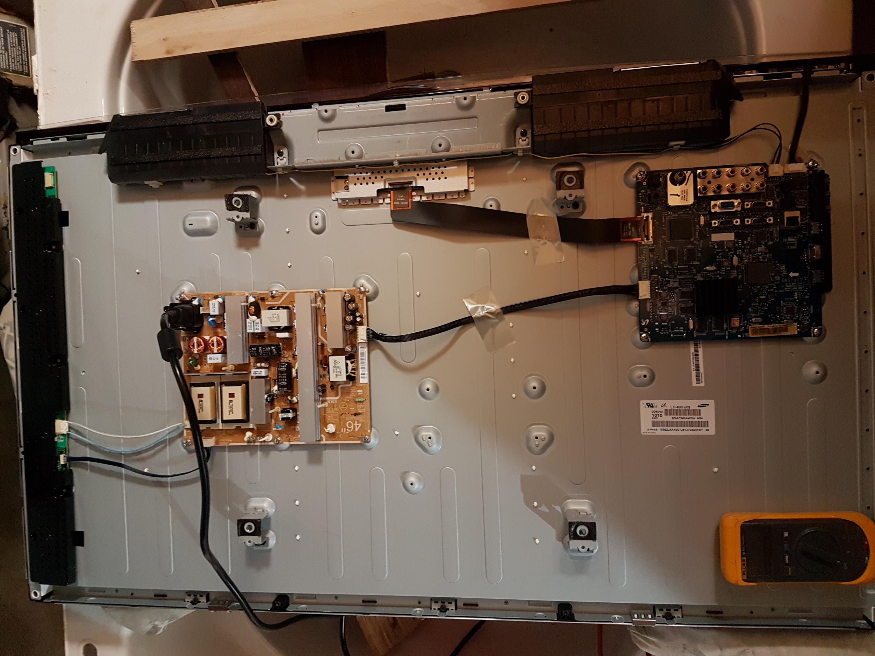

                          Can I see the whole backside of the TV showing all the boards?

                              Re: Samsung LN46C610N1F no backlight
                              This is the boards. Lighting isn't great, sorry.

                                  Your TV uses CCFL not LED.
                                  I just watch the 'tampatec' about fixing similar power supply board by cutting the jumper:
                                  https://www.youtube.com/watch?v=i-jQZ-TQdgU
                                  It is easy fix alright by disconnecting the jumper for the PFC Low Voltage protection circuit, instead of find out what the cause of the problem but taking short cut by cutting the wire for protection.
                                  The real problem is due to low PFC Voltage.
                                  I did the circuit analyzing finding out the reason for low PFC Voltage (360V instead of 380~400VDC) is due to bad resistor network in the PFC feedback circuit.
                                  If you look at the pictures of the board, you will see that shopjimmy solder the JP852 back together and fix the PFC circuit.
