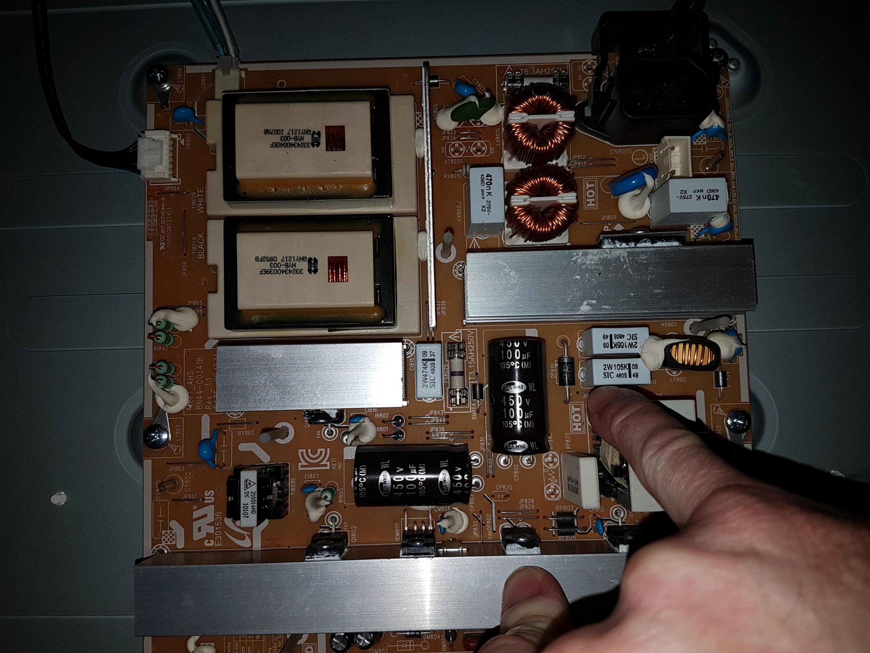

Re: Samsung LN46C610N1F no backlight
You can run the board without CP820 in place just long enough to see if the Boosted Voltage is present on the main cap or not.
