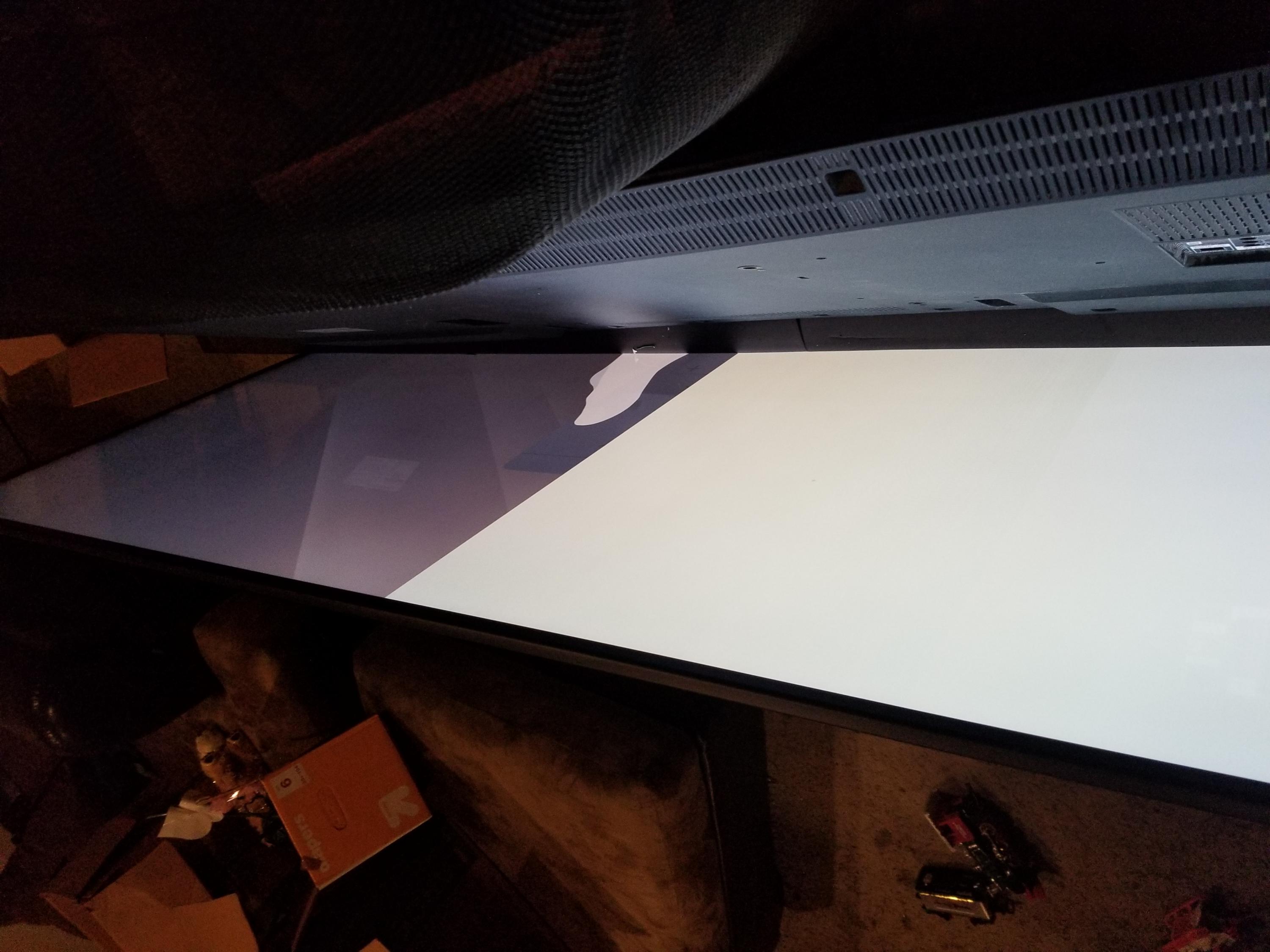

    Sony XBR75X850C no picture backlights on
    Received this from somebody and this is an interesting one.
    By mishal symptoms were no picture no backlight and a flashing Amber and green light upon start up . Read up on the Internet about Sony and forced usb updates.
    . So I did that And now I get back lights but still no picture. Upon inspection I notice that some of the voltage regulators and inductor coils are not putting out voltage on tcon. It would appear that as soon as I disconnect one of the 4 flat ribbons into the panel from the T con I lose my 3.3 volt . Is this some kind of a passive system where all cables need to be connected to create a closed loop circuit back to the feedback system of the tcon? I can only speculate that either this is a failure of the tcon board or panel.

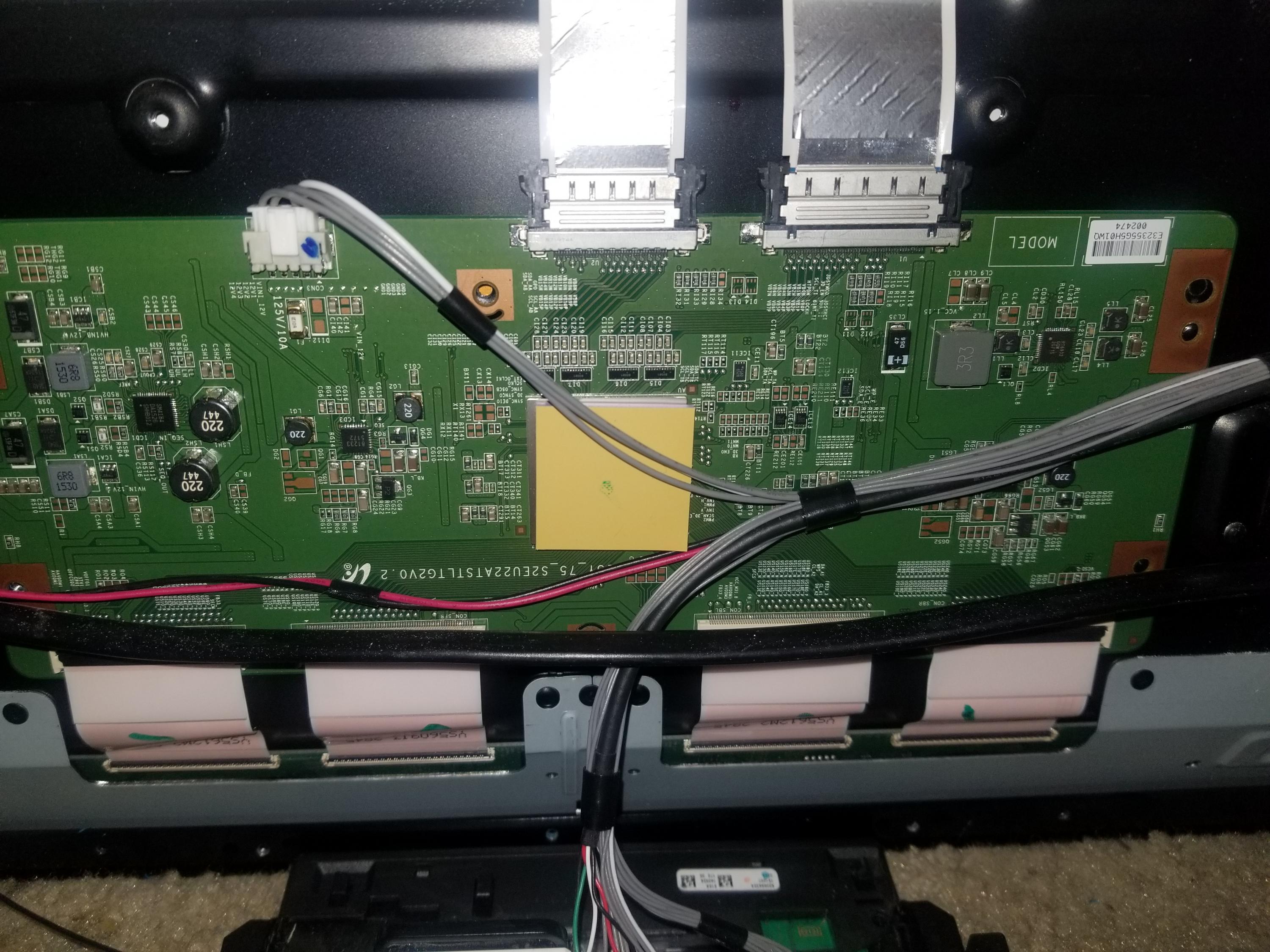

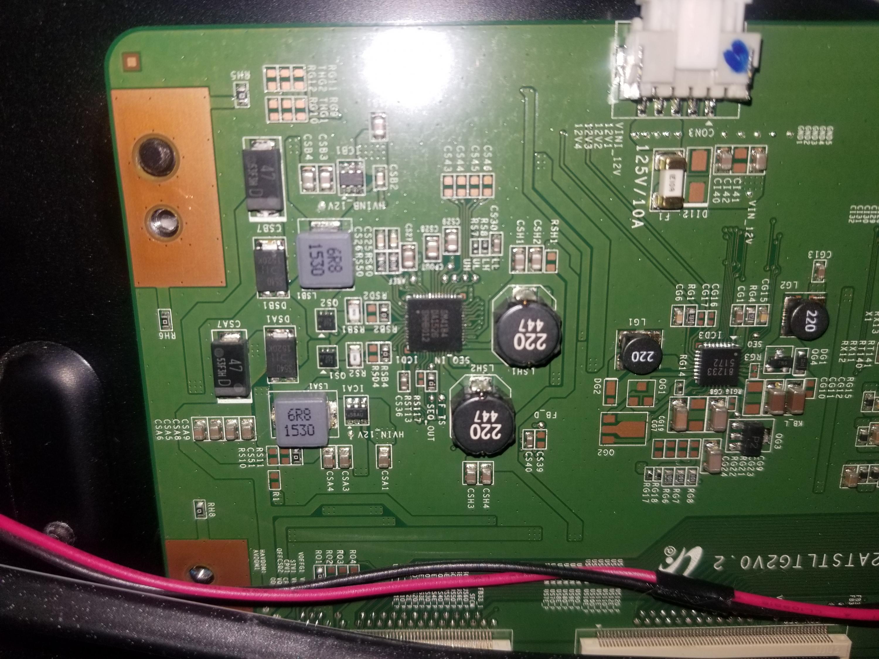

    Re: Sony XBR75X850C no picture backlights on
    Here's pics. CSA6 thru CSA9 go short with far right ribbon to panel attached. Without it attached about 1.6k ohm.
          Ok. More research shows if you power up tv w/o tcon connected, automatic flashing green and amber status light. Meaning eeprom lost panel ID configuration. Weird system..this requires a sub update every time. Going blind update Because you will not see what is happening on the screen because it's completely dead even back lights are out and no 12v to tcon. After about an hour the update will finish in allow the back lights to come on in supply 12 V to tcon. This will happen every time you disconnect the tcon in power up the TV
              Well you guys are right as soon as I plug in the far right cable to the panel I immediately get a short circuit across the four M LCC capacitors off the DC converter shown in the previous pic . What I did is I covered up with tape the 16 V drive on the right side. I immediately noticed the short was gone upon inspection of testing on the MLCC's. Then powered up suddenly I noticed all tcon voltages came back and I have a perfect left side but dead right side. So I was correct this system requires a full loop back between left to right in order to power up tcon voltages. With the data drive going to the full left and right side of the panel you can disconnect the VCC to either side and you will still get a picture. Only if all data drive output signals and feedbacks are registered being connected it will allow the T con to do a full power up regard less if one or other side 16 V VCC is connected or not
              Unfortunately chock this one up to a shorted panel. What a shame. Such a nice Sony 75 inch 4k too
                The white blob is just background
                    OK got into this thing further and found a shorted M LCC capacitor at location CSA191. This runs the 1st ribbon driver on 4th board over on FRC. Replaced shorted M LCC and short when a way that was showing up on the tcon. However upon powering up I still have no picture some of the low voltages like the 16 volt and others do not want to come up on tcon. I cannot seem to get them to come up even thou the old board for some reason I had to heat up in order for the voltages to come up to show the good side of the panel working. Received new tcon a and same issue. Panel is manufactured by Samsung and so is the tcon board. My question is do all ribbon connections need to be made in order for a loopback feedback back to the tcon to power up other voltages? As anyone ever heard of this in case I might still have some problem with the LCD panel even know everything seems to test good going back to tcon board now.
                    Only voltage present is 1.3v running main processor. VCOM ,VCC, VREF, AVDD, HVDD, And all other voltages dead.
                                The four caps are the VCC output on the tcon. Of course now that I removed the short still no outputs on tcon. With old tcon I covered up the VCC output on the right panel ribbon and was able to achieve voltages and half a picture only after I heated up the tcon around the DC converter IC.
                                I'm not sure of panel model but I'll find out later when I get home.
                                The VCC is what was shorted on right side of panel.

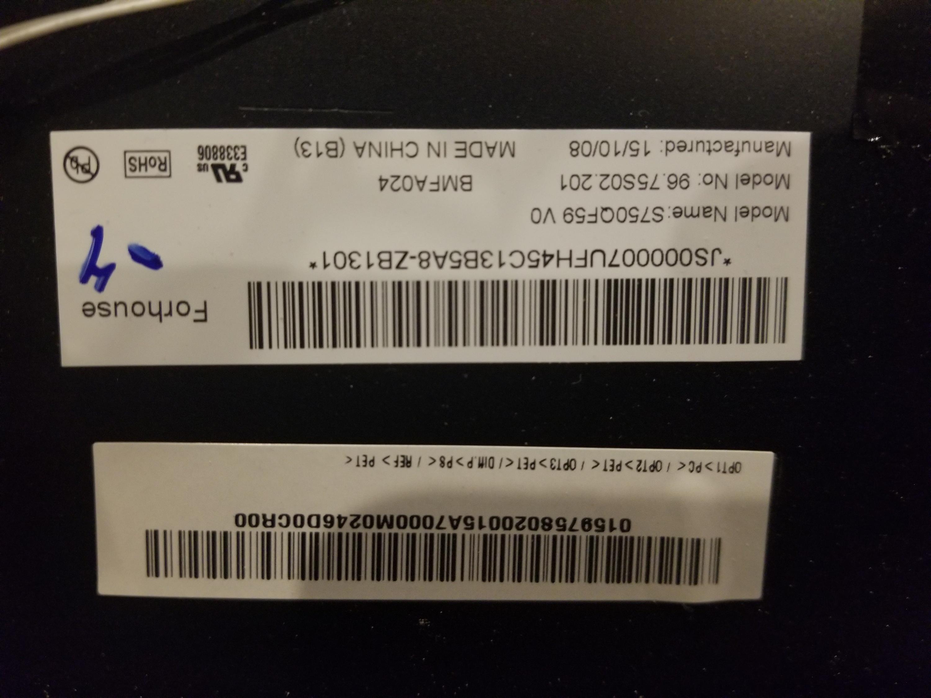

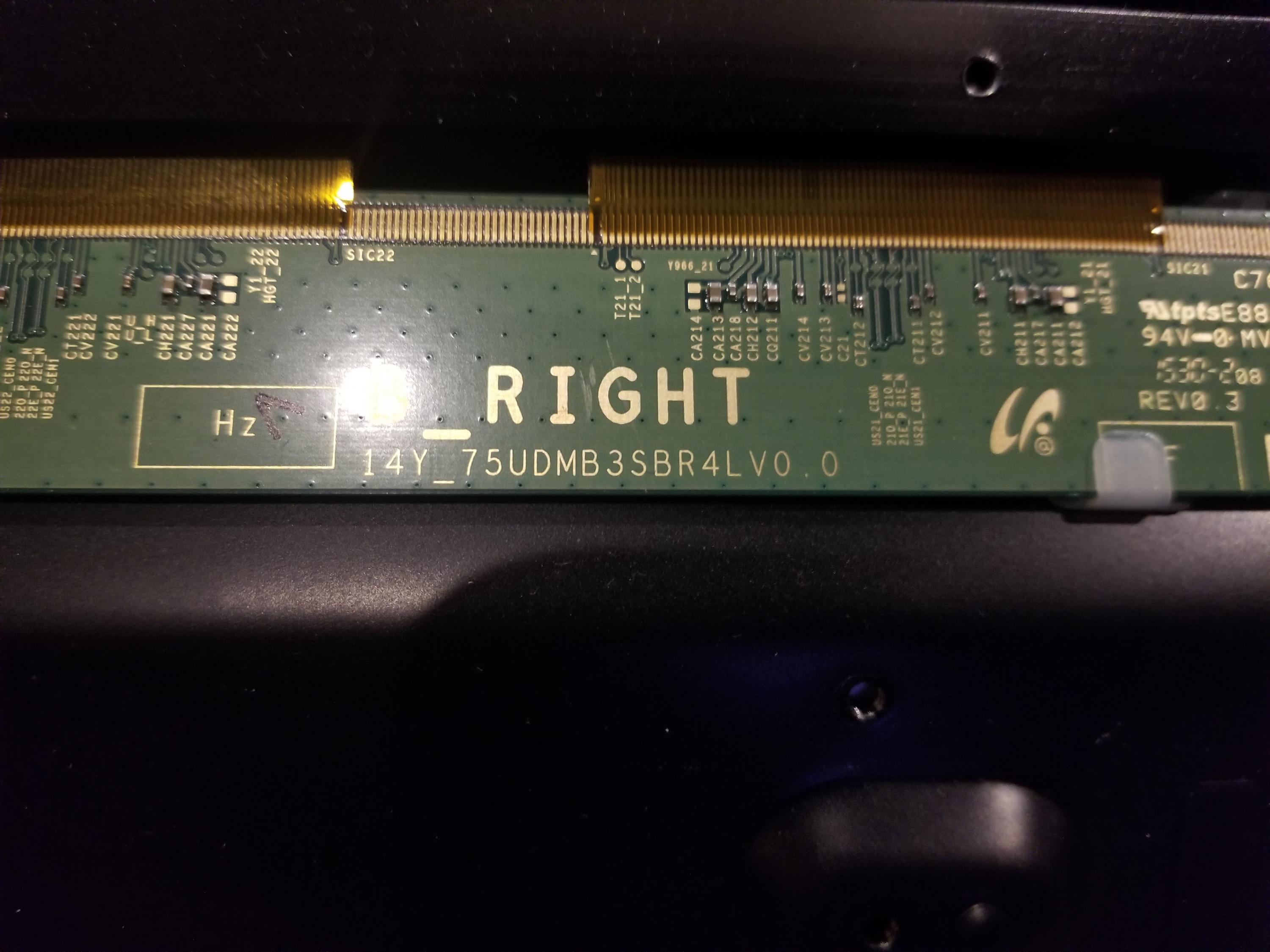

                                  Ok. Panel model
                                  • freakaftr8
                                    • Oct 2012
                                    • 3743
                                    Sorry for the upside down pic
                                        The HVDD btw was the area shorted on the right side originally. On FRC board. This is the voltage drive for the column drivers. One capacitor was shorted like I mentioned previously.
                                        I just never seen a tcon that won't produce voltage if panel left disconnected. That is if what is really happening here if I didn't receive another defective tcon.
