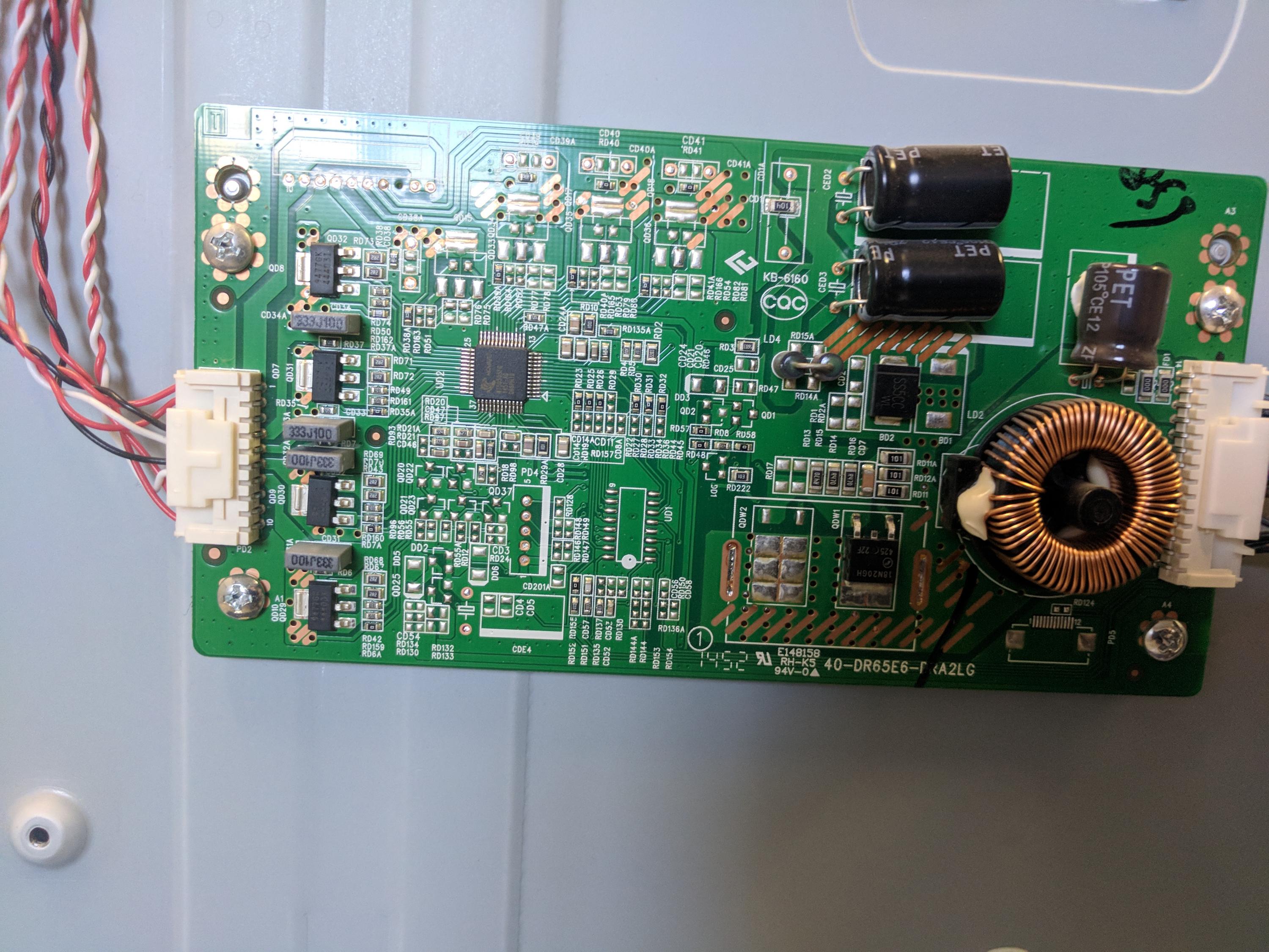

    Hello all,
    I have a sanyo fw65d25t that I picked up from someone who knows how a screw driver works. He said the picture just would take longer and longer to come on and then one day it stopped. Well he tried to look at and managed to get the back cover off and wreck the power switch button.
    So the indicator light comes on when its plugged in, I can't get it to turn on with a universal remote. He did say the back-light still worked just no picture. I'm wondering if their is a way to solder some jumper wires some place to turn it on with a switch?
    Or do I have another issue? I did check all the caps and voltage regs. The voltage reg on the FRC board that is 1117a does not have conductivity to ground at all on any of the 3 pins? Nor does the top tab/pin.
    Then followed up with this.

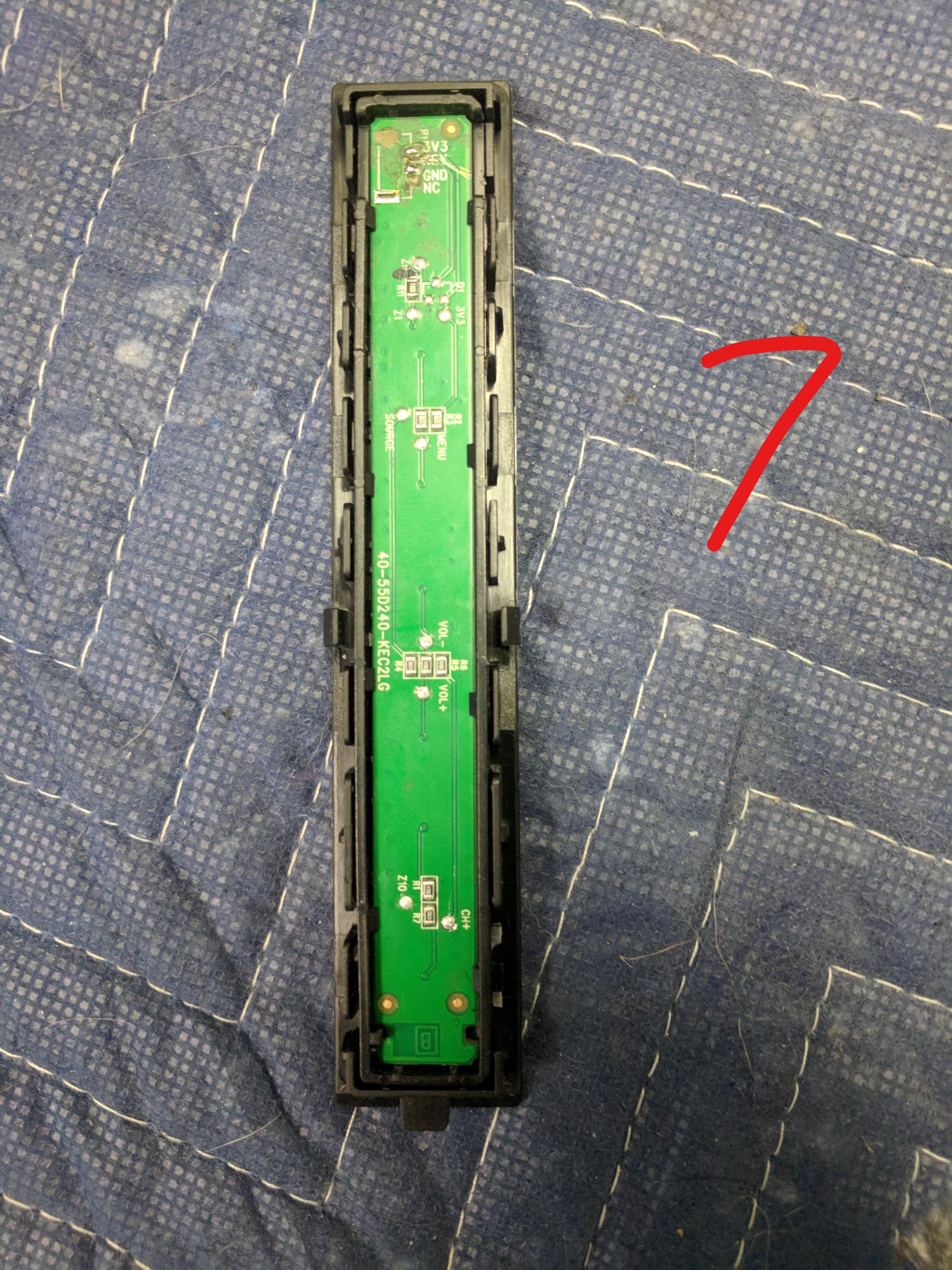

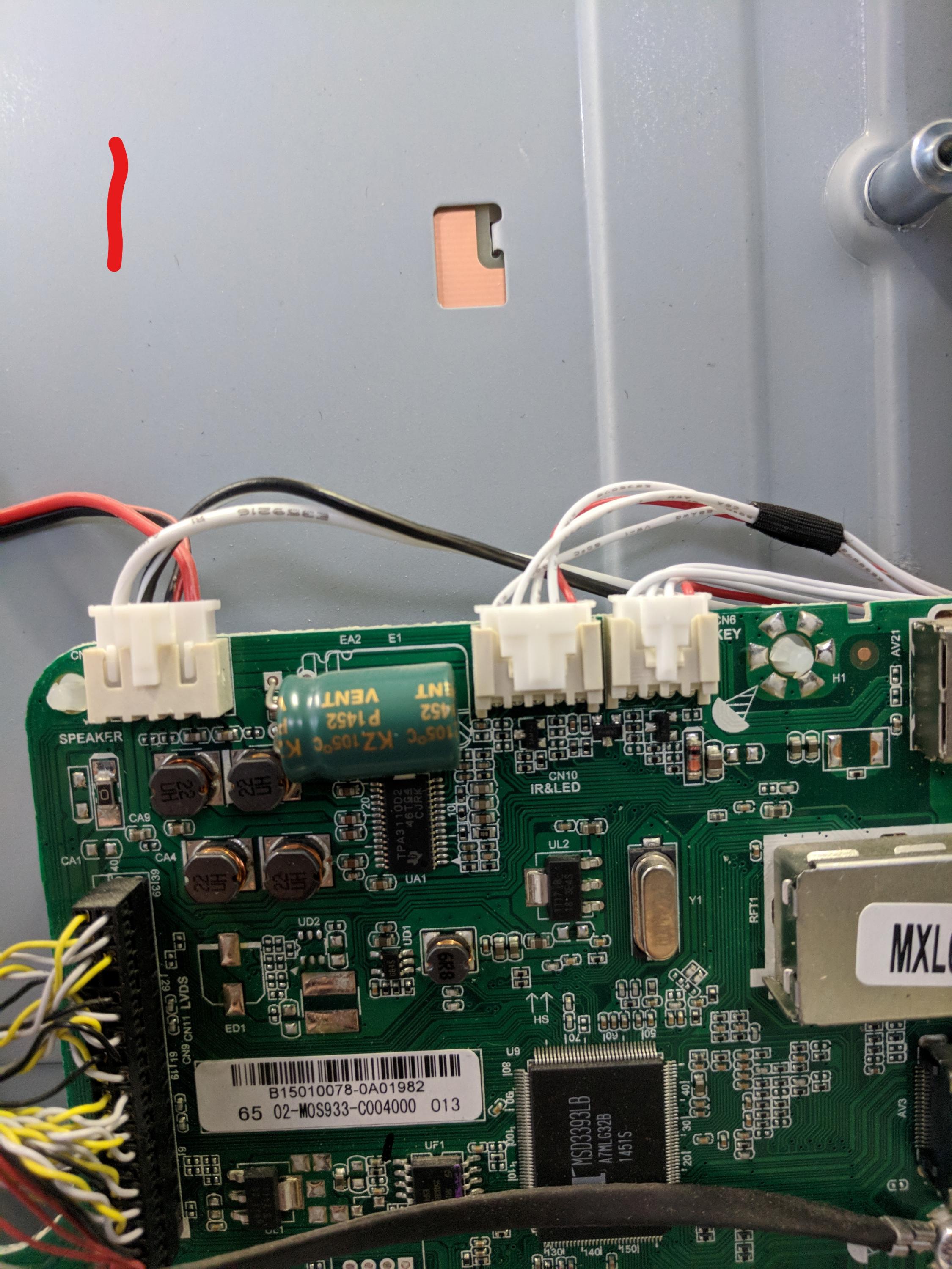

    Ok so in picture 1 is the IR&LED CON10 and the Key CN6. The pin voltages are as follows.
    *PIC1
    *CN10 goes to IR&LED board
    L to R
    3.2v, 3.2v
    3.3v, 3.2v
    GND
    NC - 5.2v
    5.2v, 5.2v
    *CN6 Key
    (Goes to power button asm that the other guy wrecked)
    L to R
    3.2v, 3.2v
    3.3v, 3.2v
    NC - 5.2v
    5.2v, 5.2v

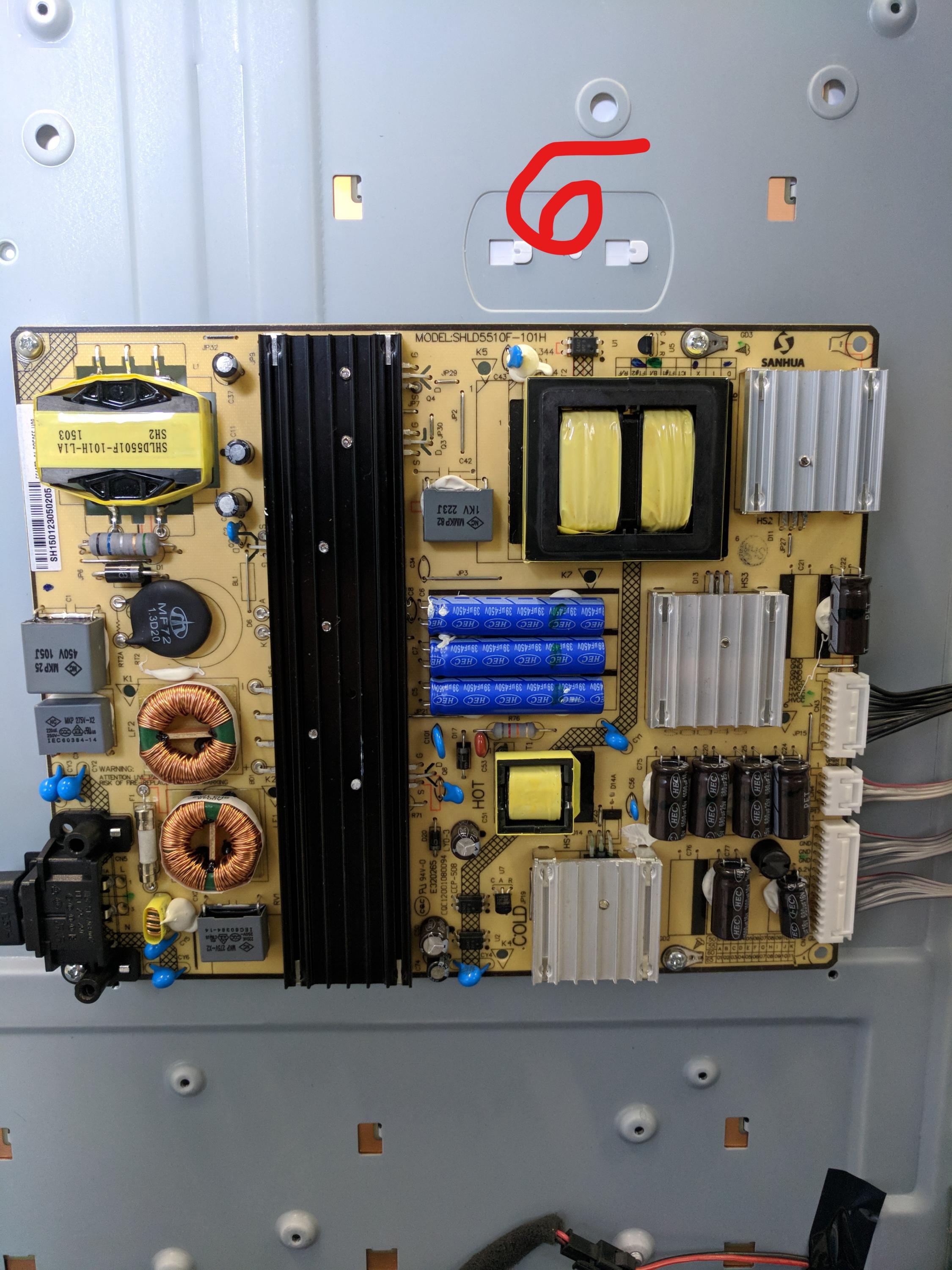

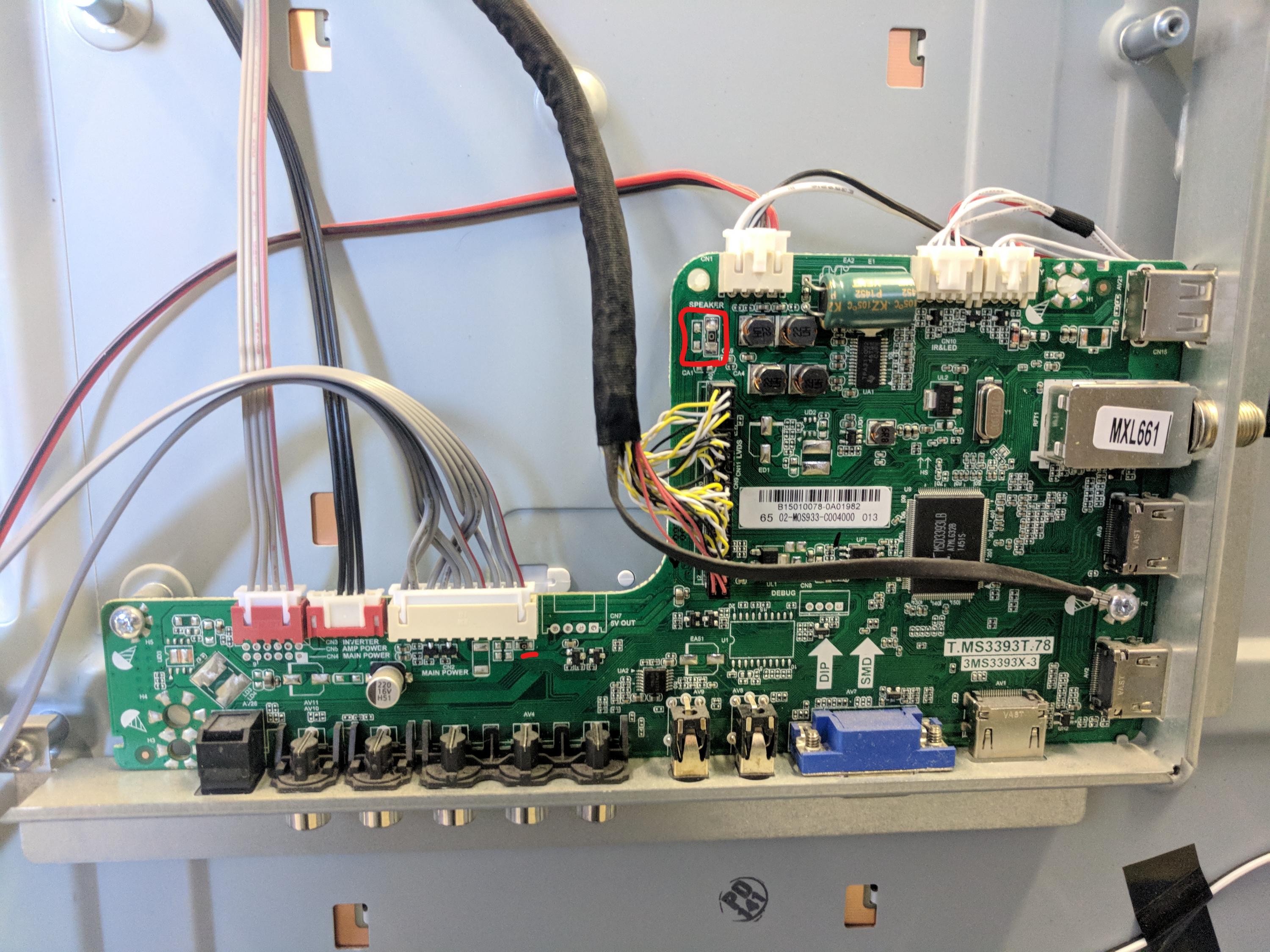

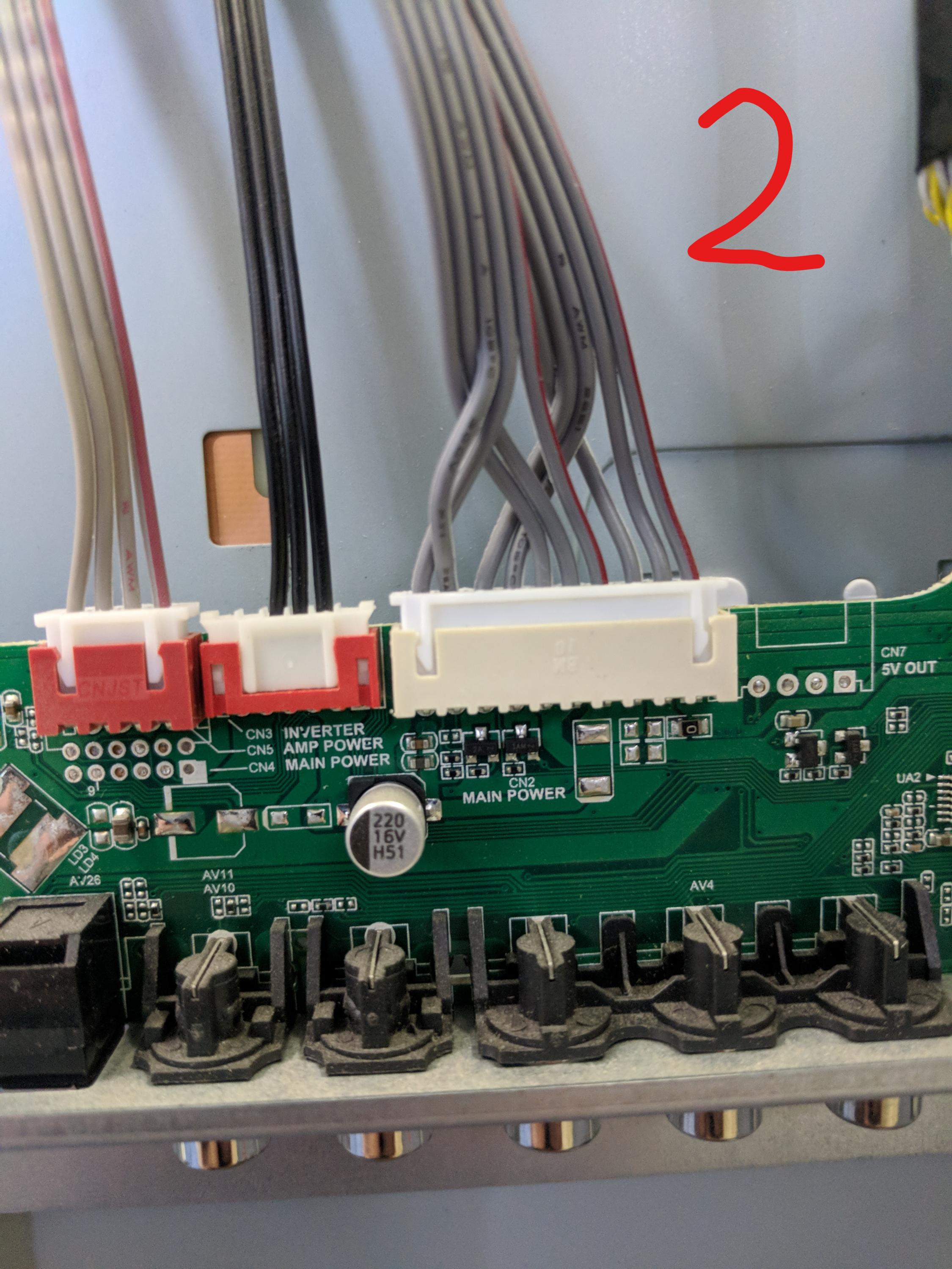

    *Pic 2
    *the first red connector (CN5 AMP PWR)
    L to R
    VR PWR, 12v
    VR PWR, 12v
    GND
    GND
    *Second red connector
    L to R
    55v
    5.2v
    GND
    *Big white connector (CN2 Main PWR)
    L to R
    12v
    GND
    5.2v
    5.2v
    5.2v
    5.2v
    GND
    GND
    4.8v
    5.2v

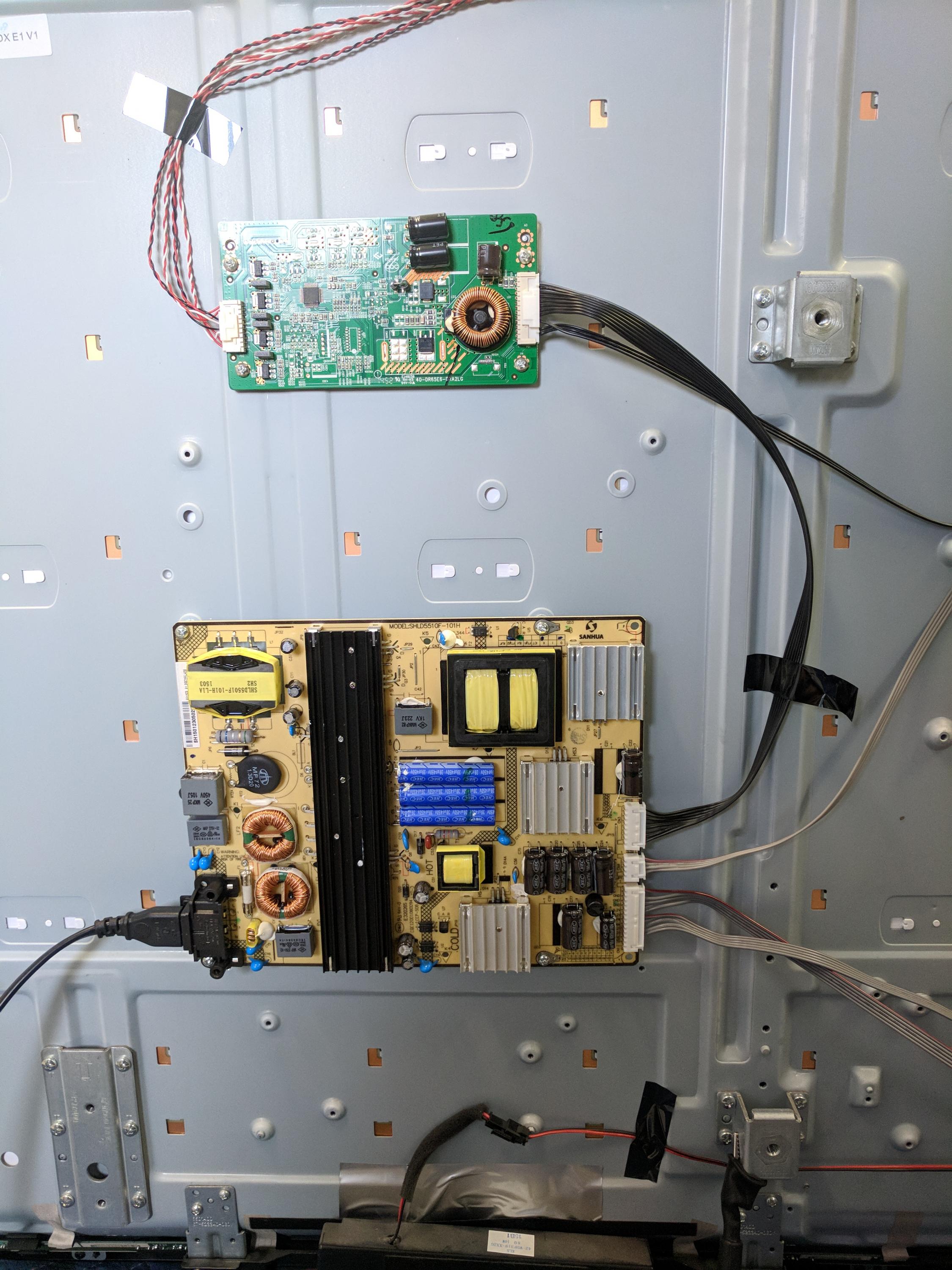

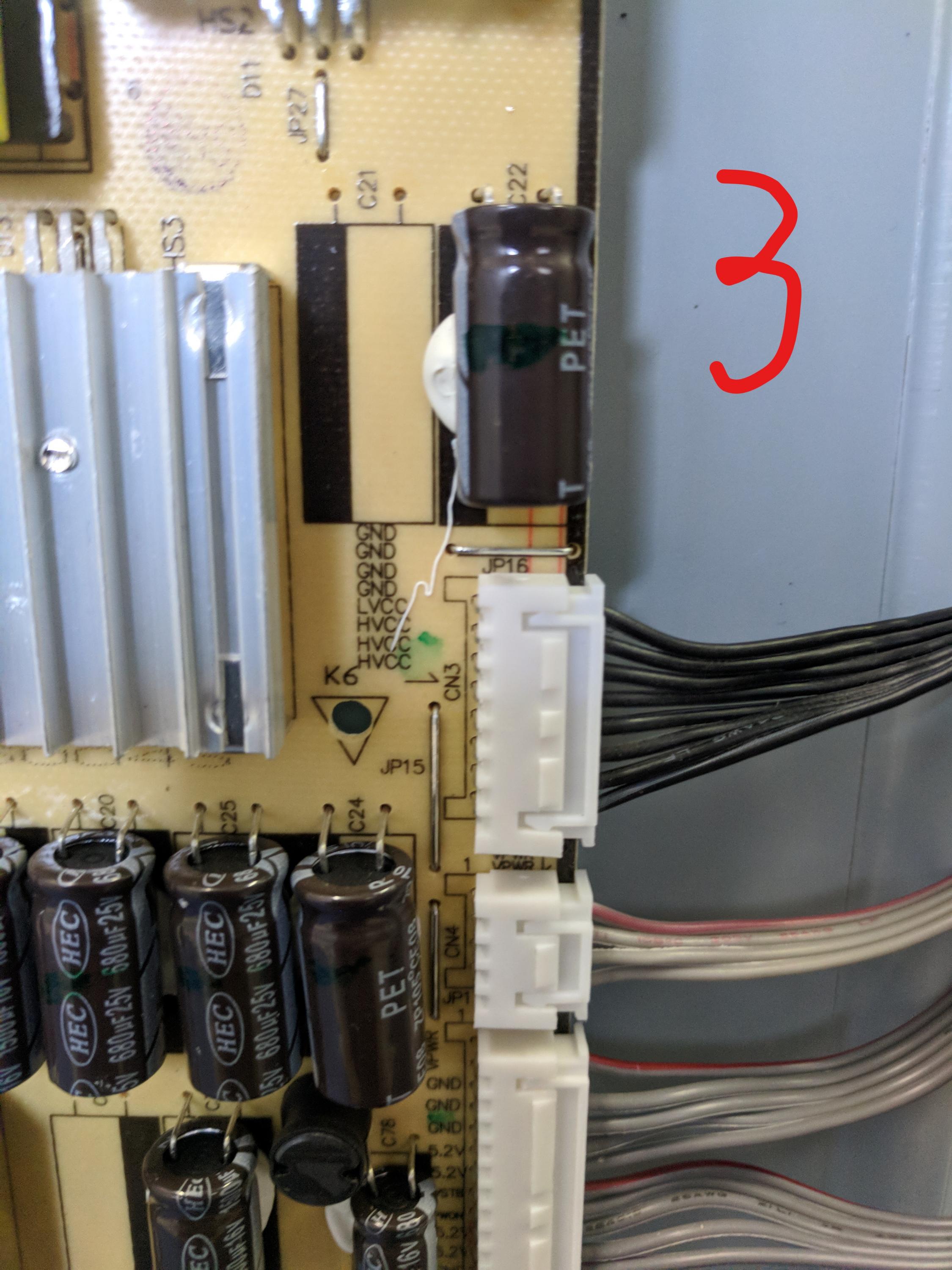

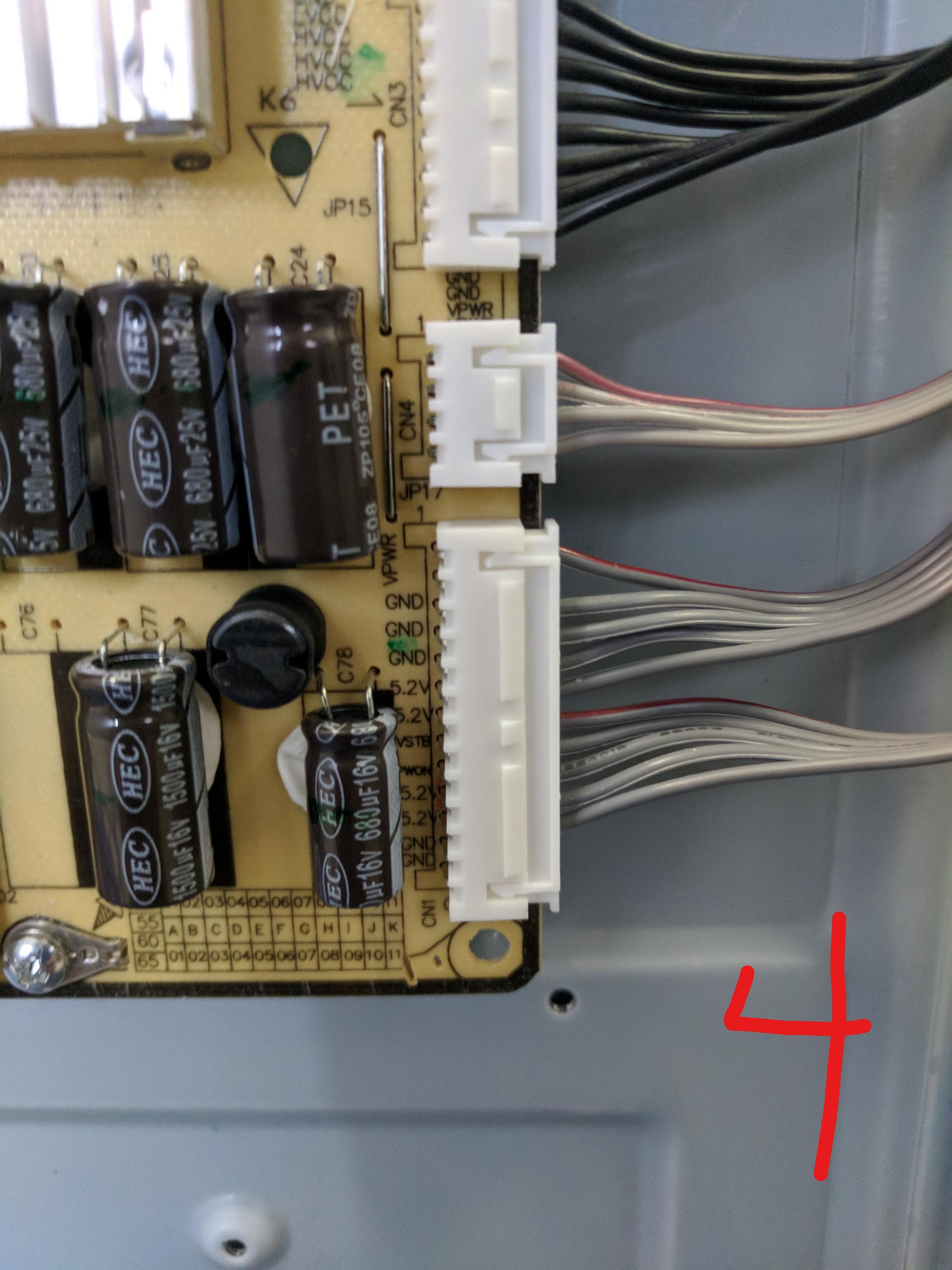

    *Pic 3
    *CN3
    GND
    GND
    GND
    GND
    LVCC - 12v
    HVCC - 55v?
    HVCC - 55v?
    HVCC - 55v?

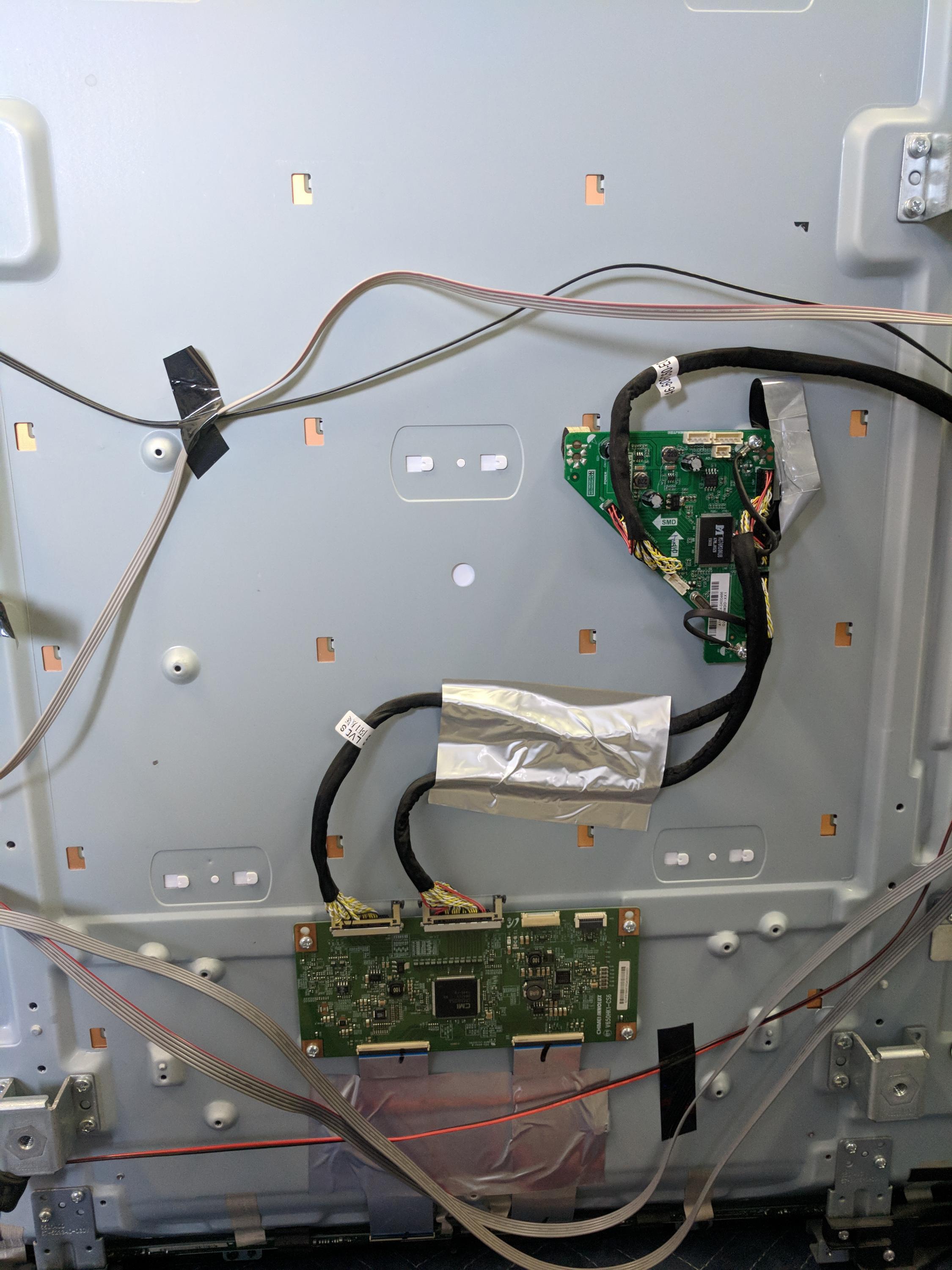

    *Pic 4
    *CN4
    GND
    GND
    V PWR - 12v
    V PWR - 12v
    *CN1
    VR PWR - 12V
    VR PWR - 12V
    GND
    GND
    GND
    5.2V - 5.2V
    5.2V - 5.2V
    VSTB - 5.2V
    PWON - 4.8V
    5.2V - 5.2V
    5.2V - 5.2V
    GND
    GND

    Power supply

    Key/PWR button asm

    Re: Sanyo FW65D25T won't turn on, broken pwr button

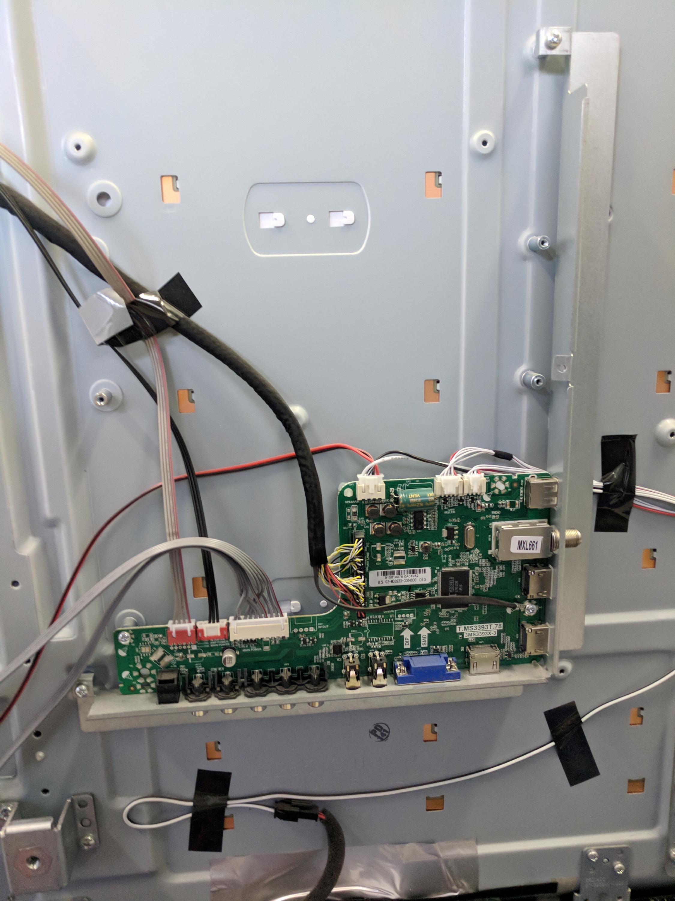

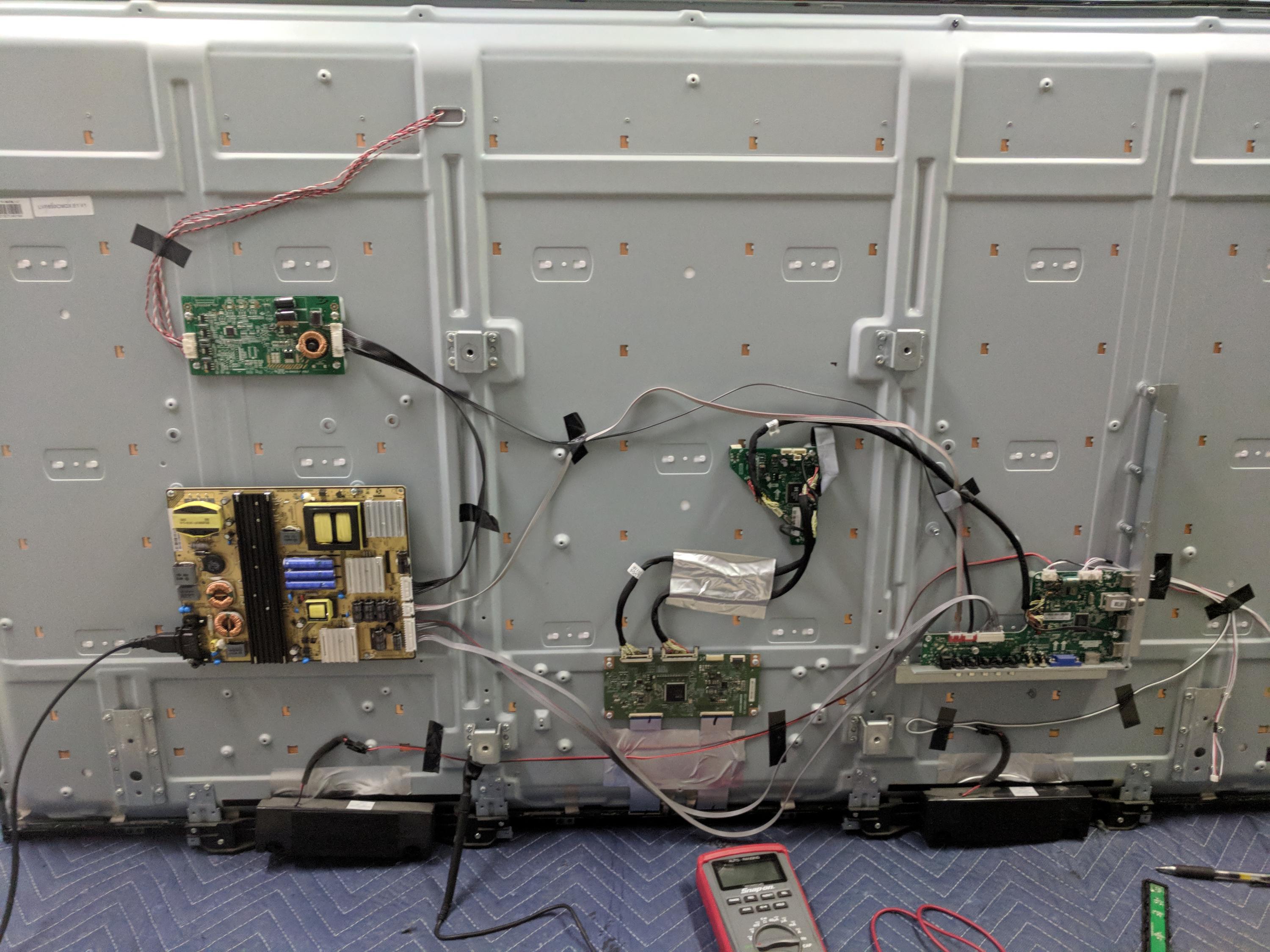

    Can we get the pictures that show the WHOLE backside of the TV?
    'PWON - 4.8V'
    So far you do have PWON (PS-ON) signal to turn on the rest of the power supplies but I cannot see other command signals to turn on the backlights and backlights dimming.
    So at this point, you do have backlights, correct?
    Do you have 12VDC on both ends of the SMD fuse on that FRC/T-CON board?

        "PWON - 4.8V" Right now your TV is stuck in the POWER ON mode and you are getting the switched power supplies outputs.
        So basically you should have backlights right now if the command signals for backlights are present.

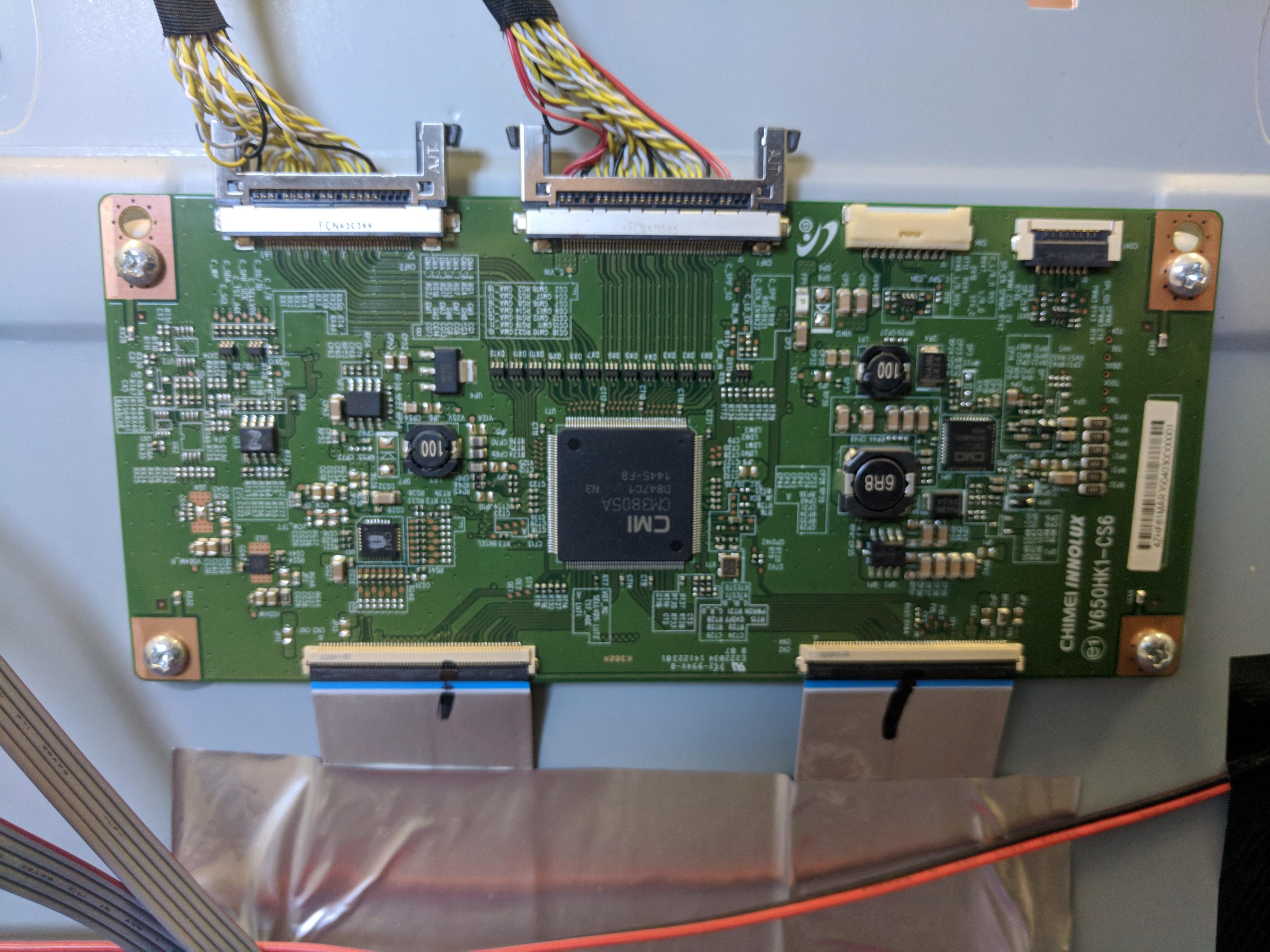

          I don't have back-lights on or anything. Indicator light is still on. I can't get the light to go out no matter what I do with universal remote. (supposed to turn TV on to program remote. I have entered every code for TV and tried to turn TV on with no luck.
          On the board with the video inputs Main board? The few fuses I seen tested good 5.2v on both ends or 12v on both ends. The Fuse on the FRC board or in pic 1 the triangle board. Has a fuse but no power either end. Also the 3 little red wires on the LVCS input connector have no voltage? I thought maybe they should since they are red?
            Here are some more pics.
            Also the fuses I highlighted in the pic are the ones I found and have same voltage on each end.

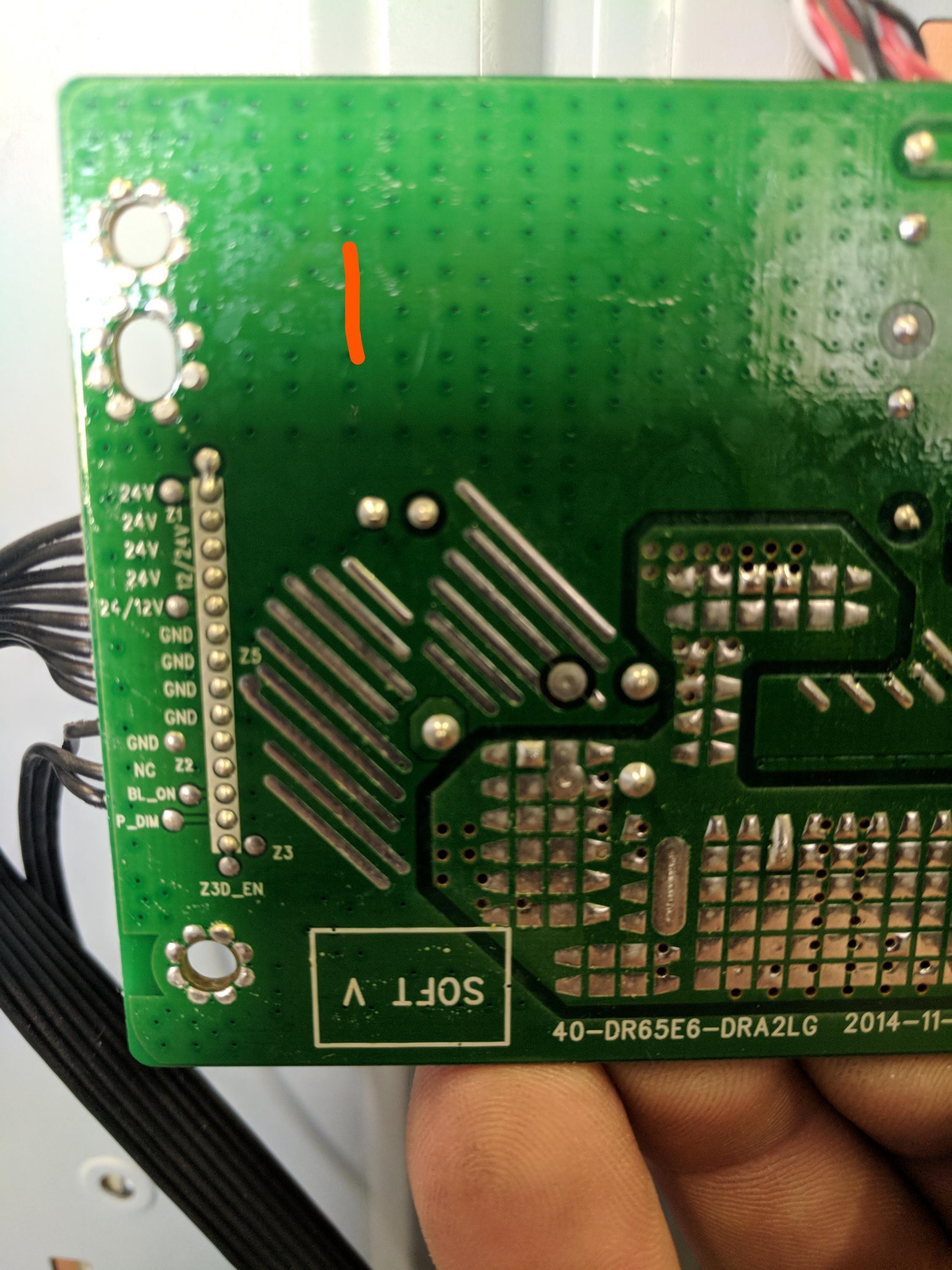

                  Are there any printing on the bottom side of the board to indicate what the pins are for?

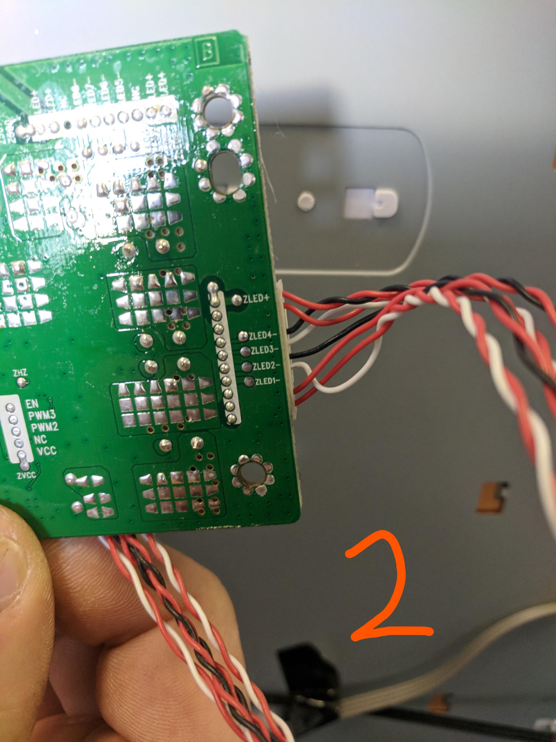

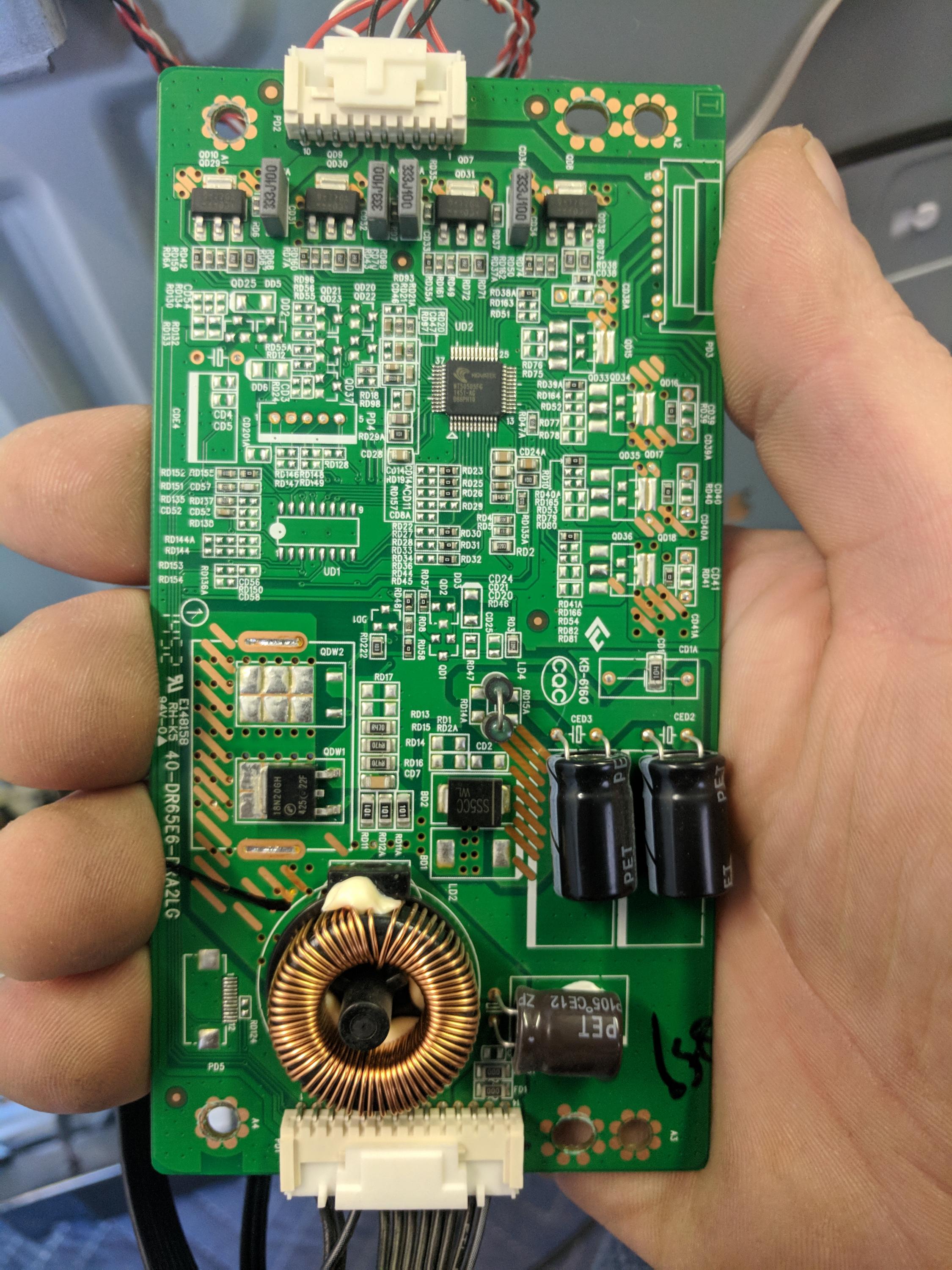

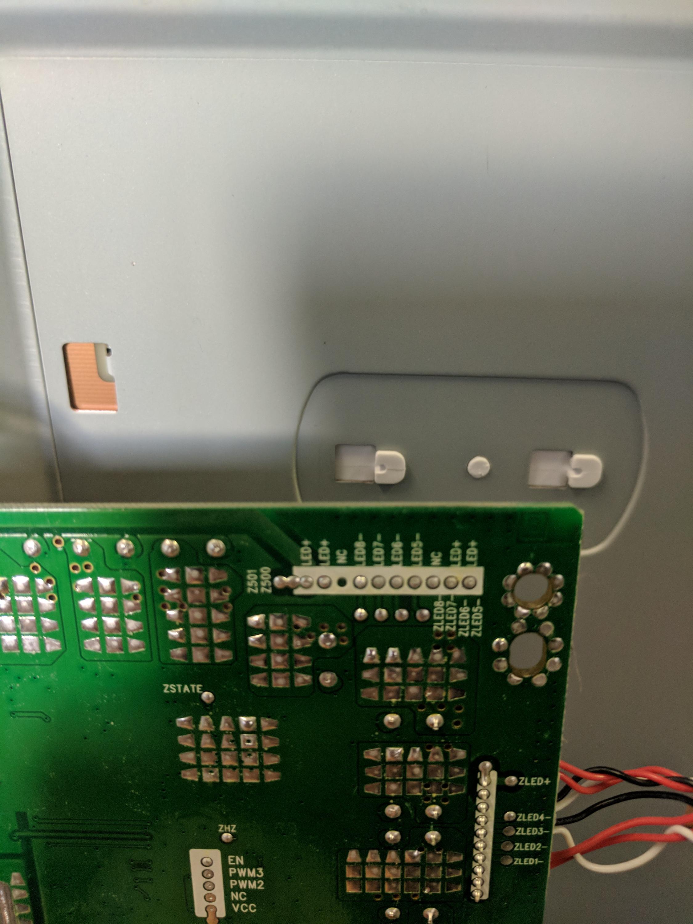

                    Ok so in pic 1
                    24v 55v
                    24v 55v
                    24v 55v
                    24v 55v
                    24/12v 12v
                    GND
                    GND
                    GND
                    GND
                    GND
                    NC
                    BL_ON 55v
                    P_DIM 5.2v
                    Pic 2 I have 55v at the 4 red wires ZLED+

                    I can't power the TV on I can only plug into the wall and the stand by led comes on. So when I do that I get 55v at CED2

                      https://www.badcaps.net/forum/attach...2&d=1511541378
                      See above

                            As I indicate, the main board is stuck in the ON condition right now other wise you will not have those Voltage you reported.
                            The 55V boosted Voltage seems low to me for the LEDs to be on, we need to look up the spec sheet of the LCD panel, there is sticker on the back of the LCD panel, what are the numbers.
                            We need to get the backlights to work first so we can see if there is any image on the screen or not.
                            You will have to fix at least two problem: #1 is the backlights, #2 is the power on/off control.

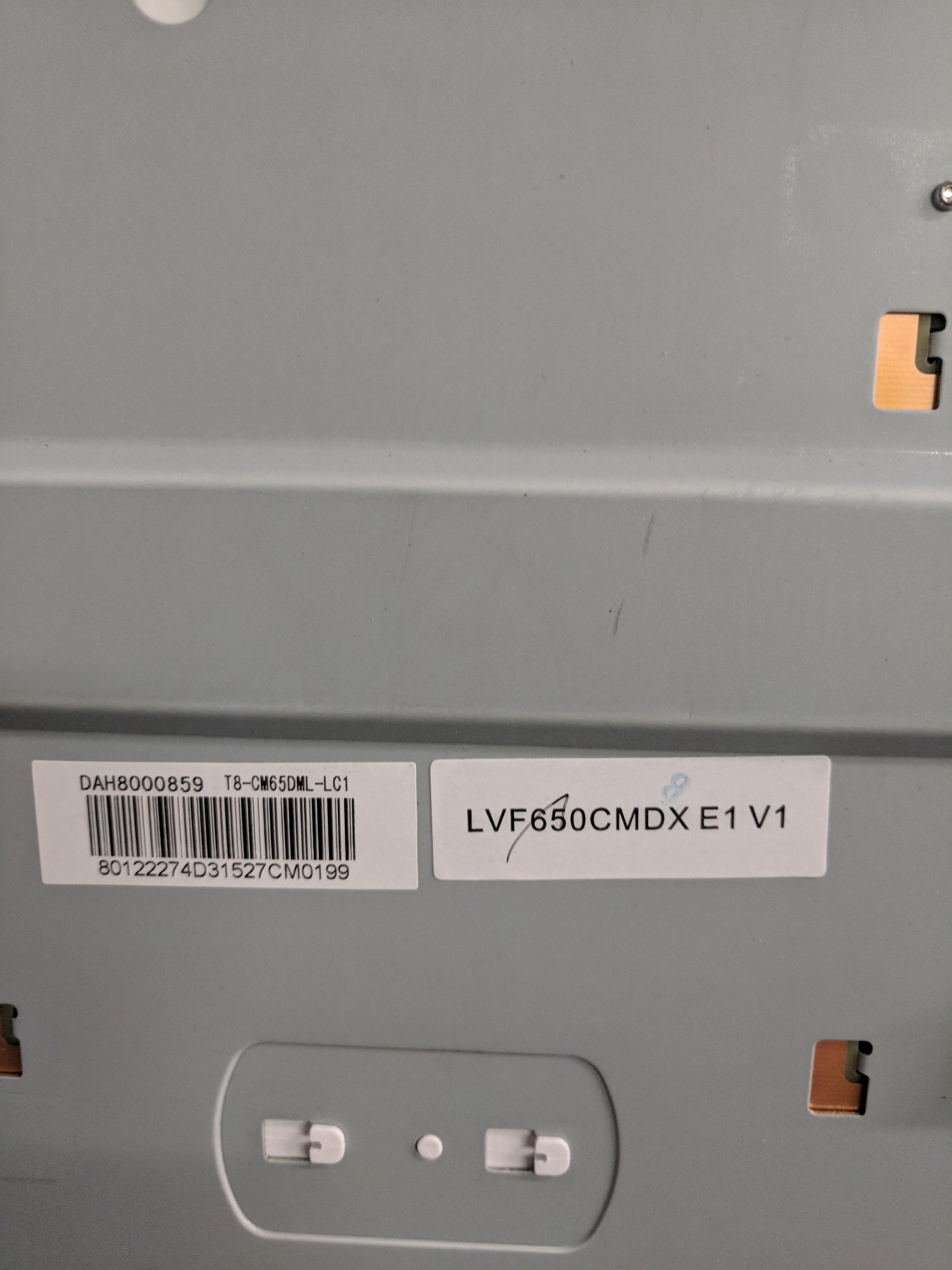

                              I have attached a picture of the numbers that I seen on the back panel.
                              So the tv is stuck in the on position while the stand by light is still on?
                              Also when I plug the tv in I hear a small buzzing noise coming from the power supply board. This buzz goes away when I unplug the connector that feeds the main board and comes right back when I plug back in. I'm guessing the buzz noise is coming from a voltage reg or something to do with main board maybe being stuck in on mode? Or this is totally normal.
                              I also I haven't had luck finding a new button assembly to fix that or will I not need to once we get the backlights on?

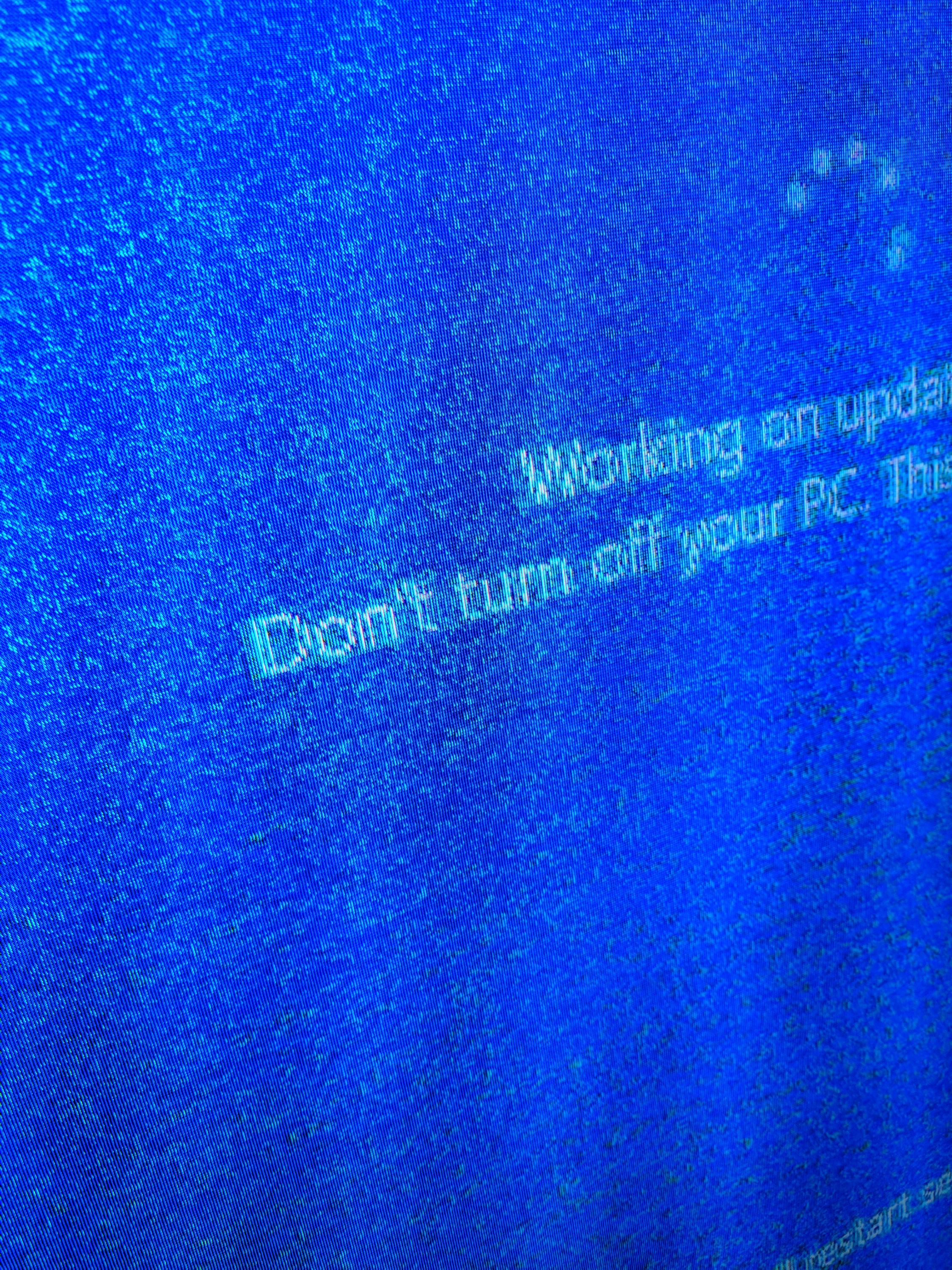

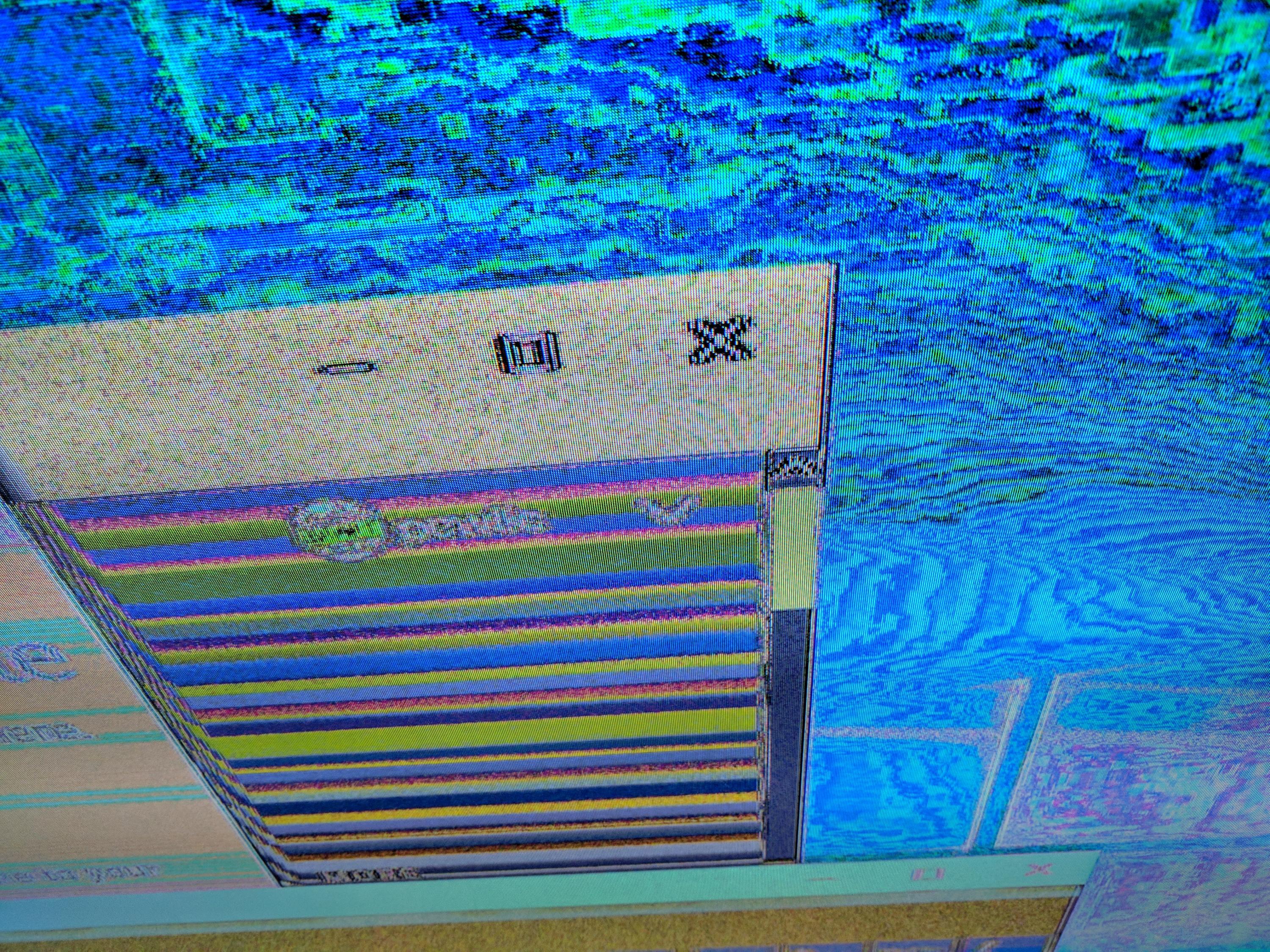

                                    Alright, I replaced the eeprom chip and now the TV will turn on but takes a good 2 seconds for it to come on. This is the picture I get now from it.
