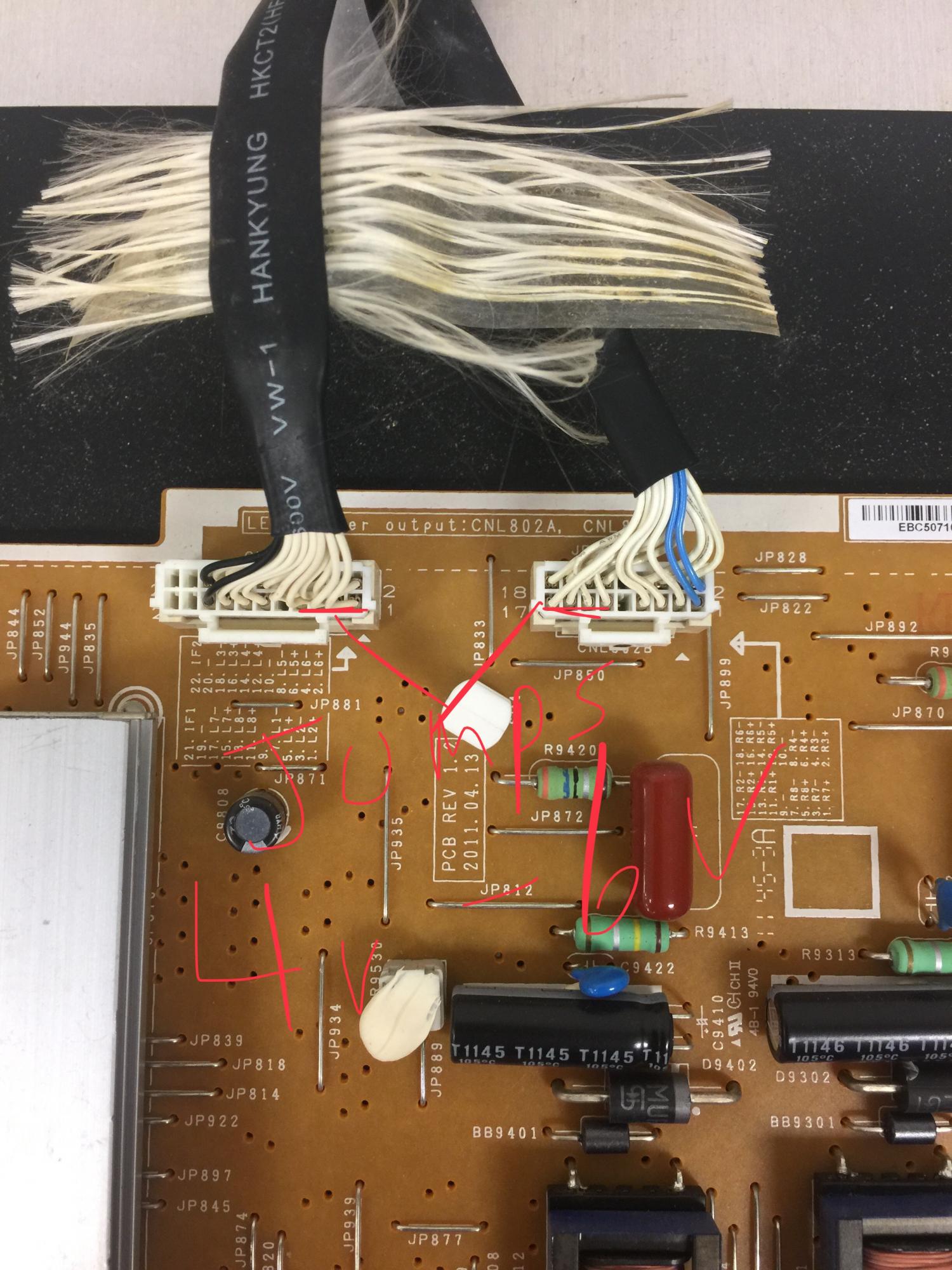

    Hey guys got this TV where it's dark along the very top. Image is still there when testing voltage on the backlight connectors the TV will power cycle upon touching L2+ showing 44v on all except for R1 and R2 and L1 and L2 which jump between 4v and 6v
    Any Ideas on fixing this issue.

    What voltage do you have between the two legs of C9110, C9201, C9310, C9410

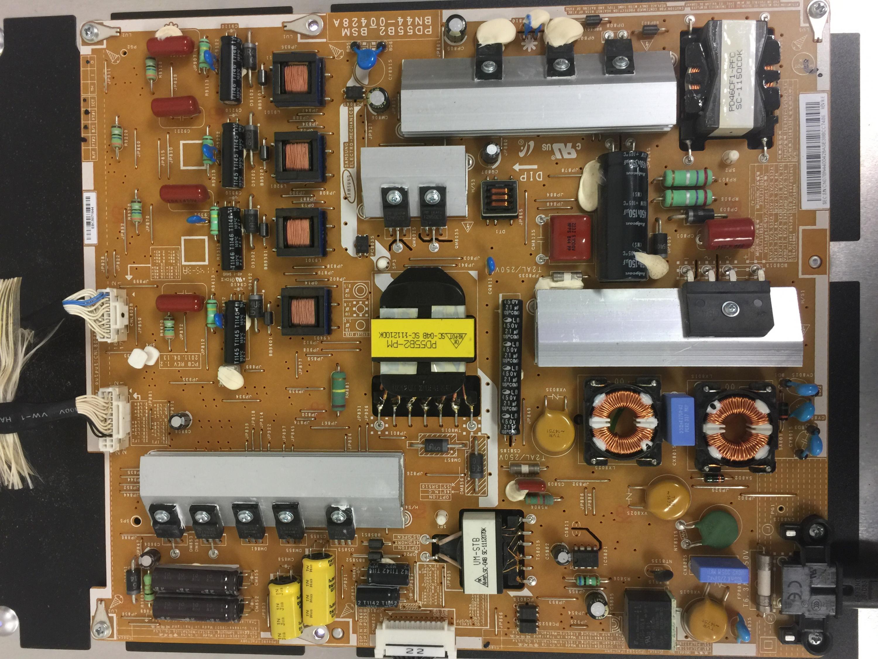

        I look at the boards connections and this is what I see:
        This power supply/LED driver board has:
        4 Boost converter circuits
        4 PWM Controlled MOSFET
        4 Main LED strings:
        R1+ is the Anode of the first LED string that has LED strips R1, R2, L2, L1 connected in series. L1 - is the Cathode return of this LED string.
        R3+ is the Anode of the second LED string that has LED strips R3, R4, L4, L3 connected in series. L3 - is the Cathode return of this LED string.
        R5+ is the Anode of the third LED string that has LED strips R5, R6, L6, L5 connected in series. L5 - is the Cathode return of this LED string.
        R7+ is the Anode of the first LED string that has LED strips R7, R8, L8, L7 connected in series. L7 - is the Cathode return of this LED string.\
        So turn the TV off and keep the meter black probe on the chassis, put red probe on R1+ then turn the TV on watch the meter to see how high it goes up to and then wait 5 seconds to see how low it goes down to. Turn the TV off and then move the red probe to L1 -, turn the TV on and see how high the Voltage goes up too and then wait 5 seconds to see how low it goes down to.
        Repeat the same procedures for
        R3+/L3-
        R5+/L5-
        R7+/L7-

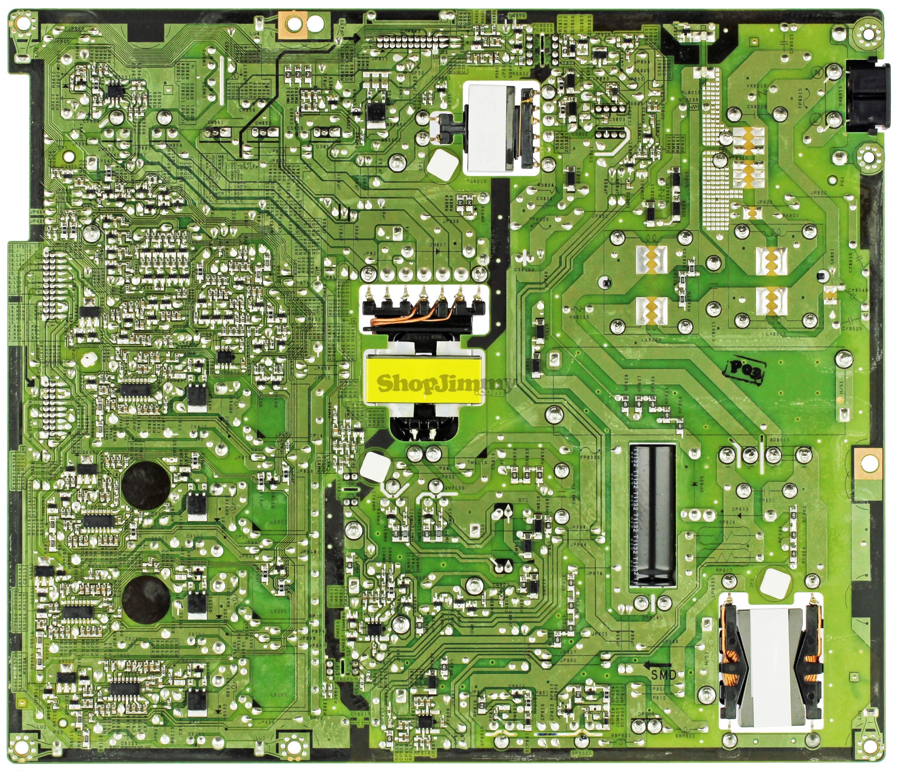

        Pictures provided by shopjimmy.
        http://www.shopjimmy.com/samsung-bn4...pply-unit.htm#

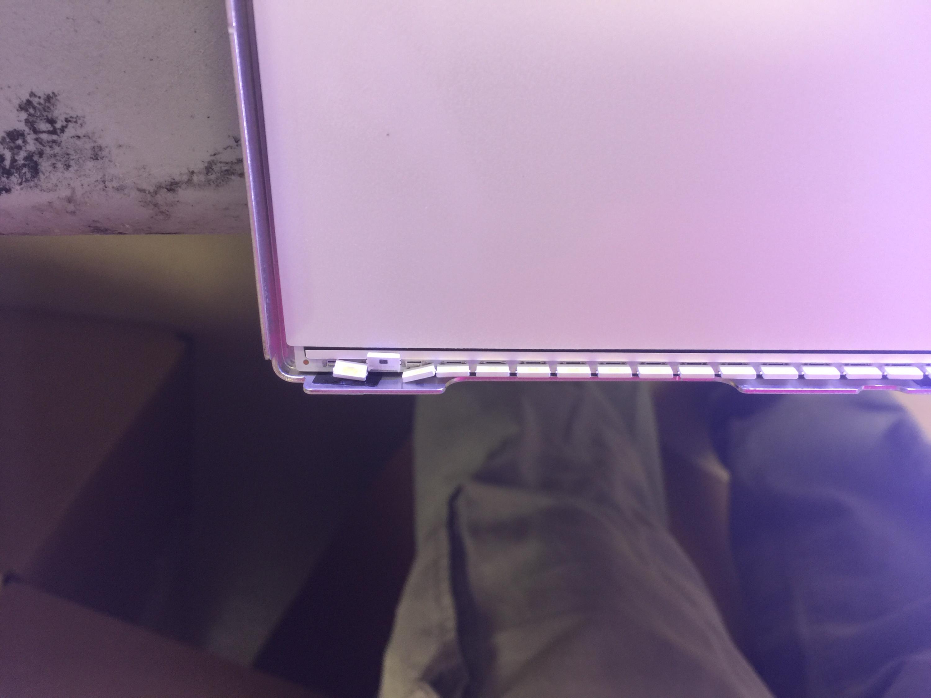

                Well I have discovered that this tv has been taken apart before. All the stripped screws and such and then once I get he panel out of the thing I discover this and it is like this on both sides. Hopefully pads are intact and I can just repair it

                  OK so I have to find these little LEDS now. They have a number on them. I have searched it but no luck.
                  LZ2XNS031
                  is the imprint.

                      I am located in Indianapolis. I don't want to order brand new strips. Nothing wrong with the strip itself. I would like to find the individual LED's. just need 6 of em.
