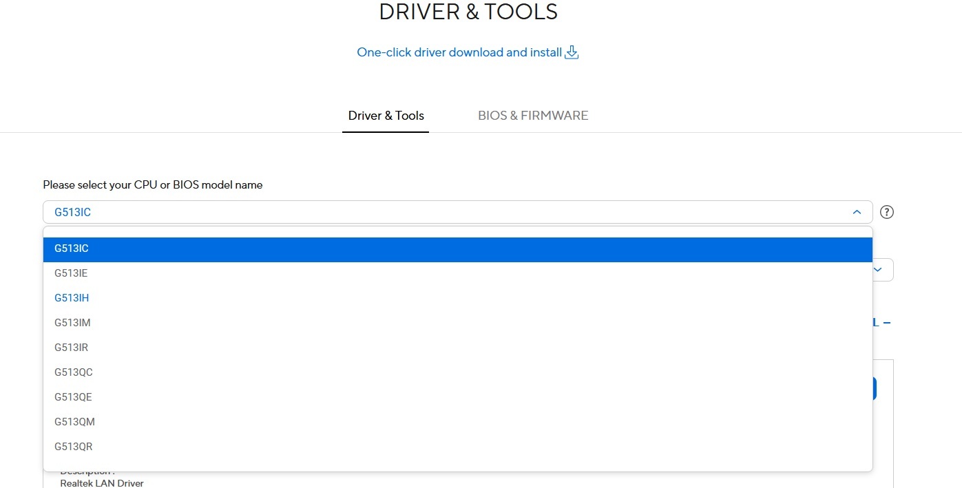

                                  Originally posted by ktmmotocross
                                  must i start board when flashing this ic?

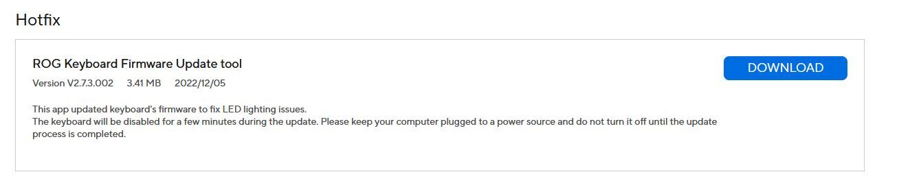

                                    • 21173
                                    Originally posted by SMDFlea
                                    Can you scan the QR code near the USB ports and post what it says, or post a good clear picture of it.
                                    There is a keyboard firmware update tool for some models. The QR code will have the model number for the bios, scan it , then go to the support page and slect that model and see if the firmware update is there as a Hotfix
                                    Example: G513IH Hotfix, ROG Keyboard Firmware Update tool - https://www.asus.com/me-en/supporton...desk_download/
                                    • ktmmotocross
                                      Boardkiller
                                      • Feb 2014
                                      • 3608
                                      • slovakia
                                      interresting. on asus site they wrote that to udate its firmware i must flash main bios which i did.
                                      i try to locate this update but there is non for this G513QE
                                        • 21173
                                        Is G513QE what was scanned from the QR code
