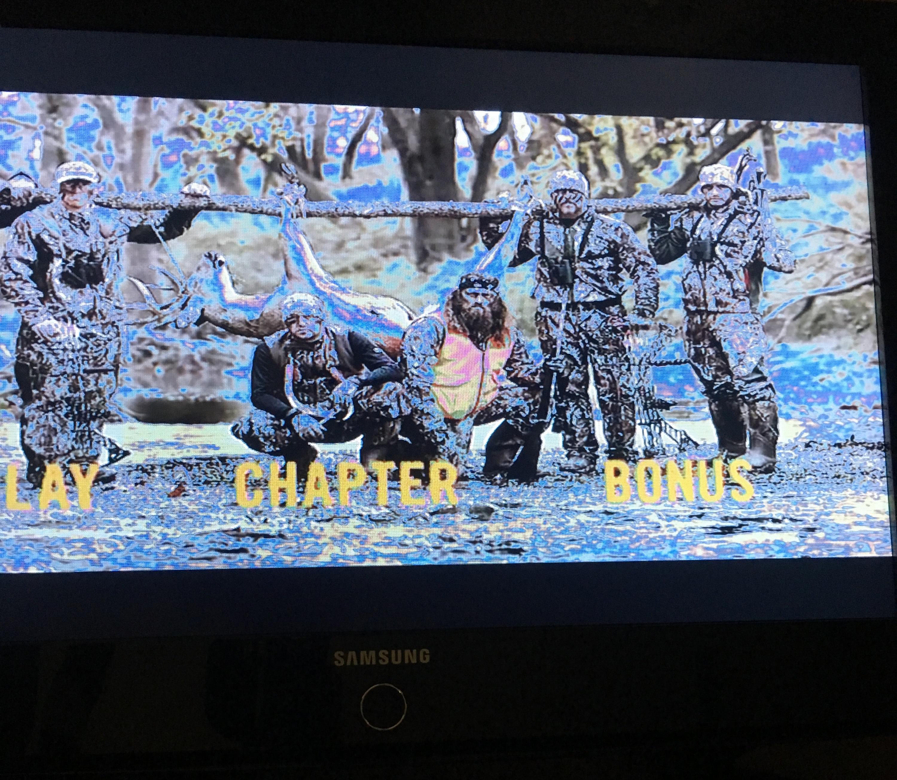

    Hello, all. I have been going through several threads looking for information on discolored picture on my Samsung LN32A330J1D. The picture shows up in black, white, gray, and some orange/red. When the menu is selected it appears perfectly fine. I have gone into the "hidden menu" and attempted to adjust things as I have seen that fix similar problems on YouTube, with no success. I was leaning towards replacing the main board vs the T con at this point, so I have ordered a Main Board. I am hoping this fixes it, although I am told it could easily be the t con or the screen itself? Much of my research shows similar issues, although, many have distorted screens that are full of color and not the black, gray, and white as I have. Any suggestions/guidance would be greatly appreciated! My buddy has a home entertainment business and I am now collecting his throw aways since I just found out he doesn't repair any of them! His trash, my treasure!

    How about uploading the screen shot so we can see what the actual image looks like?

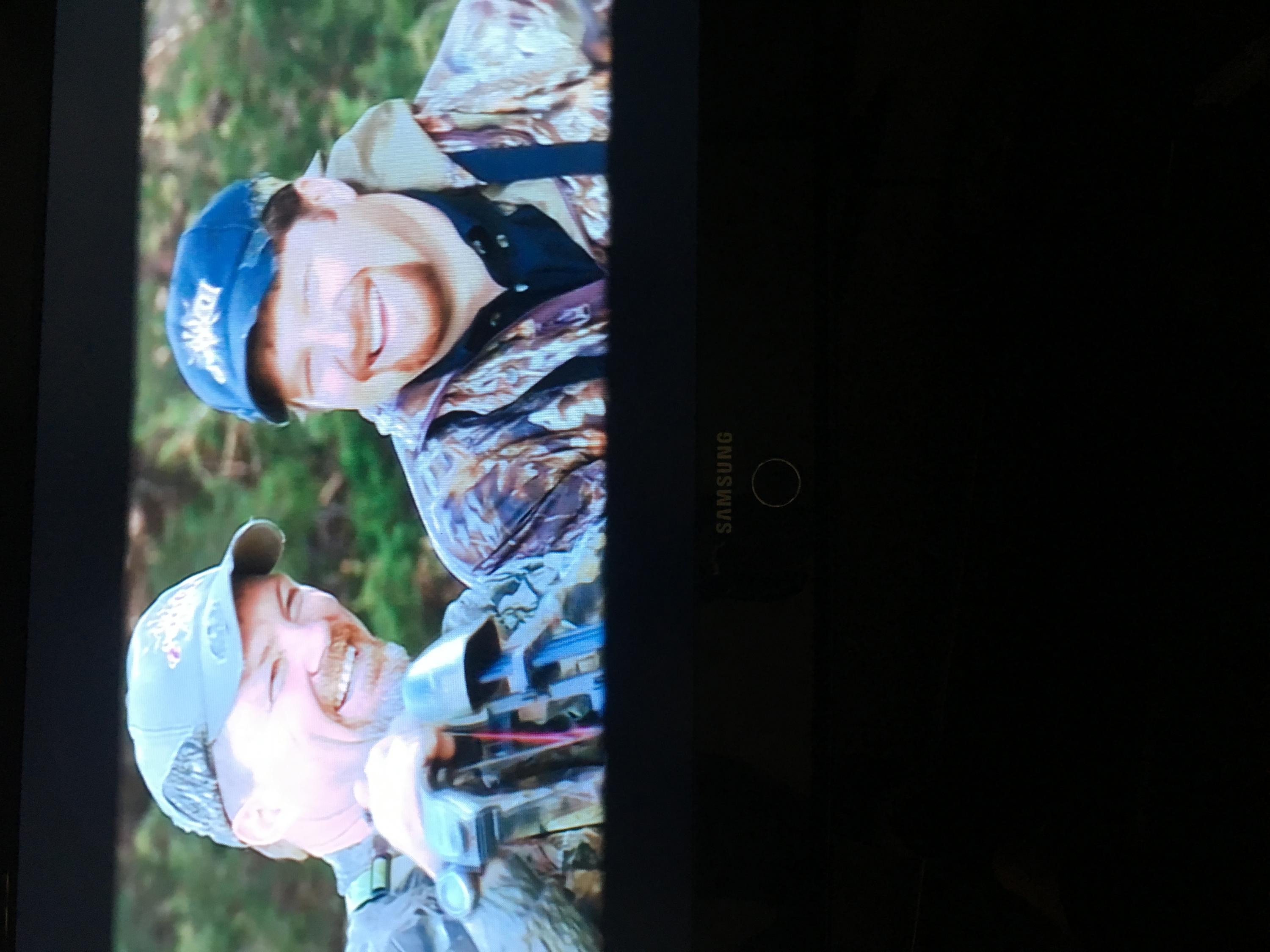

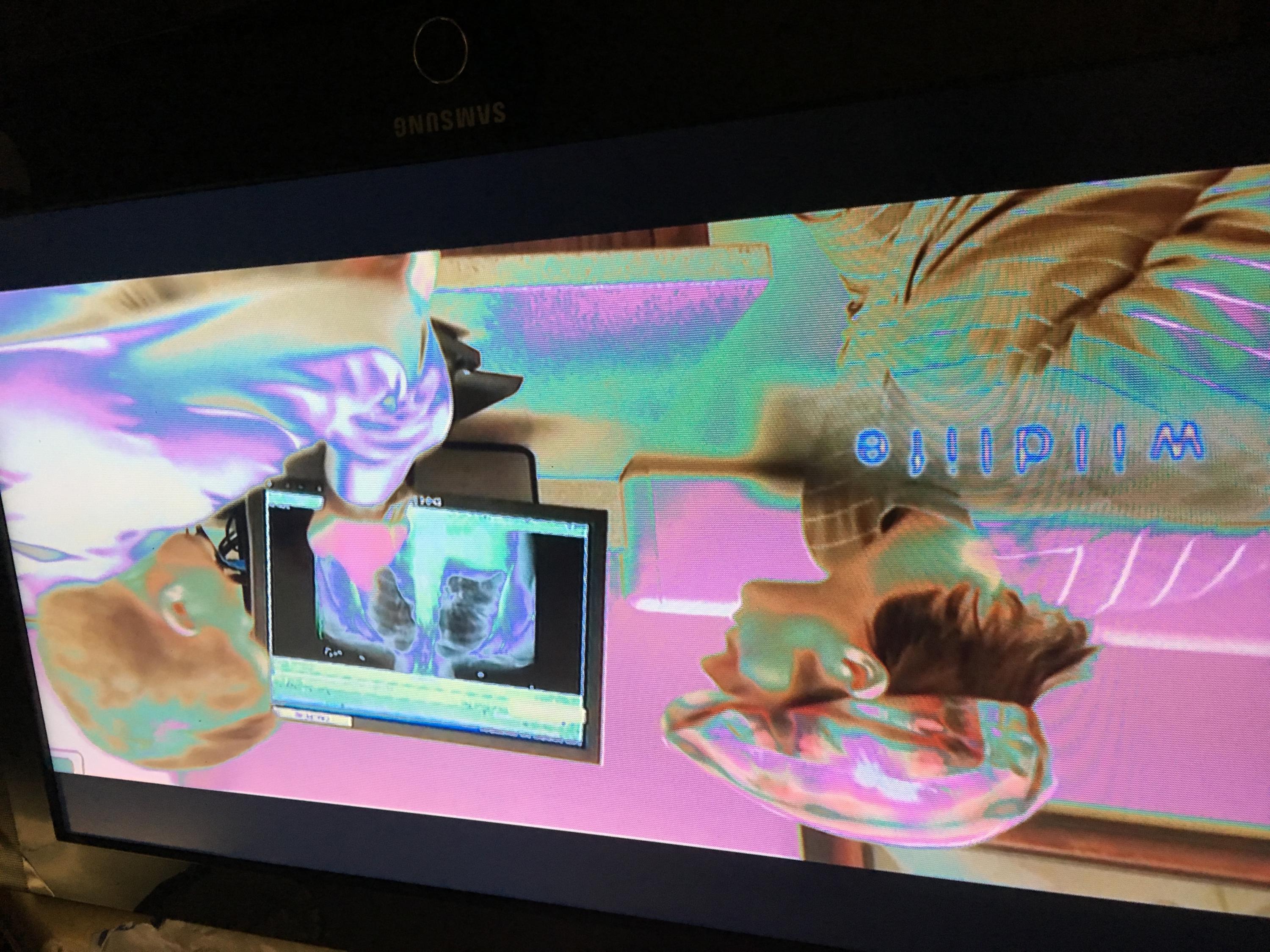

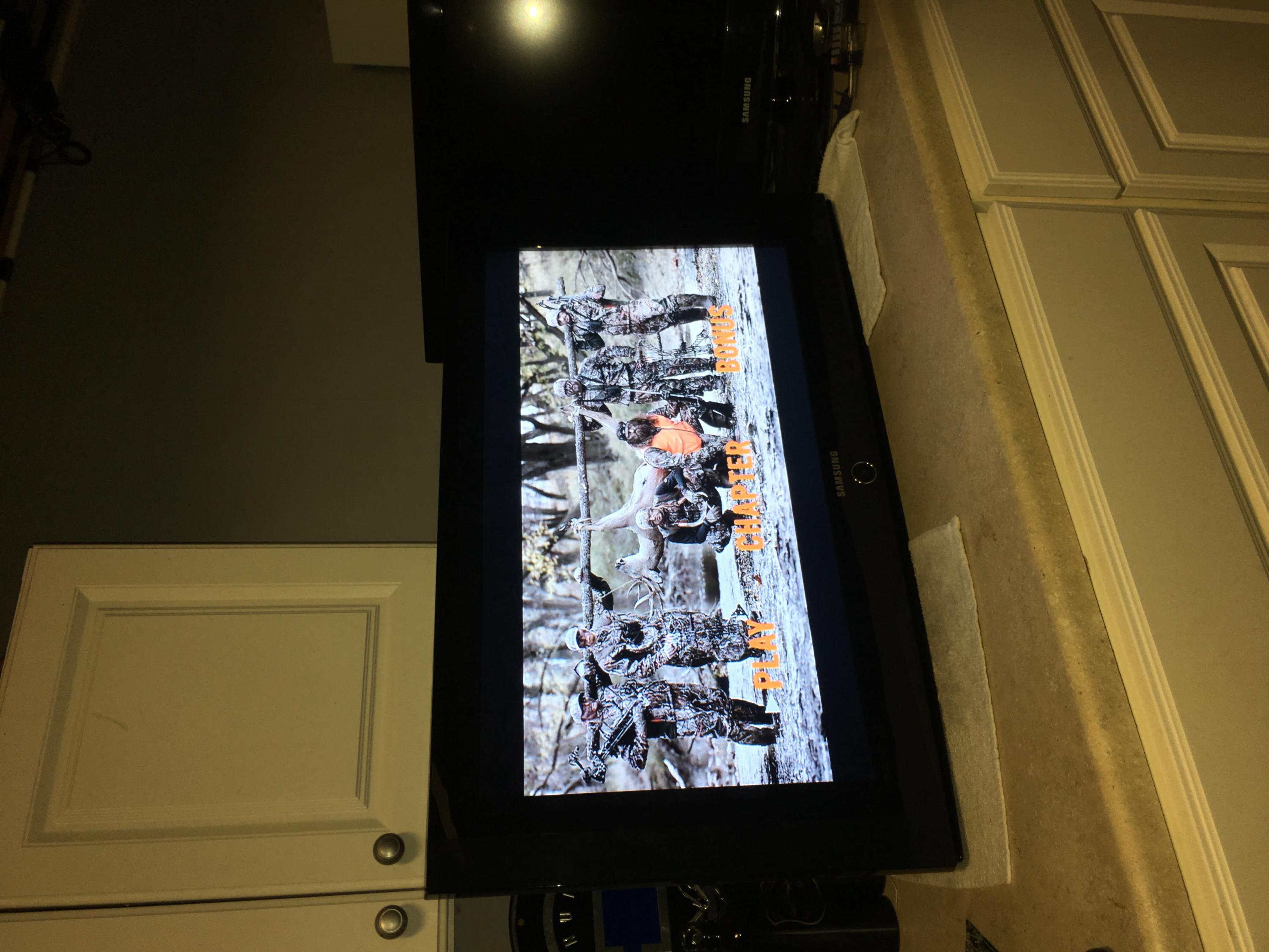

        Re: Samsung LN32A330J1D - Discolored Image
        These are what I get when the tv is on...and I got more color than before
          That is GAMMA Voltages problem, you will need to test bunches of GAMMA Voltages on the T-CON board.
            Ah ok. Thank you for the quick response! Wish I found this site before I ordered the main board! The menu shows up perfectly normal (I should've taken a picture). I will be ordering a t con replacement!
              Yes...a new T-CON Bd will fix your problem. This is a common fault with these sets.

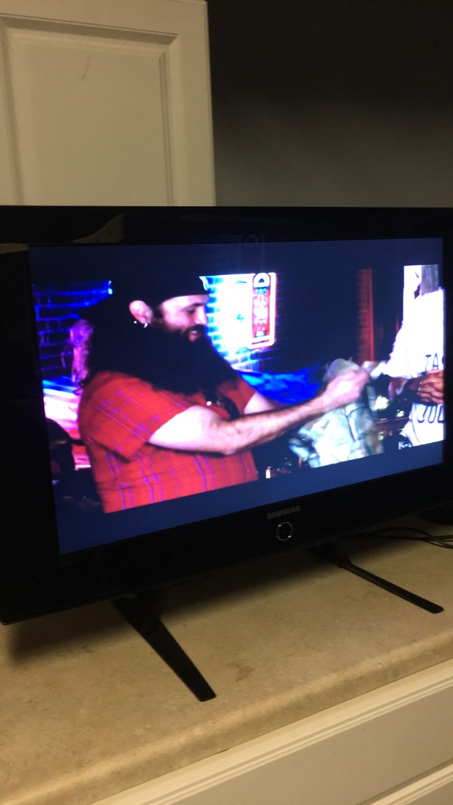

                      Well I ended up ordering a new t con board of eBay. Everything turned out great. Thank you all for your input and gudiance!!!
