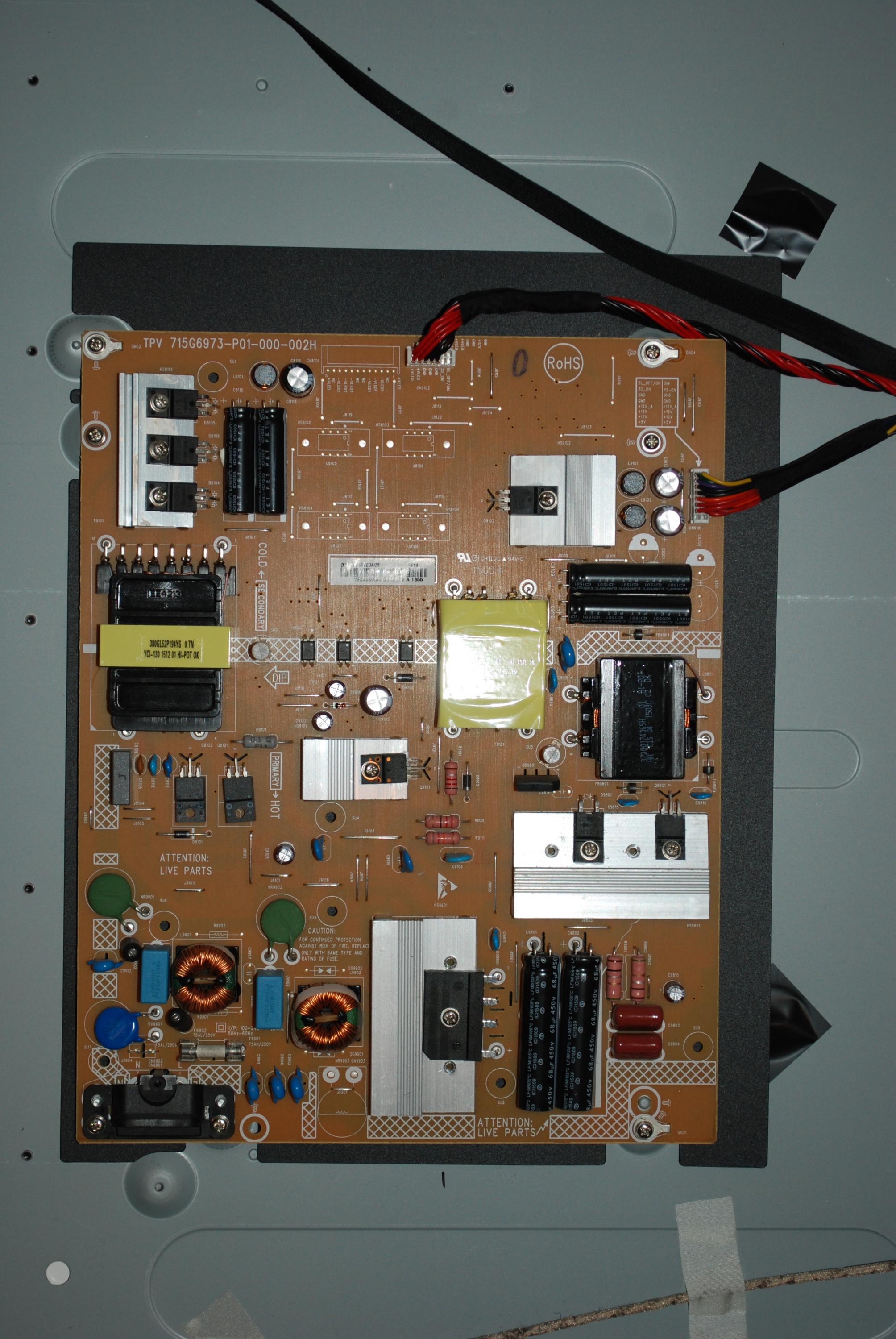

    Pretty easy. With the back off the TV, plug the TV in, while measuring the STBY voltage with you DMM set to DC V at the PSU. See if it disappears. We are going to need some high resolution, straight shot pictures of your PSU and main board.

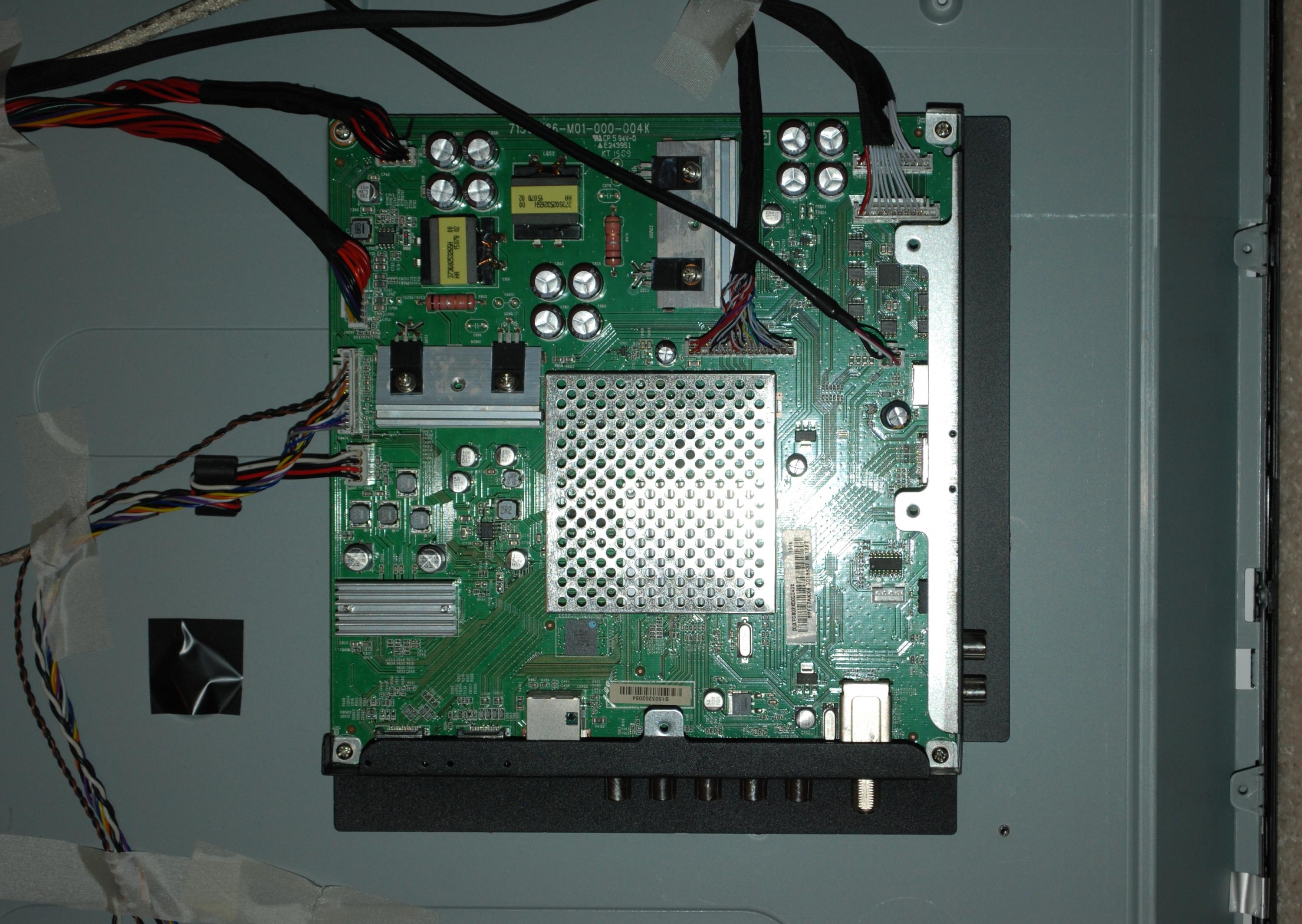

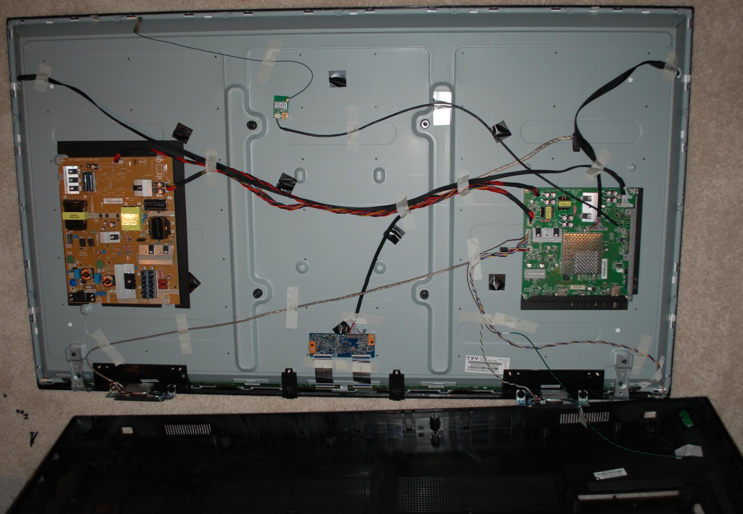

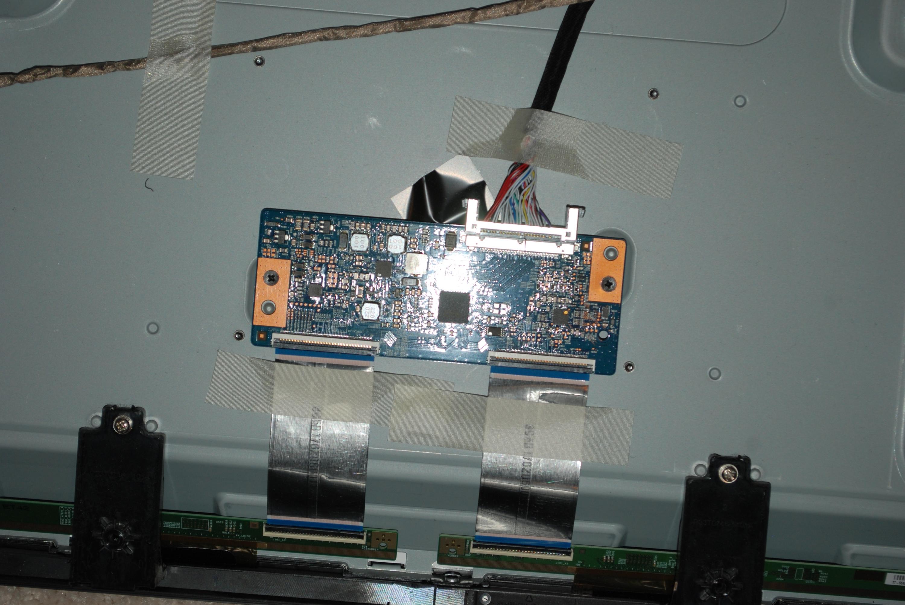

                Re: Vizio e55-c1, Plug in, standby light on, then fade off in 2 sec
                UPDATE=>
                #1. I took it off the wall and brought it to an area where I could work on it. Plugged it in before I start taking it apart . . . It works perfectly! So I did not do any meter readings. I'm guessing it will tough to fix the problem if it is intermittent. Any suggestions? I'm guessing I just keep turning it on/off once or twice a day and see if I can get it to fail again? Other ideas? I've read bits/pieces about EPROM issues. Any chance it was just "mucked up" and a few days being unplugged and then repowered helped? Just trying to figure out if this was a one-off, or an intermittent problem.
                #2. I was WRONG on the standby light. Now that it is working, the standby light operates just like SLK001 said it did earlier in this thread. Sorry I doubted you SLK001 ☹
                #3. As requested, I have attached photos of the PS, Main, and T-Con Boards.
                Any ideas on what do do/check next?
                  Check that all your cables are properly seated. Also, make sure all the screws to ground are tight to the chassis.
                  Looks like the right cable from the TCON to the panel is not all the way in. Also pull the power supply and look for fractured solder joints at the connector.
                    Finally had time to do this tonight. I did seat/reseat all cables and checked ground screws. Also pulled the PS to look for fractured solder joints (I have seen these before so believe I would recognize), but I found none. TV still working fine. Pretty hard to fix something if it won't fail so guess I'm going to button it up and let it run and turn it off on when I can, and see if it will fail. Thanks so much to all of you for your suggestions/advice. Really appreciate it. If it fails, I'll repost, but other than that, I think this thread is CLOSED.
