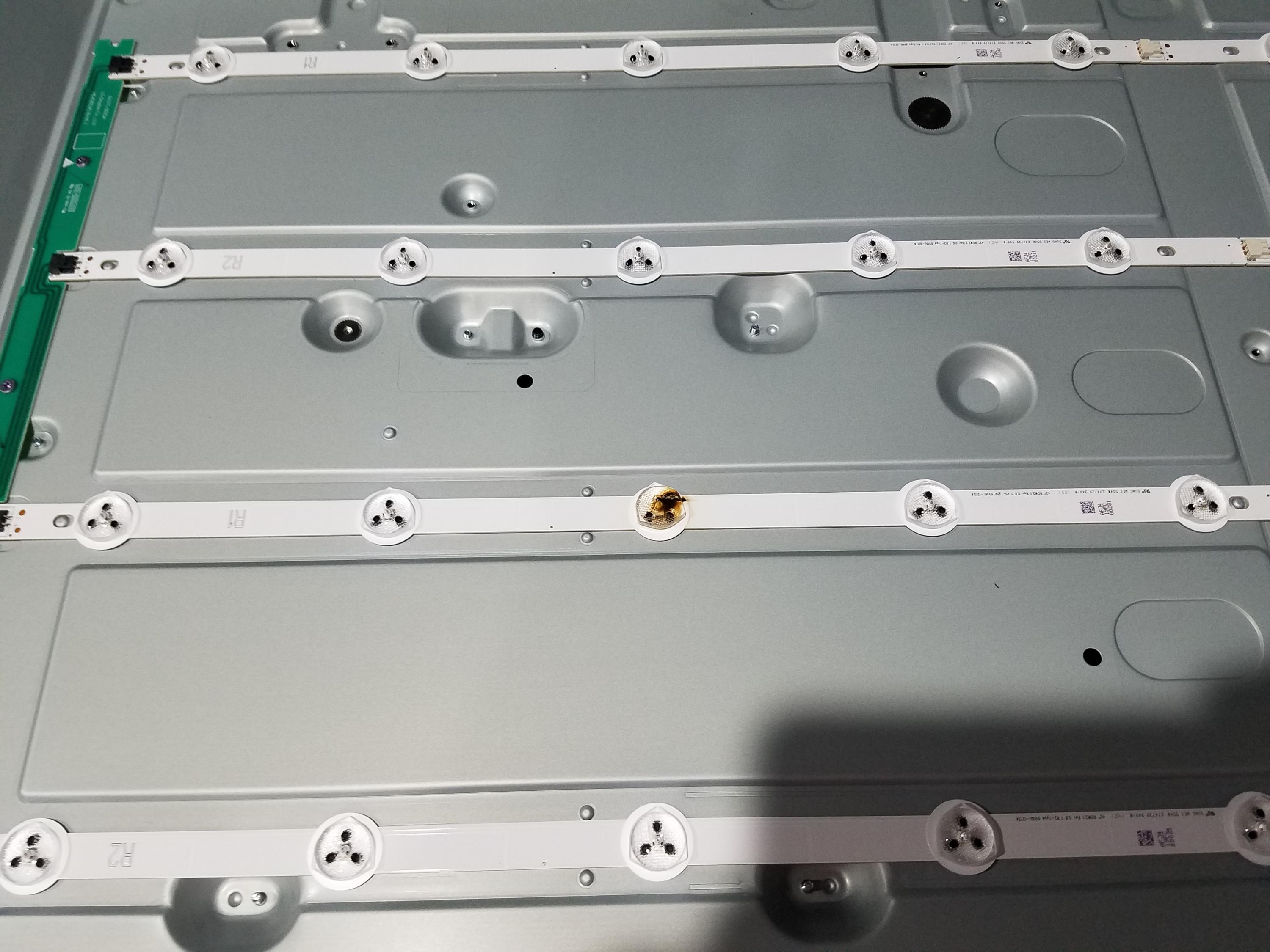

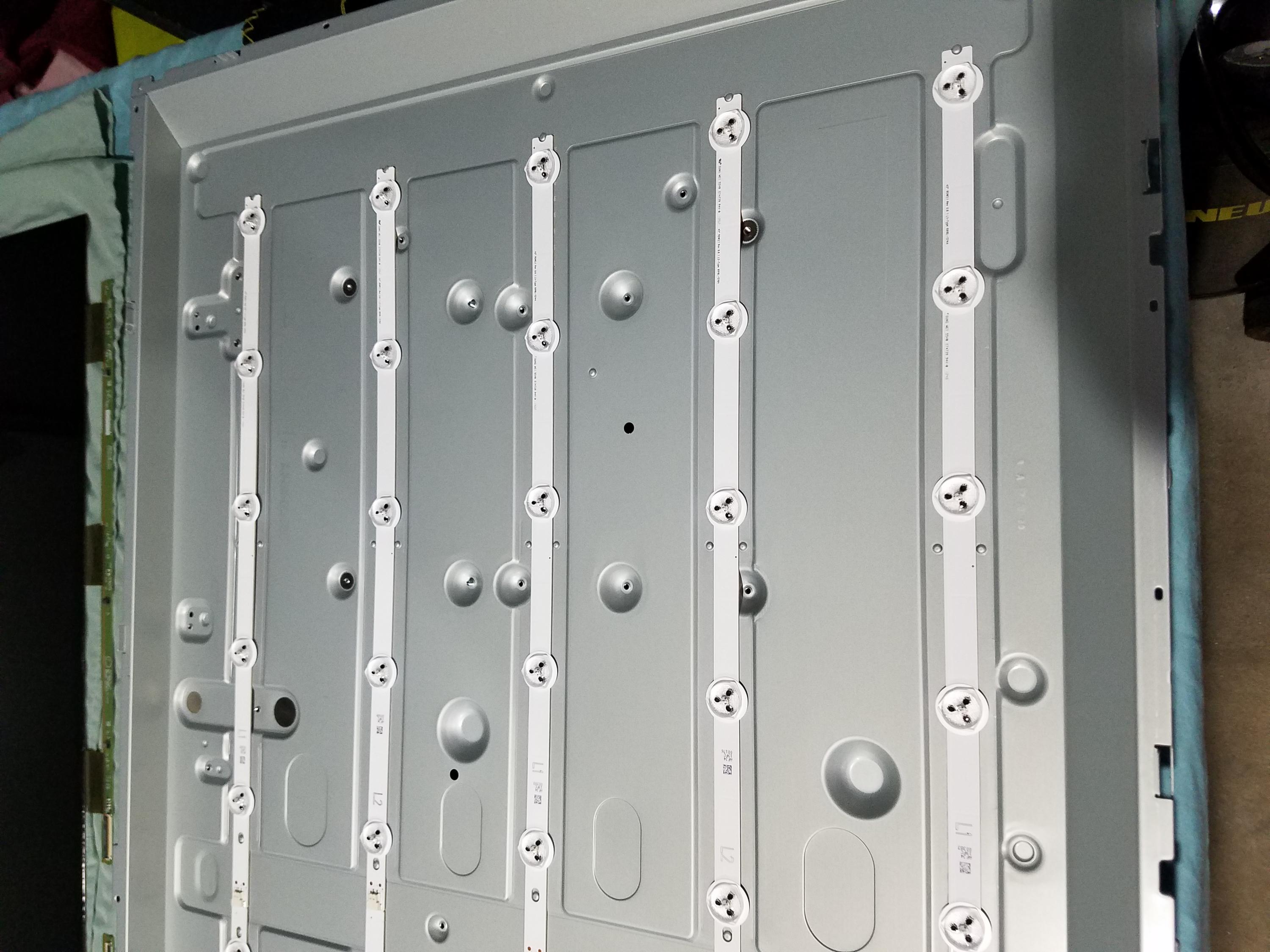

So you have bad LED string that is connected to pin 5/7 that is why the Voltage jumps up over 150V due to no load.Ok so I was able to get the 1st wire disconnected from the connector. I tested the tv with it unconnected and the backlight does not flash when it is unconnected. once you put it back together like it was originally and turn on the TV you get the backlight to flash again.
Replacing each LED can be done if you have good proper tool, in your case you may be better of replacing the LED strips, you need to get the correct one for your model of your LCD panel, check out shojimmy.Last edited by budm; 09-14-2017, 10:30 PM.Never stop learning

So if you look at the attached photos I believe I have found the bad LED strand. My next question is should I just replace that strand or replace all of them just to be safe? Also what is the proper way to get them disconnected and taken off the board without causing any damage? I dont see a tab to press and take them apart or do they just push together and pull apart? Also how do I tell what panel I have? I know that I need the panel number to order the correct LED's.Attached Filesif you find these attachements useful please consider making a small donation to the site
