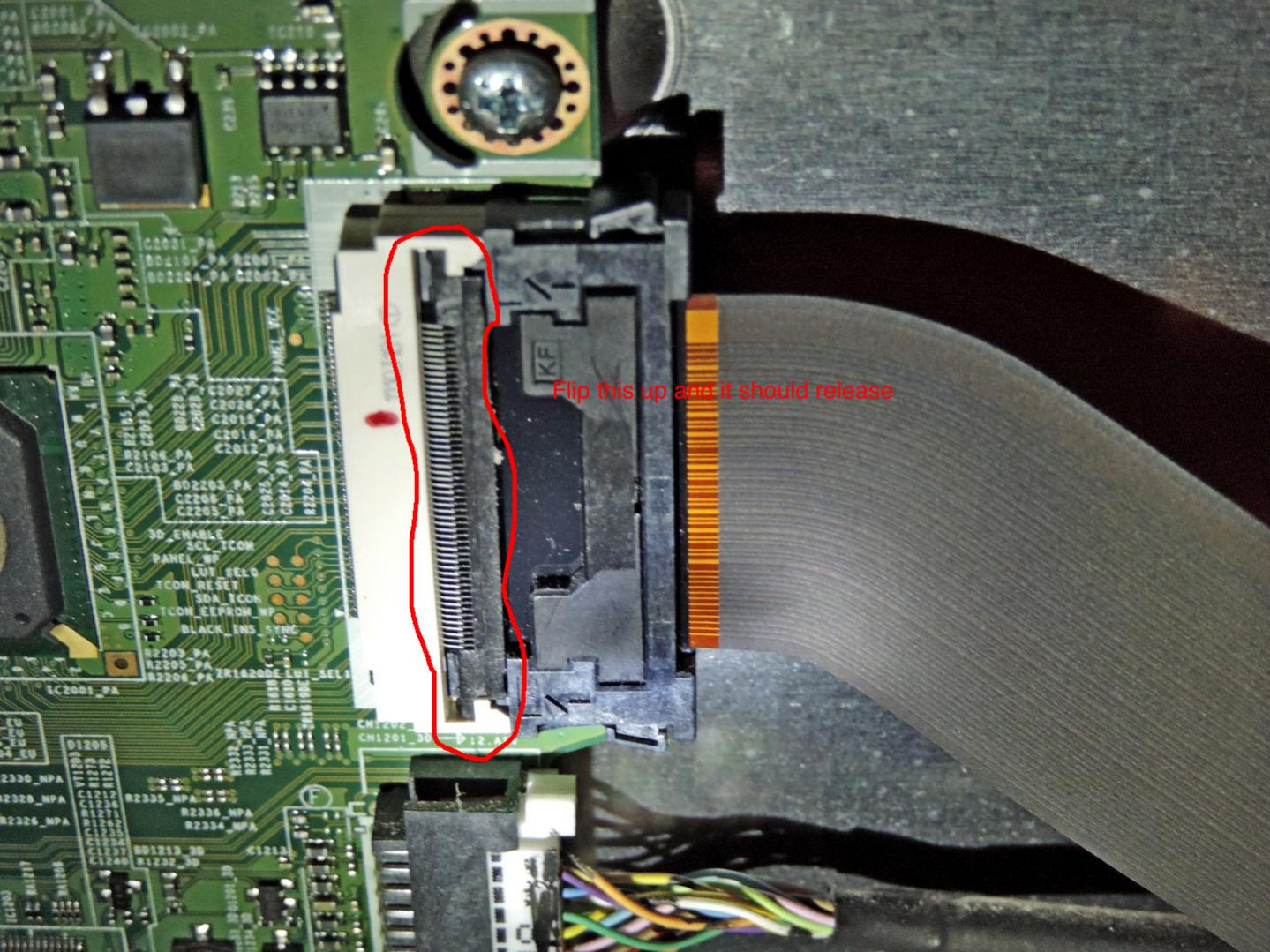

                          Image of the ribbon connector - never had experience with this type.

                          • heavymachines
                            • Mar 2011
                            • 1028
                            Re: Samsung UN60D6420UFXZC Not turning on
                            It should work as shown in edited pic
                            • Wellington1
                              • Sep 2017
                              • 43
                              heavymachines - Success! A big thank you for taking the time to show me - so simple once you know but it looked trickier than it was and one thing I do not need is a broken ribbon connector!
                              Now I just need to find out if the connector from the PS board to the Main board is reconnected for the T con test, not quite clear on that part as Nick's Tvs mentioned.
                                Yes main connected with just lvd flat ribbon disconnected.
