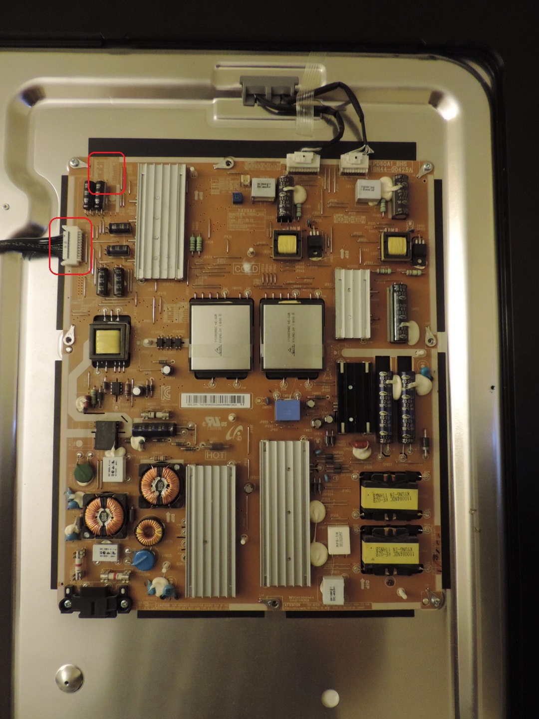

                If you could post some brighter sharp pictures of the power supply they would prove very useful. You can use the metal chassis for ground when measuring at that connector.
                • Wellington1
                  • Sep 2017
                  • 43
                  Re: Samsung UN60D6420UFXZC Not turning on
                  Upper left area of PS board near the connector to Main:
                  Hope these help.
                    #29
                    The exposed pins you can see on the top side of the the board are the ODD number pins, the EVEN number pins you will have to access them from the back side (the wire entrance side) of the connector using skinny probe.
                      One of the connector:
                      Could one disconnect at the Main board and insert the DMM probe into each corresponding pin hole as shown or does the cable need to be connected at both boards? I see it must send voltage signals both directions.
                        I think initially it would be best to have the mainboard connected to the power supply so that you can see if any voltages are missing.
                        Perhaps you could turn the mainboard over and rest it securely off the metal chassis and read the pins from the underside.

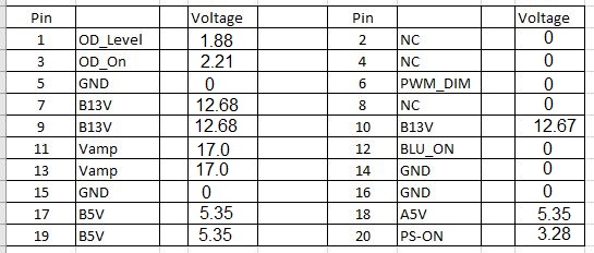

                                After checking the easier to access odd number connections on the PS board at the hard wired connector the readings are:
                                PIN #
                                1 OD LEVEL 1.88
                                3 OD ON 2.21
                                5 GND 0
                                7 B13V 12.68
                                9 B13V 12.68
                                11 VAMP 17.0
                                13 VAMP 17.0
                                15 GND 0
                                17 B5V 5.35
                                19 B5V 5.35
                                As the relay clicked the voltages would drop at most, to be expected I assume as it cycles. As soon as I can find a needle or something similar I will try the even numbered pins.
                                Using good lighting and a magnifying glass I am quite certain I managed, after going over the even numbered connections at the harness itself three times, pretty sure I made contact, the readings are as follows:
                                PIN #
                                # 2 NC 0
                                # 4 NC 0
                                # 6 PWM DIM 0
                                # 8 NC 0
                                # 10 B13V 12.67
                                # 12 BLU ON 0
                                # 14 GND 0
                                # 16 GND 0
                                # 18 A5V 5.35
                                # 20 PS ON 3.28
                                I was having some difficulty insuring I was actually touching each pin that was under the odd row of wires at the connector and the taped needle was not quite as secure as I would have liked but after multiple tries am certain these are the readings, if anyone feels I need to recheck certain pins let me know, wondering about PS ON value as well as the BLU ON ( back light ).
                                    Were the backlights on when you did this test since BL_ON and PWM_DIM are both 0V and would indicate no backlights?
                                    OD_Level and OD_On both look very low. I'm not sure what they should be but a search of the forum show other sets to have a working voltage of between 3V to 5V
                                    Can you attach the test procedure document relating to another Samsung ( UN55H6350AF ) you refer to earlier and a clear focused photo of your mainboard to compare it with the document.
                                      The back light leds did not turn on, only when the cable between the Main and PS boards was disconnected did they light up, and of course the relay stopped clicking as well.
                                      As the back lights function the problem seems to be pointing towards the Main board, I know one can use some resistors and bridge between 5V Standby and I believe PS ON and BLU ON at the connector on the Main board side which would, if back lights come on, suggest a Main board issue, worth a try or do the voltage readings say the same thing?
                                      I will check the site I was on for any voltage values.
