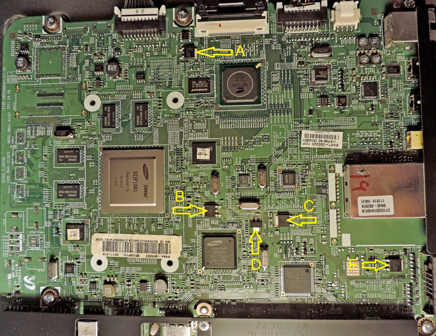

    What are the part numbers written on top of A, B, C, D & E
      #42
      Re: Samsung UN60D6420UFXZC Not turning on
      Dick - I managed to read all of them except for position D, the printing is very small and extremely difficult to highlight, perhaps with more magnification and a stronger light I can then make it out, at the moment I am not able to magnify further, as for the others the numbers are:
      A) 17-18Z
      1141FG
      B) 17-33Z
      1132CG
      C) 17-33Z
      1132CG
      D) ?
      E) 17-18Z
      1141FG
      Hope you can make something out of those numbers!

        A, E = 1.8V fixed output regulators
        B, C = 3.3V fixed output regulators
          #44
          budm - worth checking the voltages on each IC? Read somewhere about how to do that, also, would any of them have something to do with the OD ON / OD LEVEL voltages? Still looking to find out what they should be.

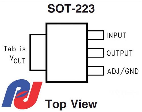

            You need to test all 3 pins, notes: the center pin is internally connect to the big tab which is the output pin.
              #46
              Pin layouts

                    I finally decided to check voltages on those main board regulators and got the following:
                    A) 1.79V / 3.29V
                    B) 3.3V / 5.3V
                    C) 3.2V / 5.3V
                    D) 1.18V / 3.29V
                    E) 1.79V / 3.29V
                    Also. I manage to read what appears to be R19183 / 12GGFDKD on the smallest regulator in position D, very difficult to accurately decipher.
