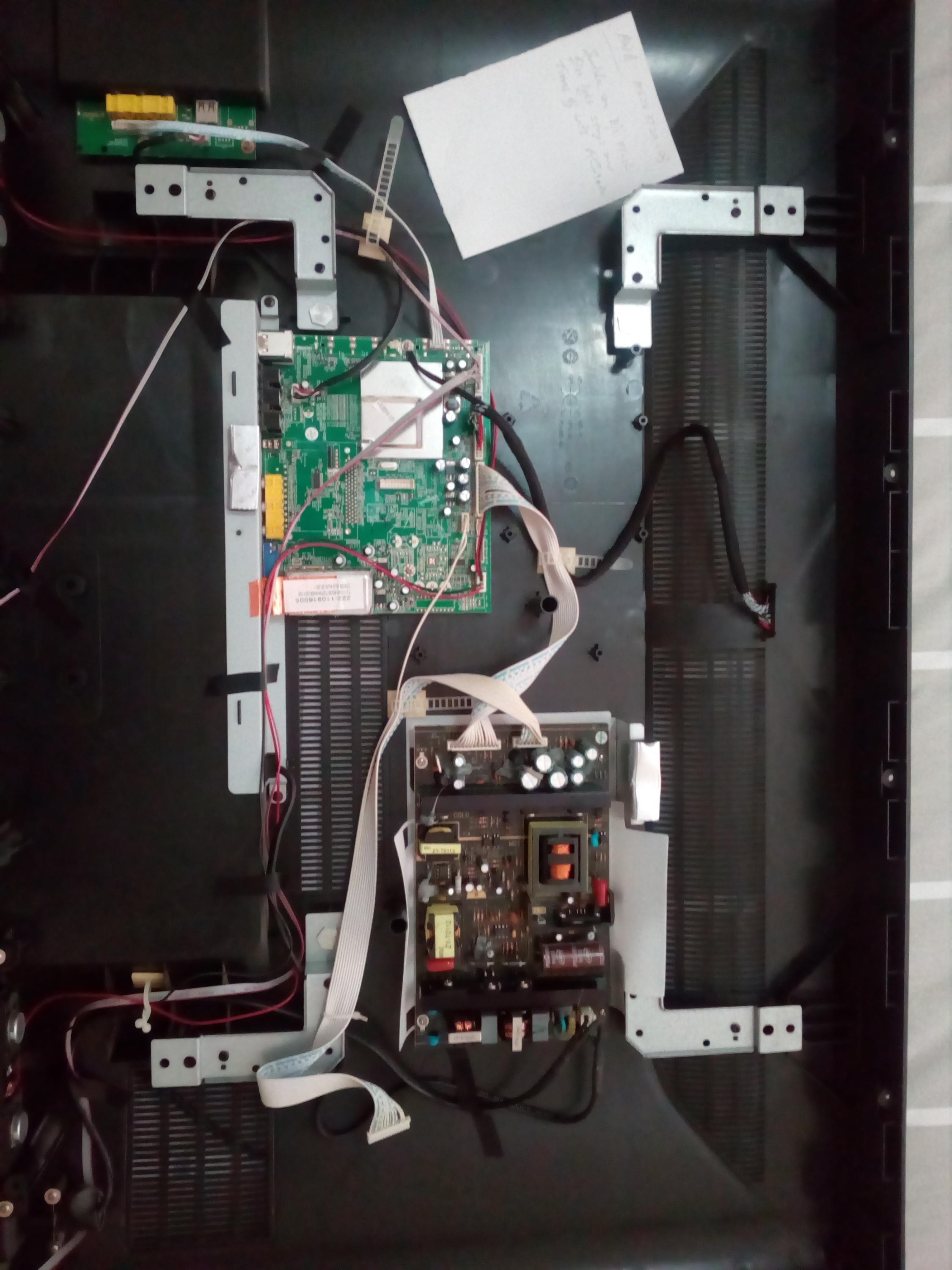

    Awa mhdv3720-03
    Posting this for two reasons one being this set marketed under several brands. It was given to me by a nice younger guy. Had standby light and at switch on red changed to blue and I saw a brief flash on screen. The set seemed to want to operate as it did not switch off until did so with remote. Took it apart and power and main mounted on inside of rear cover whereas inverter and tcon on chassis!!! Checked voltages and all as they should be so looked closely at all boards but no signs of any problem but did notice inverter board 10 connectors just a little dirty so gave them a clean and slid them in and out of connectors several times. Then put back together and set started normally got menus up did a factory reset and tuned channels in. Now running well. So the second reason to post is sometimes the simple solutions do work!!
