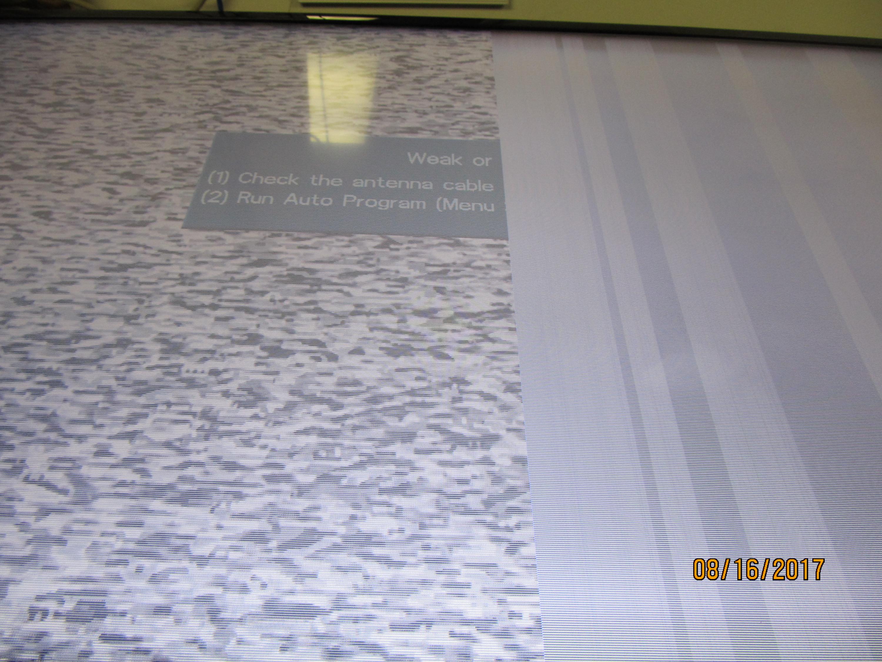

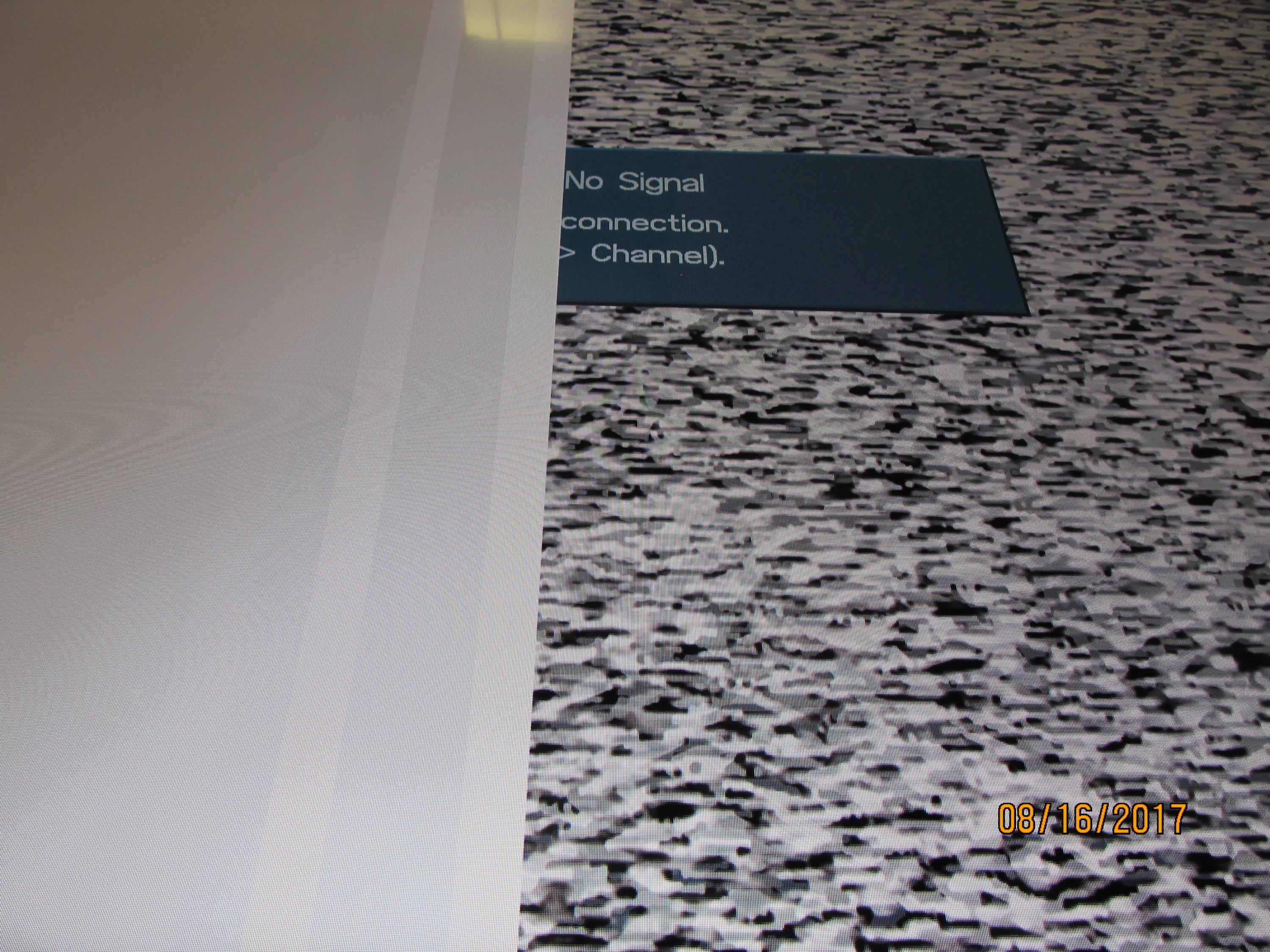

    Has a faint glow and all backlights light up. If I remove the right side (looking at the back of the tv) tcon to panel connector I get a clear picture on the right side of the panel (picture 1) and if I remove the left side connector (again looking at the back of the tv) I get a picture but not as clear (picture 2). I see lots of people having the issue on samsung LED tv's with backlight no picture but no one has mentioned removing one side of the tcon connector. My question is since one side looks fine when the cable is removed and the other looks washed out would this be a bad panel? I did replace the tcon with a used one I had in the store but I get the same problem.

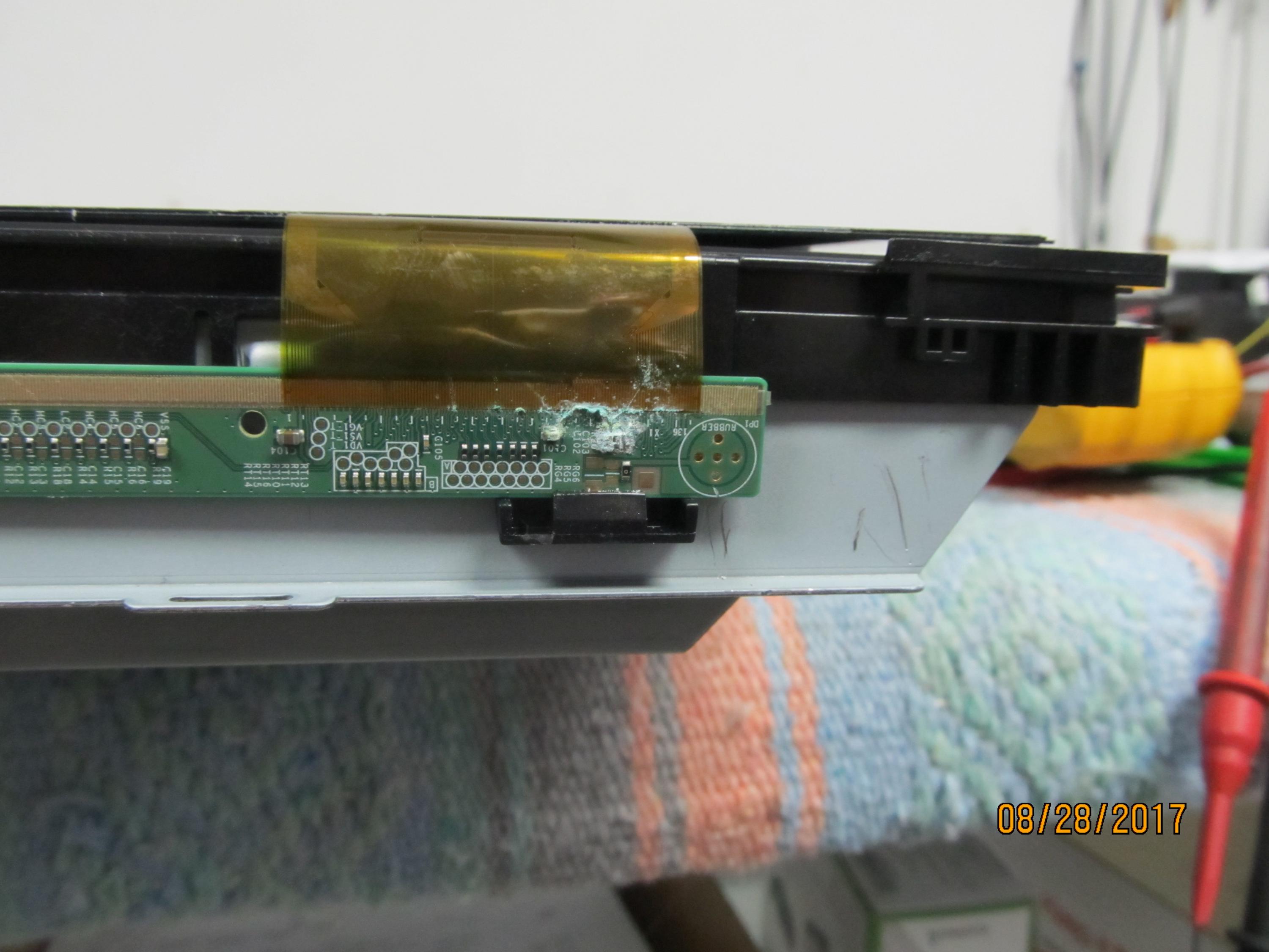

    It could be a bad panel or a shorted ceramic capacitor on the thin board(s) between the tcon and screen.

        You need to reread post2

          yeah... I don't think a new T-con will fix that either.

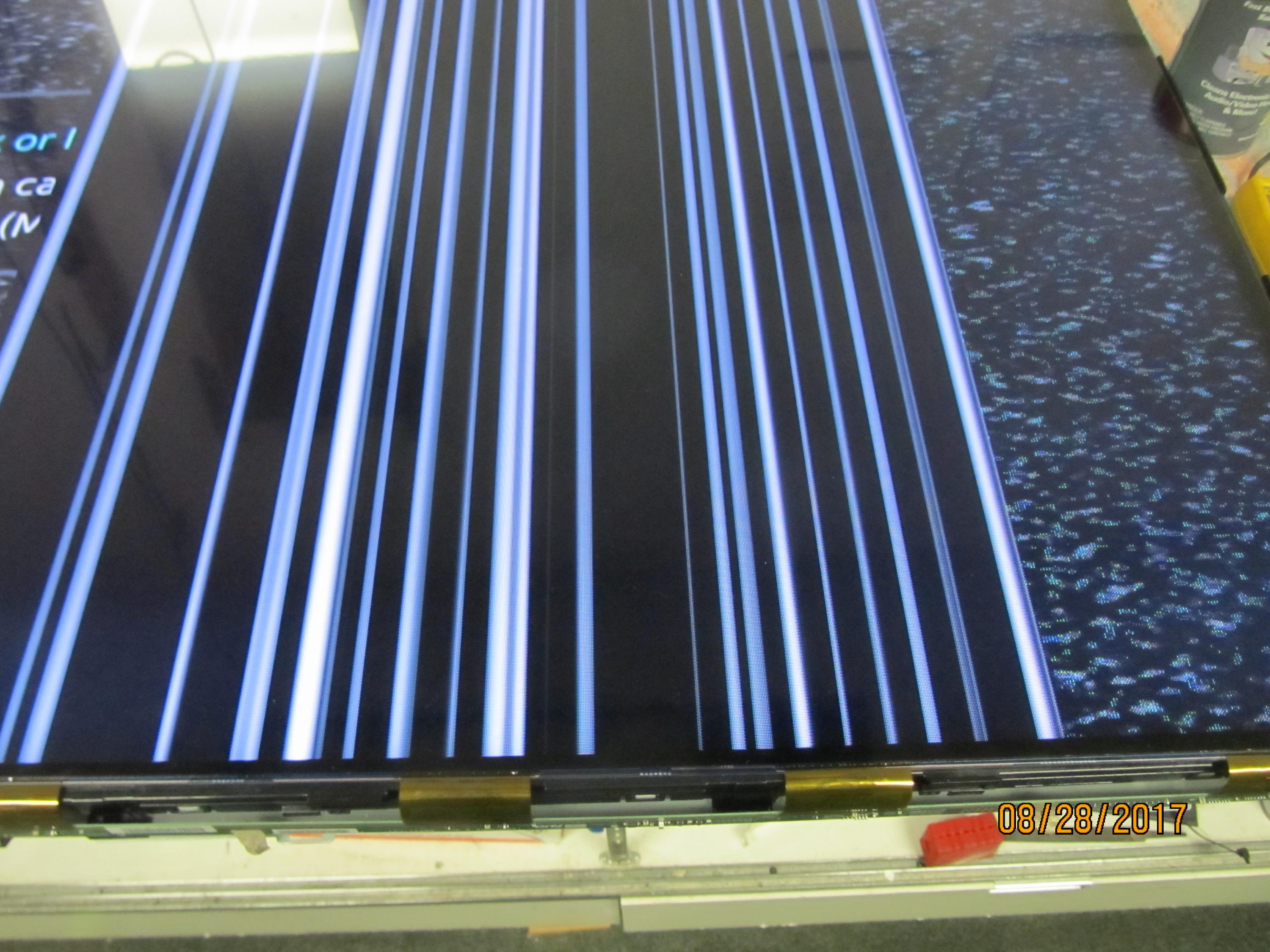

            You were right CapLeaker the tcon is not the issue but corrosion on the thin board to the panel. Cleaned that and now I a picture but it is distorted on the right side. If I move the tabs to the panel the picture gets worse.

              Bye panel!
              Probably because of cleaning the screen.....
