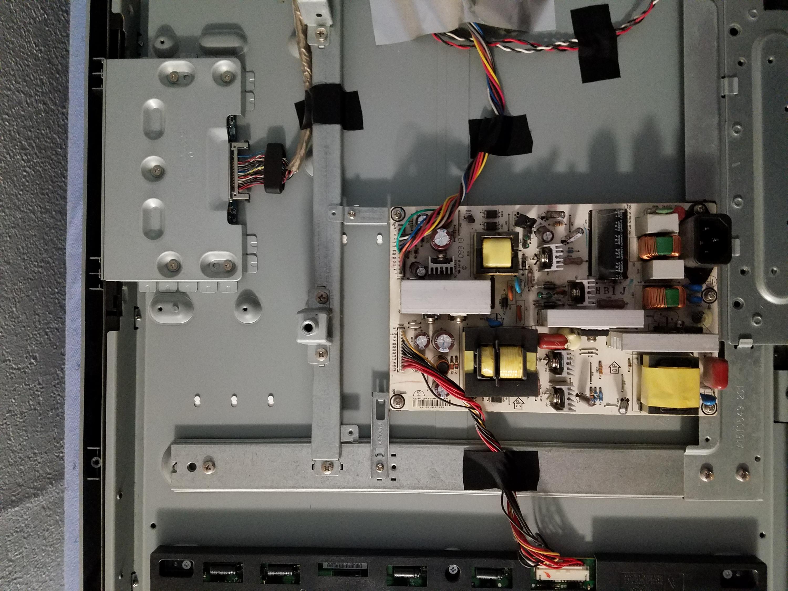

    My Vizio VA320m recently just stopped producing an image. I use this TV currently as a Monitor for my PC. i was in the middle of browsing the internet when all of a sudden a noise came out of the speakers and a little Black Blank Box appeared in the top right corner of the TV and then everything went black.
    The Vizio logo still turns from Orange to White when turning the power on but no Picture or sound. I have tried all the HDMI ports but still no picture or sound. Any ideas or help on what to do next would be much appreciated.
    Re: Vizio VA320m Black Screen Help!

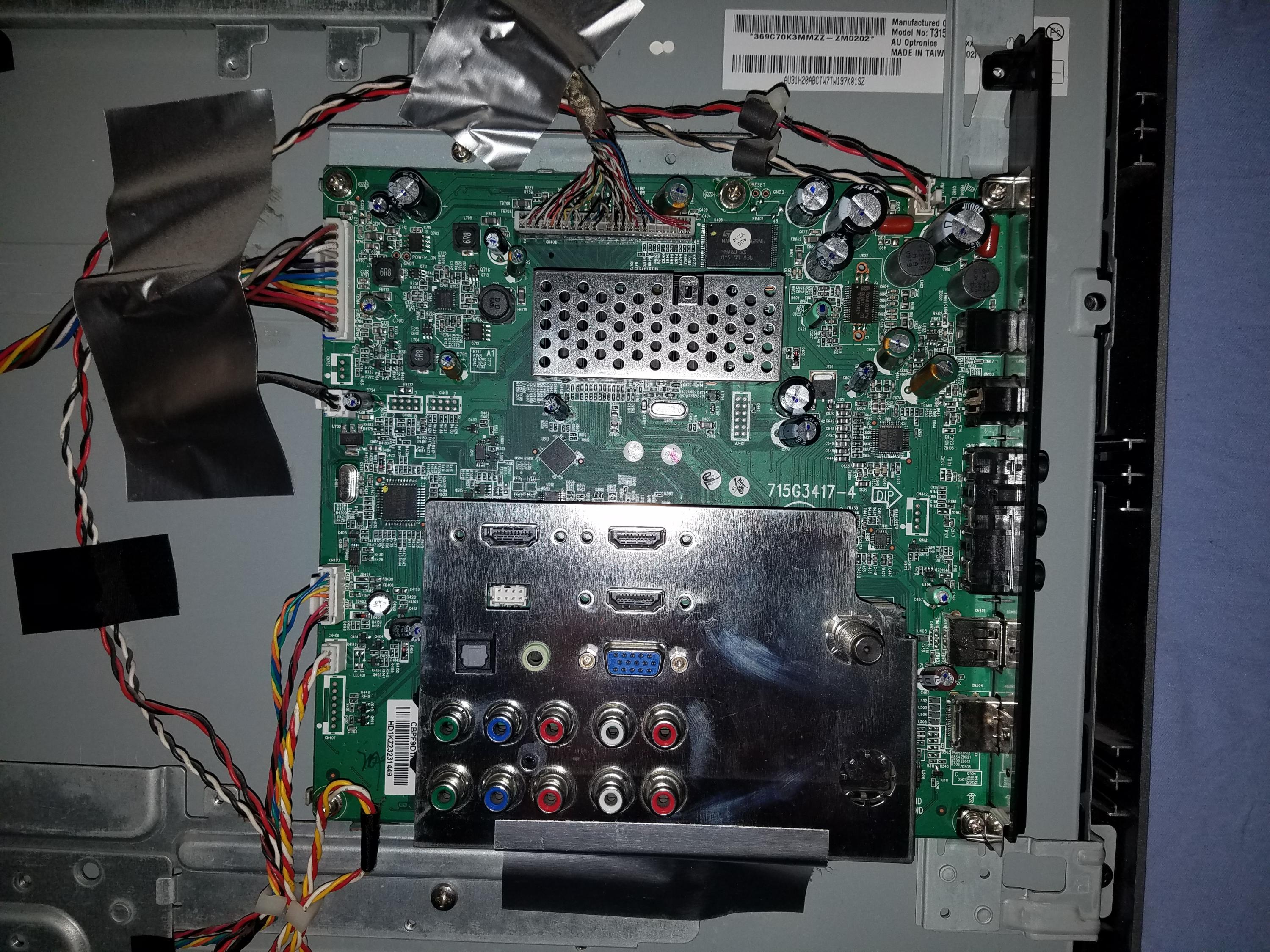

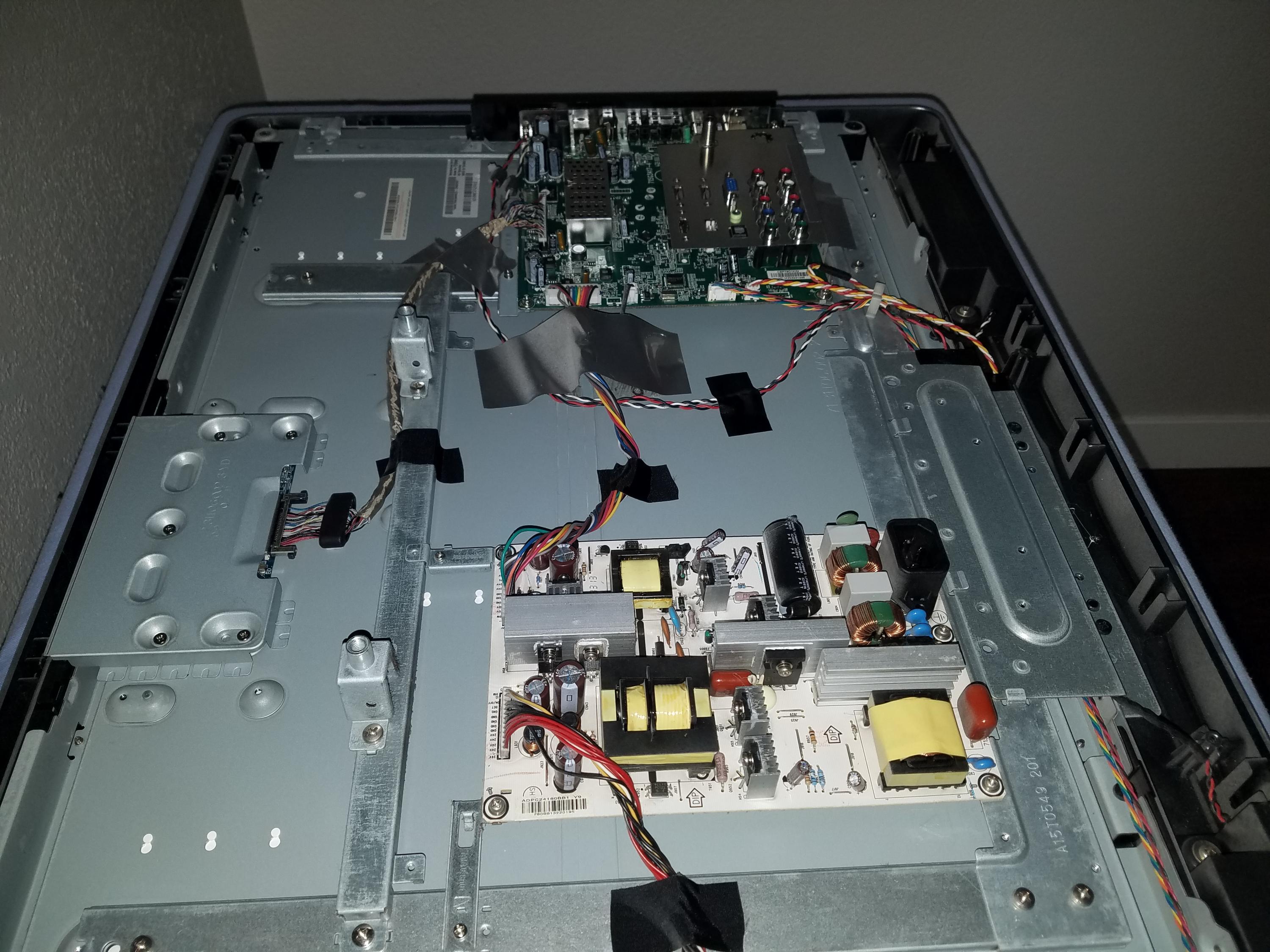

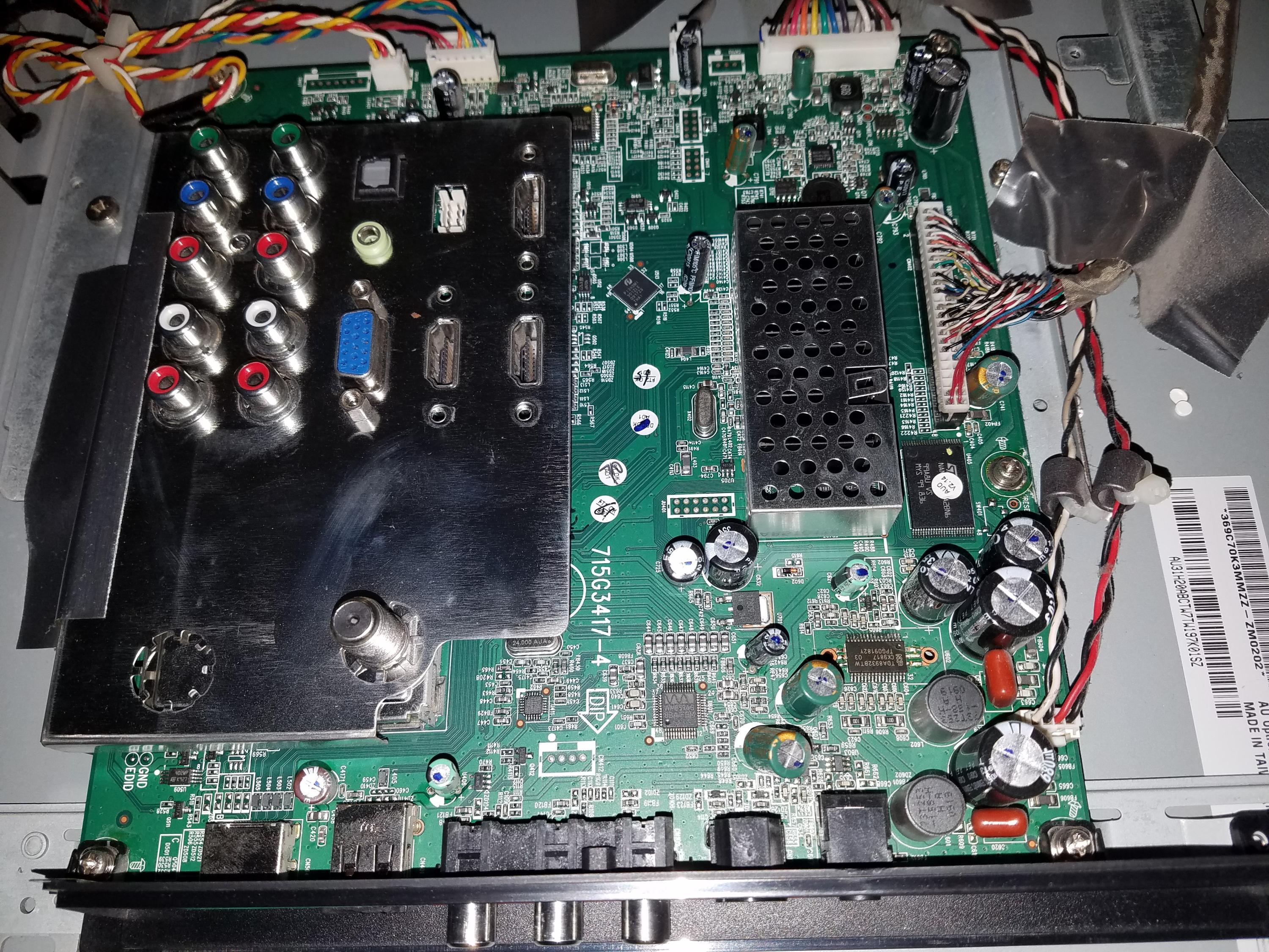

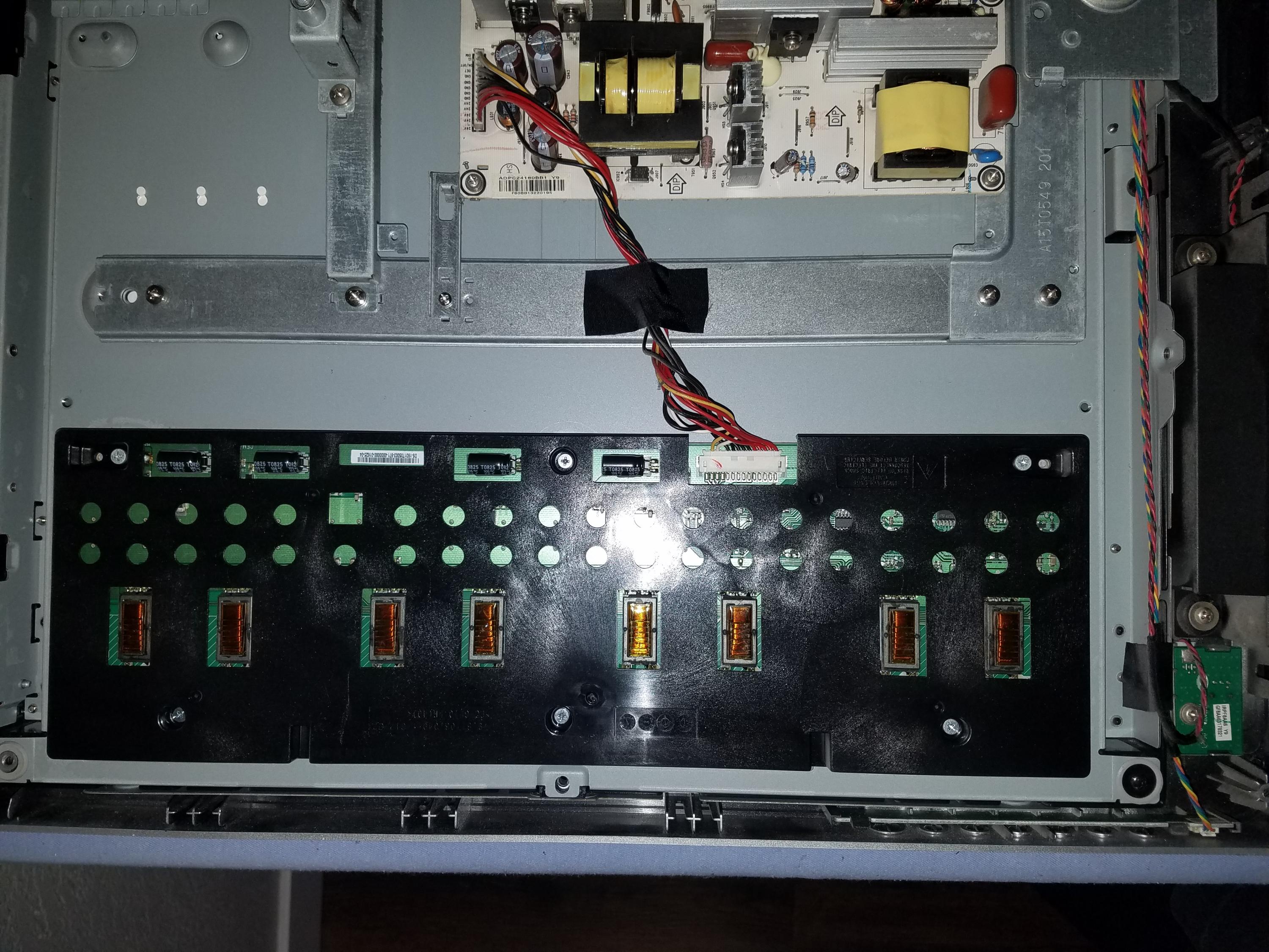

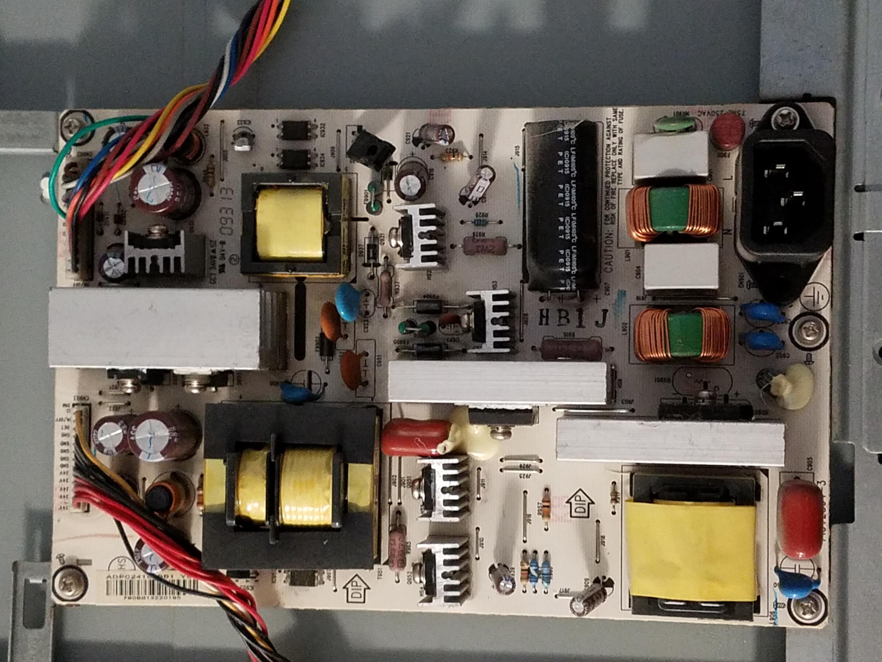

    Please upload good clear pictures of the whole backside of the TV showing all the boards so we can see what we are dealing with.
    • Adam925
      • Aug 2017
      • 19
      Here are the images you asked for.
        https://www.badcaps.net/forum/attach...8&d=1502911116
        There are two white connectors on that power supply board; one goes to the main board, another one goes to the inverter board, we need to the DCV reading of those pins on the connector after the TV is turned on by the power switch.
        There are pin names printed on the board so make sure to report the readings with pin name and follow by the Voltage reading so we can see if Voltages and the command signals are all there or not.

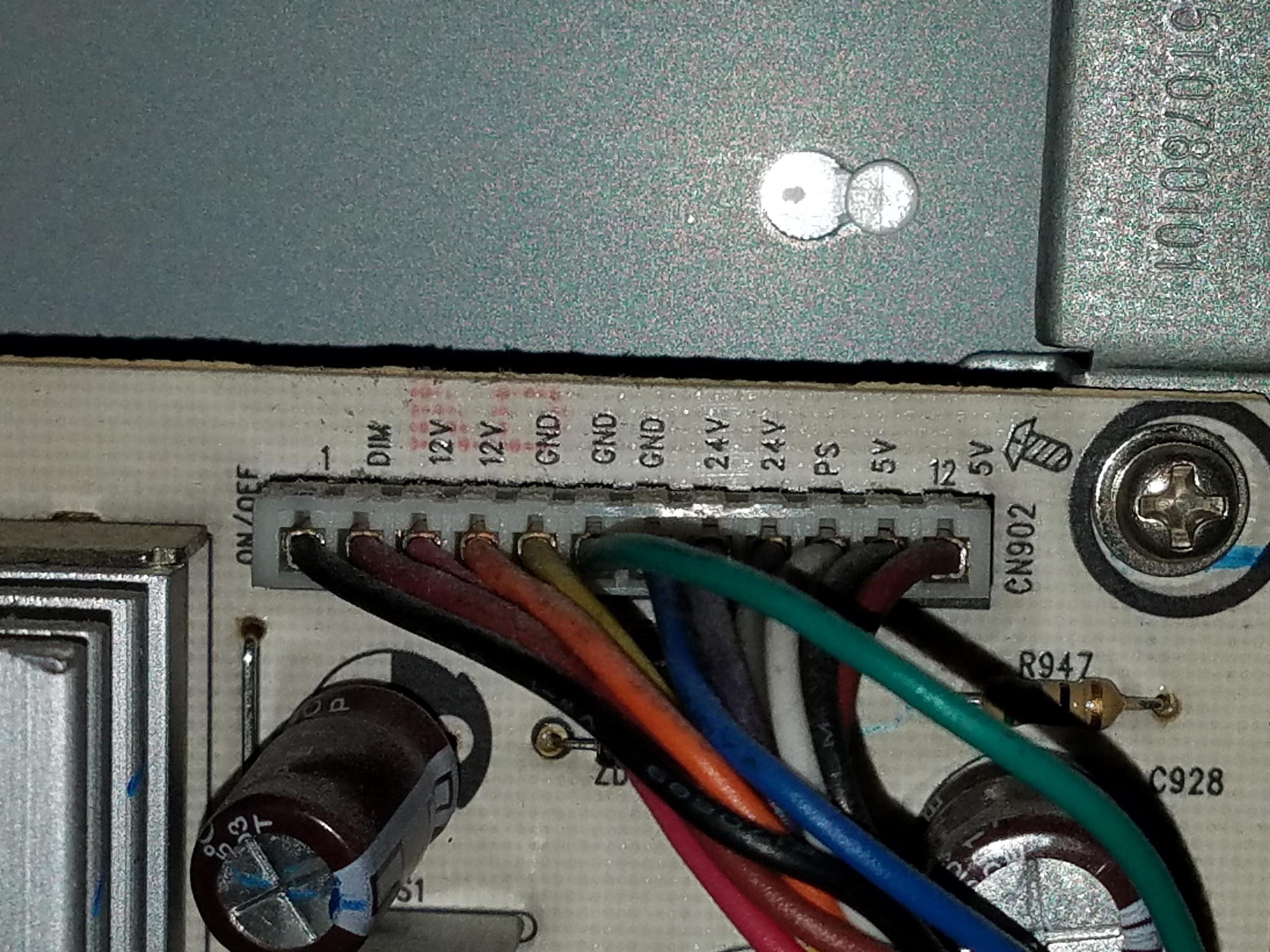

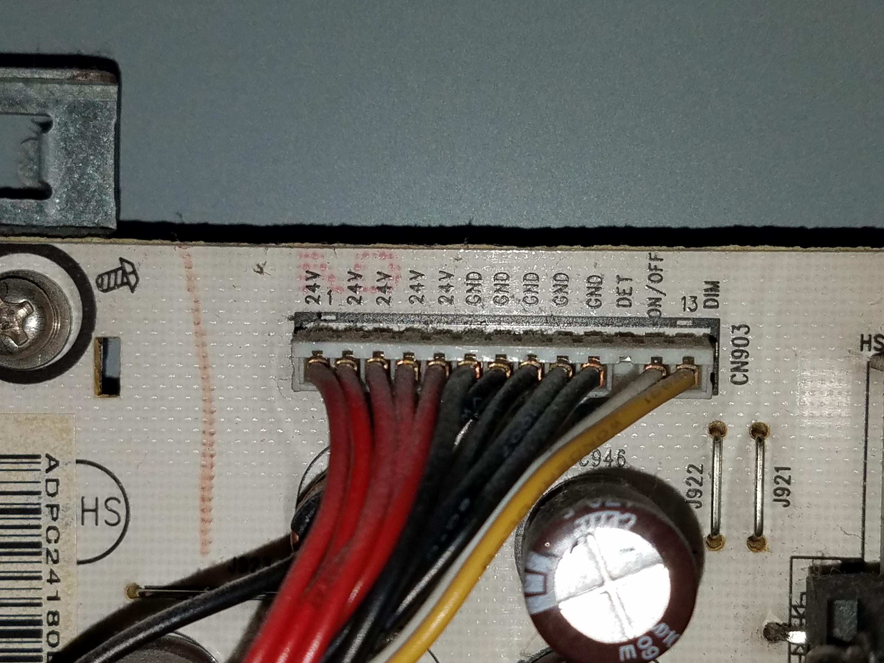

                Here is a closeup view of the 2 connectors. I wrote for the pins exactly what you will see in the images.
                • Adam925
                  • Aug 2017
                  • 19
                  by the looks of it on CN902 pin 1 is ON/OFF
                            OK, so PIN 1 is ON/OFF, and pin 12 is 5V.
                            You can force on the backlights by disconnecting the ON/OFF wire going back to the main board FIRST, then use 470~1K ressistor (1/4 W will be fine) hook up between ON/OFF pin and the 5V pin to see if the backlights will come on; you should see the image on the screen and all the functions should work if the only fault is ON/OFF signal, if not then you have more than just bad ON/OFF signal.
