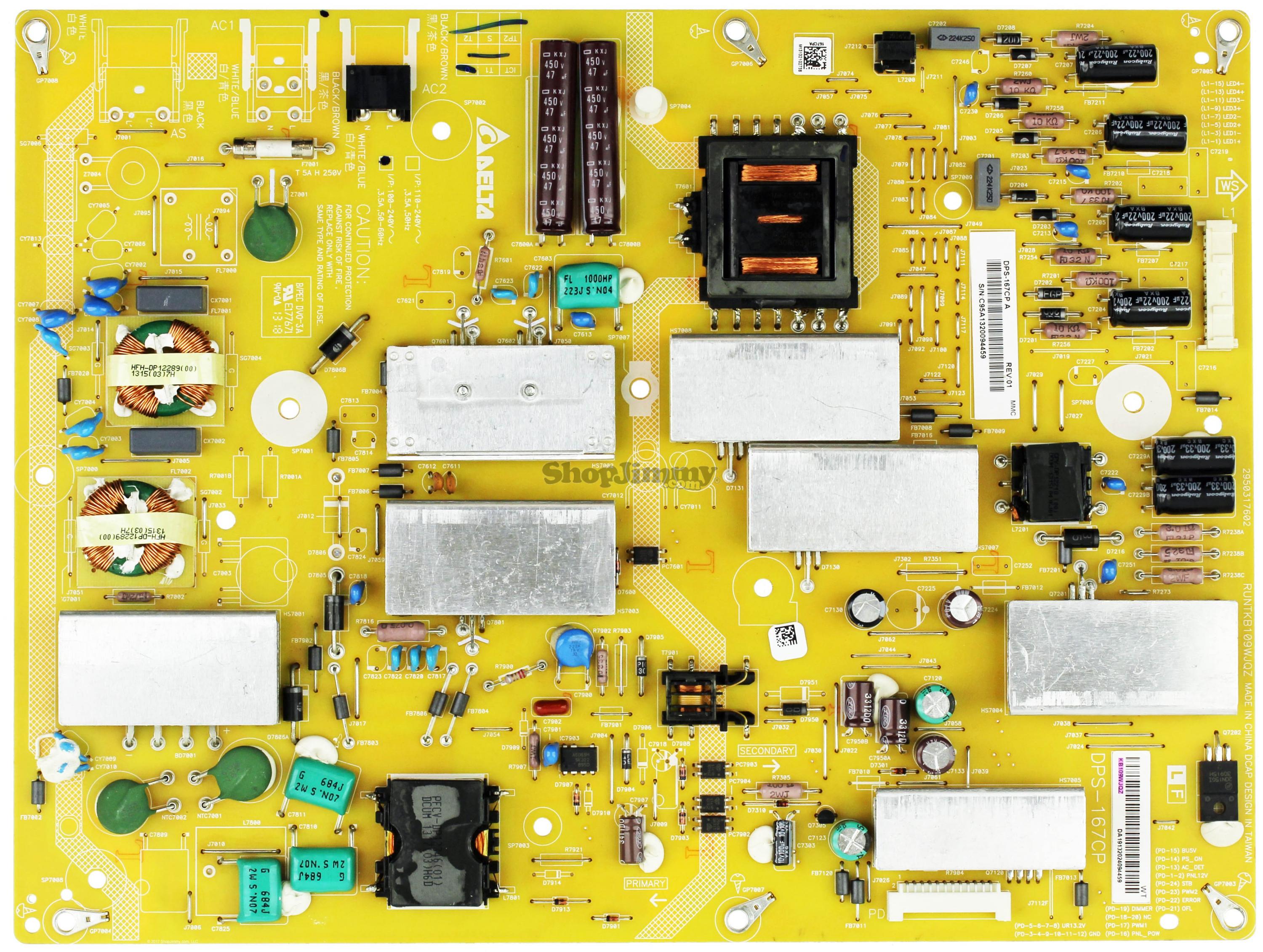

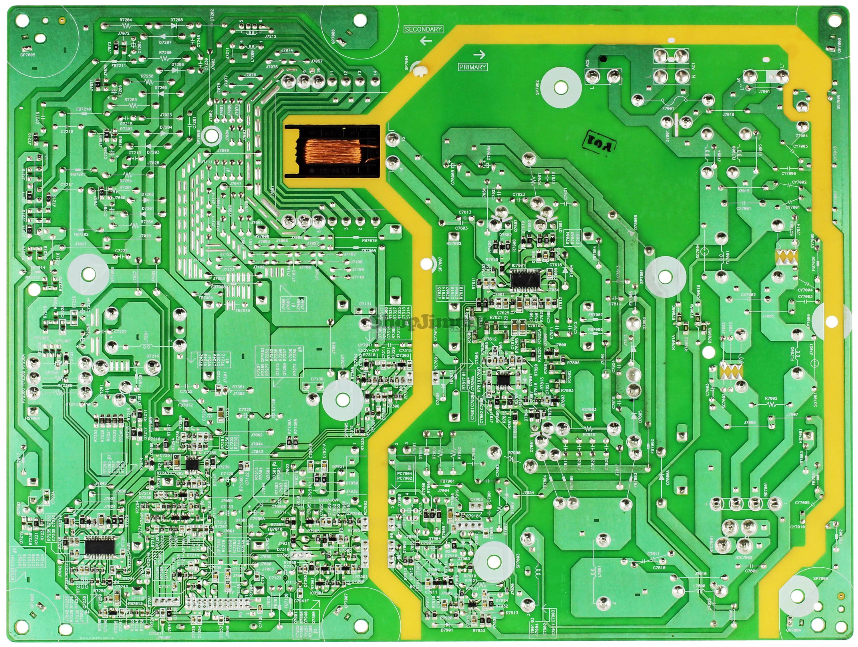

    Hello there,
    Can someone help to troubleshoot this power board KB109WJQZ for Sharp TV LC-60C6500.
    No STB voltage, DC filter caps shows 165V. I found a defective diode location D7950 part number SB2100. I replaced it with another Diode STPS2150 from another Sharp board and I still not getting any STB voltage. Suggestions on what to check next ?
    Thanks in advance

    Check capacitors C7950A and C7950B
    What is the part number for Q7120

      Check R7900 to see if it is open, it should be 2.2 ohms, if it is open ic7903 is bad

        Thanks guys. I did notice R7900. I been looking for IC7903. I will report back soon if I have it.

          Ok. There is definitely an improvement. 5V present on Pin 15 which is BU5V but still nothing on Pin 24 STB. Any thoughts?

            Pin 24 'STB. is the BL-ON pin which it receives the BL-ON signal from the main board.
            You need to report DCV (when TV is OFF and when power switch is activated) for all the pins of the PD connector so we can see what are missing.
            You must put down pin number and follow by pin names so we do not have to guess what they are.

              Thanks guys. Installed circuit board on Tv and is working properly. Thank you for your time.
