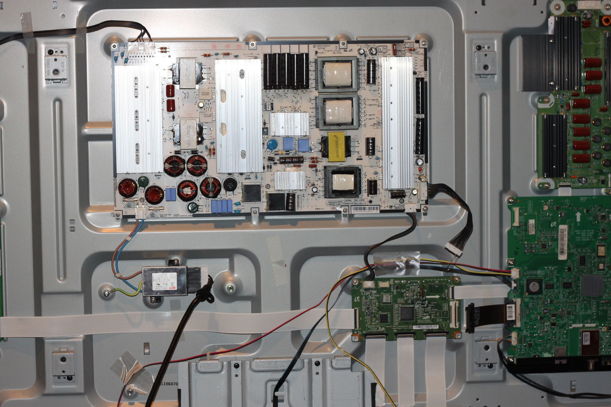

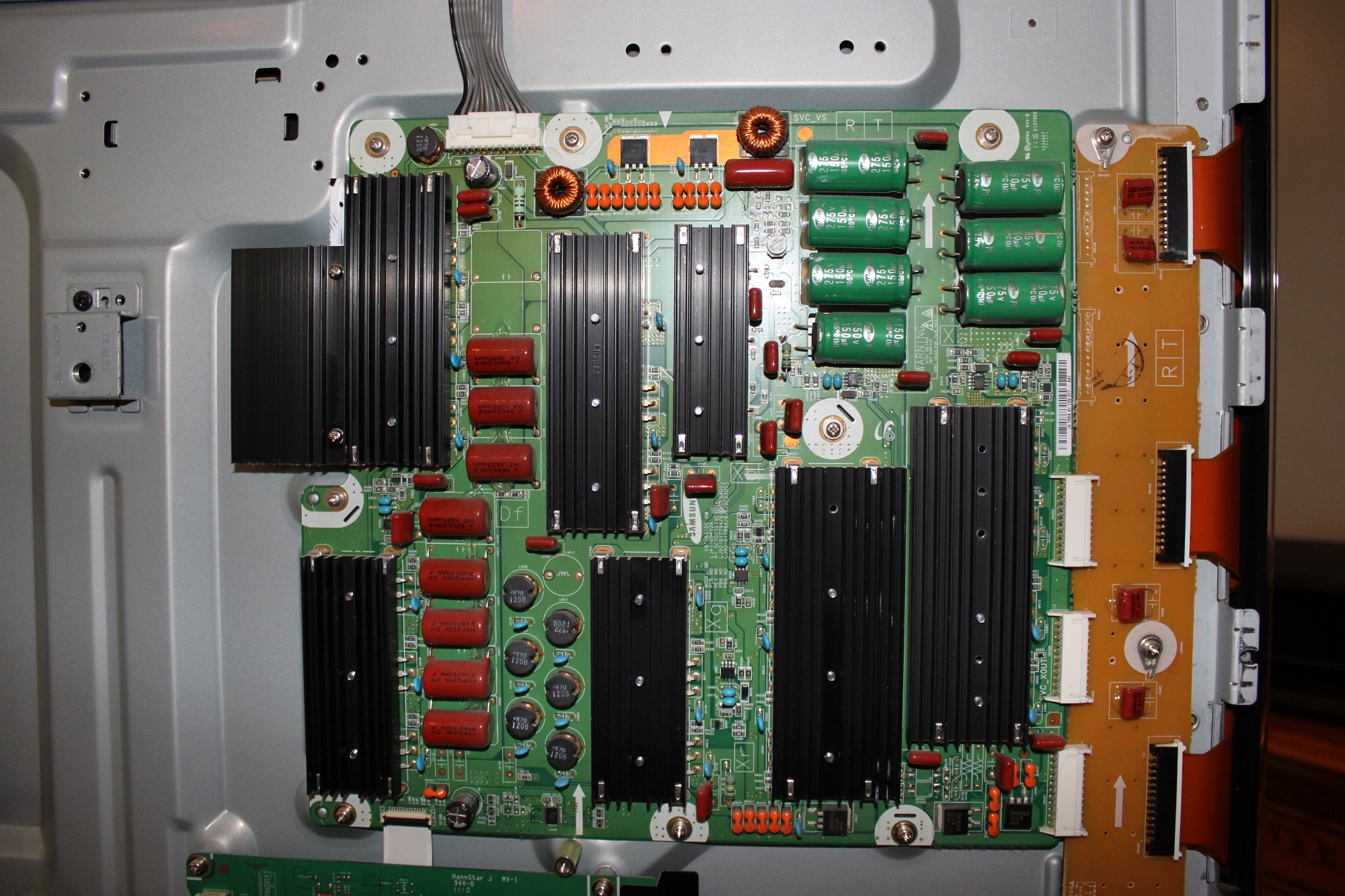

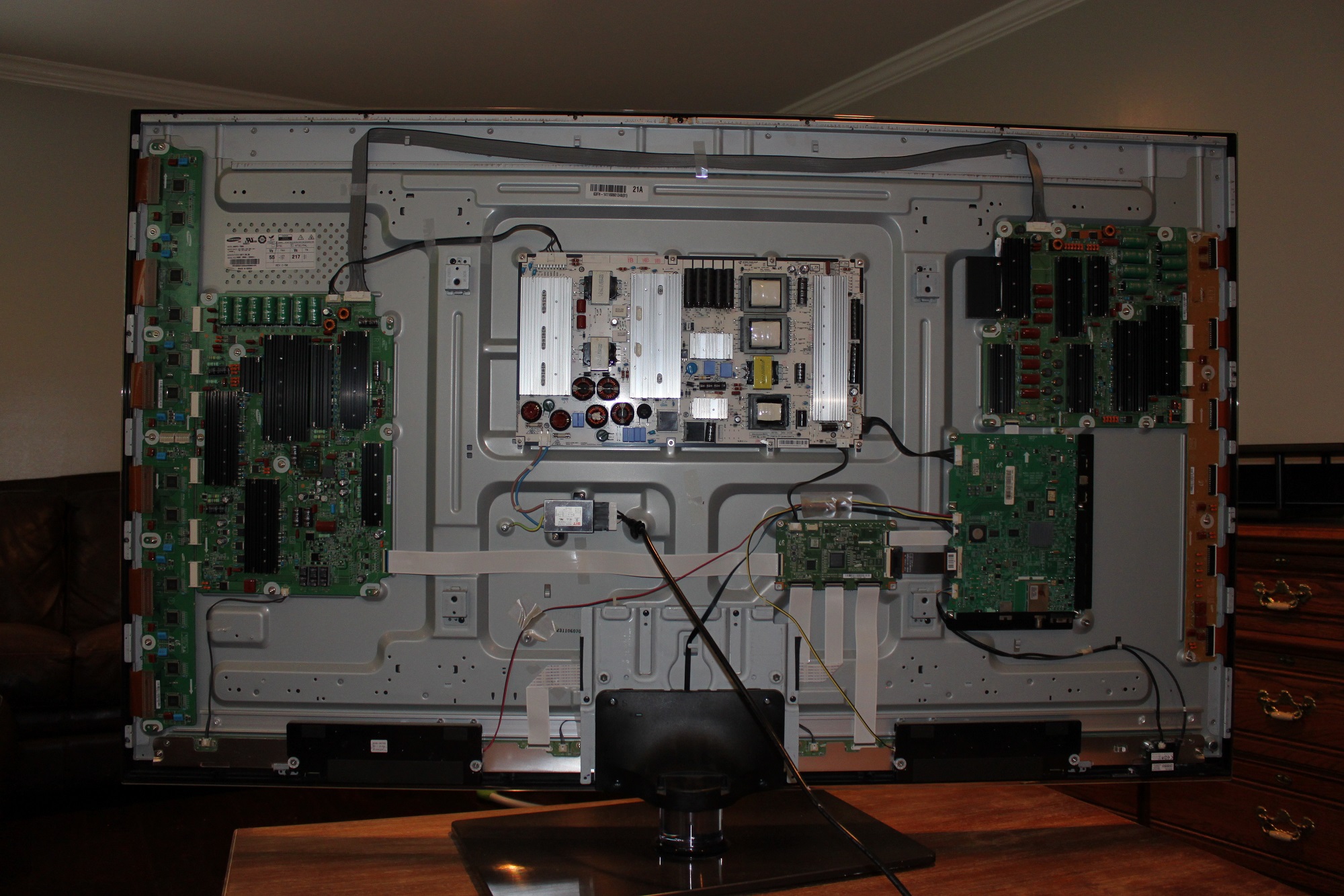

    Hi Guys,
    I have a Samsung Plasma PN64D7000 that has started having the flashing red LED issue on the front with no display. I've looked at a couple other posts here that have similar symptoms, but the troubleshooting doesn't seem to net me any results with my problem. I really like this television set, and I would like to fix it instead of tossing it for an OLED. Hopefully you guys can help me get to the root of the issue. I appreciate any assistance or suggestions anyone may have.
    When I plug the television into power, the red LED on the front flashes 5 times.
    When I push the power button, red LED light just flashes once, but nothing happens.
    I do not hear any noticeable clicks or sounds.
    The green LED on the logic board DOES NOT illuminate or flash at all.
    By visual inspection, there are no obvious scorch marks, blown capacitors, or broken solder joints. I have not removed the boards, so solder inspection is done just from the front side.
    I tested continuity across all fuses, and none seem to be open. It is possible I may have overlooked a fuse as I do not know where they all are located.
    So far I've:

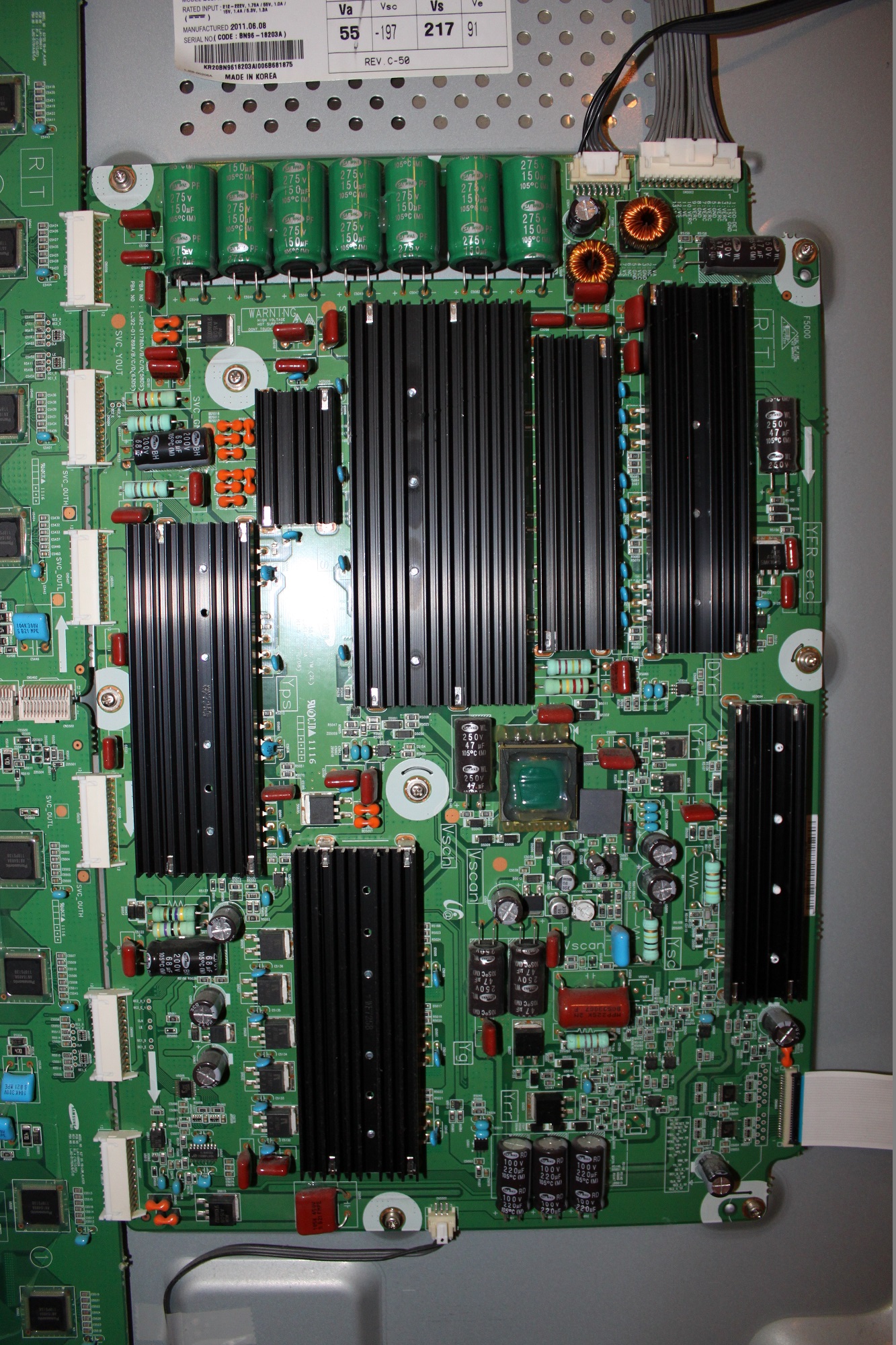

    unplugged the Y-sus and X-sus power cable, no change to behavior
    unplugged the power from only X-sus, no change to behavior
    unplugged Y-sus ribbon cable to logic board, no change to behavior
    unplugged X-sus ribbon cable to logic board, no change to behavior
    unplugged both X-sus and Y-sus ribbon cable to logic board, no change to behavior

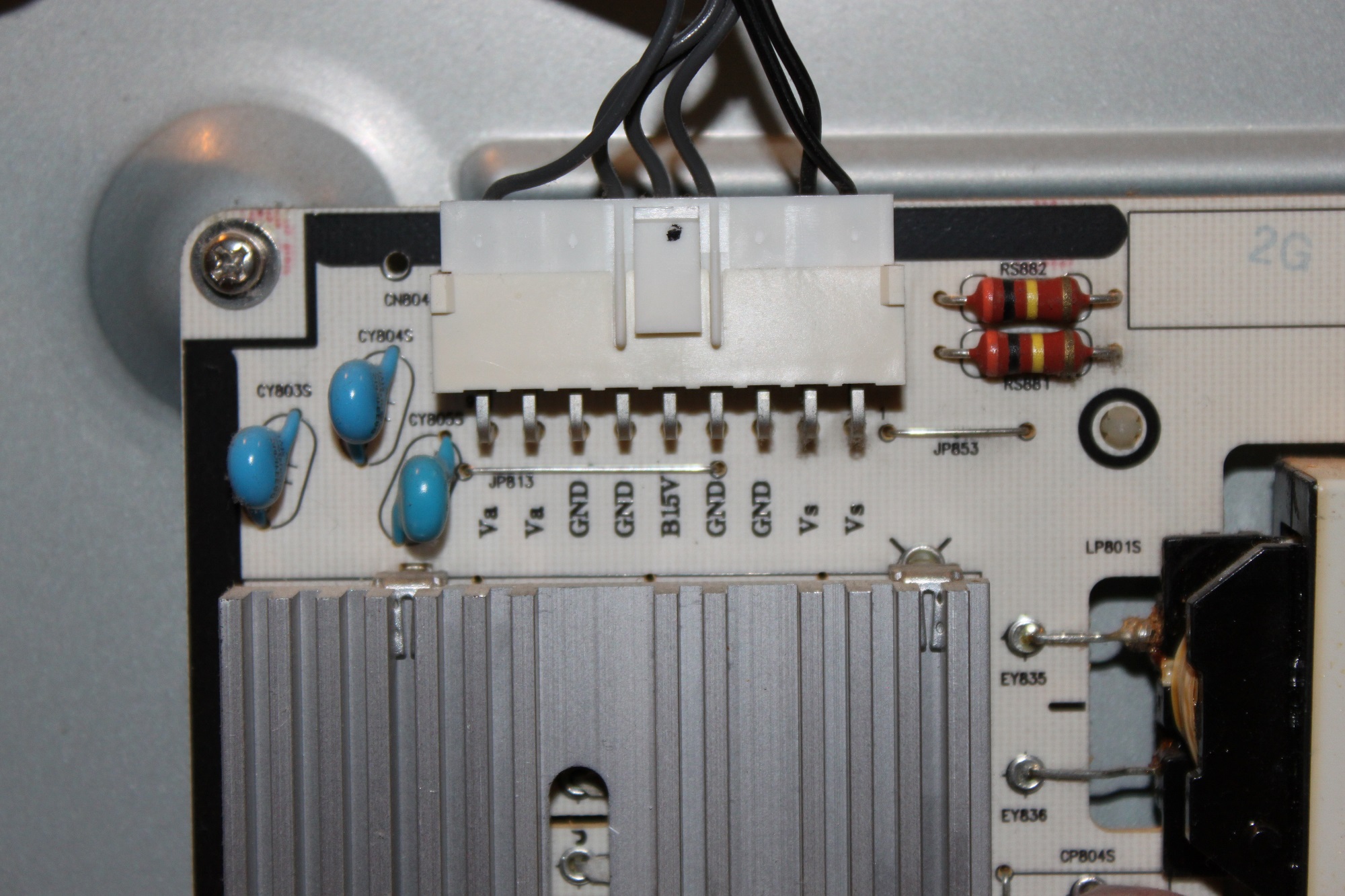

    I've tested the voltages with everything plugged in and got the following:
    Vs = 6.7 V
    Va = 0.0 V
    I do not notice any spike or change in Vs or Va during initial power up.

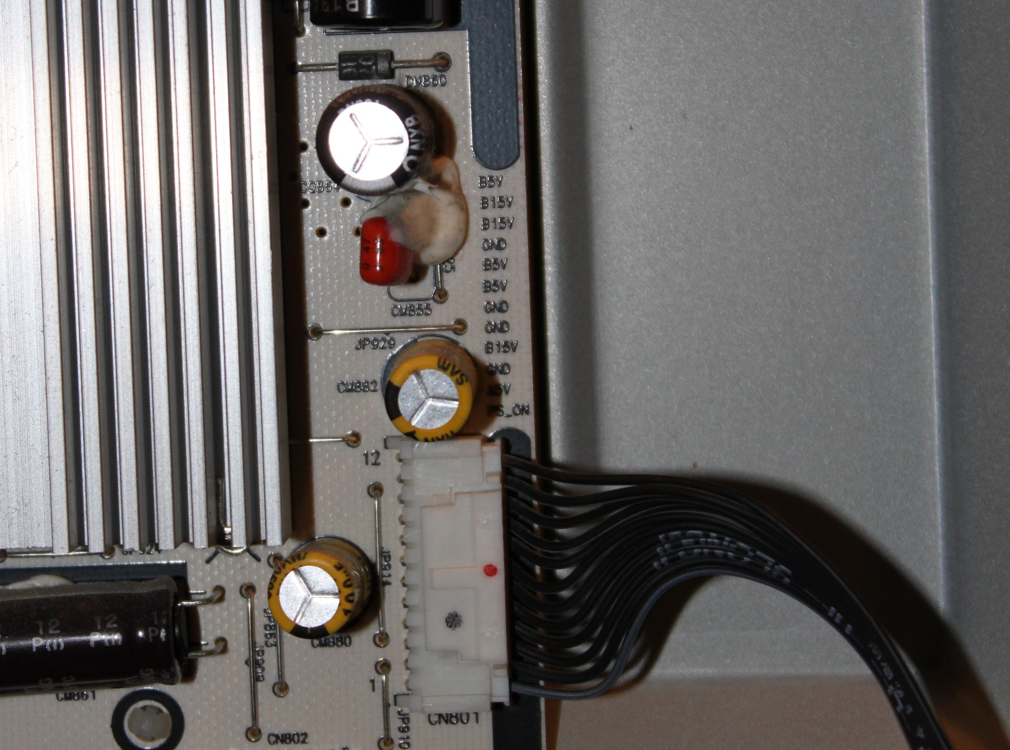

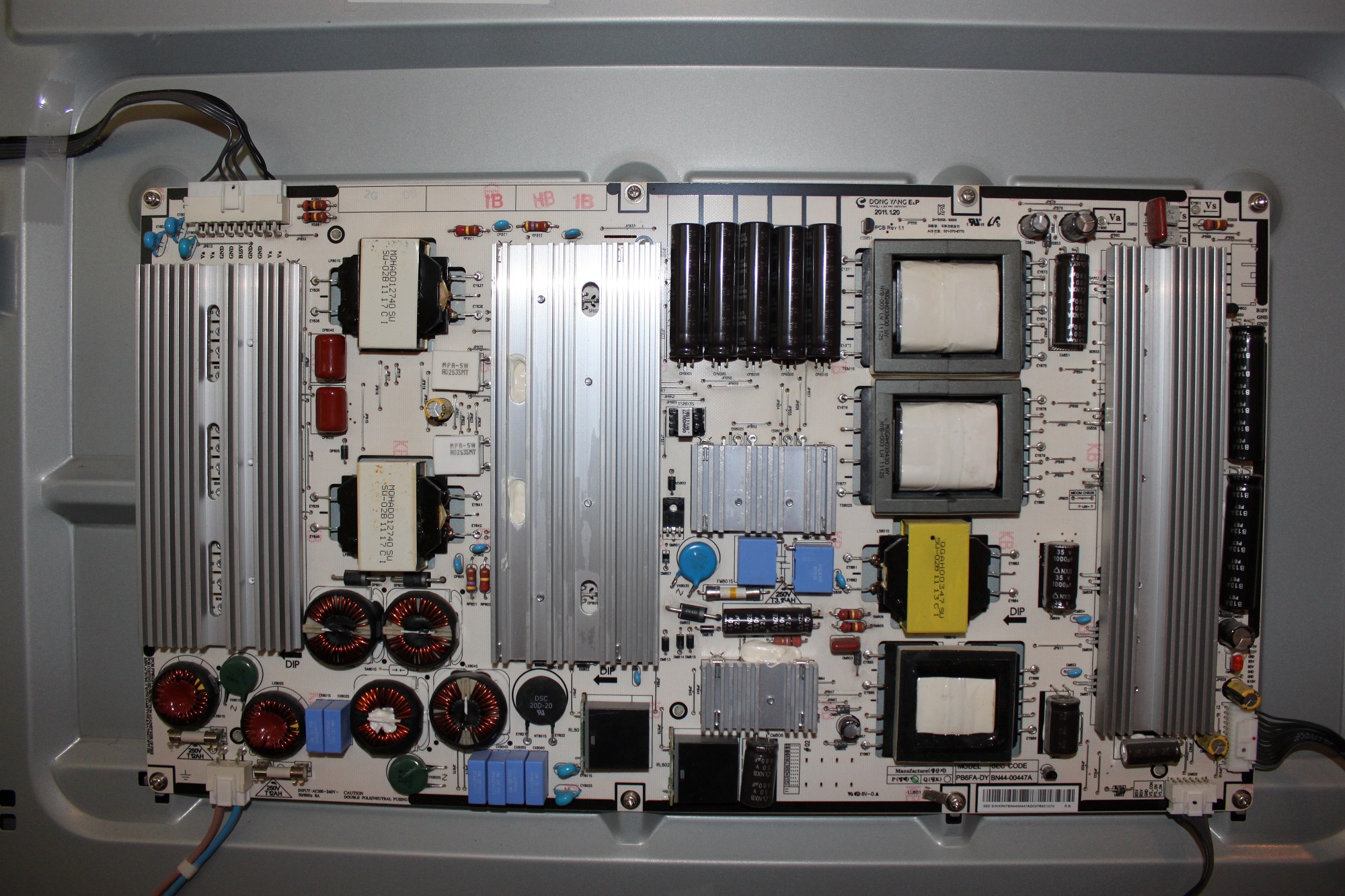

    I also tested the voltages from the PS board to the other boards, here is what I found:
    PS to Logic:
    B5V 5.3 V
    B5V 5.3V
    GND 0.0 V
    Vs_Con 0.0 V
    Ps_On 0.2 V
    Vs_On 0.0 V
    PS to Y-Sus:
    Va 0.0 V
    Va 0.0 V
    GND 0.0 V
    GND 0.0 V
    B15V 15.3 V
    GND 0.0 V
    GND 0.0 V
    Vs 6.7 V
    Vs 6.7 V
    PS to Main:
    B5V 5.3 V
    B15V 15.3 V
    B15V 15.3 V
    GND 0.0 V
    B5V 5.3 V
    B5V 5.3 V
    GND 0.0 V
    GND 0.0 V
    B15V 15.3 V
    GND 0.0 V
    A5V 5.3 V
    Ps_On 0.2 V

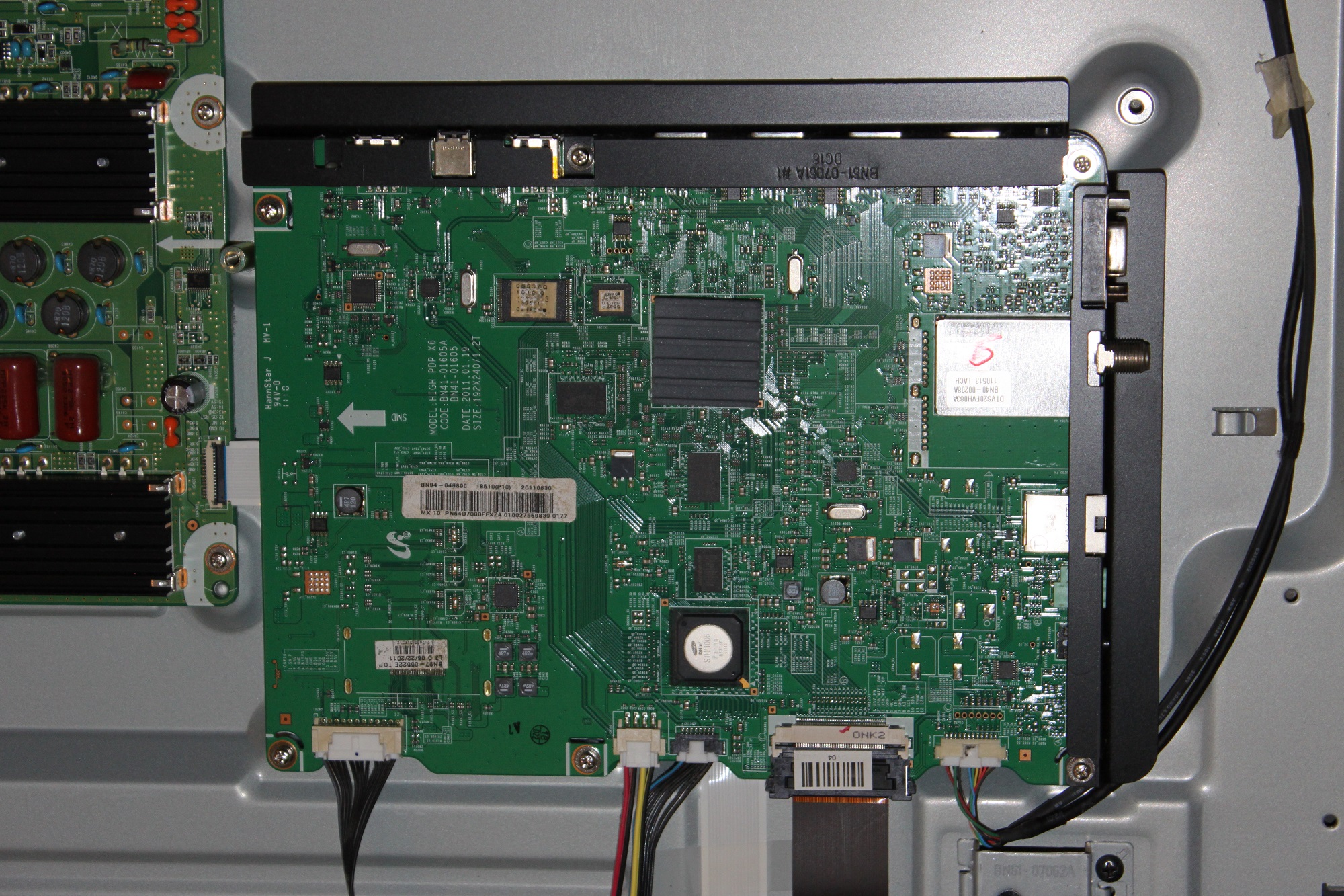

        If the voltage on the PS-ON pin coming from the main board to the power supply doesn't rise when the power button is pressed, then you almost certainly have a main board failure. I would not suspect the logic board based on your description. You should be able to jumper pins 3-4 on the logic board to produce test patterns on the screen which would prove that the main board is at fault. I'm unsure if anything else needs to be jumpered on this model to produce the test. Typically, the LVDS cable must also be disconnected. That's the ribbon going from the main board to the logic board.

          This is a 2011 model so your testing will not indicate fault after 3 seconds from switch on as all shuts down. You have to set up the test in readiness then switch on and immediately note what happens:. As said ps.on and vs.on should be checked and if ok then vs voltage but all within the first 3 seconds. Posts made earlier this year contain info.

            I will go ahead and see what happens with PS_On and Vs_On at startup. I tested Vs and Va when plugging power in, but I noticed no change in voltage with those two points at startup versus staying on.
            Just planning ahead here, but if indeed my mainboard is bad, am I pretty much tossing this television? I've looked around for a BN94-04689C, but it seems that availability anywhere is basically none. Even on Ebay, I just see offers to rebuild boards. No actual functioning ones. Shopjimmy and Encompass parts don't have it either. Does anyone have a source for this?

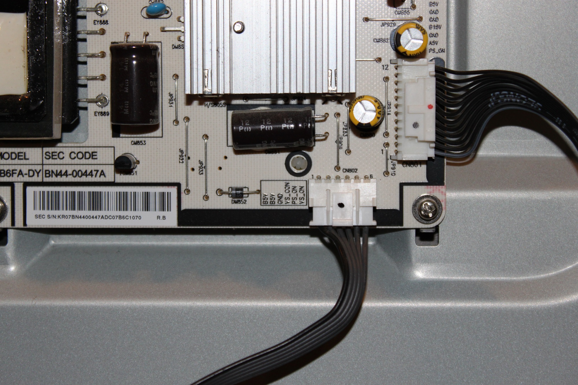

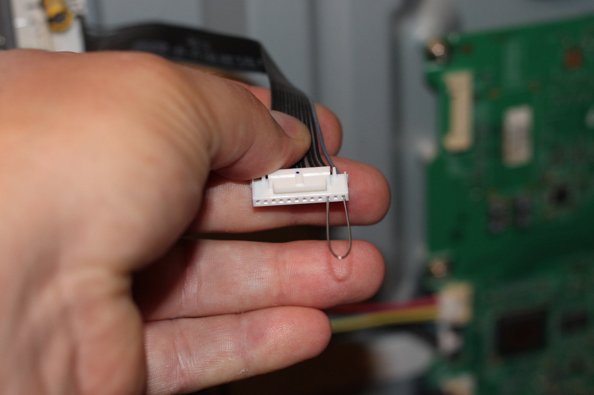

                I am looking at the Samsung fast track troubleshooting manual, and I need a little clarification on running the test pattern.
                The instructions state:
                Short "power on" pin to circuit ground on power connector to SMPS.
                Does this mean I take pin 1 "Ps_On" and just short it to pin 3 "GND"? I would have thought that a voltage would need to be sent down Ps_On to trigger an action. Instead, the instruction seems to state to short it to ground. I probably just don't understand the sequence on how everything gets turned on.
                Thanks again. I appreciate all the help.

                  It can be a bit confusing as some switch on circuits have voltage go low while another in same set may have it go high e.g. ps-on and vs-on. Your set doesn't seem to have vs activating at all but there should be time before auto shut down to see any reaction at switch on. Bit different that vs-on goes via control board.

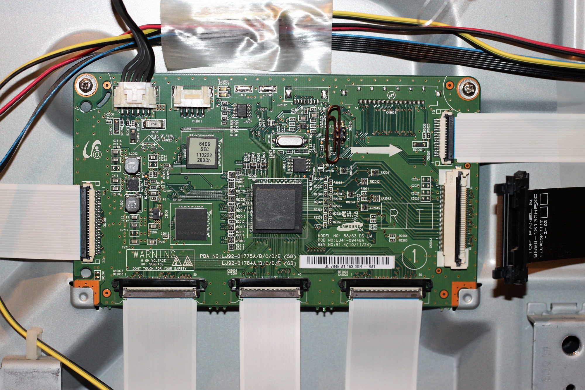

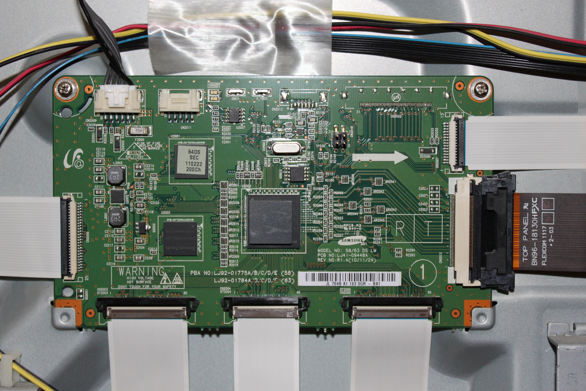

                    So I tried to run the logic board test pattern. When I plugged in the power, there is an audible click, but nothing happens. The screen remains blank. There is no green light illuminated on the logic board, and no red light on the front of the television.
                    I watched Vs when the power is plugged in, but I do not see it jump or rise. I've attached photos showing the test configuration. I verified continuity between pins 1 and 3 on the main power board connector. I also verified continuity between pins 3 and 4 on the logic board. I used a paper clip to jump the pins since it is what I have on hand.
                    I've attached the photos of the test configuration so it can be verified I did it correctly.
                    Any ideas on where to go from here? Thank You.

                        If by control board, you mean the logic board, than no, there is not a flashing light. During the test, there isn't an LED anywhere flashing or illuminating.

                          I'm referring to this one: https://www.badcaps.net/forum/attach...1&d=1502474021
                          That light should flash whenever the B5.3V is on. Can you test the voltages either side of fuse F2000 on the control board?

                              Re: Samsung Plasma PN64D7000 Flashing Red LED No Power
                              Both of the LEDs are green, I doubt they will have failed, I think normally only one flashes and the other is always lit but I can't be sure.
                              The fuse is a Littelfuse 451 surface mount fuse. I'd expect ~5V both sides of it.

                                So I tested the fuse labeled F2000. The left side of the fuse, I am seeing 5.3V. The right side of the fuse, I am seeing 0.4V. Going to venture a guess this isn't right.
                                I also tested the resistance, and get some odd results. It starts out at 3 kOhm right after being disconnected from the power, and continues to climb > 15 kOhm after sitting awhile. This seems counter-intuitive as I expected resistance to increase with voltage applied as this would raise temperature. Looking at the specs for the 5A Littlefuse, I should see a cold resistance of 0.0125 Ohms. So something is way off.
                                My multimeter is a cheapo, so I would take the accuracy of readings with a grain of salt. But I would venture to say that the readings I am seeing indicate an issue with the fuse. I'm going to suck it up and buy a proper meter tomorrow.
                                I found the fuse on Amazon and put an order in. They aren't very expensive, so I figure why not. Would it be a poor idea to jumper over the fuse and see if the television turns on? Would you suggest any additional trouble shooting while I await the arrival of a new fuse?
