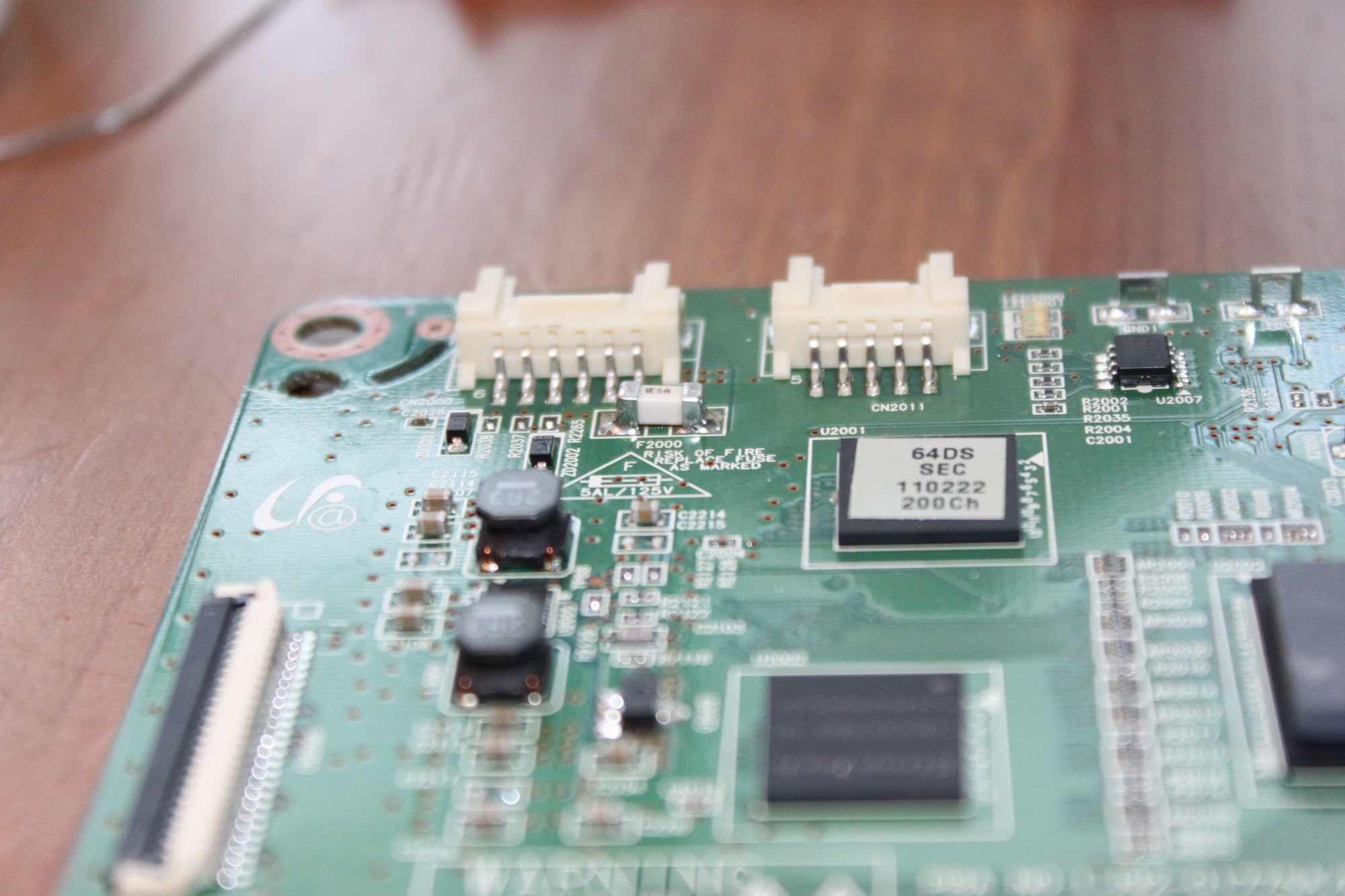

      Both of the LEDs are green, I doubt they will have failed, I think normally only one flashes and the other is always lit but I can't be sure.
      The fuse is a Littelfuse 451 surface mount fuse. I'd expect ~5V both sides of it.
      You can test the power supply without the control board but right now I'd be more interested to see if or why the control board isn't firing up the power supply.

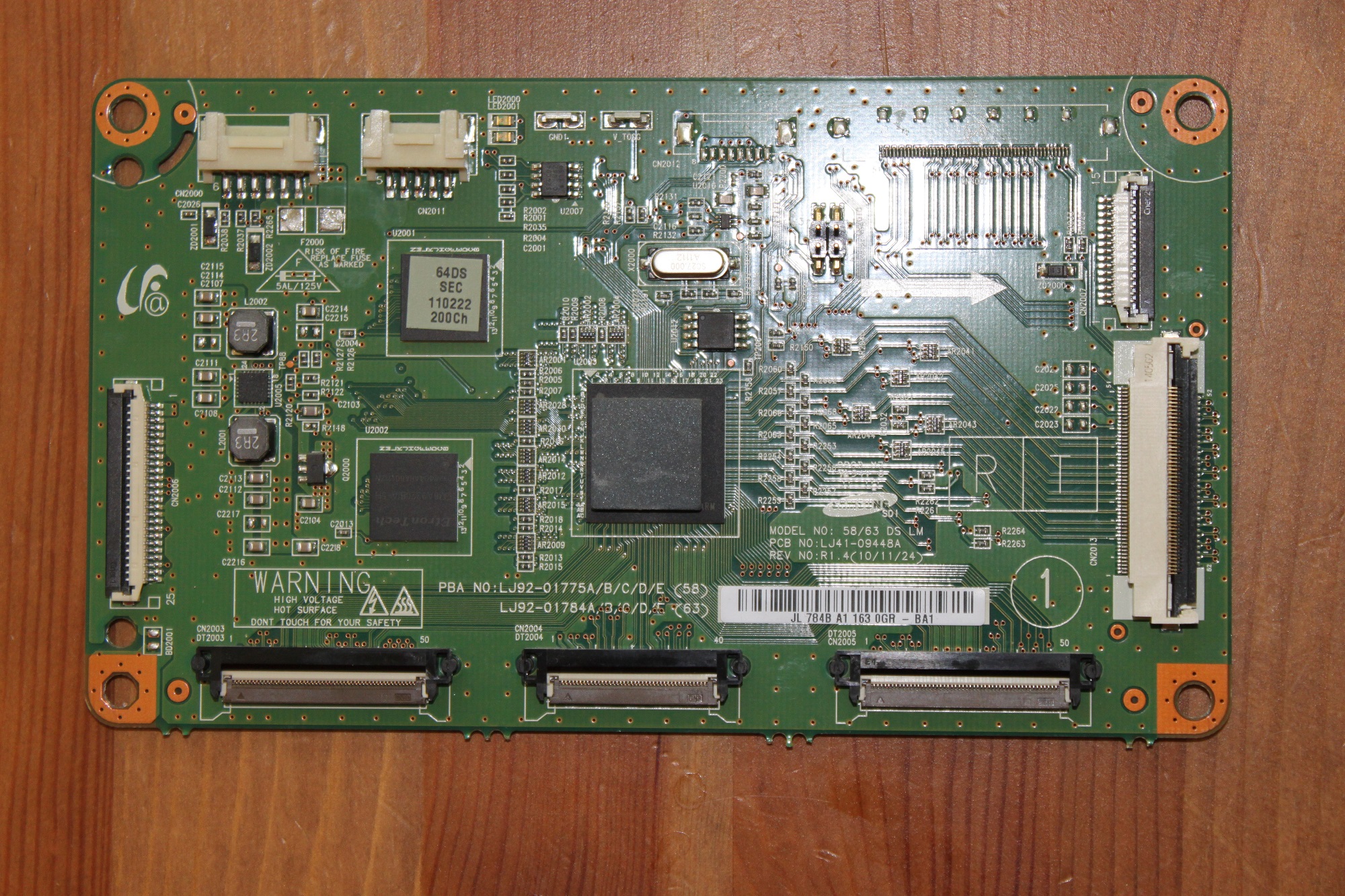

      So I finally have an update. It took me awhile to receive the fuse. Once I had it, I went to Lowes to get some rosin flux and thin 63/37 solder. Lo and behold, all they had was acid flux and only one choice of thick 60/40 electrical solder. So I had to place another order from Amazon for the solder and flux. Not sure where a DIYer is supposed to get this stuff after Radio Shack stopped being a tinkerers paradise and eventually closed up.
      Anyways, I got the old fuse removed and installed the new one. My soldering skills aren't the greatest, but I got the job done. At F2000 I now get 5.3V on both sides. The green LED on the logic board now turns on.
      But, a powered logic board didn't seem to solve my problem. Upon plugging the TV in, I get a click, the green LED now illuminates on the logic board, steady for about 3 seconds and then it goes to slow blink. I still get the flashing red LED on the front with no effect coming from hitting the power on button. The only change I see after installing the new fuse is the logic board is now getting the 5.3V and the green LED illuminates.
      I once again isolated the motherboard and ran the logic board pattern test. Upon plugging the TV in, I get a single clicking sound, the green LED illuminates steady for about 3 seconds, and then goes to a slow blink. There is no picture on the screen.
      I have been plugging the TV in while monitoring Vs. It does not rise or jump over 5V.
      The only change in behavior I get is when I unplug the ribbon cable from the Y-sus board. When I do that, I get a continuous clicking noise, and Vs will rise to about 15V. The logic board continues its steady blinking green light, and no picture appears.
      No other combination of unplugged ribbon or power cables does anything. Even with both the Y-sus and X-sus boards unplugged, Vs does not get to the specified voltage when plugging the TV in.
      Any ideas on where to go from here? Thank You!

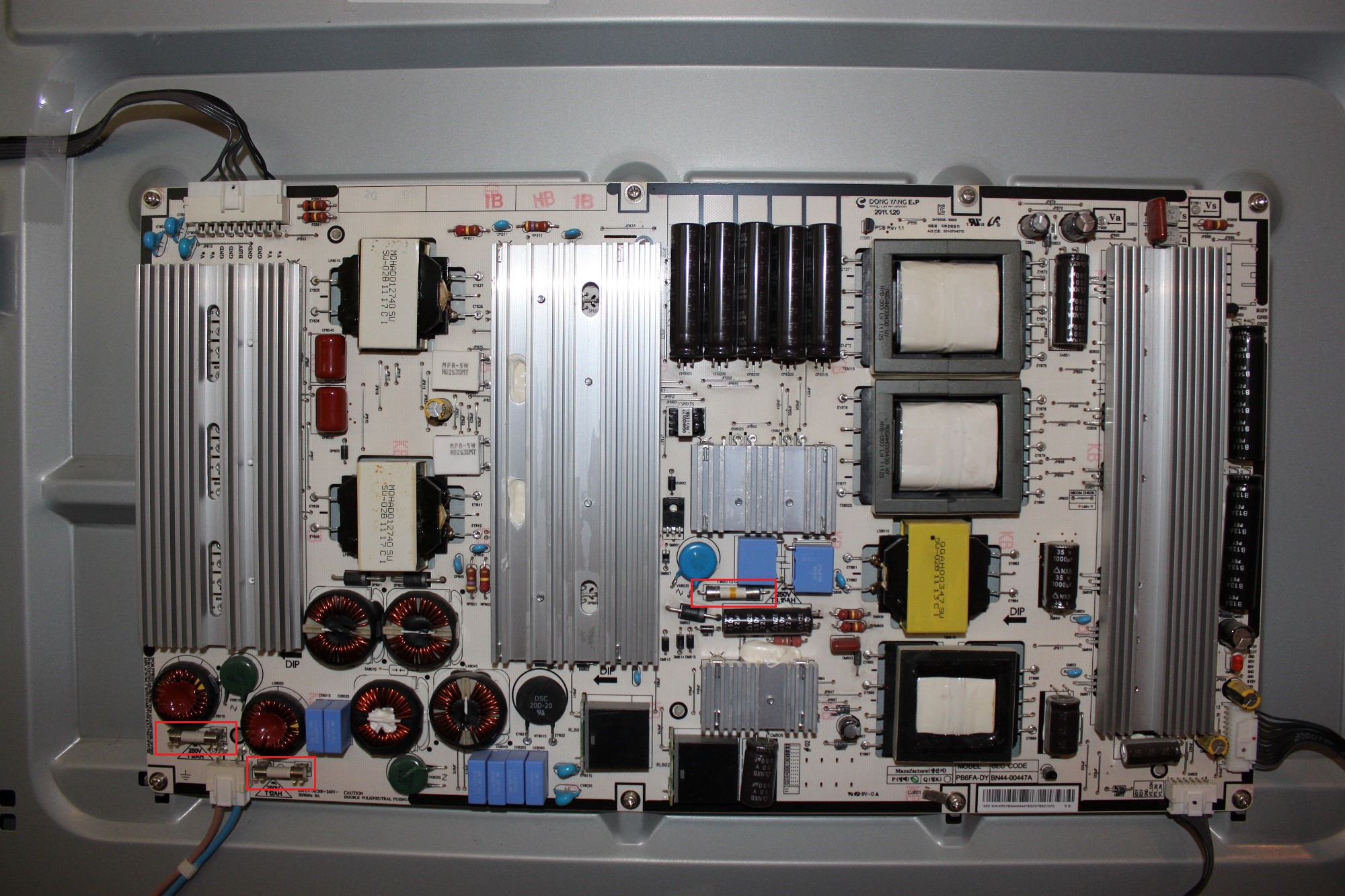

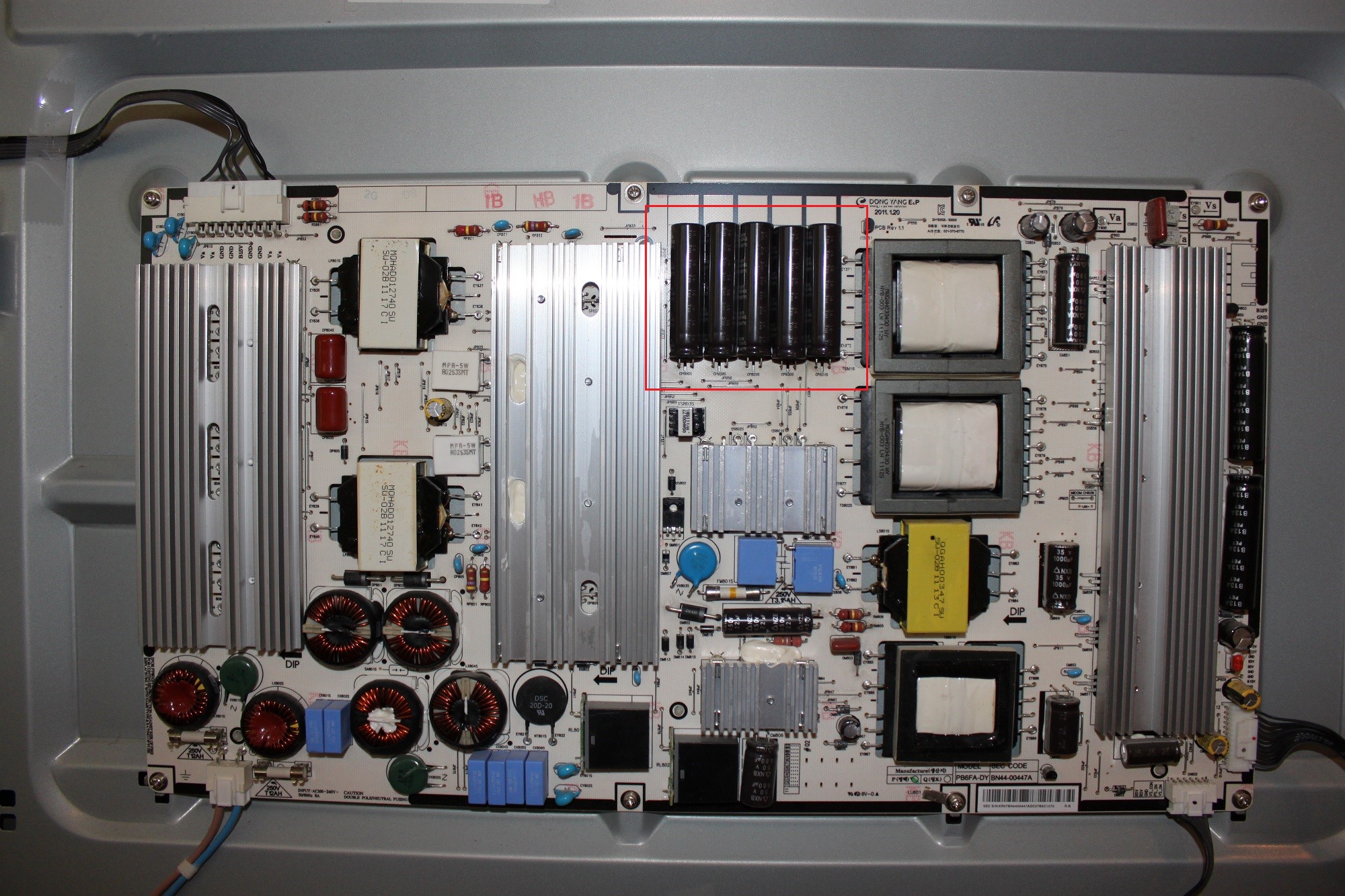

                  I get 0V at Va at plug in, and it does not change over time.
                  All three fuses I marked in the attached photo have continuity. If I have missed any, let me know and I will check them.
                    #29
                    Re: Samsung Plasma PN64D7000 Flashing Red LED No Power
                    Looks like you got all of them.
                    What voltage do you get across any of the large 5 capacitors above the fuse while the TV is switched on in the test pattern mode.
                    Note: they are all in parallel so need only test one. Careful, it's the high voltage side. Be careful not to slip probes or you may blow fuses or cause further damage to PSU. (Unlikely to damage other boards, though. But it would make a right old bang!)
                    • FrivolousShrimp
                      • Jul 2016
                      • 40
                      #30
                      Those are pretty high voltage. I had to crank the multi-meter range to the top end!
                      If the capacitors outlined in red in the attachment are the ones you wanted me to test, they move between 375V-389V.
                        #31
                        Ok, that's good, it means the PFC booster is working (390V nominal)

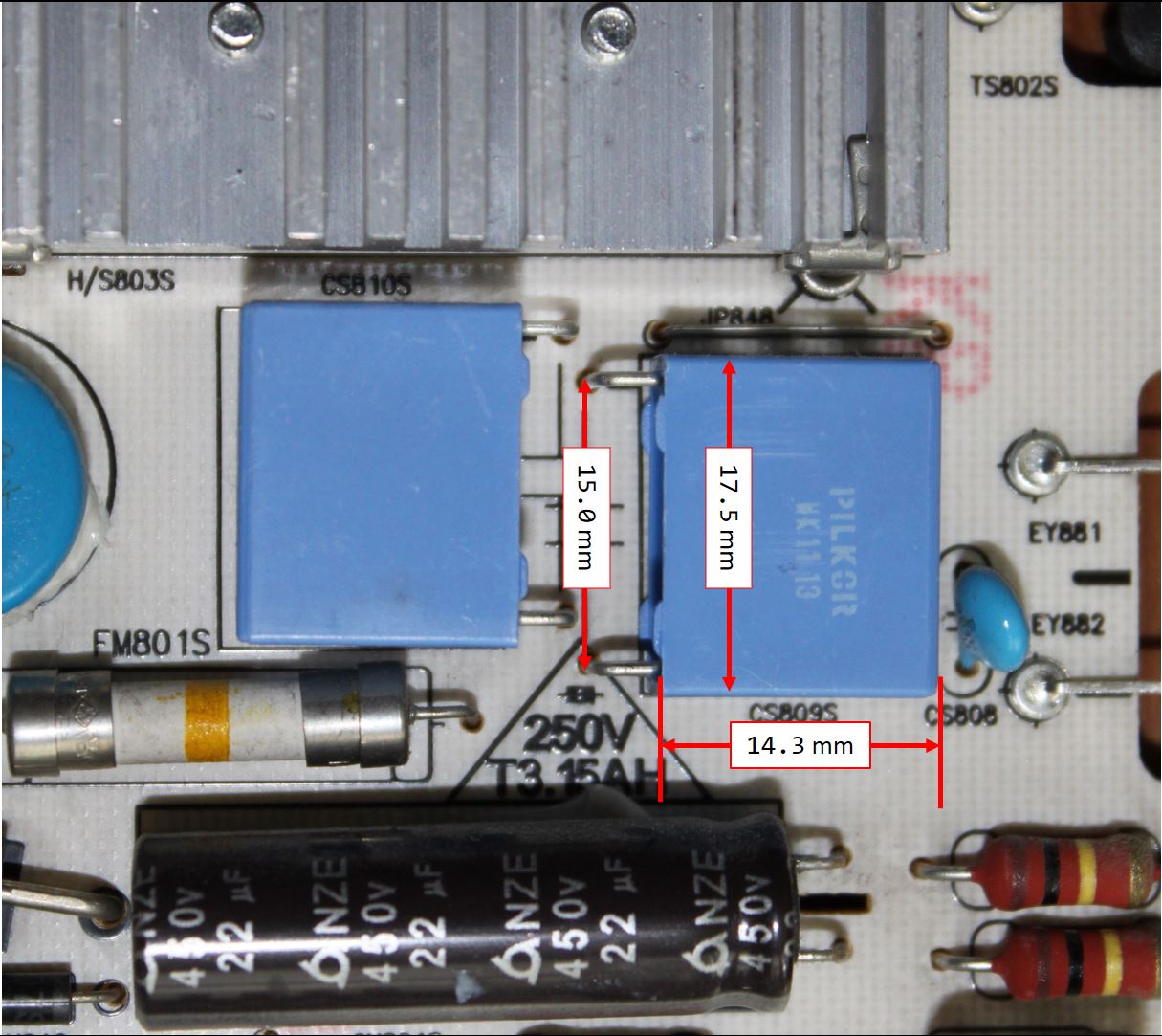

                            It *may* be worth exchanging the two blue caps in the centre of the power board - the ones that are rectangular. These can fail and cause this type of symptom. It's vital you use the right type of capacitor so if you want to go this route, get me a pic of the capacitors and the dimensions (width, height, spacing between pins) and I'll look for a suitable replacement.
                              Unfortunately, I do not have an oscilloscope. I'll ask around and see if any of my friends may have one, but I have my doubts about it.
                              The capacitors are 14.3mm wide x 17.5mm long x 8.5mm deep. The spacing between the pins is 15.0mm. I've attached photos of the capacitors.
                              I do have a capacitance tester. Is it worth removing them to test? My only concern is getting them in and out without damage. I imagine I can snip their leads off and solder them back on there. This way I'm not fighting to keep solder hot at two locations on the board to try and get them out. Also, it appears they are marked as 33nJ. Why would it be in Joules instead of Farads?
                              I am wondering since my PSU board is suspect, is it worth just sending off to PTS electronics? It looks like they have a repair and return option for $68. That seems like a pretty reasonable price. This is the link to their site: http://www.ptselectronicsinc.com/bn44-00447a/ .
                              And since I have a Y-sus on the way, should I swap it out and try anyway? Or just leave it be and return it.

                                Up to you if you want to try and repair it or send it off. For that type of capacitor I'd suggest removing it completely rather than snipping leads. They can be desoldered by alternating the soldering iron between both pins while gently prising it off the other side. If there's any glue surrounding it (white blobs tacking it down), remove that first.
                                The "J" simply refers to the tolerance of the capacitor, J meaning 10%. They are 33nF capacitors. A joule rating would be meaningless as it would depend on the voltage across the capacitor. You can test the capacitors for capacitance, though ESR is not a useful measurement. They will be small in value.
                                As it is, your new Y-main will do nothing as your Vs is too low. There might be several faults on this TV if it was subject to power surge damage or something of that nature. So might be worth hanging onto that board for a bit before you return it, just in case.

                                  I guess I can give swapping the capacitors a shot and see what happens. If that doesn't fix it, I'll put the original ones back in and send it to PTS. I spent some time looking around for direct equivalents. I imagine I need to stick with the film capacitor. It seems Digi-Key has quite a few options, but only one is actually stocked. Everything else I saw has a lead time of weeks. Is this one an acceptable replacement?
                                  https://www.digikey.com/product-deta...132-ND/4157191
                                  The only issue I see is that the seated height of 18mm may be too high. From my measurements, I need to be around 14.3mm. When I bend the leads and install it laying flat, it might bump into the little blue ceramic capacitor behind. Even so, I can install and test the capacitor to see if indeed that was the problem.

                                    I would suggest this one. I think it should fit:
                                    https://www.digikey.com/product-deta...142-ND/5414292
                                    The Rubycon one might work, but it's a different type of capacitor and I'm not sure how it will perform. The capacitor is utilised as a coupling capacitor in a high-frequency, high-energy LLC resonant circuit. A lot of long words, but essentially means the capacitor needs to be rated for this type of operation (high pulse operation). LLC is used to reduce electromagnetic emissions, audible noise, and improve energy efficiency.
                                    Make sure the capacitor is clear from other components.
