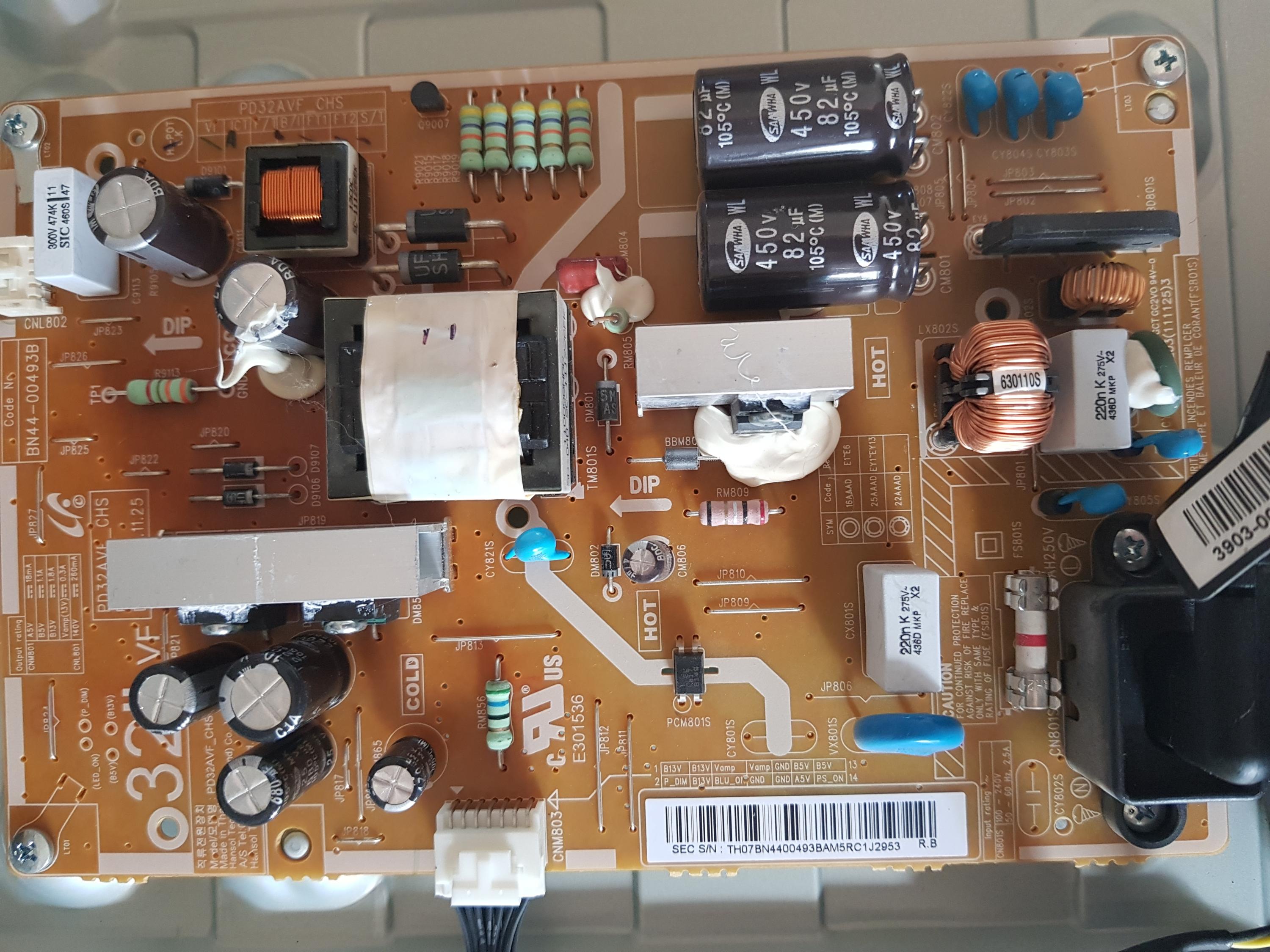

    Hi Guys i have the Samsung LED model UE32EH5000 when it is switched on i get no backlight. i have tested the LED strips and all check out. the voltages i get from the power supply to backlights is.
    182v
    182v
    0v
    278v
    278v
    and the voltages i get from PSU to AV board is.
    13.10v
    13.10v
    13.10v
    13.10v
    0v
    5.27v
    5.27v
    0.90v
    13.10v
    4.88v
    0v
    0v
    5.29v
    3.54v
    does anyone know what the issue is or what i can do to further troubleshoot. thanks.

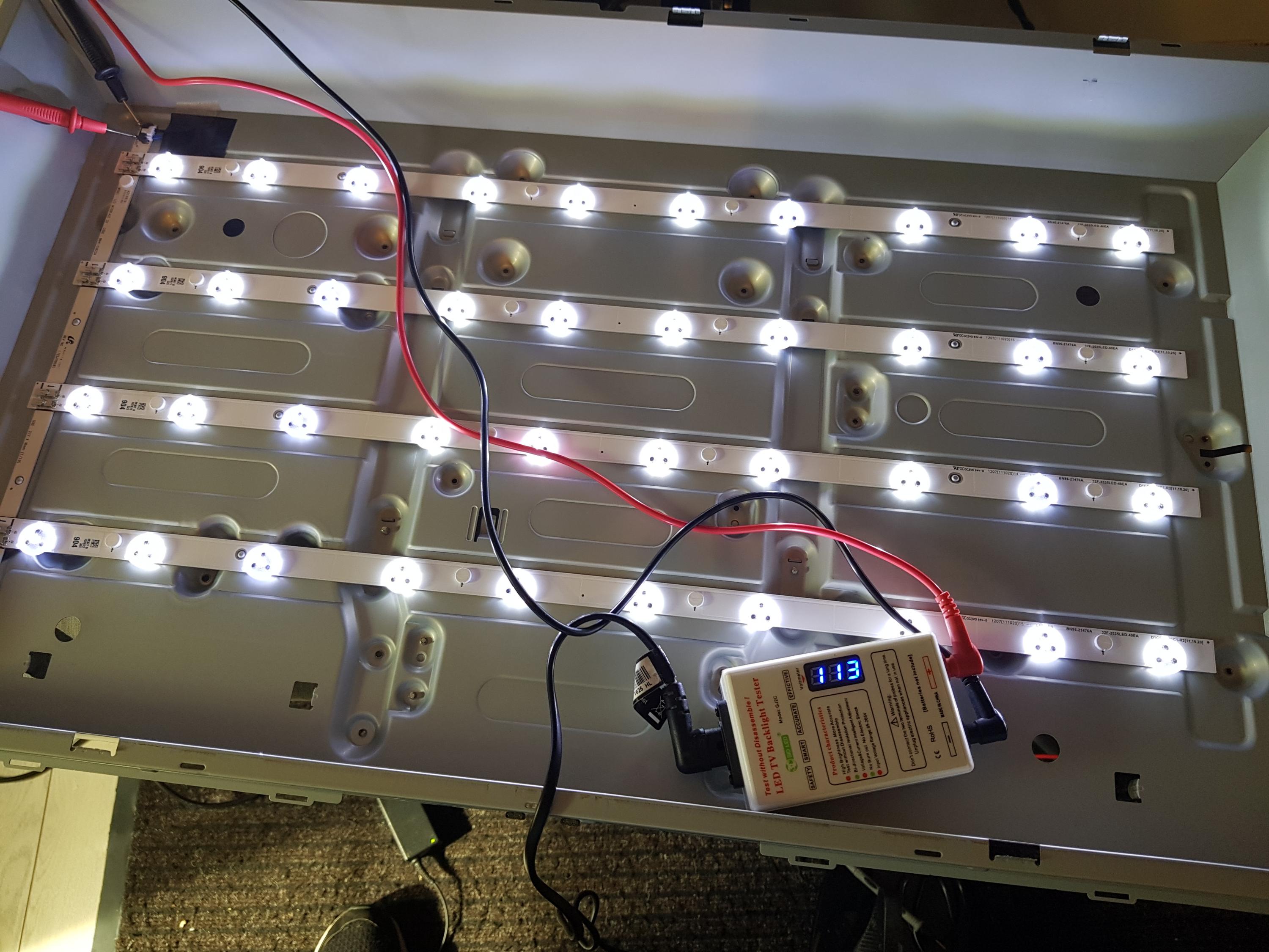

    How did you test the LED strips?

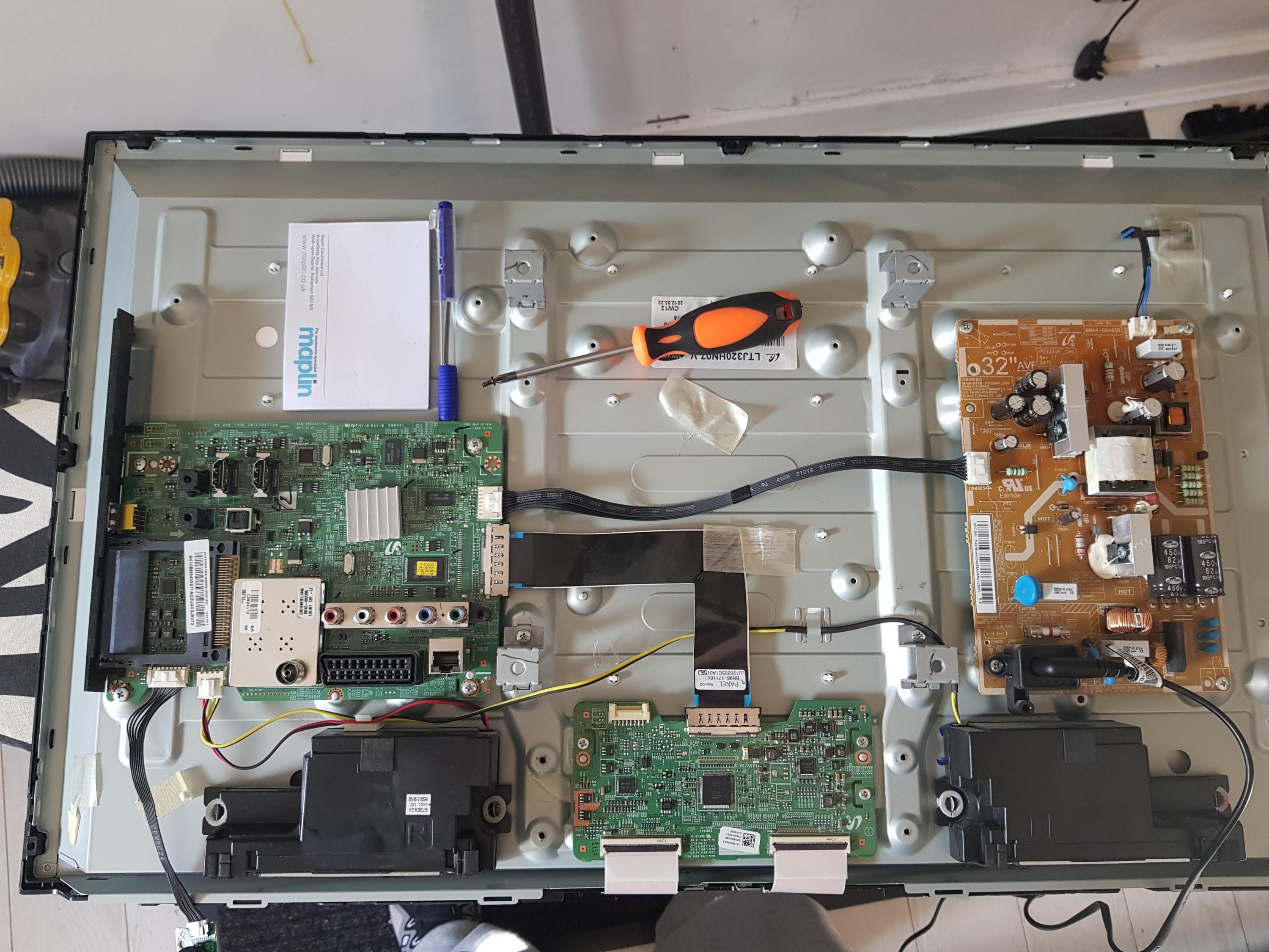

      hi there thanks for quick reply. backlights do nothing at all when tv turns on. tried it with cable to main disconnected and got no blinks from backlights at all. i tested the led strips using a LED tv backlight tester and all when on no proeblem as i stripped screen out to check.

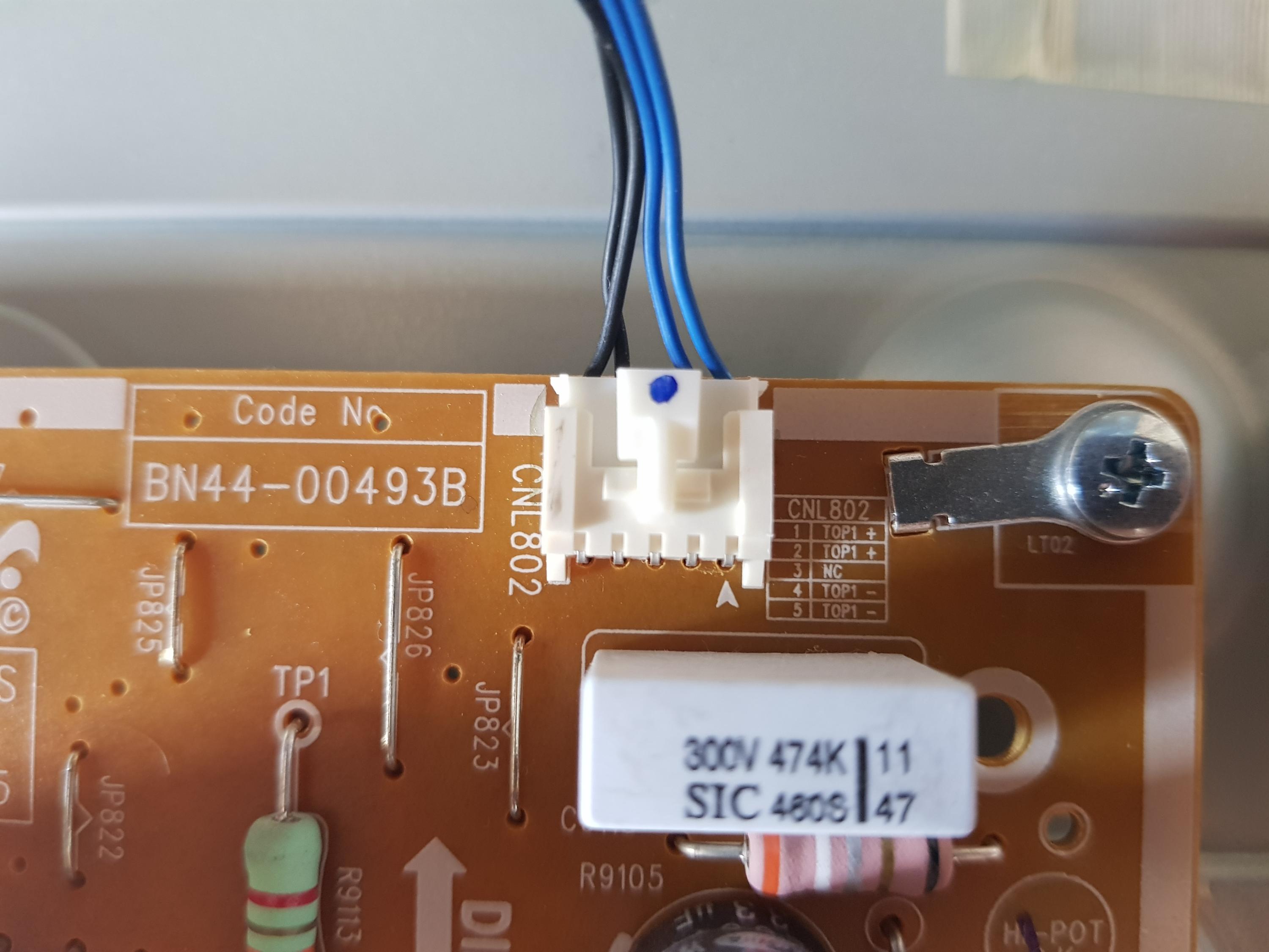

            I believe they are all connected in series since Pin1 & 2 are TOP1+, Pin 3 no connection Pin 4 & 5 TOP1-
            Also 140V for 3V leds would be approx 47 leds in series.

                The LED power supply Voltage chart shows 140V as printed on that power supply board.
                What Voltage does it show on your LED tester?
                Since you are getting 278V then it has open circuit some where.

                      Right now the power supply is not seeing the load so its output went up high.

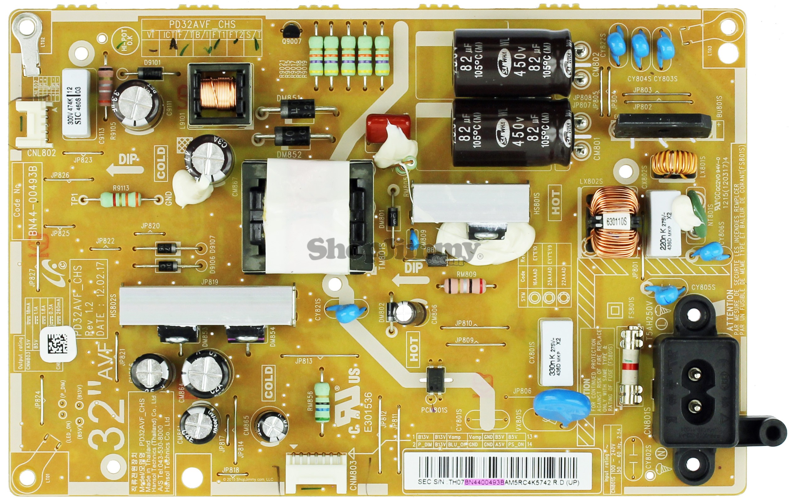

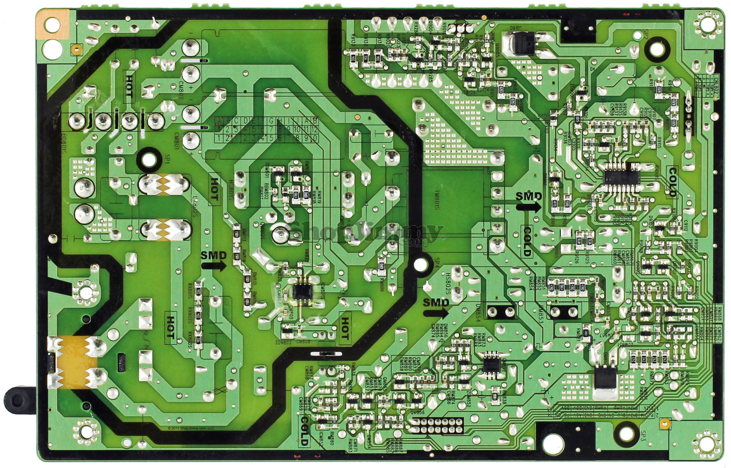

                        OK, I just look at the bottom side of the board at shopjimmy, the LED return is done through the MOSFET inside the LED driver controller IC 9101S.
                        Get the P/N of that IC so we can look up the spec. sheet.
                        Pictures provided by shopjimmy.
                        BTW, no one work on this TV before, right?
                        Shop jimmy only shows 2 LED strips.
                        http://www.shopjimmy.com/samsung-cy-...s-2-strips.htm

                          tested led strip with tester as a whole and per strip. i am getting 113v for whole string and 28.1v per strip. @Budm the IC P/N is PC1AC SLC101 0

                            It looks like in post #1 you measured the led voltage with reference to chassis, You should measure across cn802, positive probe to pin 1 and negative to pin 5

                              @R_J yes i measured with MM from ground on chassis and red probe on pins. will do that just now and reply.

                                with probes on 1 and 5 i get 0v with multi meter set to 200 and 250

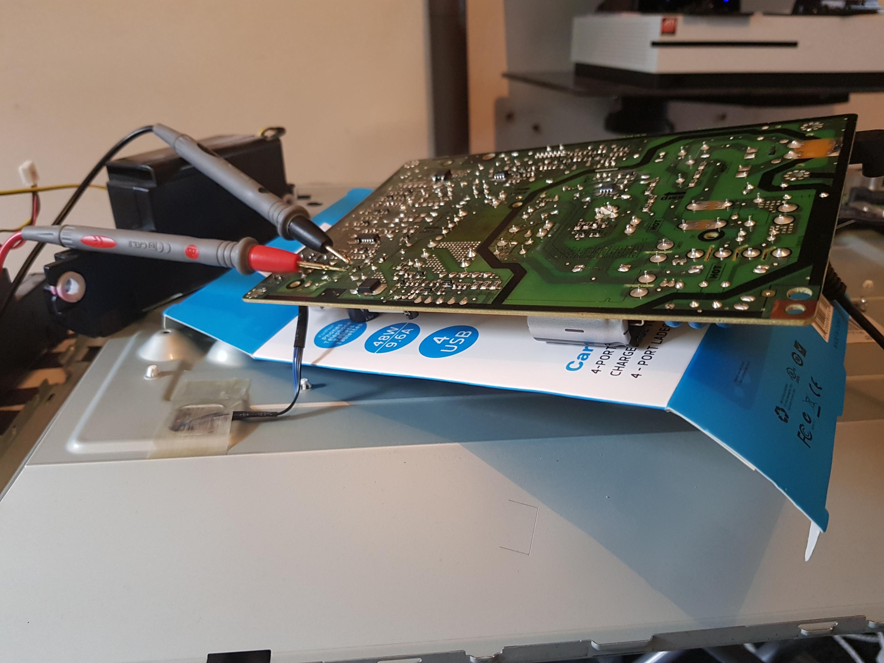

                                  What voltage do you get across C9111, you may need to check that when you first turn the tv on.
                                    Re: backlight issue Samsung UE32EH5000
                                    ok i flipped up PSU to read voltages on C9111. when i plugged in it went to 14, 17 then 19 then 1 displayed. i unplugged tv and voltage appeared 180 or so tjen gradually dropped. took 2 minutes for it to go back to 0v after switching off from plug.
                                      That means the GND return for the LED is open which will be the internal MOSFET inside the LED controller IC. I did not look up the spec sheet for that IC yet.
