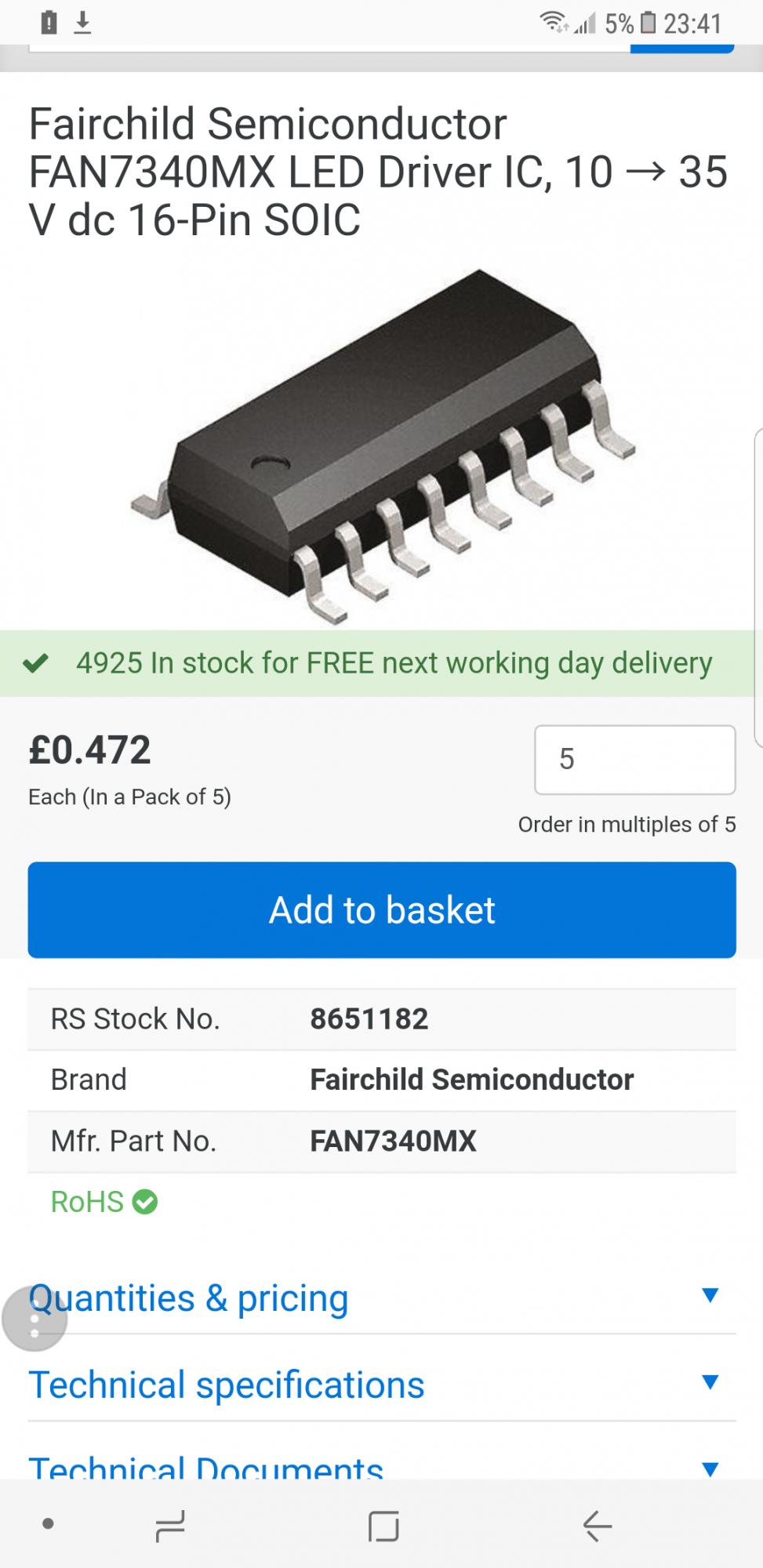

            Re: backlight issue Samsung UE32EH5000
            ok thanks. would this do ?
                                        Originally posted by Mikeyboy2007 View Post
                                        i will try that and report back. i have ordered a replacement IC also so should be here tomorrow morning.
                                        Great. I ordered mine too eventually from somewhere else but will have to wait till next week, so please let me know how things go
