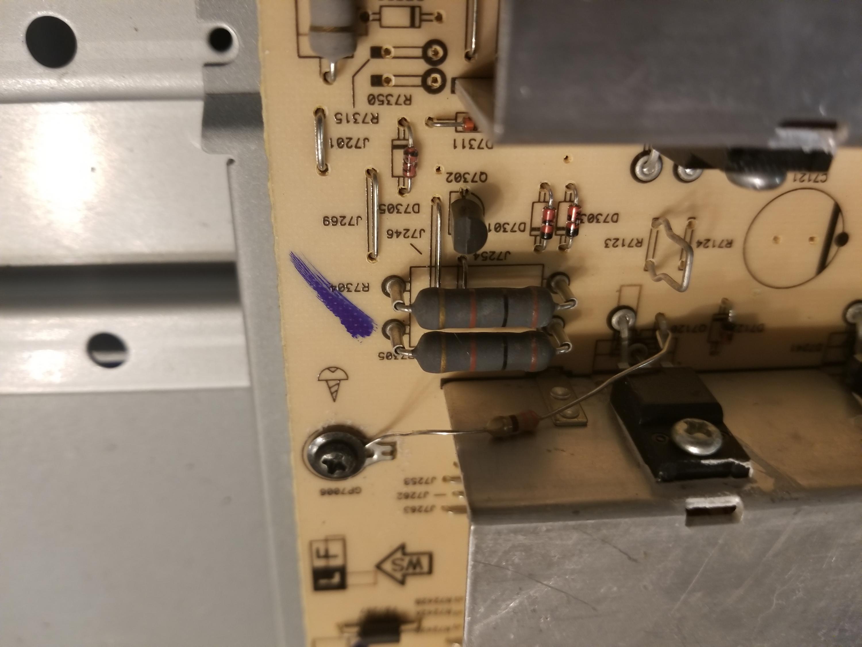

                    #49
                    Re: Sharp LC-60E79U problems
                    Here is how I added the 330ohm resistor
                      #50
                      It will need more indepth troubleshooting in that GATE drive circuit. I will have to look at real good clear closed up pictures around that Gate pin to see how it is driven, or we can use the added inverter circuit to take the BL-ON (STB pin?) signal to turn it into active low to control that MOSFET.

                            #53
                            if you plan to use it that way, you should solder the leads.
                            • Redrebel10
                              • Jun 2017
                              • 89
                              #54
                              Thanks so much bud, it's my personal tv to put on my back porch so I'm just soldering the resistor and using it like this, your help is greatly appreciated
