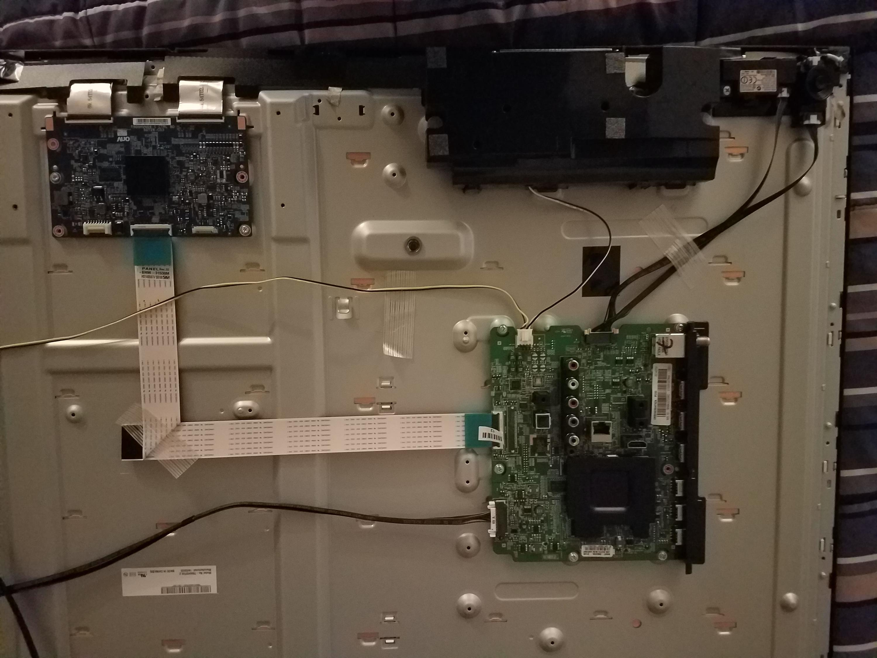

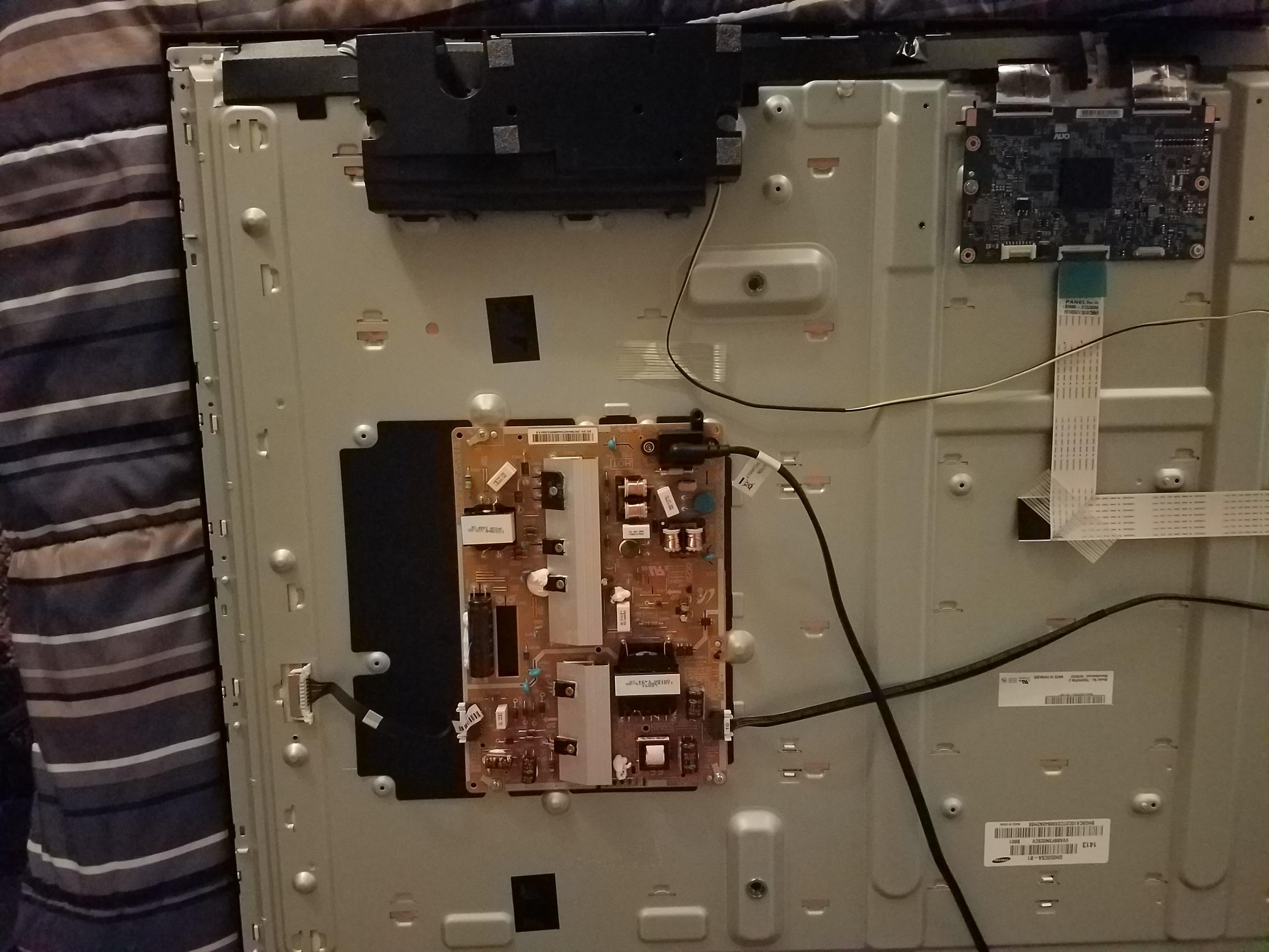

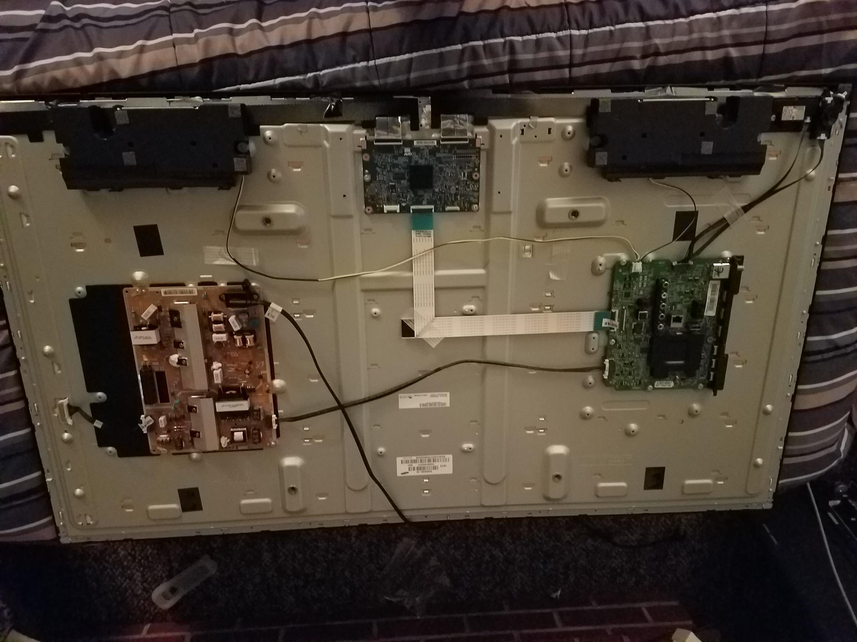

    Tv has no video. Backlights work and sound. Changed tcon board and power board.
    Any help
    Re: Samsung un50H6350
    Need good clear straight on pictures of back of tv with cover off and each board.
      Voltage checks coming soon.
        Do you have voltage at t-con?
          Yes i have 12v at tcon board
            Another one of those LCD panel with tab bonding boards on the bottom edge of the panel which prone to fail due to cleaning fluid used on the screen.
              Might try disconnecting ribbon cable to panel one at a time and see if you get any picture.
