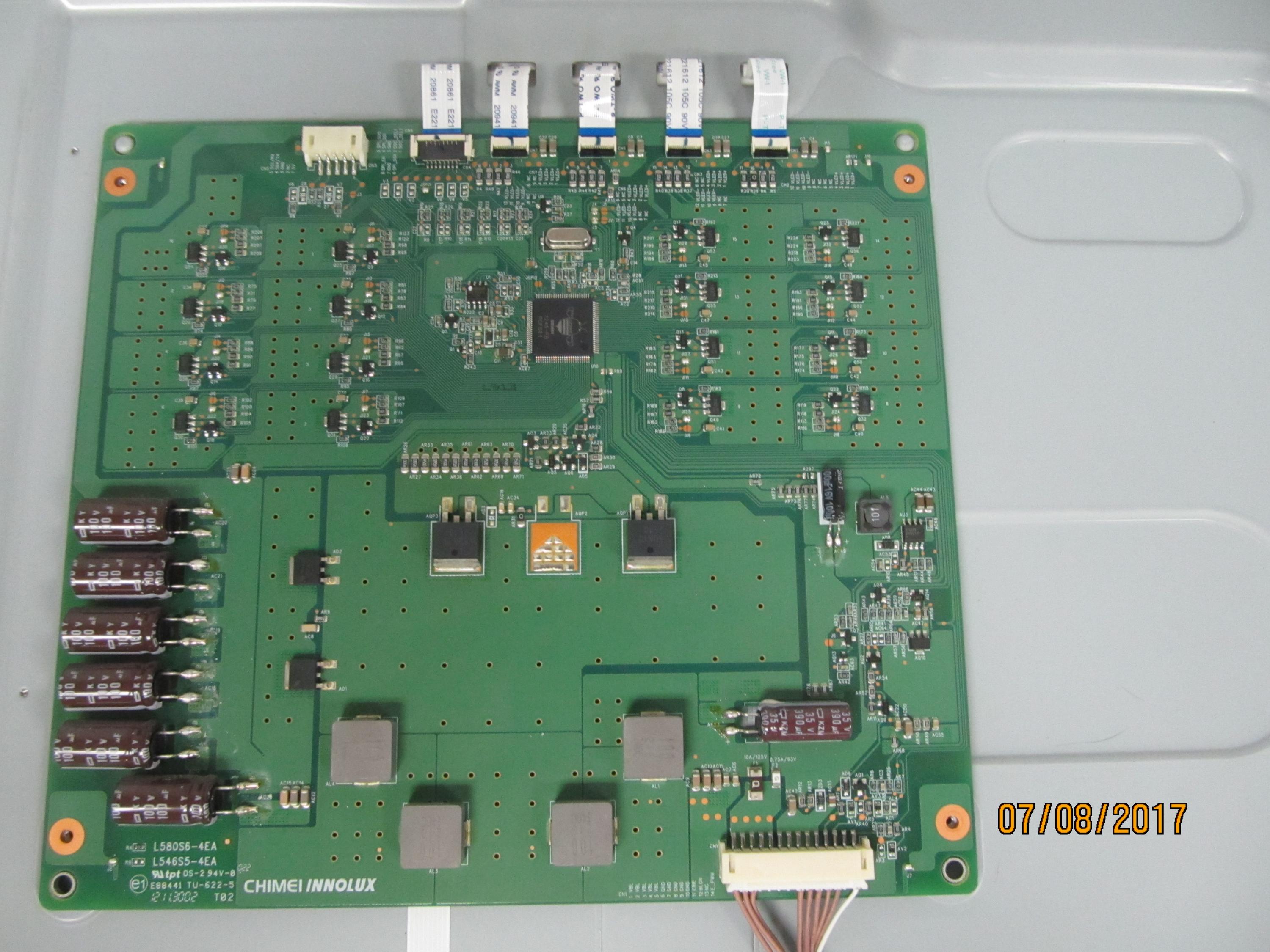

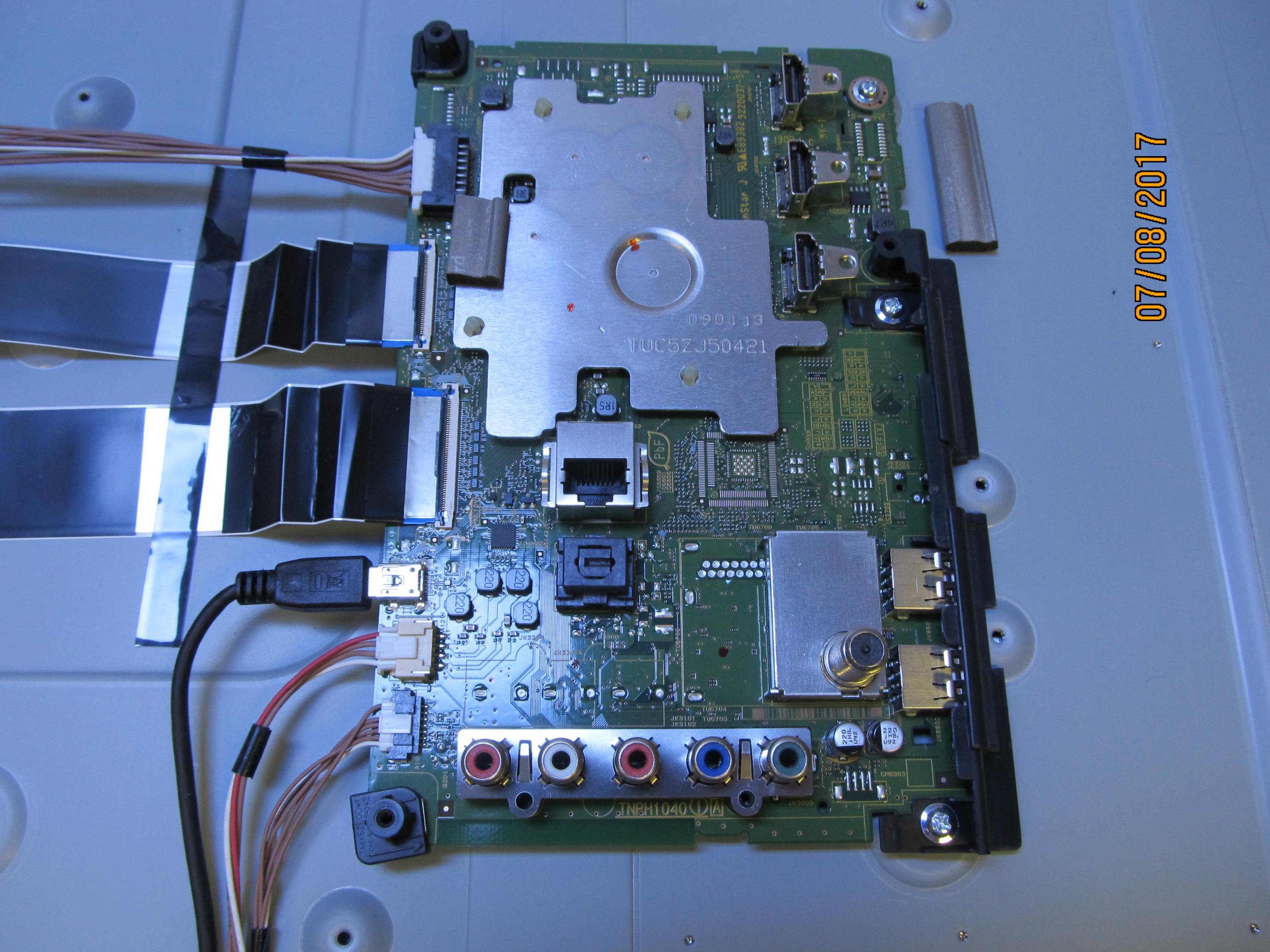

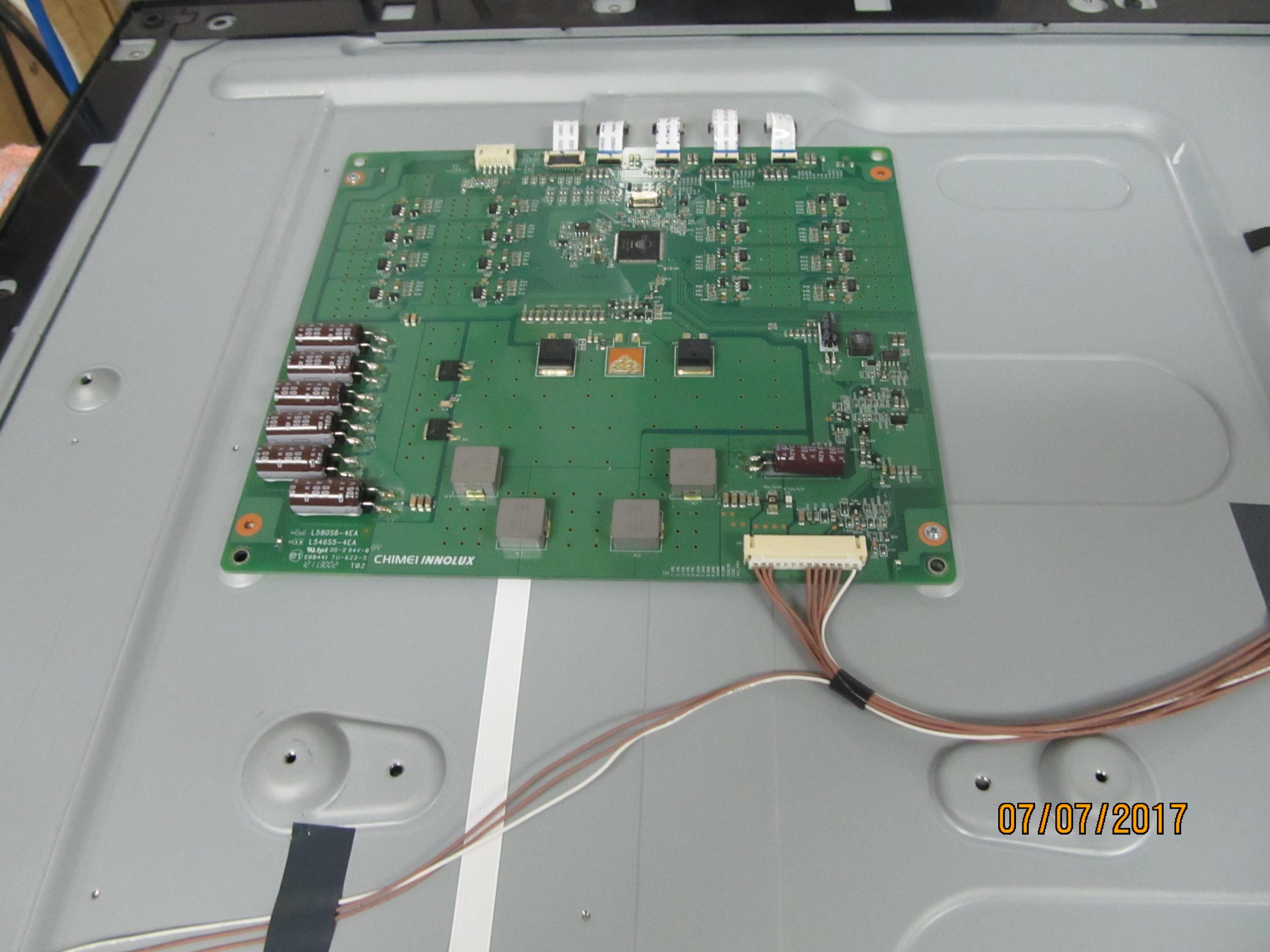

    This TV turns on and I get a quick picture when the back lights fire. I get this four times then shuts off and the power light blinks one blink repeatedly. I initially thought bad back light but now I am not sure. The voltages to cn1 when the back lights come on are as follows.
    pins 1-5 24V then down to 0
    6-10 Gnd
    11 err 0v then up to 2.5v
    12 Bl on 3.28 down to 0
    13 nc
    14 E-pwm 2.8v down to 1.5
    I cant find a service manual for this model and was wondering had any thoughts what else to check. I can't find any voltages listed for p2. I do not really want to pull the panel off if i don't have to but that looks like it is next.

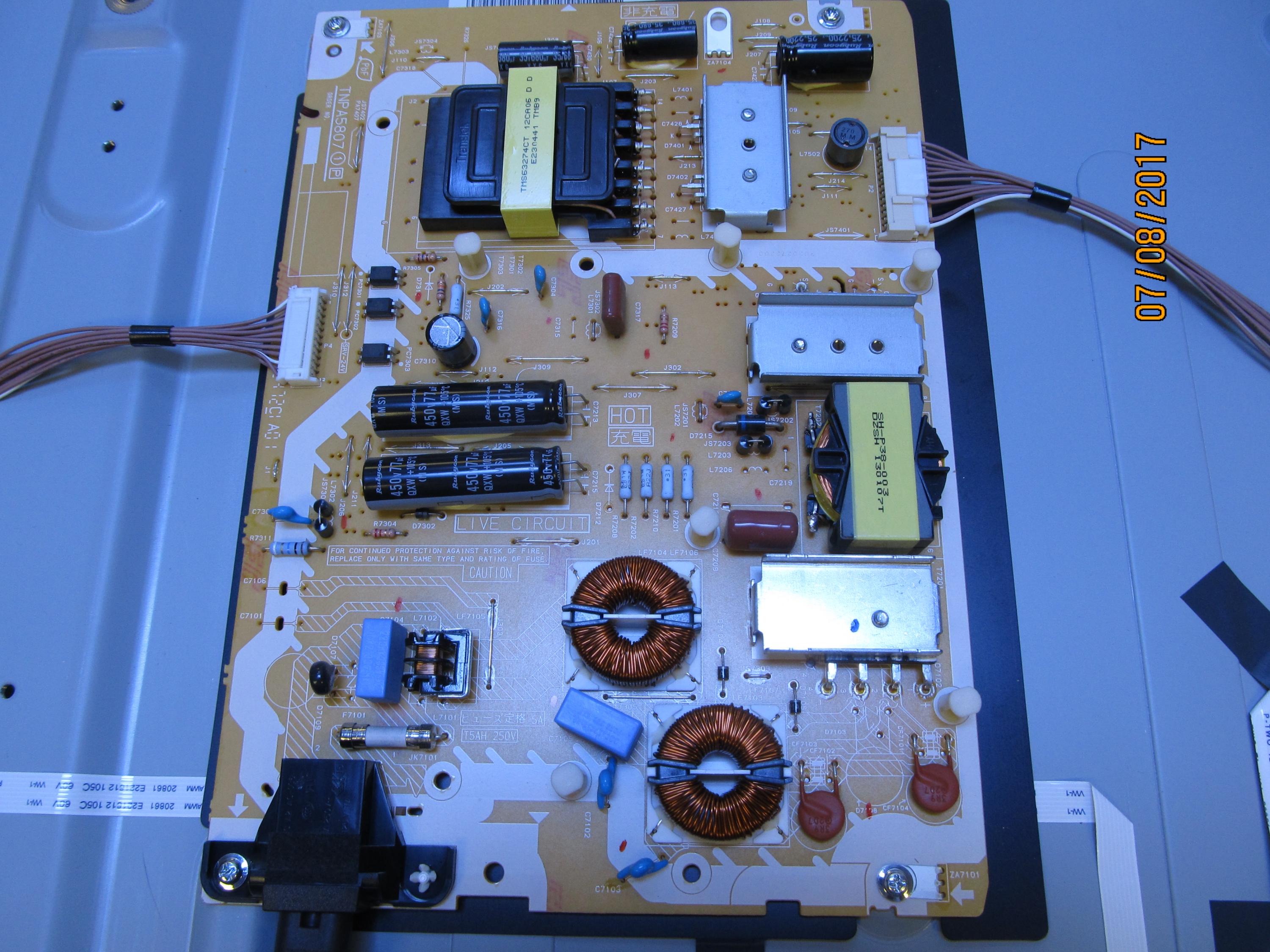

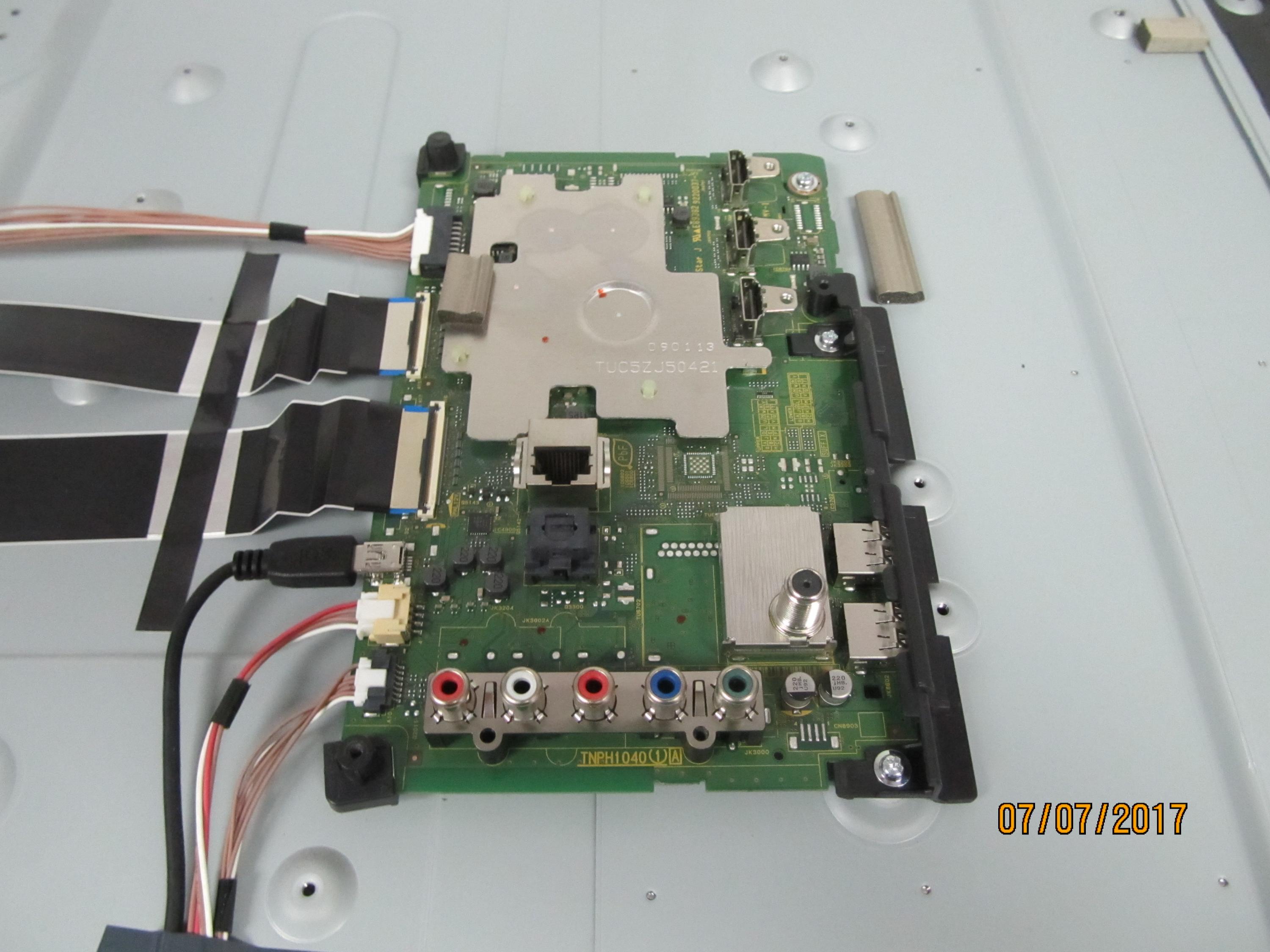

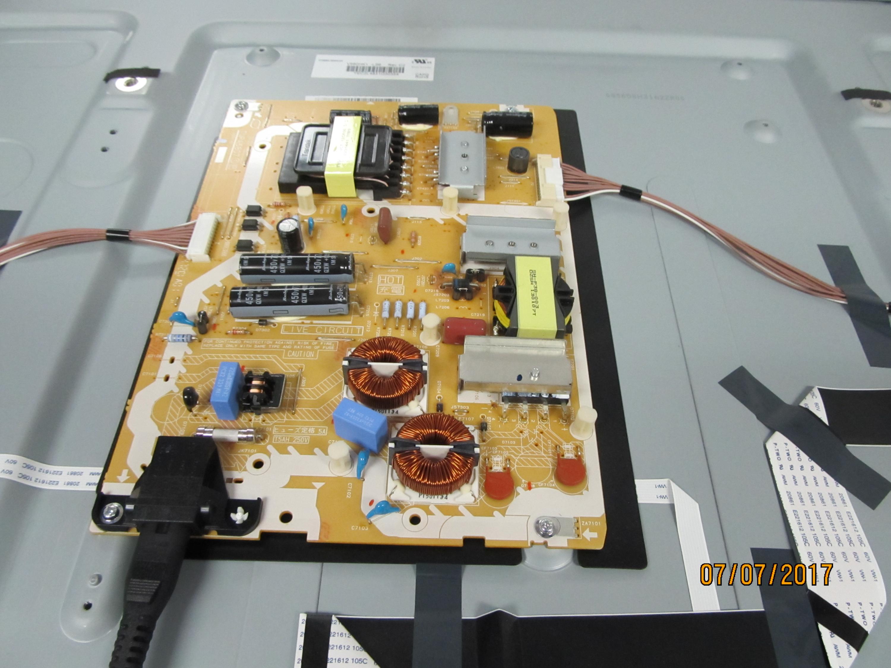

    Re: panasonic TC-L58E60 1 blink code
    Will need better shots of your boards. Straight on

      There is a little more to this now. If I disconnect all of the LED power from the led driver board to the led's and then test the voltages there is no drop until maybe 45 seconds then it shuts off and the power light will blink the one blink code.

        if your vled+ is good on the inputs, reattach the led cables and measure the vled- as it fires the backlights. record the initial spike and what it settles too.
        you will most likely have to do this once for every string of led's. looks like 16 of them.
        you are most likely looking at failed led's at this point.

            I only see 4 VLED - and 4 VLED + at the connections to the led's from the led driver board.
            they read all over the place each time they fire but the seem to be anywhere from 6v to 8v when lit and 8v to 10v when not. Vled+ is anywhere from 8 to 7 when firing and 13 to 14 when off. These seem strange to me.
                I replaced the A board and P board with no change but I could have got a bad board and did not know it. I did test the LED's and they are fine so I am going to presume a bad panel and notified the customer of such. I wish I could have a definitive answer but I do not.

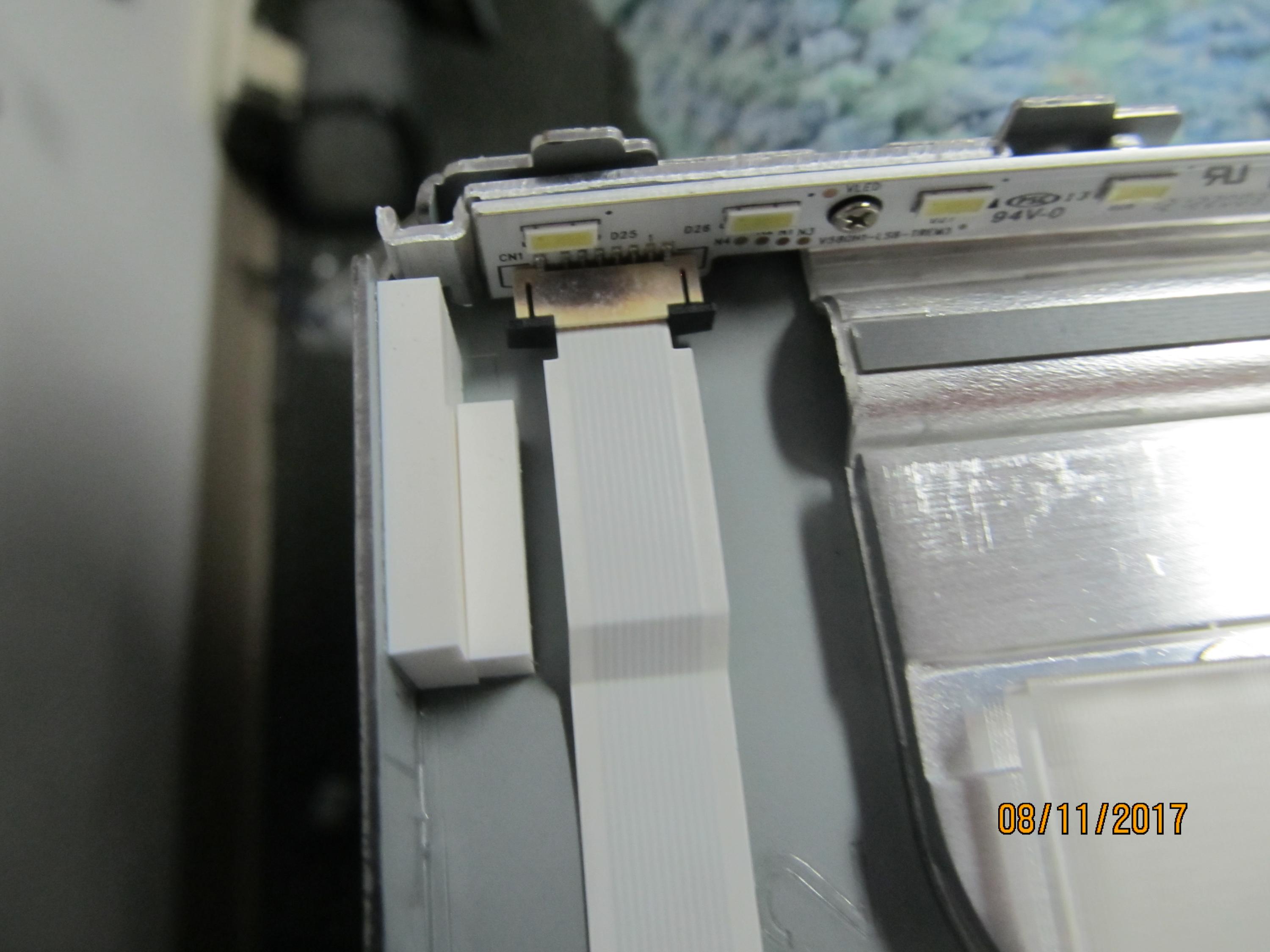

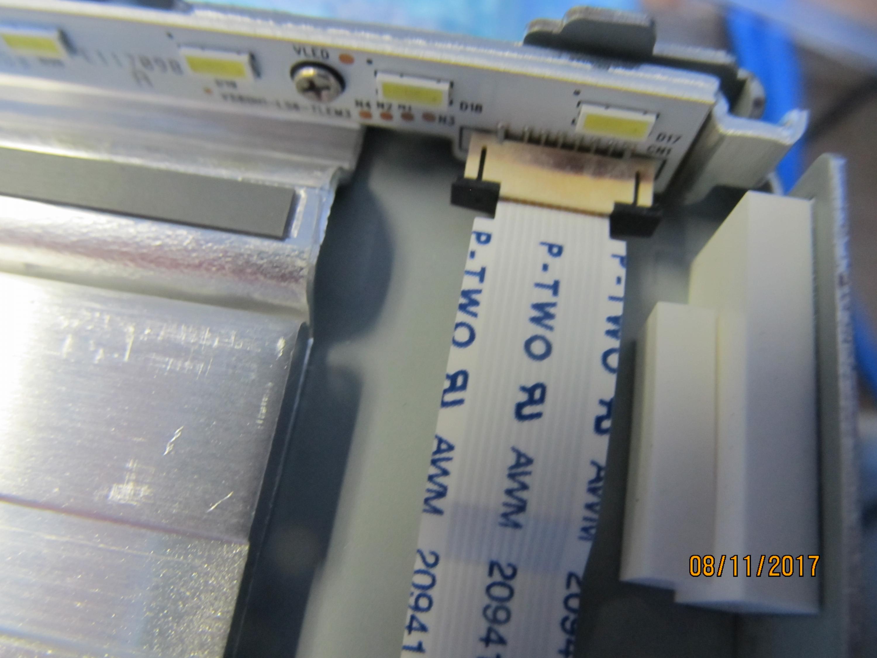

                      I believe I may have found my problem anyway. I thought I had tested the LED's but now I am not sure. I removed the panel and noticed what looks like burn marks on all four connectors. The right hand side ones are darker than the left.
                      I have never seen dark discoloration on the led connectors before. Am I correct or is this not unusual.
                        I would say you have poor connections
                          I agree, I put my led tester on the pos and neg and the led's lit up. I am going to try and clean the contacts but I do not hold much help
                            New ribbon cables or solder cable connectors to the pins
