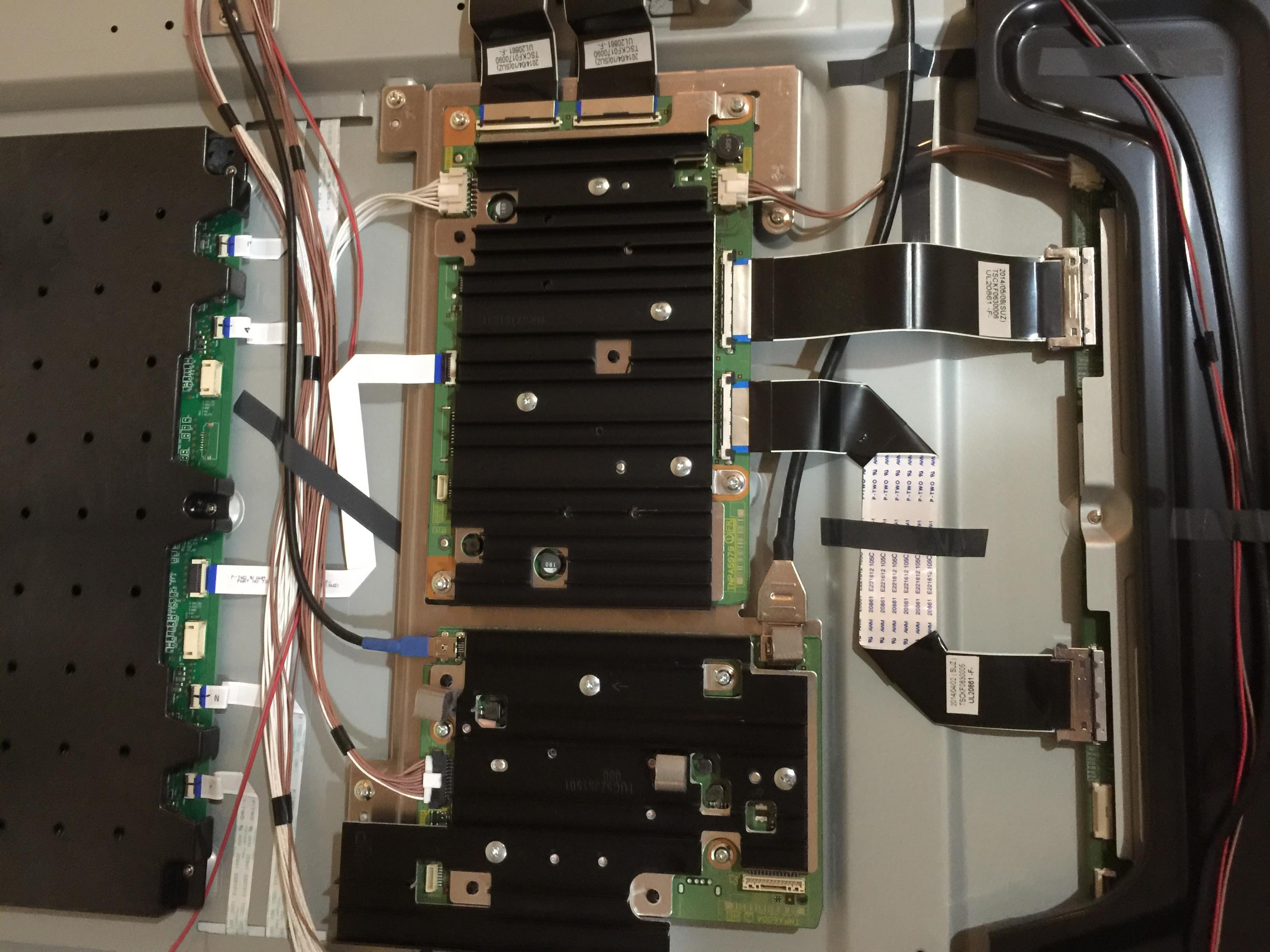

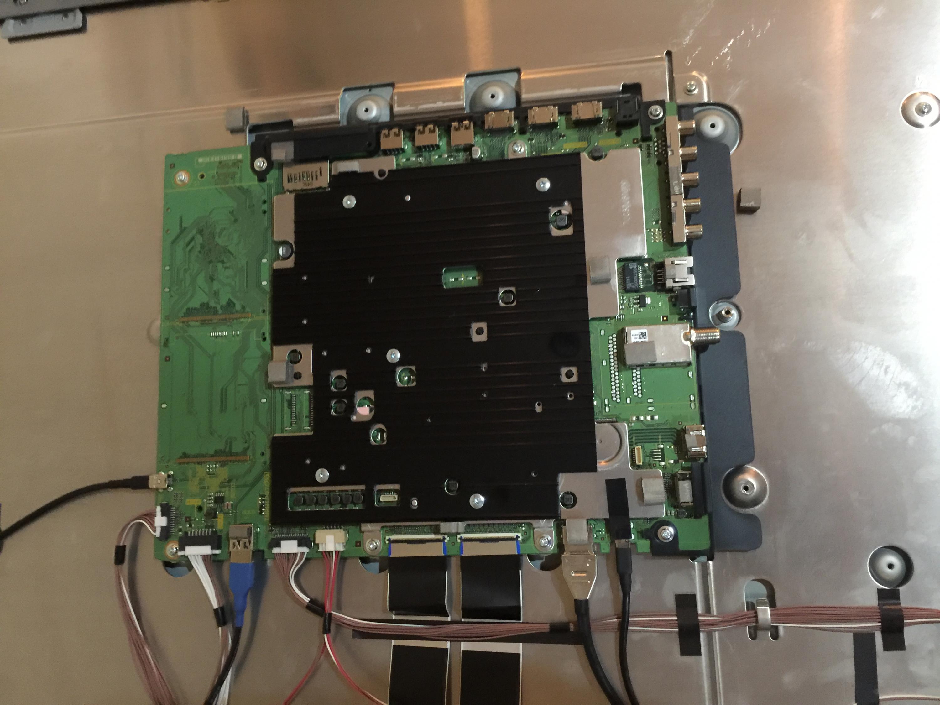

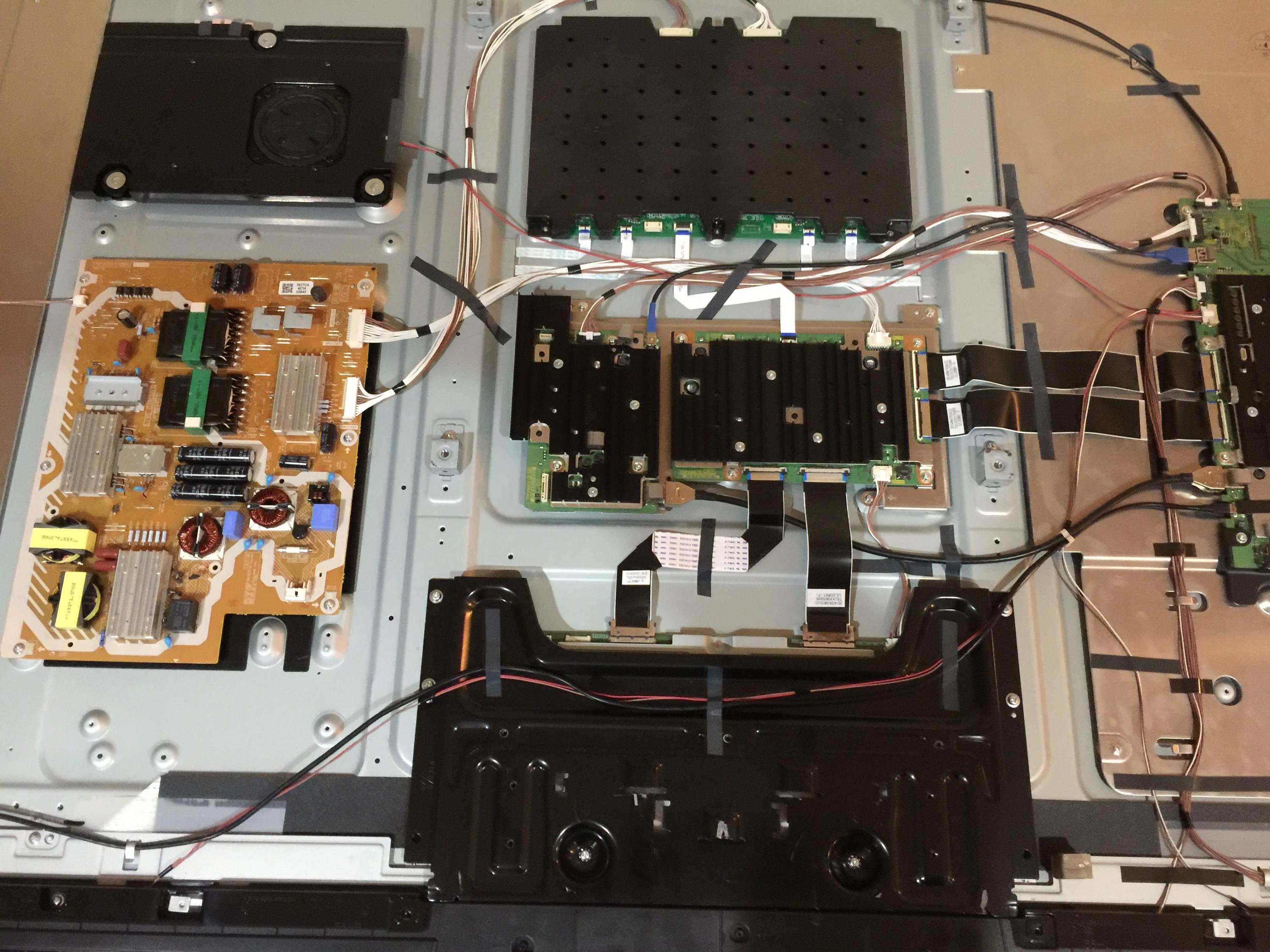

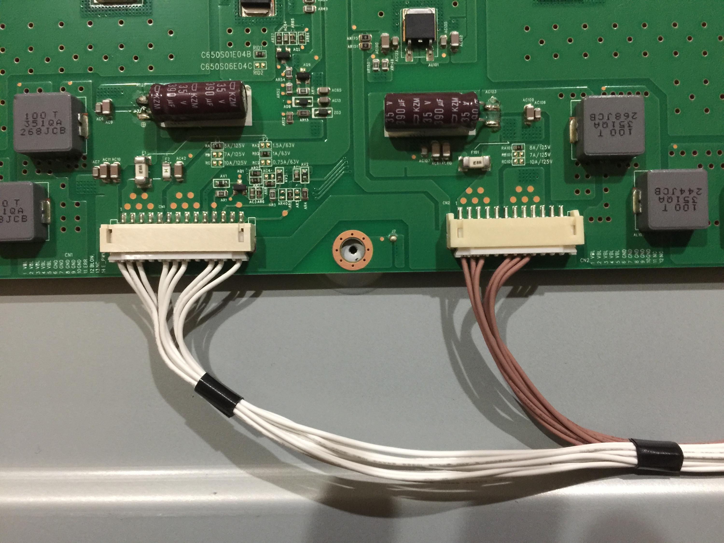

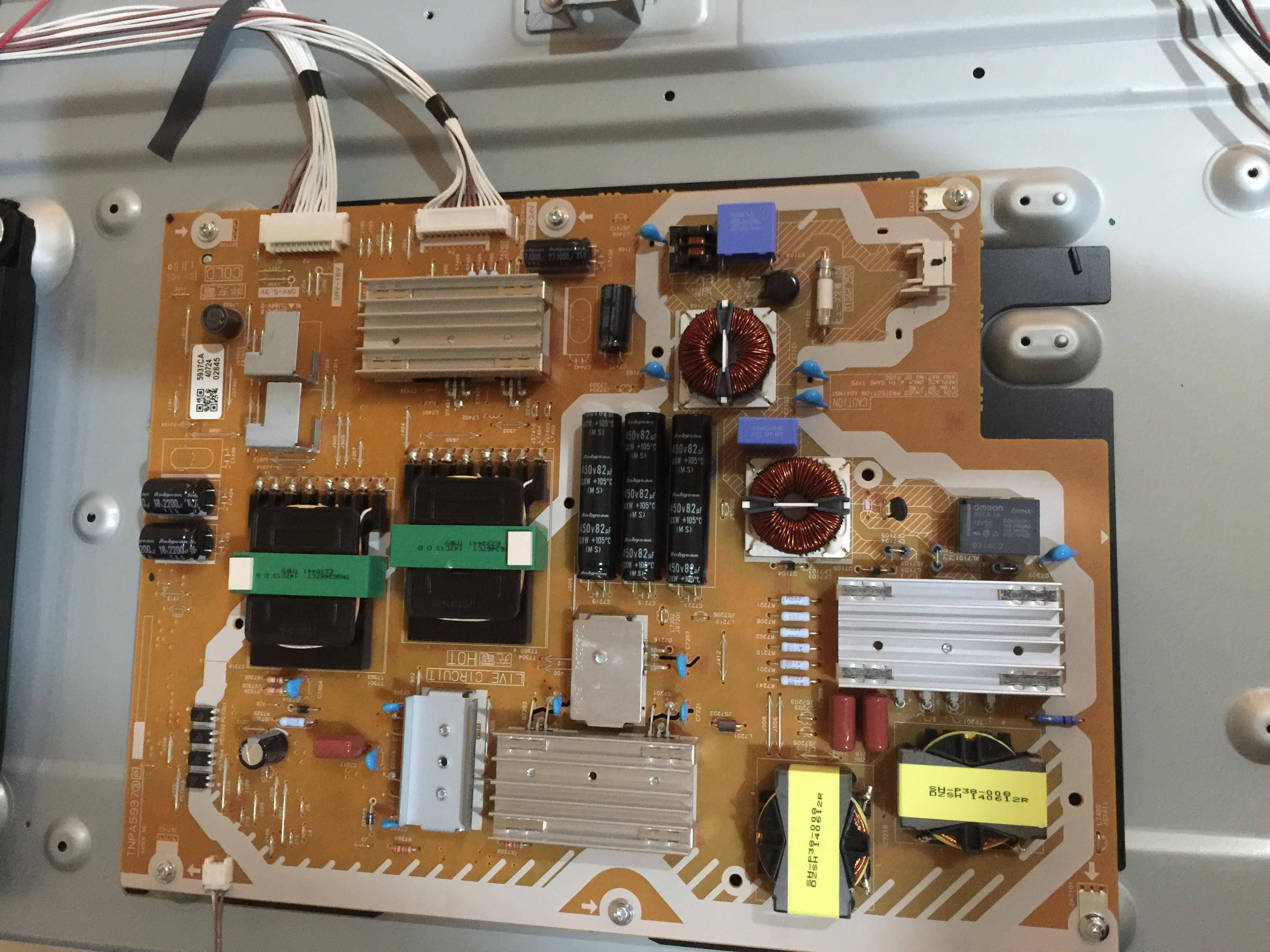

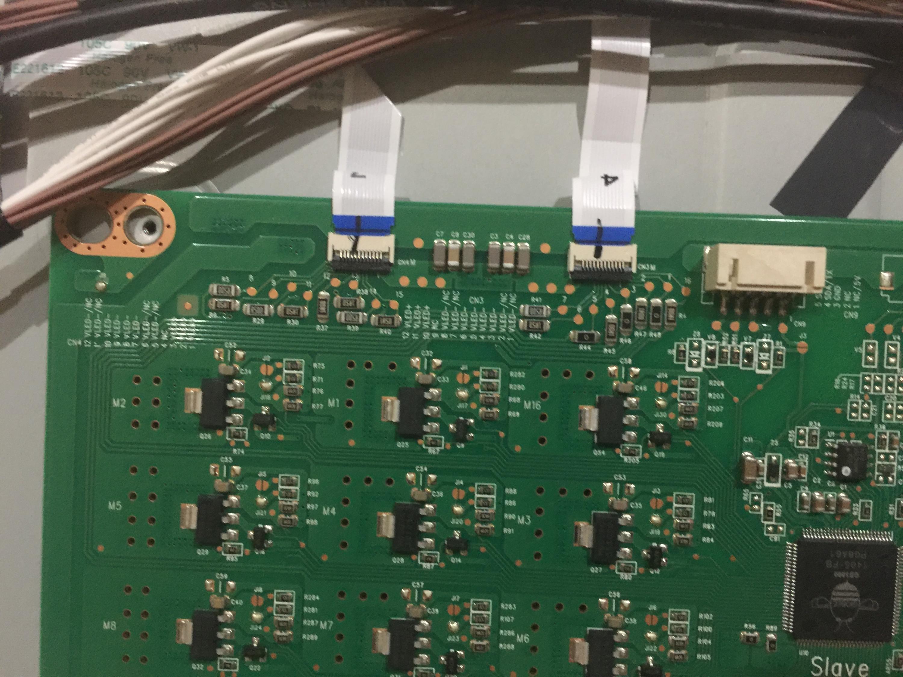

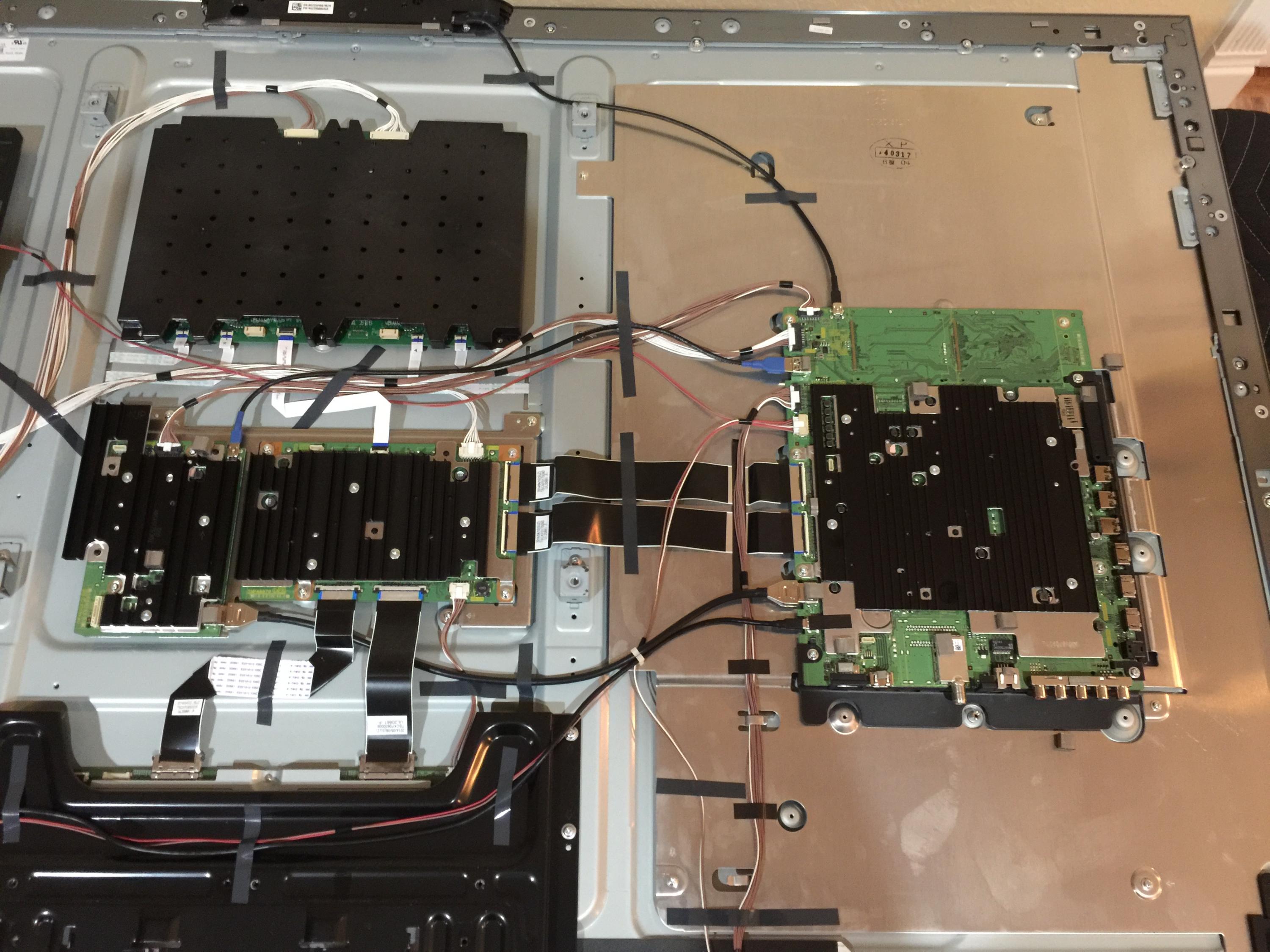

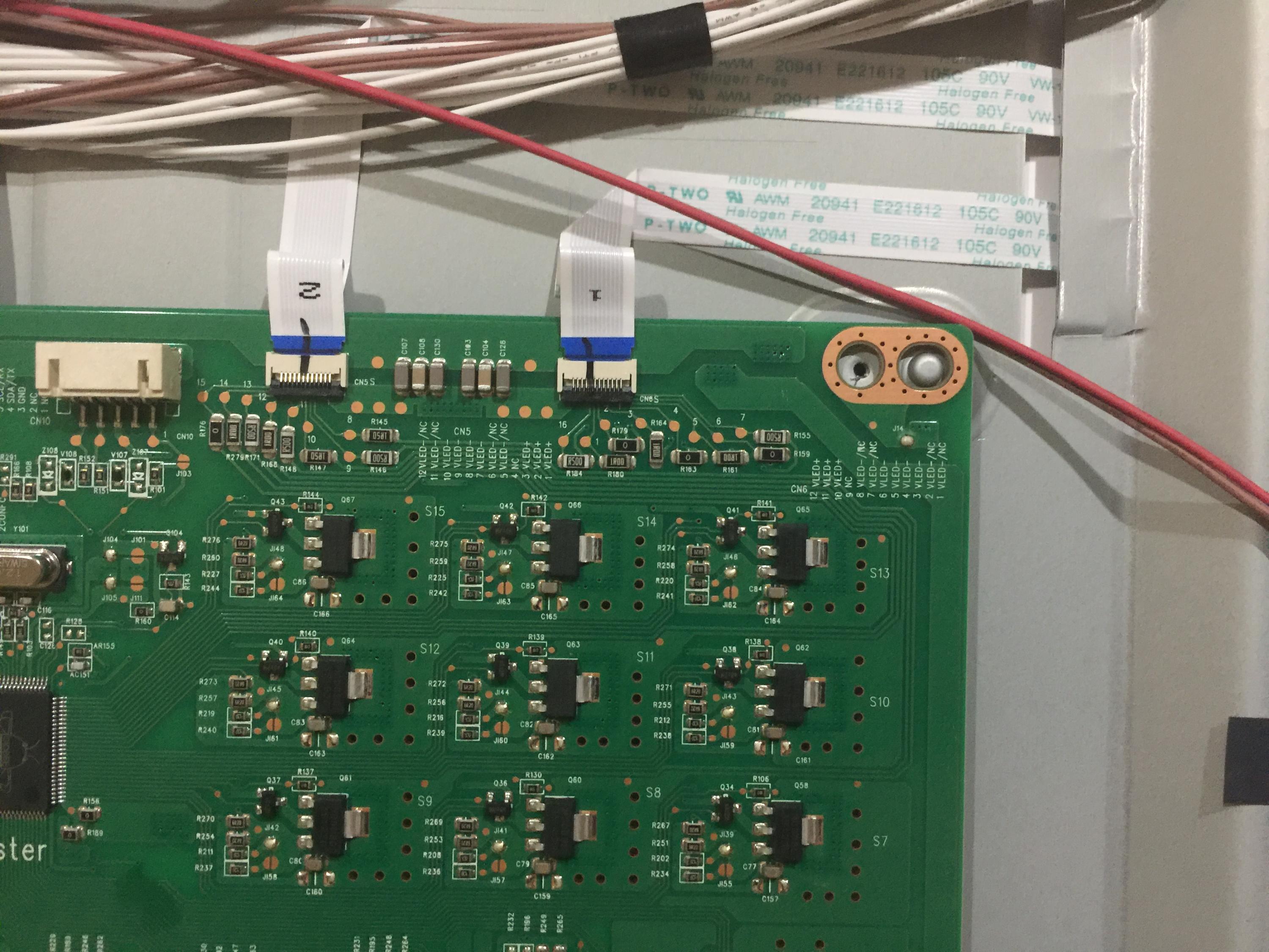

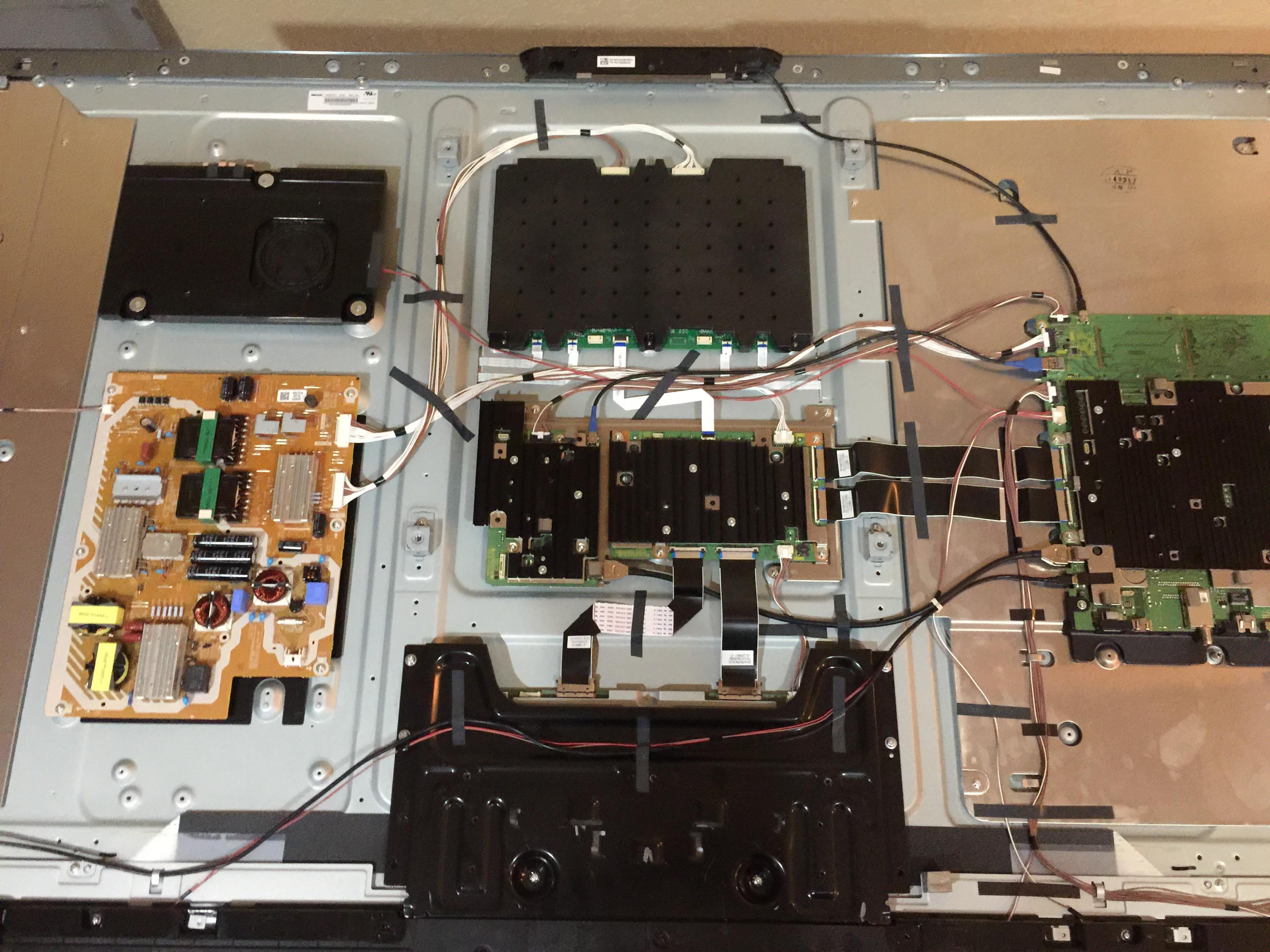

    Hey guys i need a little help here. I purchased this 65" tv for super cheap but its not working. Im trying to find info on it and i cant find anything about it. The tv has a 6 blink error code on it. Now i tried finding 6 blink error code on this model and the only thing i find is about plasma tvs. This is a LED tv. Any advice? Here are some picture of the back.

    do you get any backlight flash?
    voltages on the connector that goes from the ps to the main,
    pin description, v in stby, v when powered on.

        Re: Panasonic TC-65ax800U

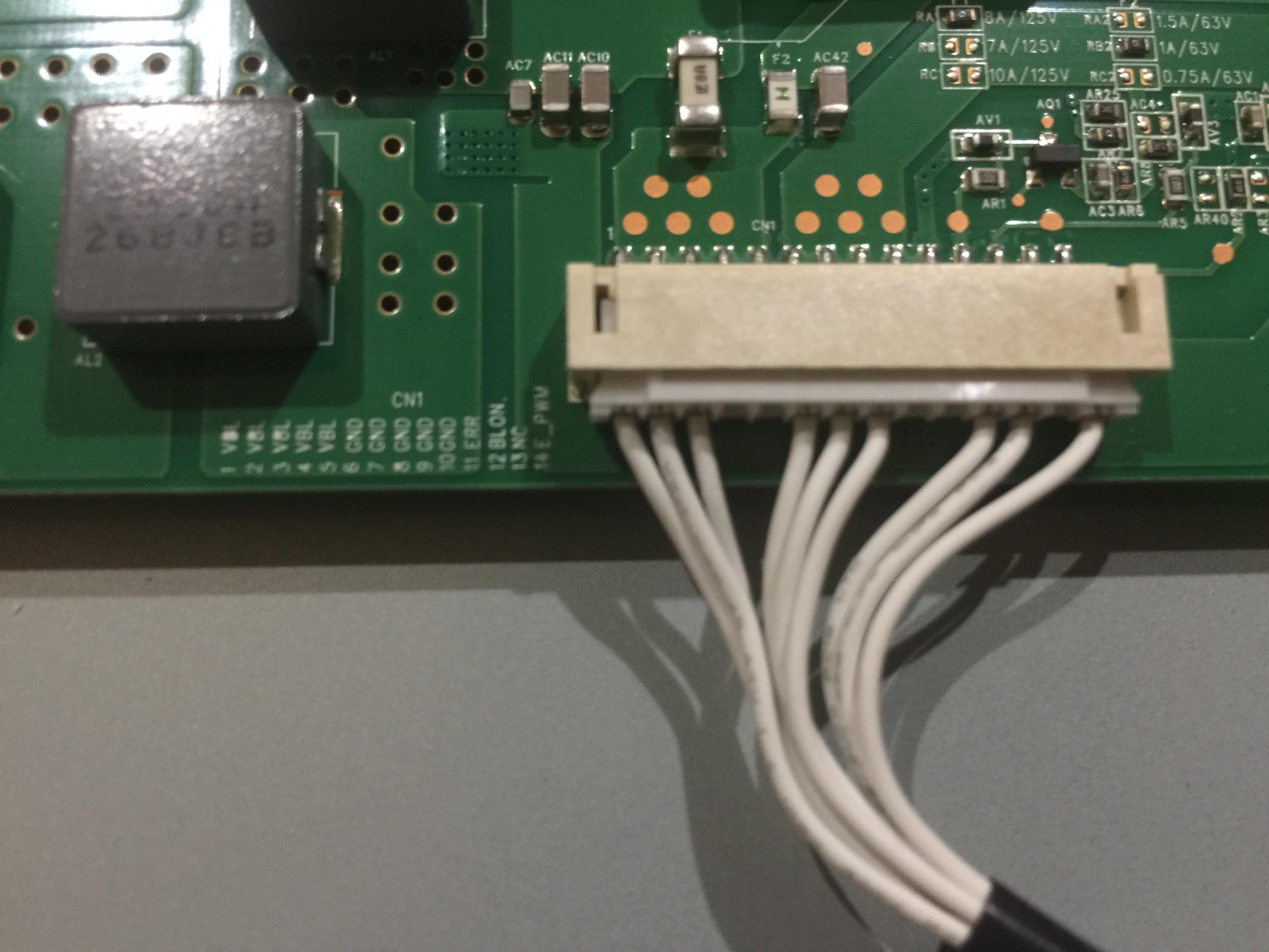

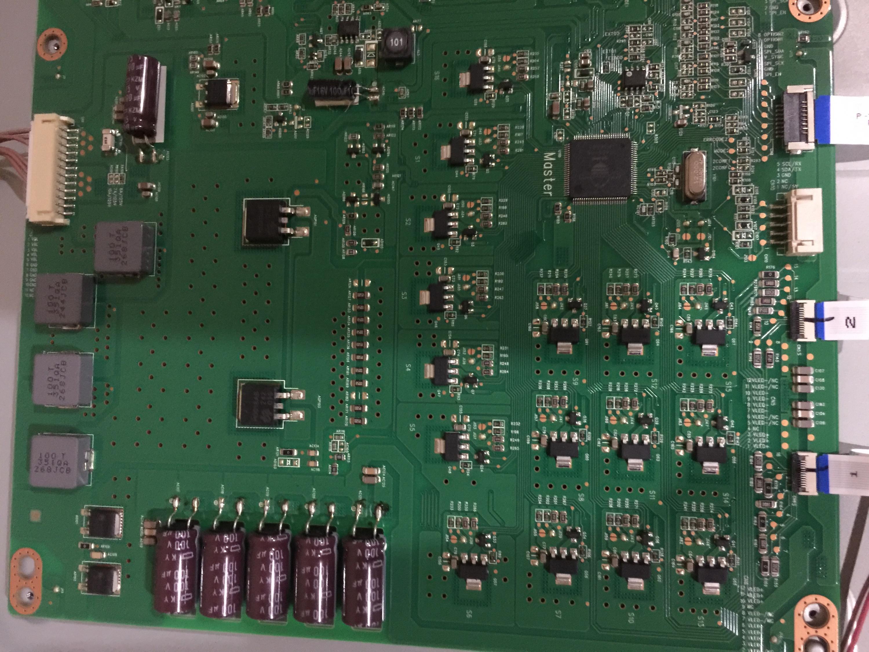

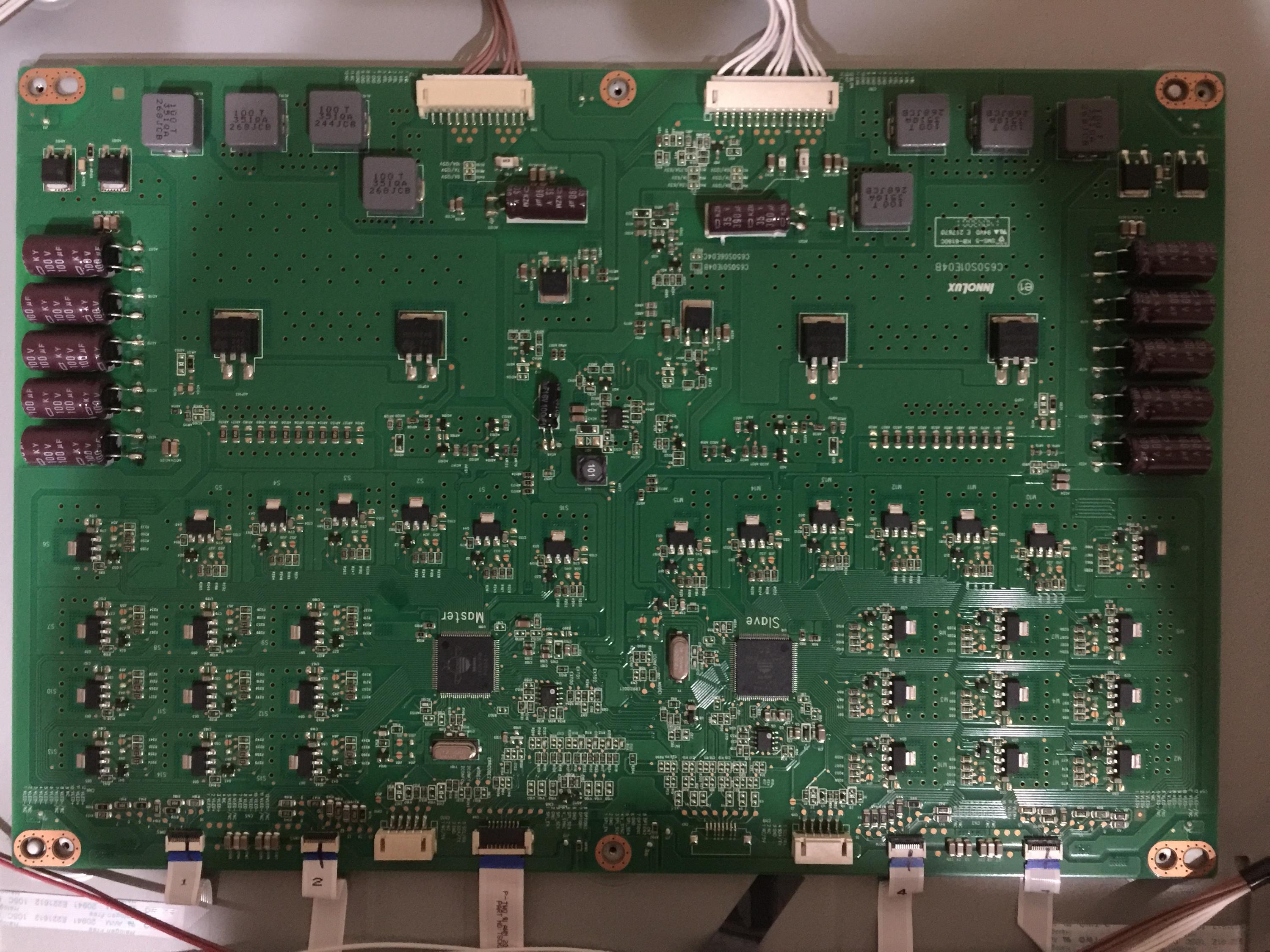

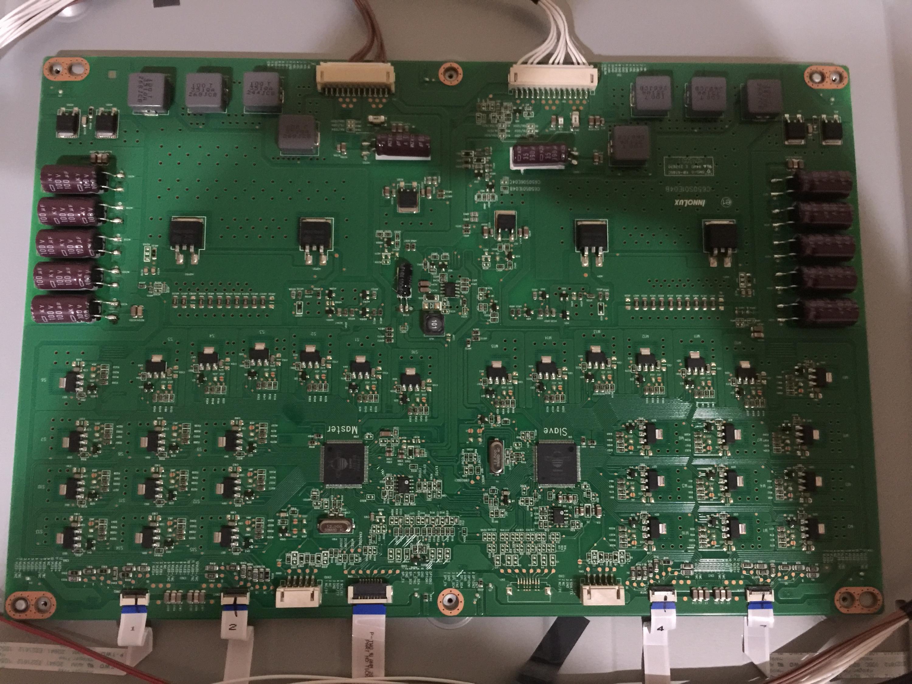

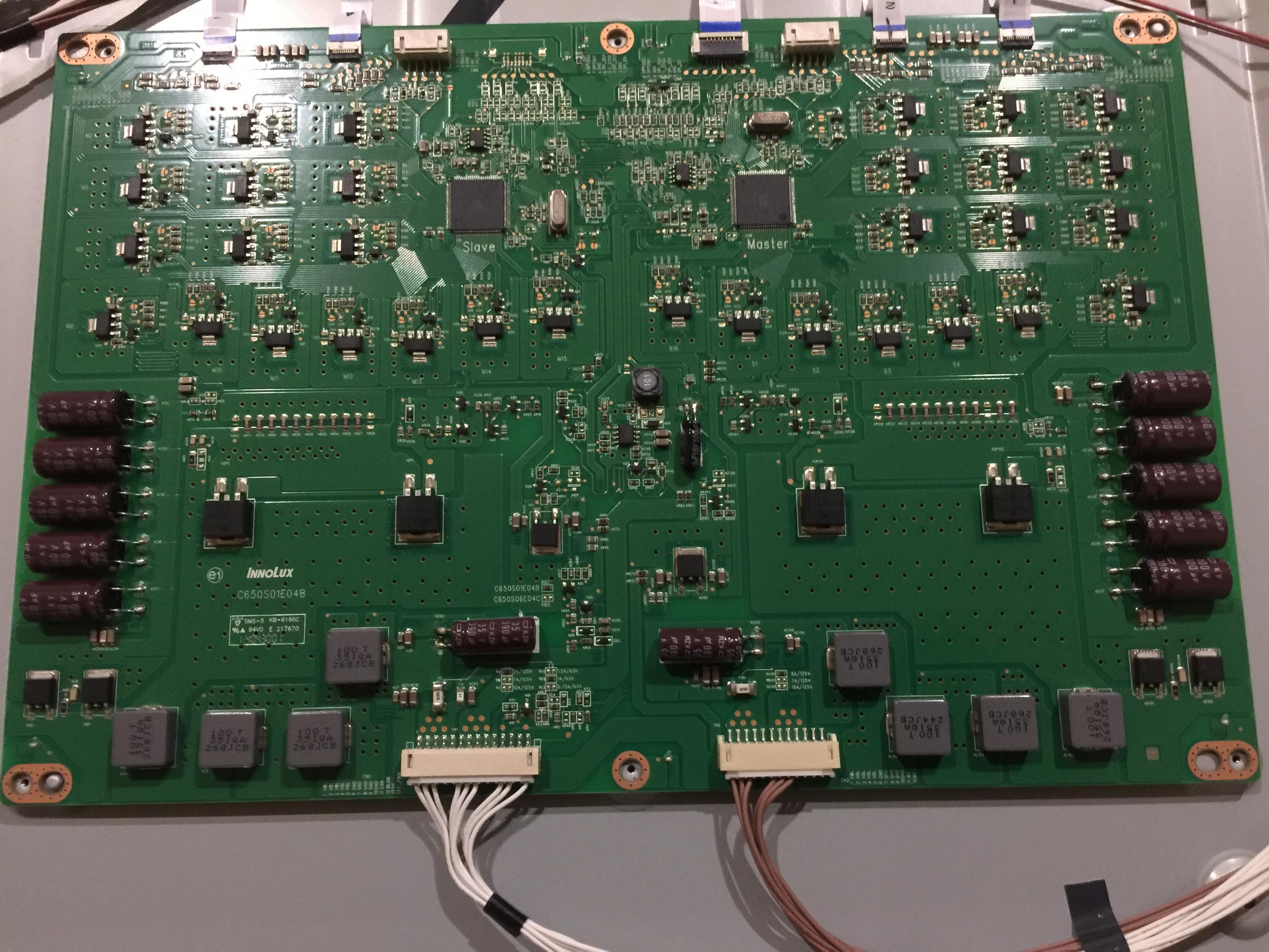

        most likely bad led's.
        can you remove the cover off of the led driver board and post a pic.

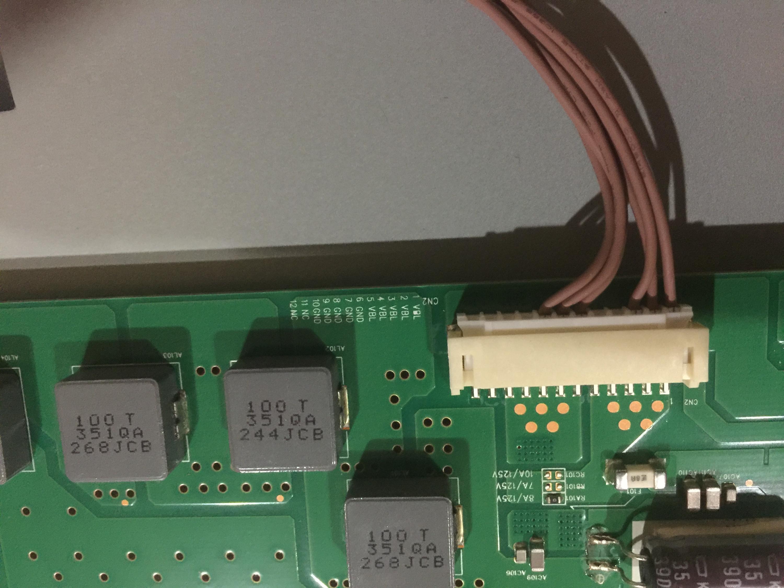

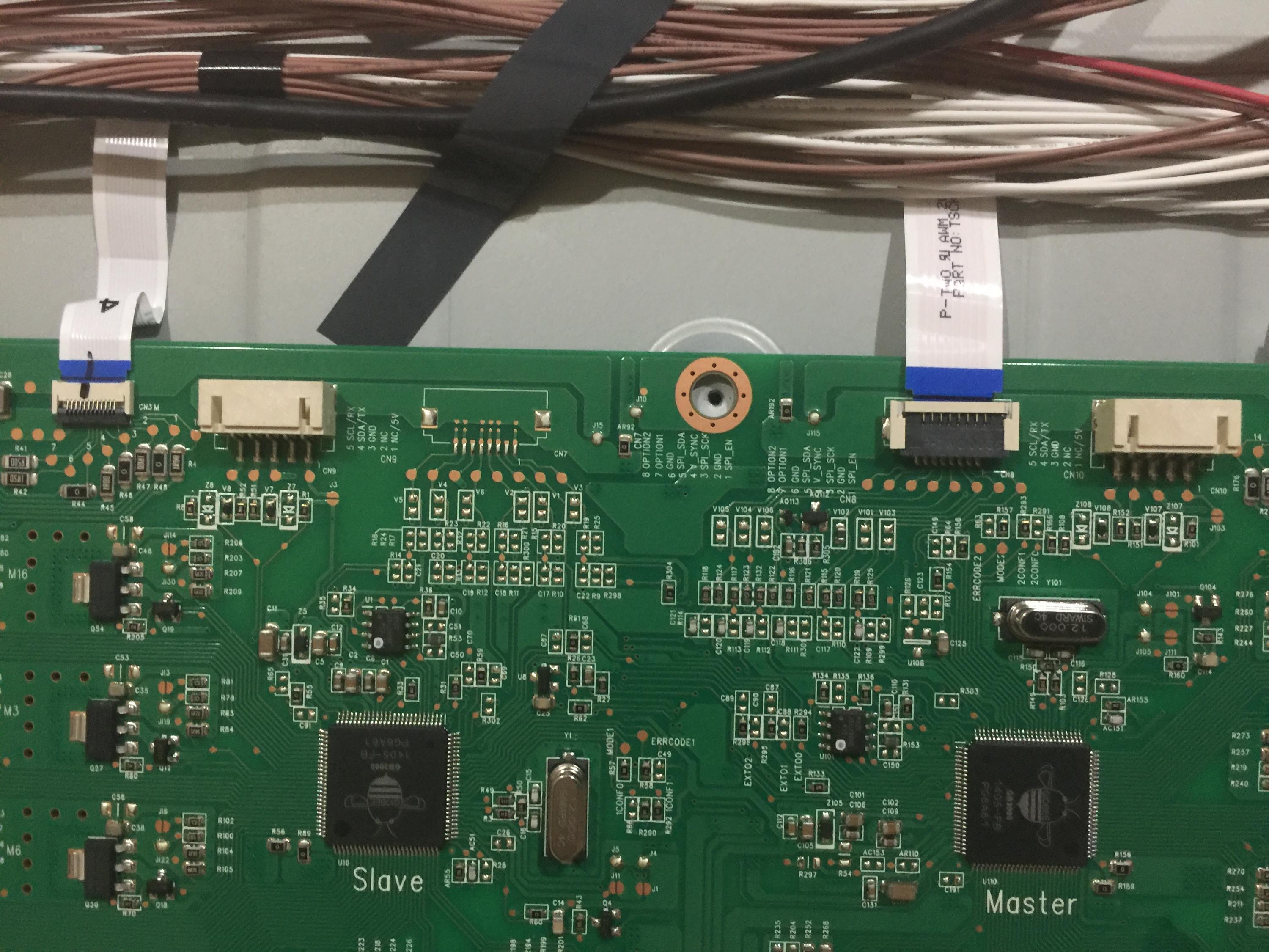

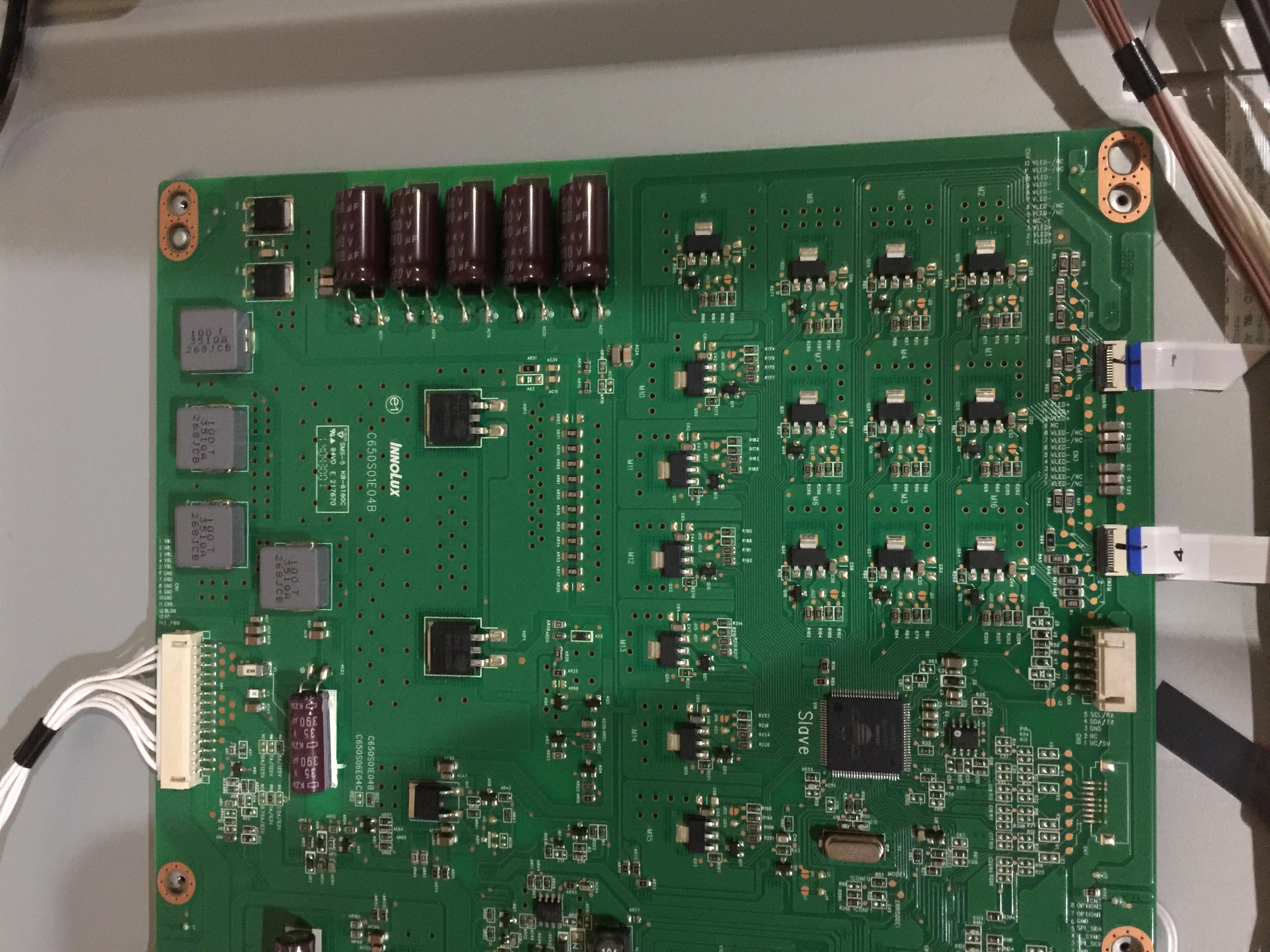

          Here are the pictures you requested.
            if you put the screws back in the board without the cover.
            then test each vled- vled+ test point on the exposed test point as the backlights come on and then what they settle down to, then we can pin point your issue.
            black probe on chassis ground.

              So i tested on the LED driver board the VBL test points. These plugs go from power supply to led deiver. The voltage was 24V when tv powered on and dropped slowly to 0. Then tested the VLED points that you requested and all the Negitive and positive points were 9V when tv powered on. Then when the tv shut down the voltage spiked to 11.5V and dropped to 0 really slow.
                i hope that you put the screws back in to ground the board.
                i think that you need to retest both vled+ and vled- as 9v on all pins is not right.
                it may be that your meter isn't quick enough to catch it, but confirmation would be good.
                still looking at led failure to me.
                  Actually i found the service manual for that specific tv and the 6 blink error code is the A board (Main Board). Plus i tried pitting the screws on and the screws go right through the board. Screws are way to small. Thanks for your help.
                    Wanted to confirm fix for 6 blinks on this TV is the Main board.
                    Just fixed mine
