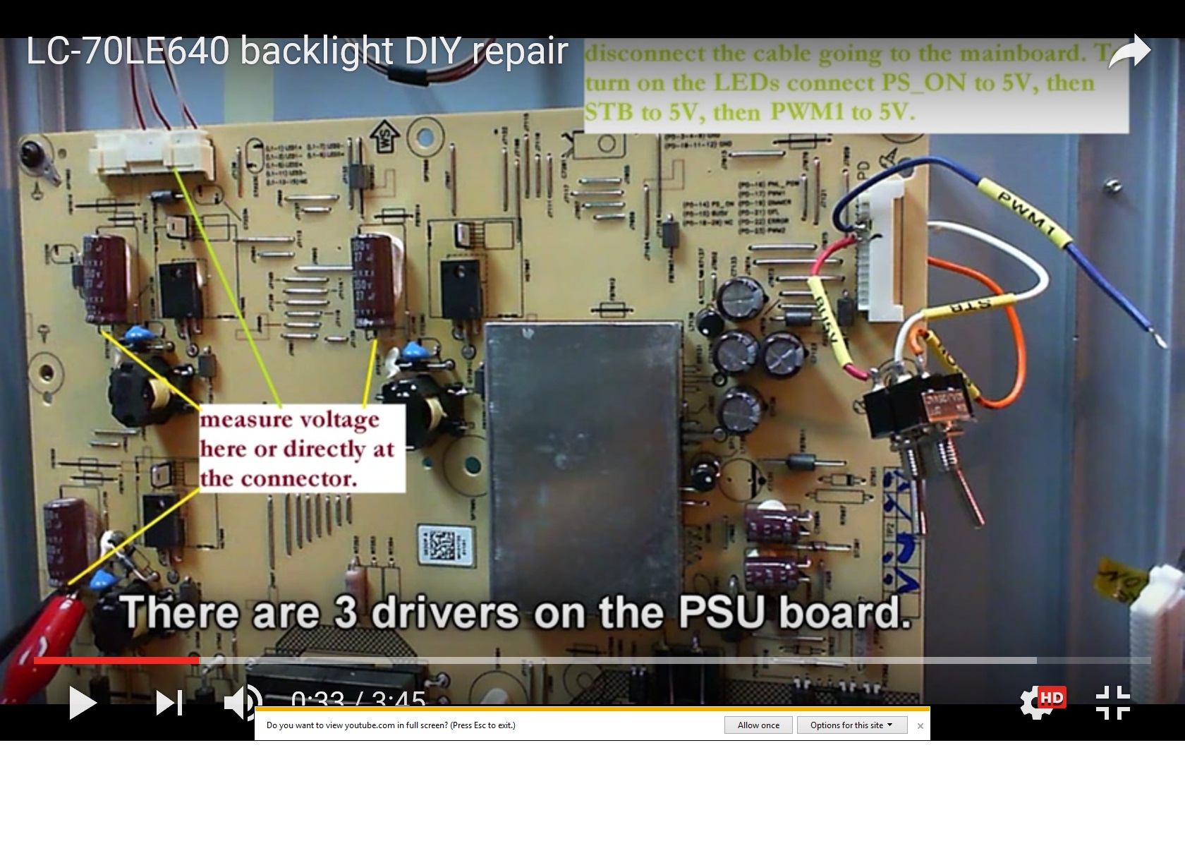

                Just trying a couple of things to get the LEDs on using the power board, I went back to this idea that I talked about earlier: See attached pic.
                This guy actually powers up STB as well as PS_ON from BU5V but no resistor.
                Anyway same as what you said he's also powering something else PWM1.
                But I don't see anything on this power board with those markings or the markings BL_ON you mentioned.
                I tried powering STB through the resistor from BU5V too and still same, no LEDs lighting up.
                There is a PNL_POW but I haven't tried that yet.
                His instructions require a step order of powering up that I don't have switches for not to mention no idea what might blow up if I do.

                  #48
                  Re: Little Help with Sharp LC-80LE642U
                  It looks to me that he is referring the 'STB' to be the same as 'BL-ON' which may be the case for the Sharp TV.
                  I would never try to force on anything without using the resistors because if you made the wrong connections you can cause more damage, the resistor is used to limit the current.
                  The PNL-POW is the control signal from the main board to turn on the switched 12V (PNL-12V) for running the T-CON board, you do not need that signal to test the backlights circuit.

                      #50
                      With
                      BUSV (pin 15) jumped to PS_ON (pin 14) through 1K Ohm resister,
                      STB (pin 24) jumped to PS_ON (pin 14) through 1K Ohm resister and
                      PNL_POW (pin 16) jumped to PS_ON (pin 14) through 1K Ohm resister
                      I get a short flash of the LEDs at power up and again at power down.
                      Nothing seems to keep the LEDs on longer than a short flash.
                      Are there any other tests than powering the strips with the LED tester that I can run on the LED strips to be 100% sure that they're not one and only problem?
                        One end of those resistors should go to BU5V pin, not PS-ON pin.

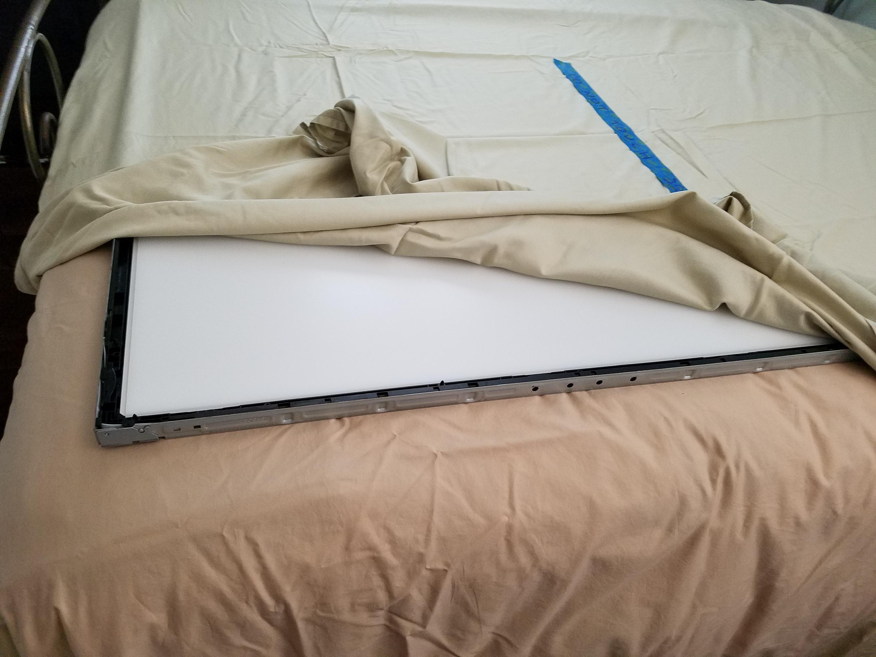

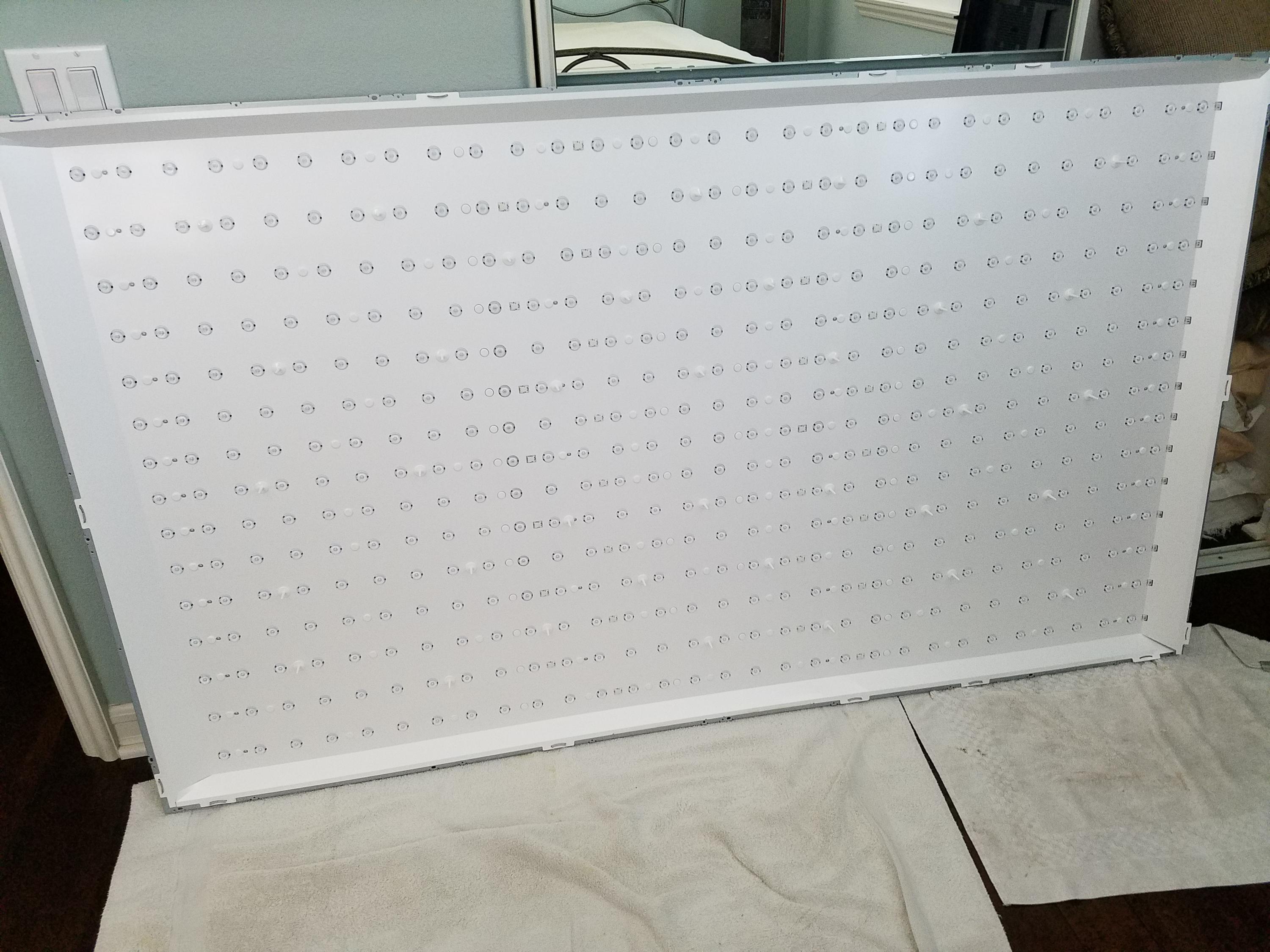

                                I have been scratching my head and wondering what edge boards and corner cables were.
                                I found this (https://www.badcaps.net/forum/showth...+cables&page=6) scroll down to #105 - 106, and some other threads which I think explain but I don't have any of those boards or cables.
                                Here's what my LED back panel looks like and here's what my LCD panel looks like. Although this pic is just one corner, believe me, there are no connections or boards except for the ones coming from the Tcon to the LCD.
                                  Is that your wife's side of the bed you got the panel on?
                                    #57

                                    I paid a tv tech to come out to my house and troubleshoot. He said the new main board that I received had exactly the same problem as the one that I need to replace. I've sent that one back to Secure Core (who by the way gets kudos from me, free return and full refund, they didn't have another in stock but ...) I have another one on order, should be here Tuesday. I'll post then hoping that turns out to be the problem, regardless, I had to promise it's the end of the line win, lose or draw. If it's not back on the wall working Tuesday night I'm off to Costco to buy a new something or other.
                                    :-) but I think you are looking at the wrong side / face.
                                    there are edge boards on the sets in some form. Just as you see the bottom edge boards connected to the panel with "tab driver flex cables", there are similar cables connecting the sides either to a board or to a long flex cable that act like a board.
                                    Anyways, it must be tough sleeping with the TV... :-)
                                      No but she's threatening to make that one my permanent bedroom.
                                        I only see a black rim around the LCD section.
                                        I haven't taken that apart but have inspected it pretty carefully and there are no visible boards or cables.
                                        Is it possible that the edge panels and cables are integrated into the LCD Panel Module Unit on this model?
                                        Have a look at the Cabinet Layout attached.
