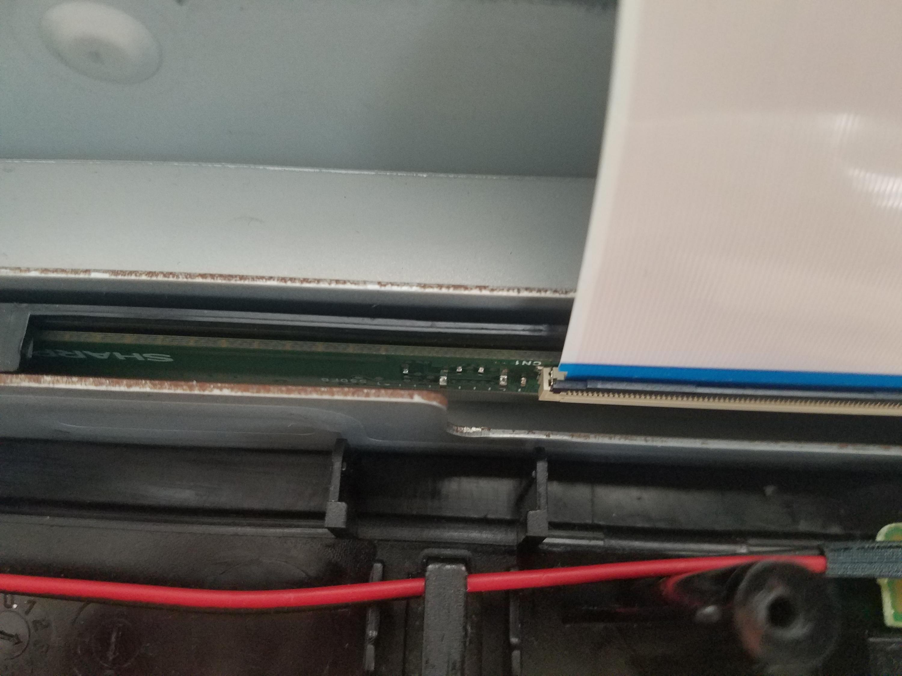

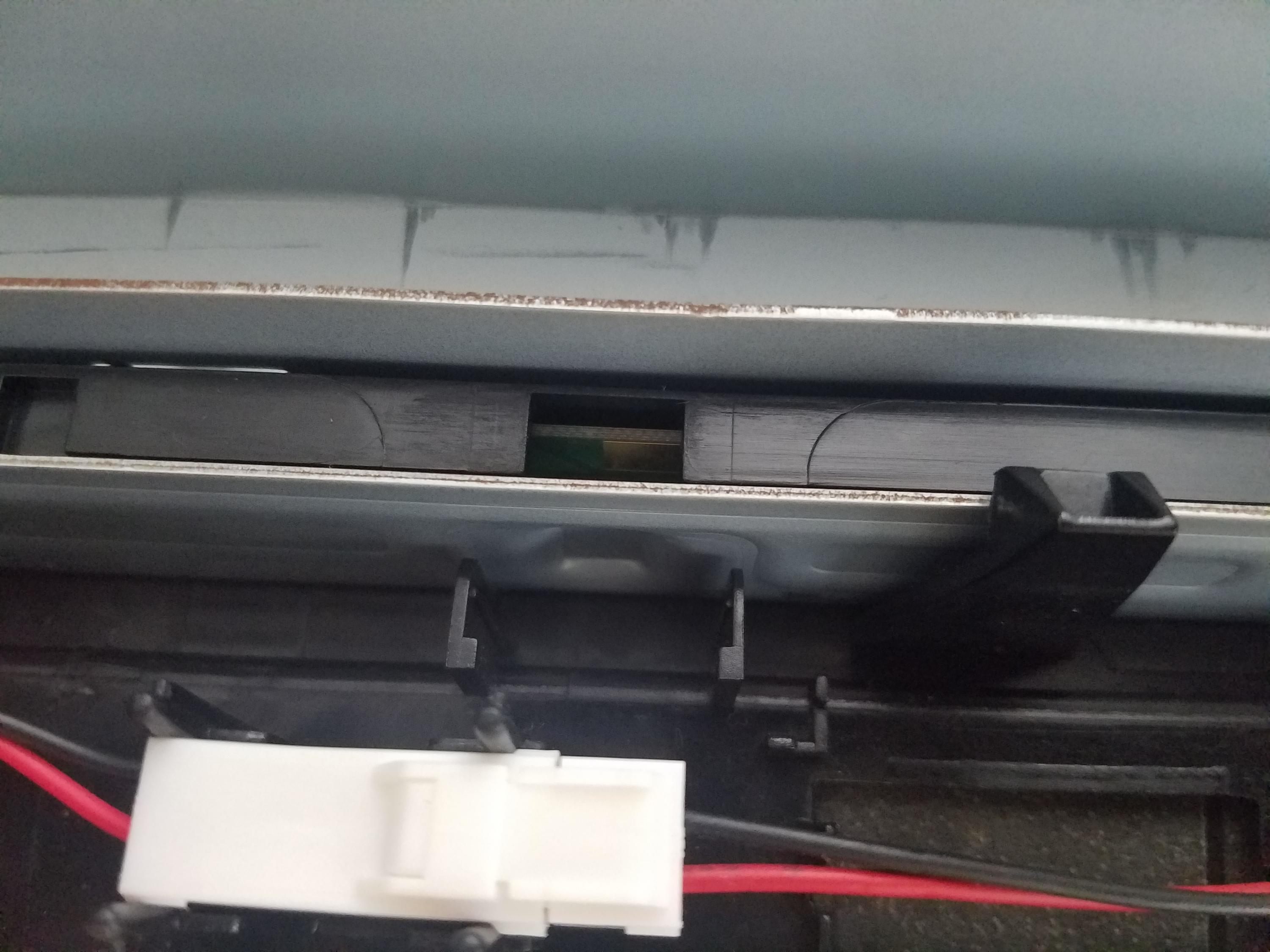

    The reason that there is no listing for the boards is that they aren't replaceable as there is bonded cabling between the board and the panel which is a "one time assembly / manufacturer". Anyways, I would look closer at the edge especially going from the tcon to the panel at the bottom. Your issue may be related to how the edge boards are interconnected which could be good or bad depending.
    OK, you're right there are boards and cables buried inside the plastic rim.
    Unfortunately the plastic rim is sandwiched between the backlight panel frame and the LCD panel frame, screwed to the LCD panel frame.
    The only way to get to the edge boards is to separate the LCD and backlight panels ... again.
    That it's going to make it near impossible to stage the pieces somehow to have them all connected.
    The Tcon ribbon cables aren't anywhere near long enough to set things where they'll fit in the room.
    And there isn't enough room to lay everything out side by side.
    Not to mention that I'm struggling to work up the courage take the two panels back apart again.
    I think I'll wait until the new main board arrives, see if my money was well spent on the tv tech.
    If that doesn't pan out, it's out to the garage at best, it'll be Goodwill or the trash if momma has her way.

      Re: Little Help with Sharp LC-80LE642U
      fingers crossed for the replacement main board.... :-)
      not sure what to say but I wish you were on my street and garabage day was dry / not rainy... :-)
      some people have had luck with reseating the cables that interconnect the edge boards. The "signal" travels along the bottom and then up each side. There are "clampable" flex / ribbon cables on those interconnections... some times they aren't set well for what ever reason... as you have found with the tcon cables, it can be hard to ensure perfect alignment. Further, some people have found capacitor blown on the edge boards that are somewhat "serviceable" albeit with not very much access... but still doable. Since your problem appears to have arrived with "powering" coming into your location, it is possible that there may be an issue there.
      Anyways, not sure what else to say other than "here is hoping".
      Lastly, your comment about access to the edge boards is somewhat wrong. I know from my work on a sharp 70 that you only have to deal with the bezel (black plastic) on the side and a removeable plastic protection / frame member along the bottom.... you don't have to seperate the leds from the panel. In fact, I was surprised that your went "there" (ie. led and panel seperated) on such a large panel.

        Initially the reason I separated the halves was to test the LEDs, I couldn't see them to know if they were all working any other way.
        After finally convincing myself they were not the problem, I put the two panels back together.
        I'll look again to see if I can remove the plastic bezel without separating the panels. If you have done it that way, I'll certainly give it a shot. I do know that there are a separate set of screws holding the bezel. I can remove only those and see if it comes out exposing the edge boards.
        Thanks for all the help. If I can't get it going I'll strip it for parts anyway. I have a friend with an 80" and I have a 70" in another room. So it won't go completely to waste. Just a shame and a waste of money.

          Well, the new main board showed up earlier this week, SOS DD, so I'm throwing in the towel.
          I've completely stripped all of the parts, and need to recover a few dollars, so make an offer if you want otherwise eBay.
          I will definitely put one set of boards up for sale and some of LED strips too.
          The LCD panel is not physically damaged but I have to believe that it's the problem, nothing else seemed to change.
          I looked at the edge panels but couldn't see anything that looked frazzled and all the connectors seemed tight.
