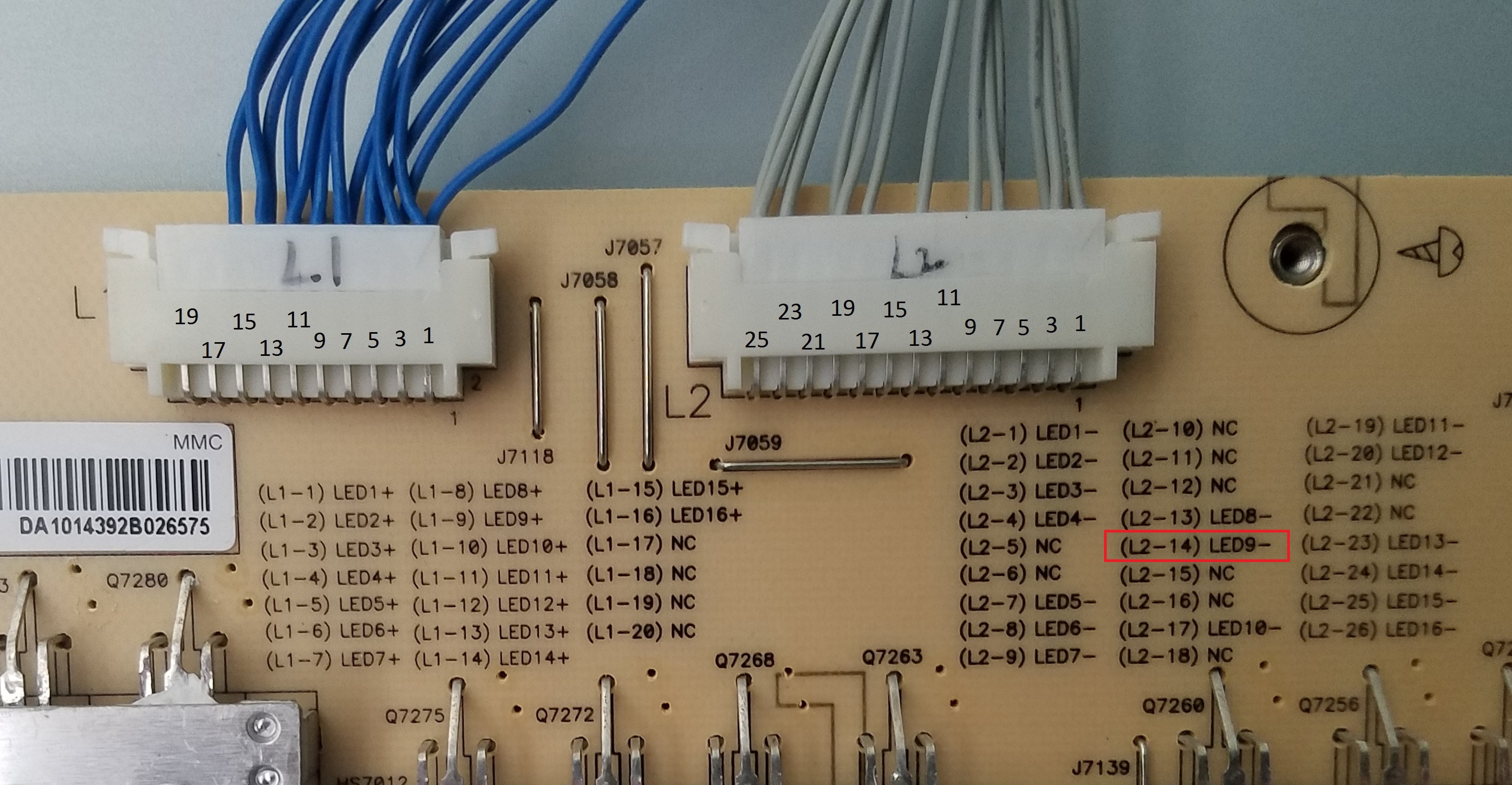

                        Readings with L1 and L2 cables disconnected, using 0-300V backlight tester on the pins of the L1 and L2 male connectors.
                        L1............LED Strip......Voltage..........L2 (Actual).....(As Marked)
                        1---------------1---------175v---------------1...................1
                        2---------------2---------175v---------------2...................2
                        3---------------3---------175v---------------3...................3
                        4---------------4---------175v---------------4...................4
                        5---------------5---------175v---------------7...................7
                        6---------------6---------175v---------------8...................8
                        7---------------7---------174v---------------9...................9
                        8---------------8---------175v---------------13.................13
                        9---------------9---------175v---------------17........*.......14
                        10-------------10--------175v---------------19........*.......17
                        11-------------11--------175v---------------20........*.......19
                        12-------------12--------174v---------------23........*.......20
                        13-------------13--------175v---------------24........*.......23
                        14-------------14--------175v---------------25........*.......24
                        15-------------15--------175v---------------26........*.......25
                        Note that the L1 connector wiring matched what was marked on the board and matched which LED strip actually lit up. The L2 connector wiring did NOT match what was marked on the board. The L1 and L2 Actual pin pairs are the ones that lit up the LED strips from top to bottom, counting them as 1 through 15.
                        Also, all LEDs lit up equally, none were any dimmer or brighter than any other. Of course that based on my naked eyes which aren't very well calibrated any more, but .....
                        I was not setup to take current measurements, can do that tomorrow, but am not expecting any surprises there either.
                        The only thing I can think of is that maybe the wiring harness may be shorting to ground or something like that. I tried using an ohm meter earlier to test pins on L1 and L2 to ground but will try again in the morning just to be sure.
                        Any other suggestions, ideas, tests that could help isolate the problem would be much appreciated.

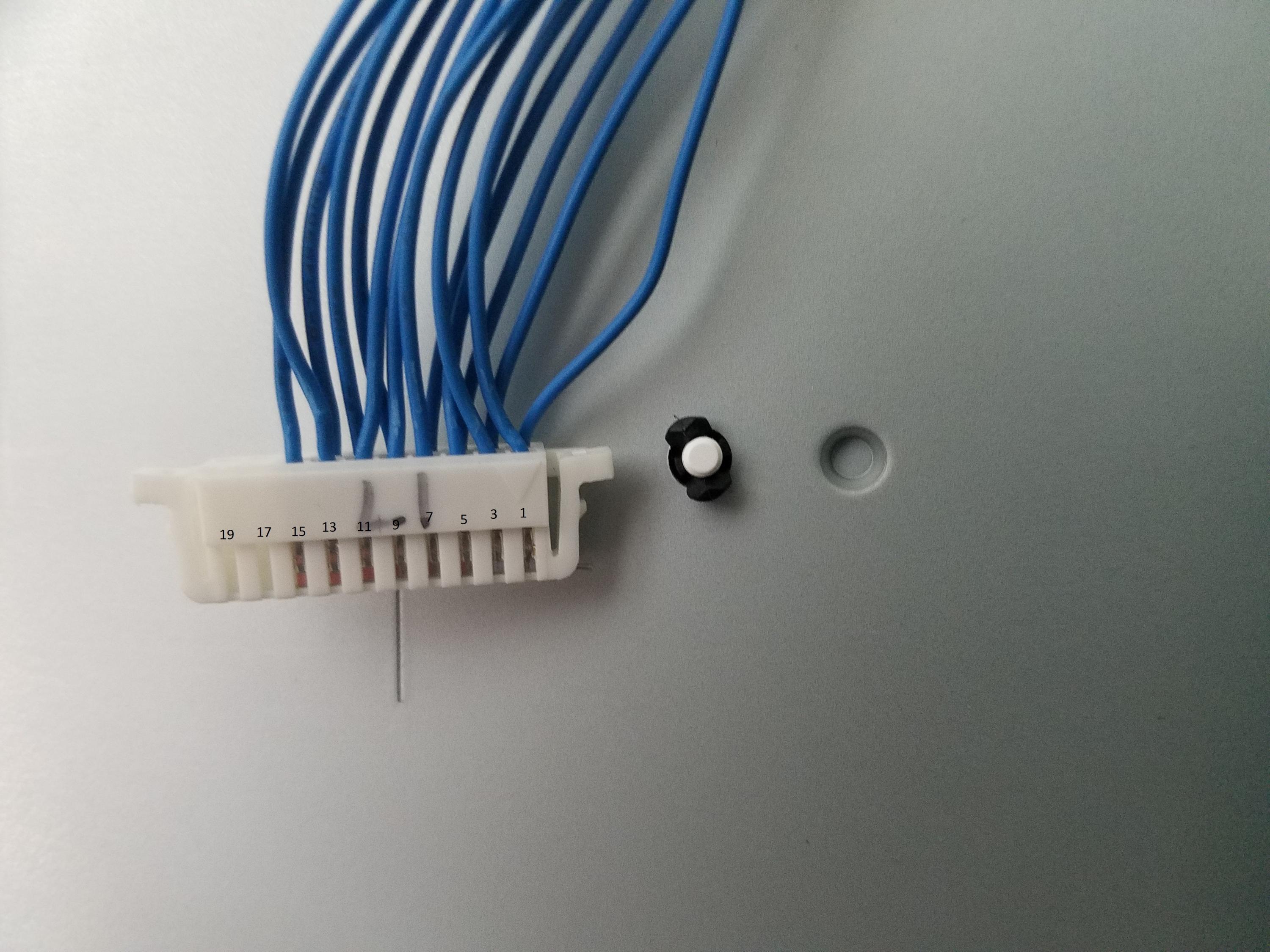

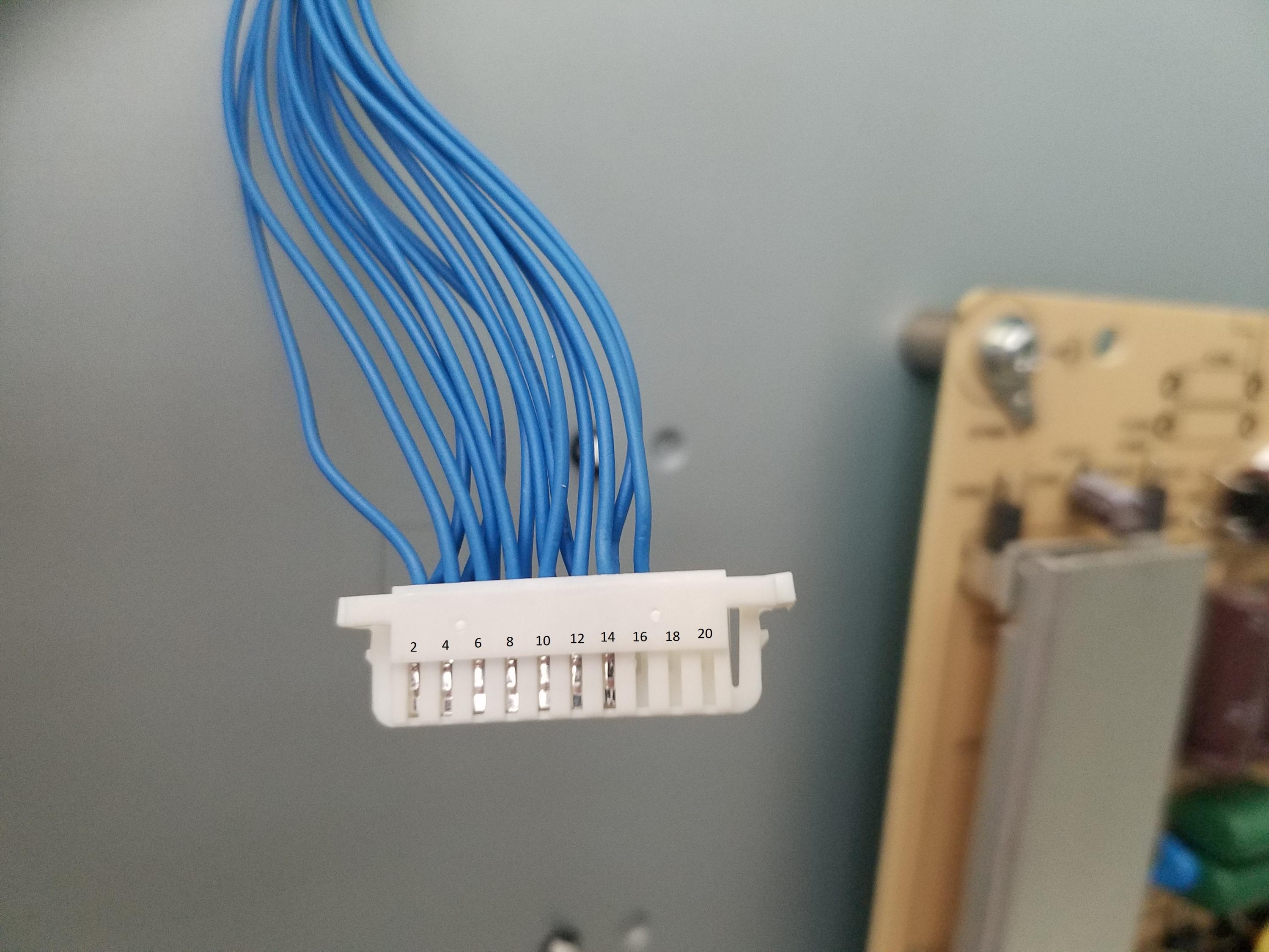

                          Just as a follow up, here's pictures of the connectors and actual pinout verses what's marked on the board.
                          I can't believe this would have anything to do with my issue though as it's been like this since new.
                          Note that the board is marked L2 - 14 as if LED 9- were connected there but pin 14 on the L2 connector is empty.
                          LED 9- is actually connected to L2 - 17 and the remaining wires are all pushed back to the next pin as marked, with LED 15- landing on pin 26 as there is no LED 16.
