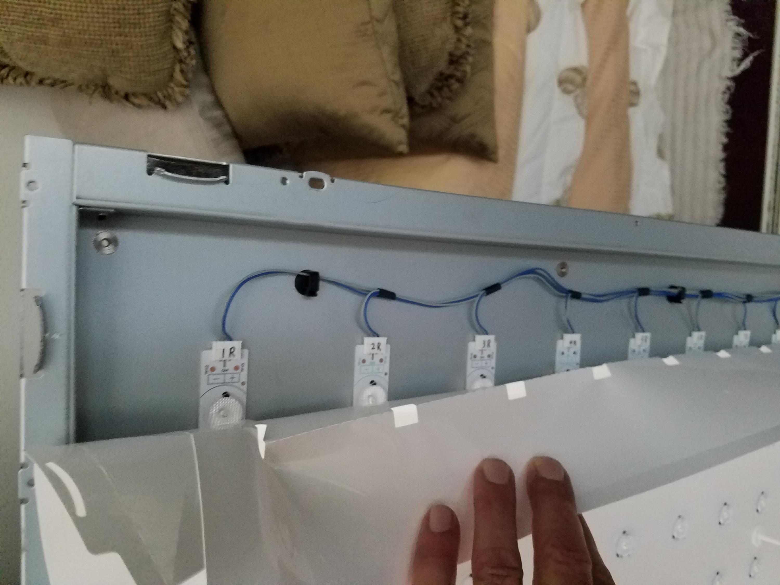

    I have a Sharp 80" TV that started giving me an error code, 1 short, 1 long blink.

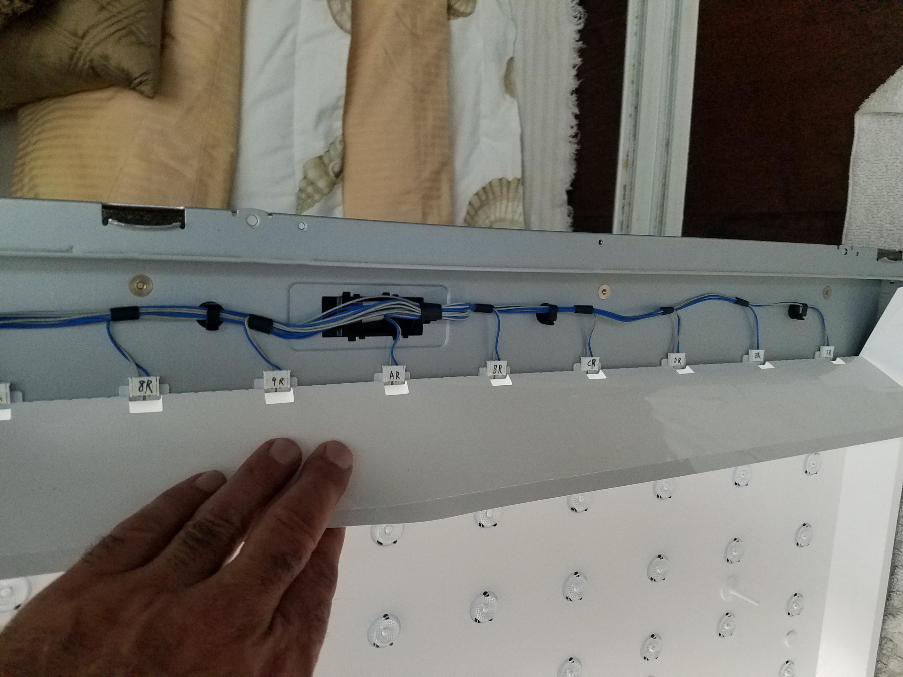

    I read that is a "Lamp / Inverter" error and am trying to figure out if there is a problem with one of the boards or with the LEDs.
    I noticed that there was some light coming from the backlight section for a brief period after plugging the TV in while holding "Input" and "Vol -" at the same time. That only stayed on for a few seconds then shut off. It was enough time to put a meter on the leads from the power board (RUNTKB096WJQZ) L1 pin 1, 3 and 5 tested to chasse ground ~130 VDC. Each LED strip is 30 LEDs long and there are 15 strips on the backlight section.
    I saw several videos and blogs where stacking up a bunch of 9V batteries would work to test the LED strips. So I separated the backlight section from the LCD panel to test the LED backlights. I tried 10 batteries = 90 VDC first but got nothing, then bumped up to 12 batteries 108 VDC (the batteries are brand new so it tests with a meter at 132 VDC).
    Anyway, according to what I've seen and read, this should be enough voltage to power one complete LED strip, but am getting nothing, no light at all.
    I am sure that the voltage is actually making it onto the strip because I tied the battery stack leads to the connector pins and tested across the little copper tabs on the strip.
    Before jumping to the conclusion that strip is bad, I tried another strip, same result, nada. So I am guessing that I'm doing something wrong.
    Any help would be appreciated, thanks, best regards,
    Tom

    You may have the voltage (V) but not the current (I) to sustain the for the backlight strip to turn ON....From what you explained....That points to a Backlight failure.......However before assuming that you should do a self-test on the PSU.

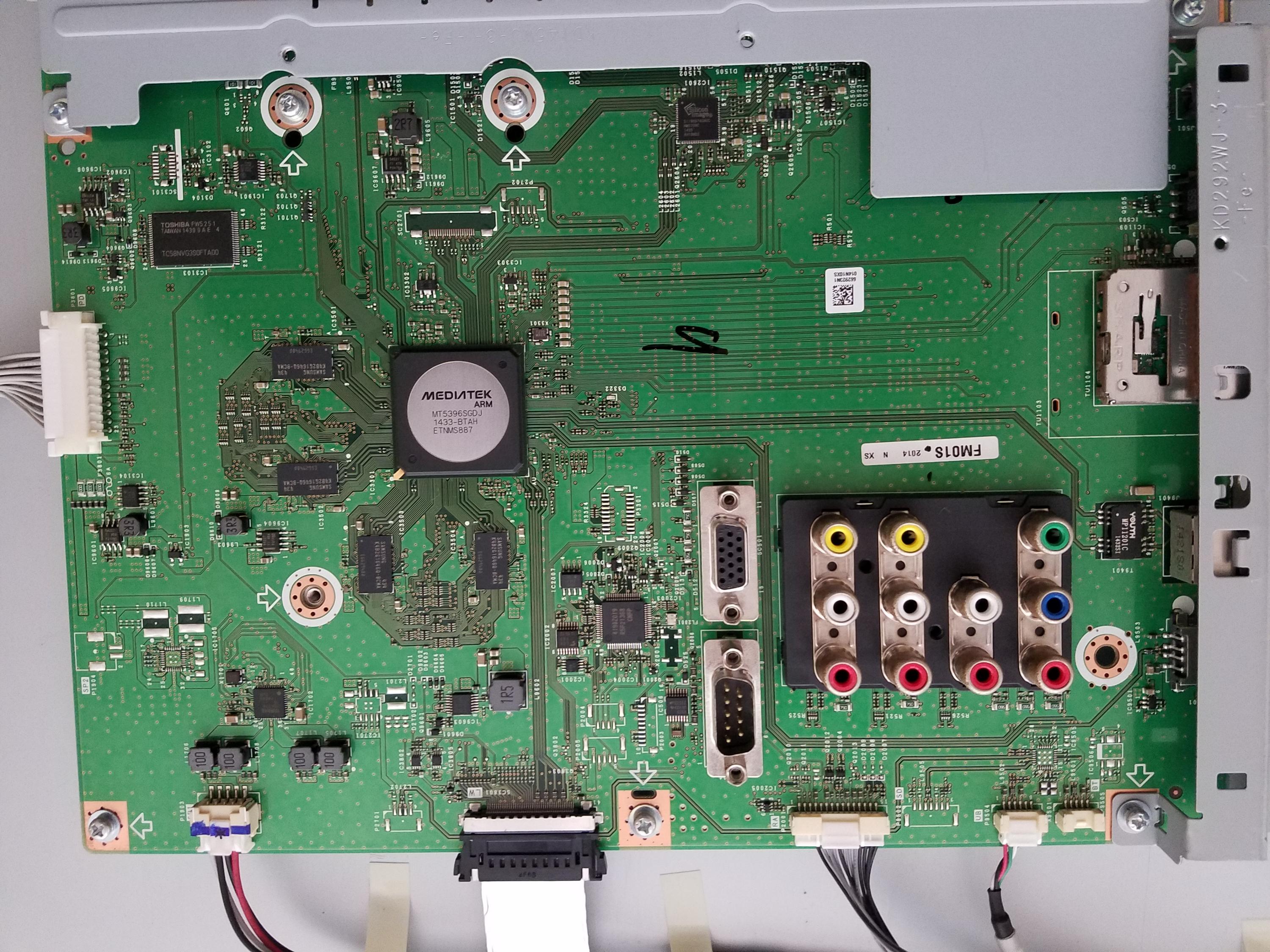

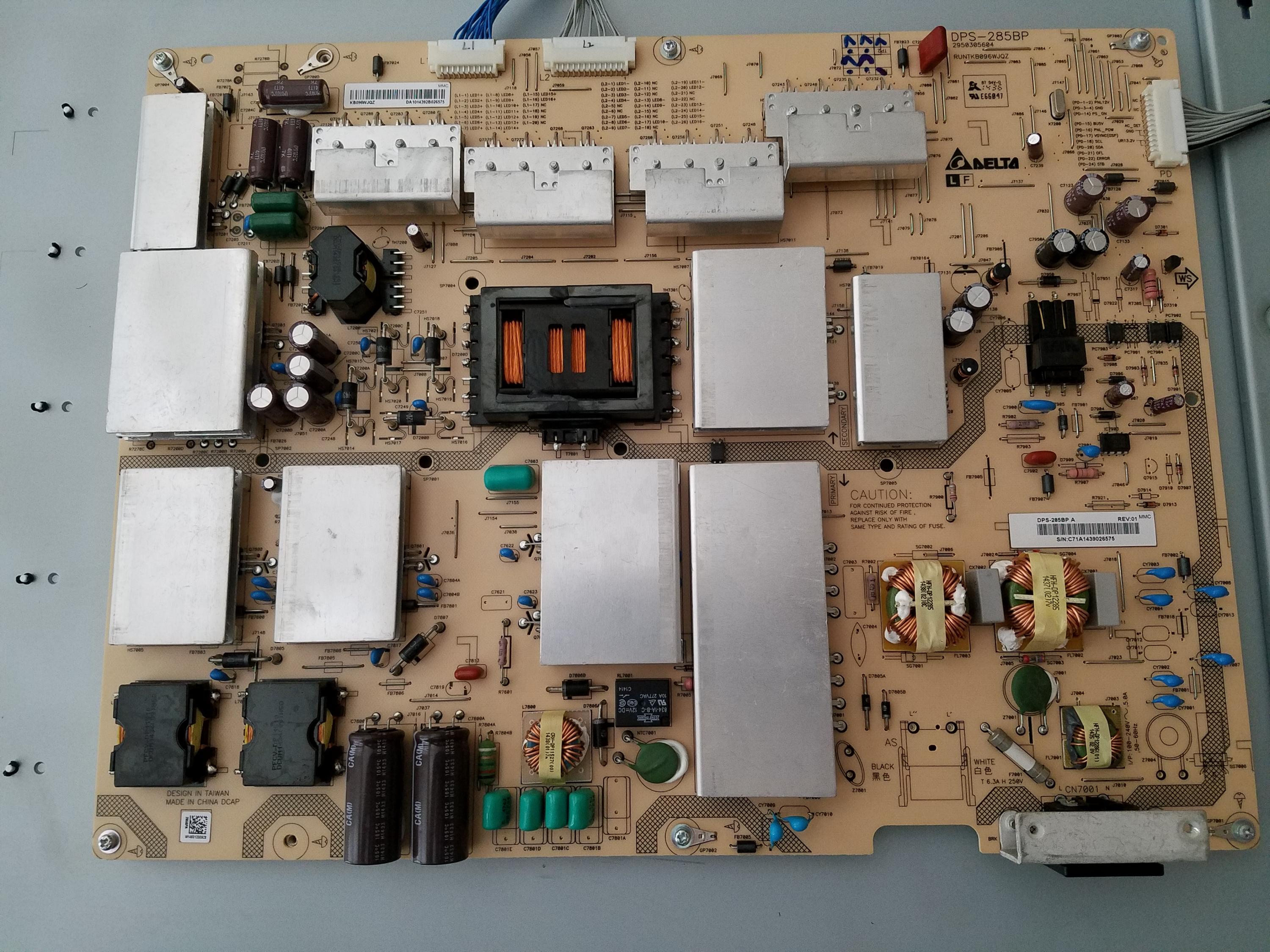

      Need good clear straight on pictures of back of tv with cover off and each board.
        Re: Little Help with Sharp LC-80LE642U
        I don't have one shot that shows the whole back of the TV but I do have individual shots of the boards. The LC-80LE642U layout looks very much like any of the other 70", 80" or 90" models. 3 boards showing main to the right, tcon middle bottom and power to the left looking from the back.
        Also, must report that I added 2 more 9V batteries to my stack and that was barely enough to light the LED strips. They all did come on, some just barely but I think a good indication that there are none shorted and none open.
        Please see attached pics of boards and backlight section.
        Is it safe to say that my backlight LEDs are OK even though some barely lit with the stack of 14 9V batteries?
        What would be the next test, power board, main or tcon, and how should I go about that. I can reassemble the backlight section with the LCD panel and mount boards within an hour or two.

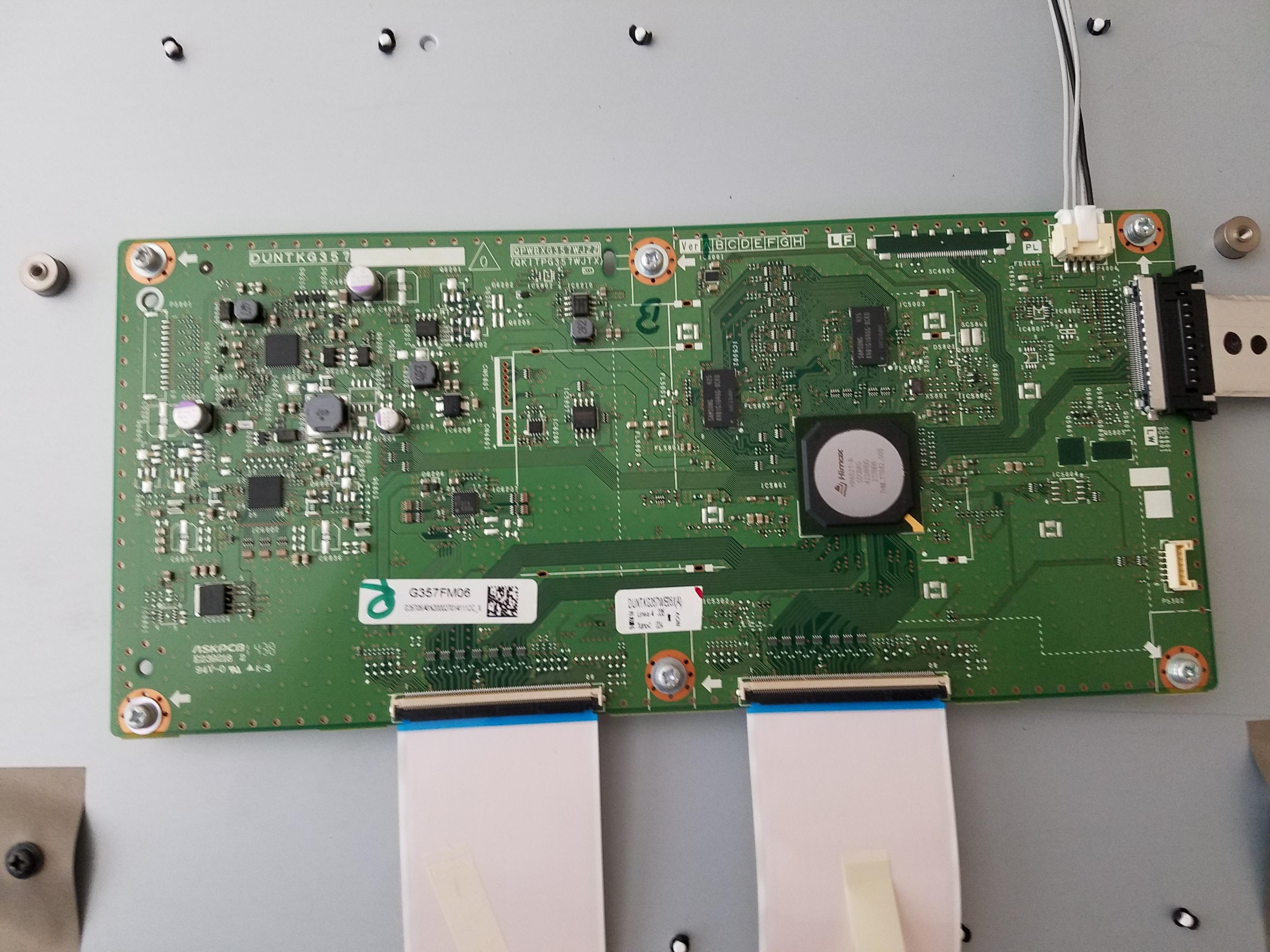

          First pic from the left is the main board, DKEYMF953FM06
          Second pic from the left is the TCON board, DUNTKF975FM18
          Third pic from the left is the power board, RUNTKB096WJQZ
          Fourth, fifth and sixth pics are the backlight section and connectors.

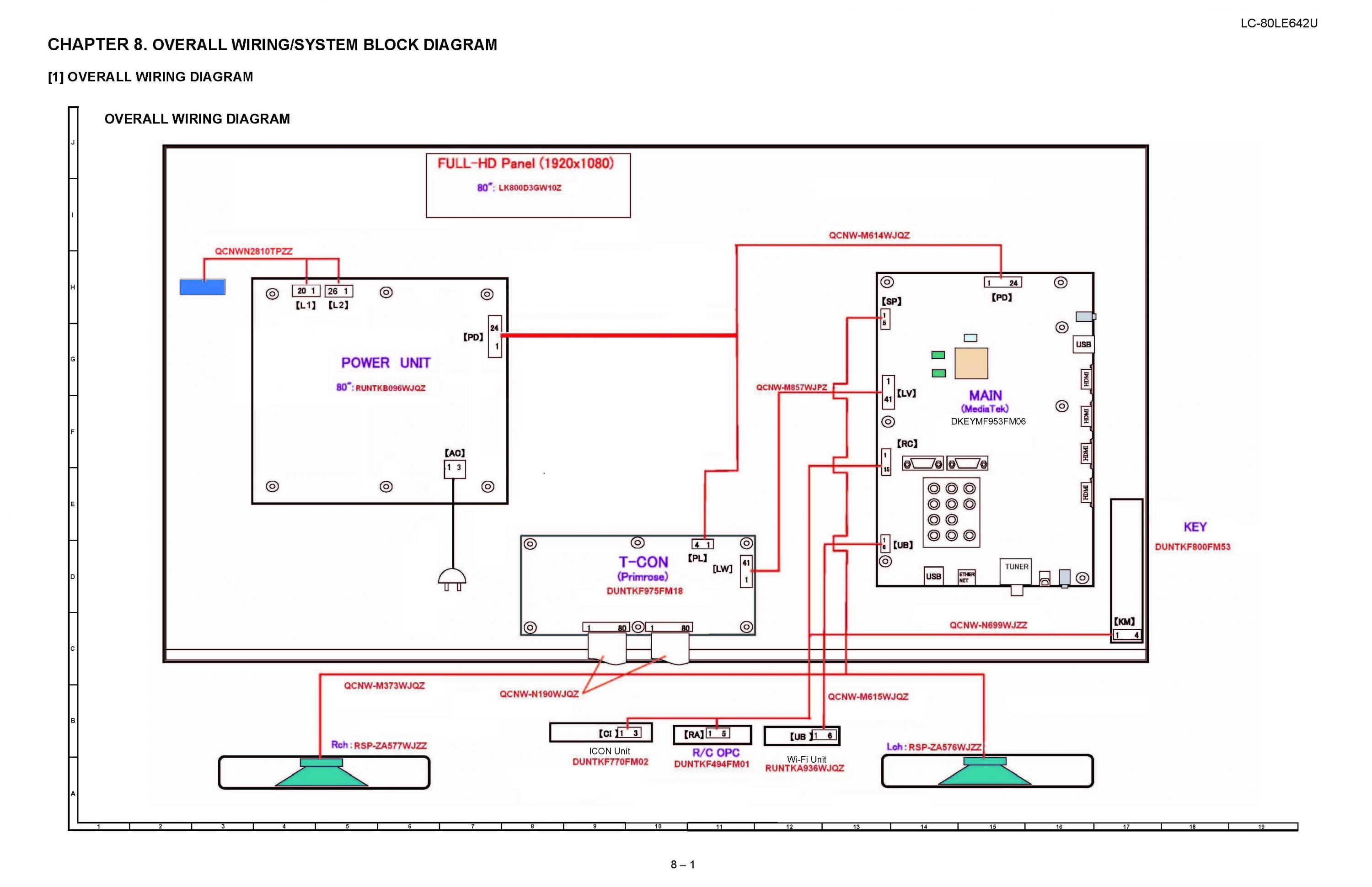

            I did find this in the manual showing the board layout and connections looking from the back.

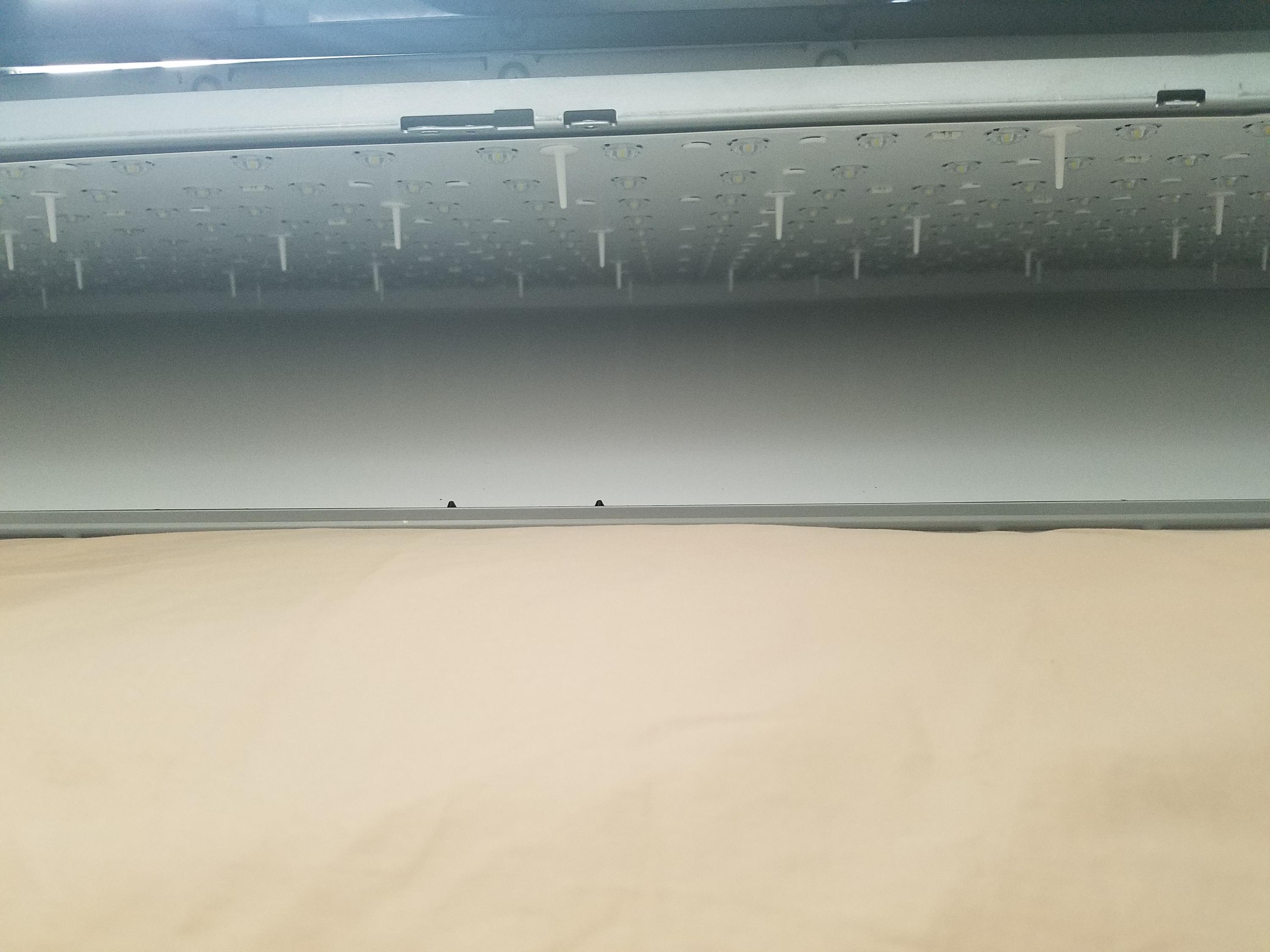

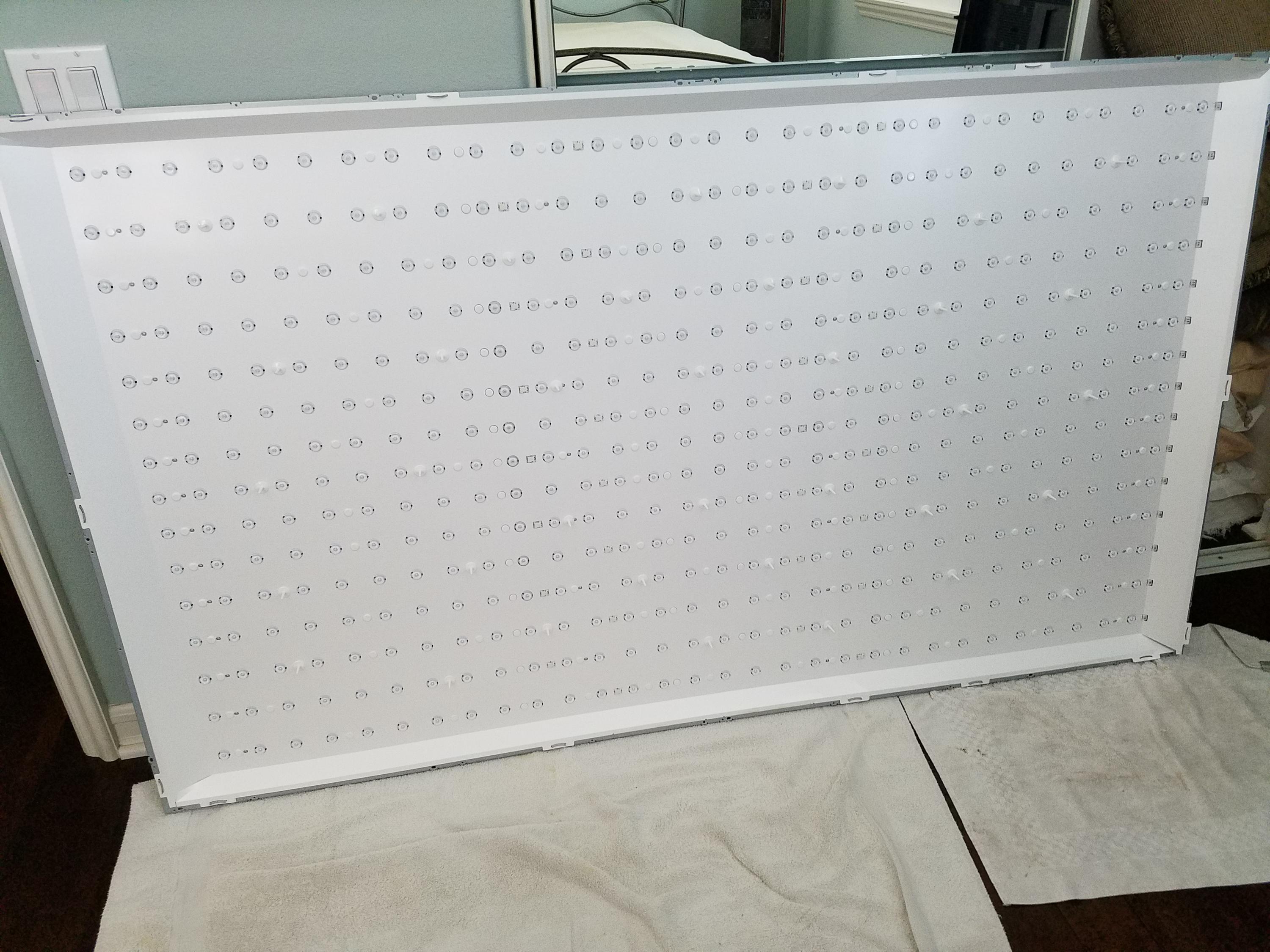

                  You have panel off. You should be able to see if any are not lighting

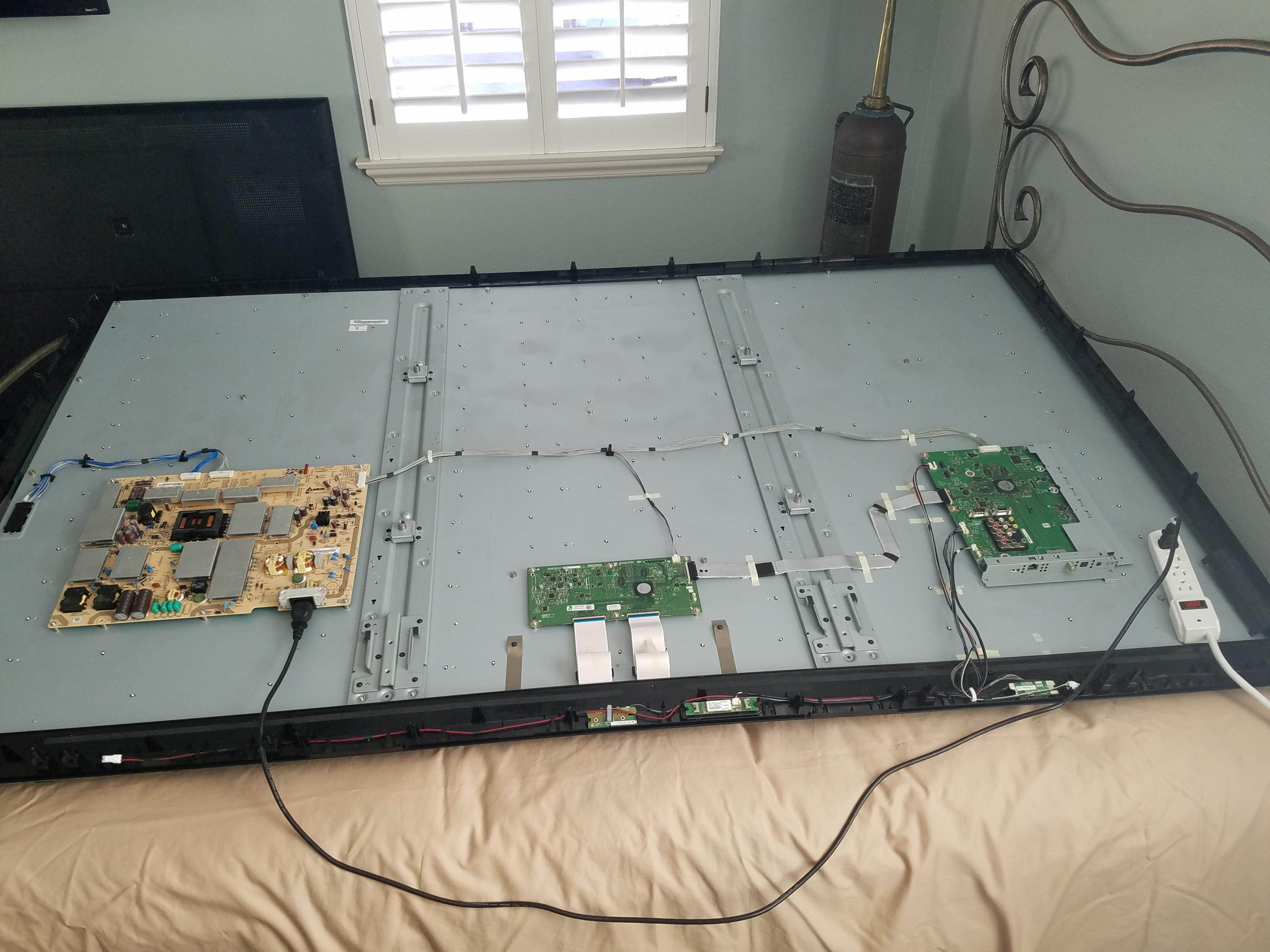

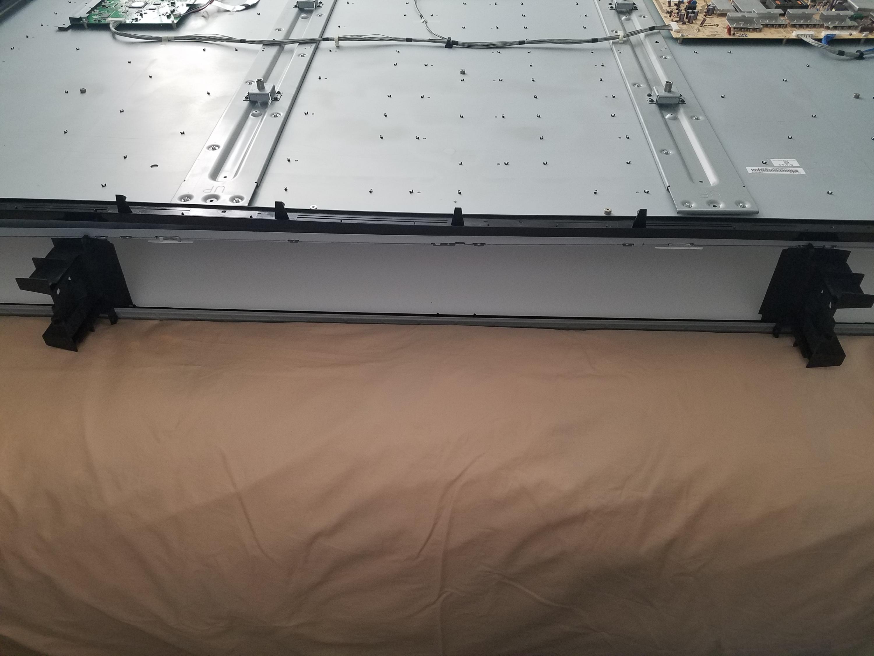

                    Here's my test setup, basically the whole TV is together. I have the LCD laying face down on a bed with the backlight section on top, and connected, but propped open at the top. I'm keeping it open using the plastic pieces from where the stand goes in. The bezel is just laying on top so that I can use the buttons.

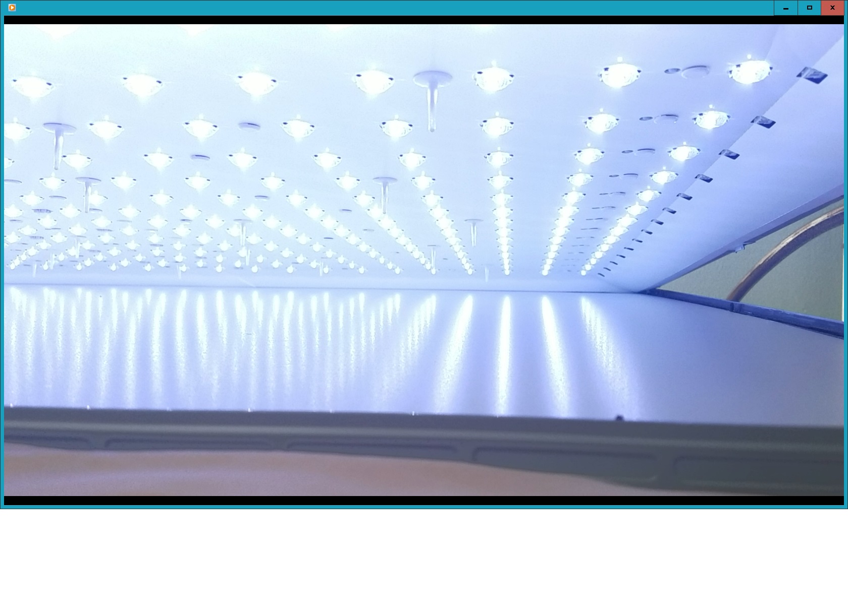

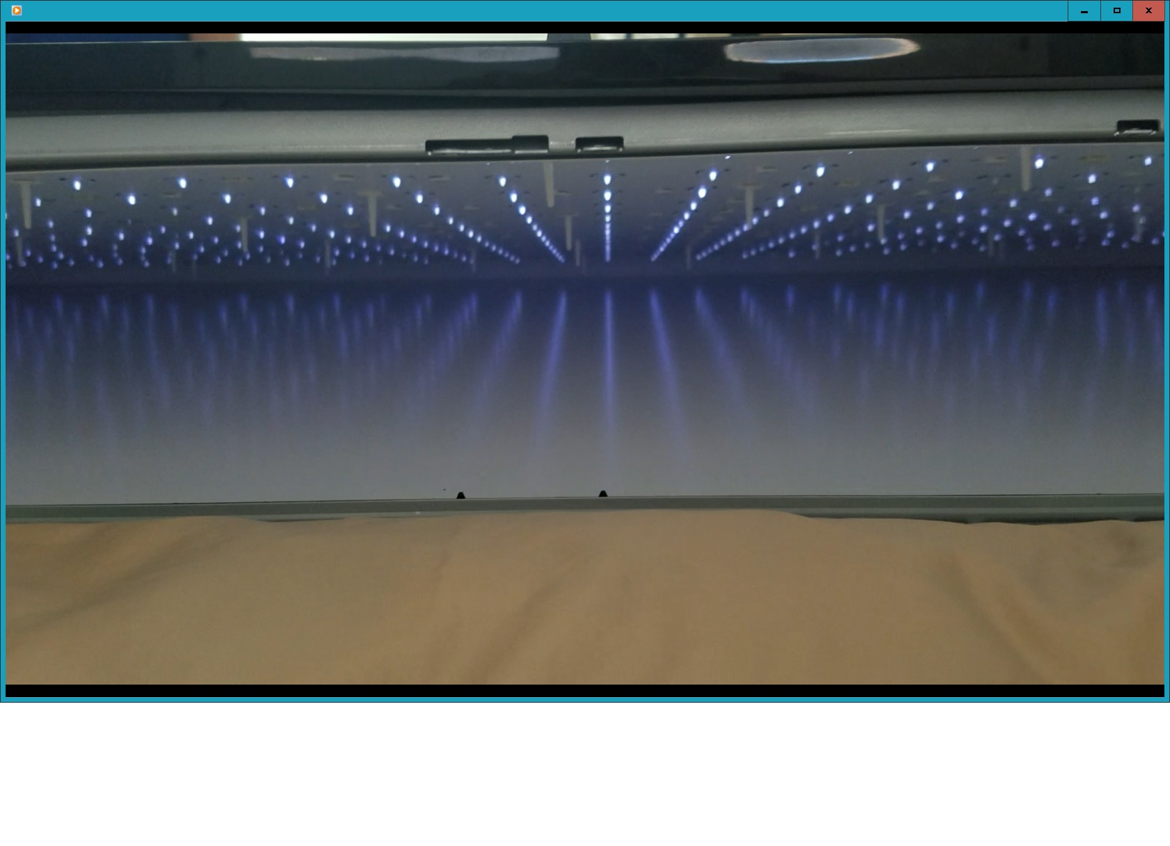

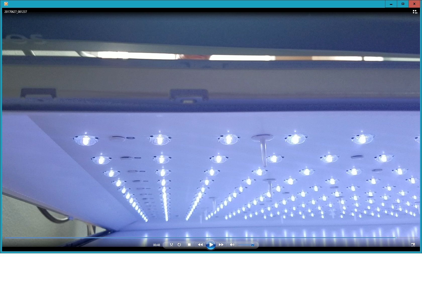

                      I took a video of exactly what's happening, but first some screen shots to show that all of the LEDs are coming on. The reason they don't look as bright in some shots as others is due to my inability to get exactly the right frame of the video to stop when I want to take a snap shot. Believe me, if the video loads, you'll see how bright they actually get.
                        Website won't let me upload a video, invalid file.
                        What is happening exactly is that I have my wife hold the "Input" and "V0l -" buttons down and switch on the power. The system takes a second or so, then flashes the LEDs full strength, then after a few seconds, the power board clicks and the icon goes back to blinking.
                        The LEDs flash very briefly, maybe not even a whole second.
                          I also have to say that it seems like the LEDs stayed on until the power board clicked when I tried this before but working from memory at this age isn't my strong suit any more. :-)
                            The first picture right side looks like a couple not lighting. The shear number of leds makes it hard to detect.
                              I think what you are seeing in the first picture isn't that the led isn't lighting, its being blocked in the picture by the "standoff pin".
                                I'm almost positive all the LEDs were all lighting. We repeated the reset procedure several times. Also, I'm hearing that they should have stayed on until the power board clicked, as I described earlier, they should not have just flashed.
                                If bad LEDs were the cause wouldn't the ones that were still ok stay on until the power board clicked and shut off? Shouldn't I have been able to see clearly for at least a few seconds that some were on and others were not?
                                The change from earlier, staying on until the power board clicks, verses big flash makes me think the power board was headed south the first few tries and is completely shot now. That's not to say that some of the LEDs aren't bad too but honestly, think they're OK.

                                  Following this. Can you tell me how you took the lcd panel off safely? That's a big panel
                                    I laid the TV face down on a bed and pulled the back off.
                                    Disconnected at the board end speakers etc. anything attached to the bezel.
                                    Then very carefully stood it up on the top edge.
                                    And walk it on edge across the bed to make room to lay it down on it's back.
                                    Be careful not to let the bezel catch on the covers or it will get pulled off.
                                    If you keep it a little at an angle leaning / favoring the back it's not too hard.
                                    Anyway, with the TV on it's back, and bezel mounted equipment cables disconnected, the bezel lifts right off just pull the tabs.
                                    Now undo the screws holding the backlight and LCD frames together.
                                    However, not all of the screws. Take all of the screws out of the sides but not the top and bottom. I left every other screw in top and bottom.
                                    Then go through the same lift and walk on edge procedure to get it laid back face down.
                                    Slide enough of the screen over the edge of the bed to remove the screws from the top or bottom, and slide and repeat for the other end.
                                    Once all the screws are out, you can lift the backlight section off of the LCD panel without too much trouble, IT TAKES TWO PEOPLE. Fortunately, my wife was home to help. She's a sturdy girl :-)
                                    I actually found it more convenient to just leave the backlight section on top, just propped open to see what the LEDs were doing.
