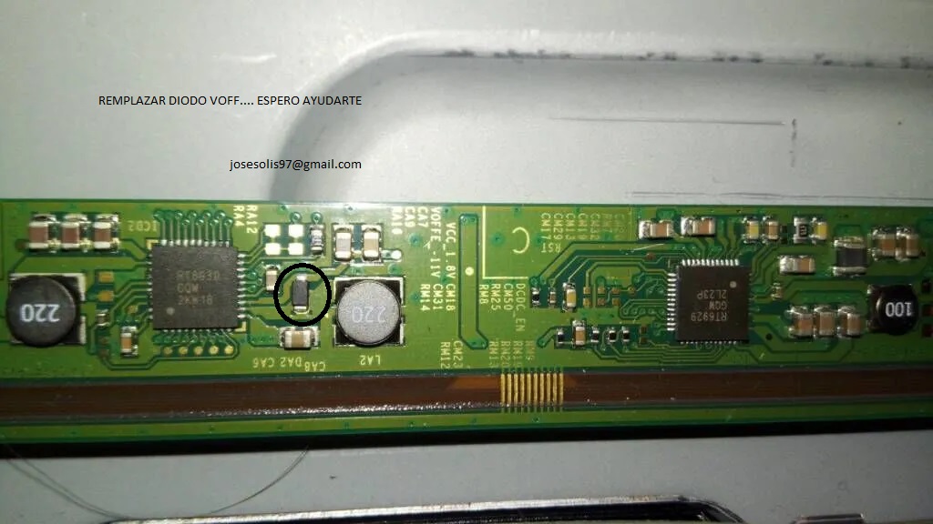

                    #29
                    Re: Sony KDL-48R550C, need comments is it Panel FAILURE?
                    remplazar diodo VOFF y listo

                        #31
                        hello sir, I tried changing the diode, but it didn't work

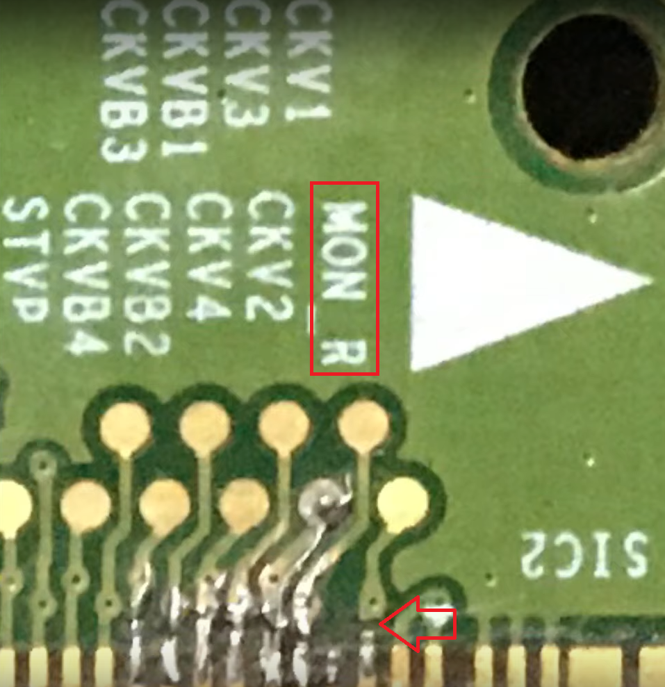

                                  #36
                                  Hi all!
                                  I know this is an old topic but i have exactly the same problem.
                                  Here's what i tried:
                                  USB blind upgrade. I succeeded but still no joy.
                                  I cut MON_R and MON_L as in the video. No picture....
