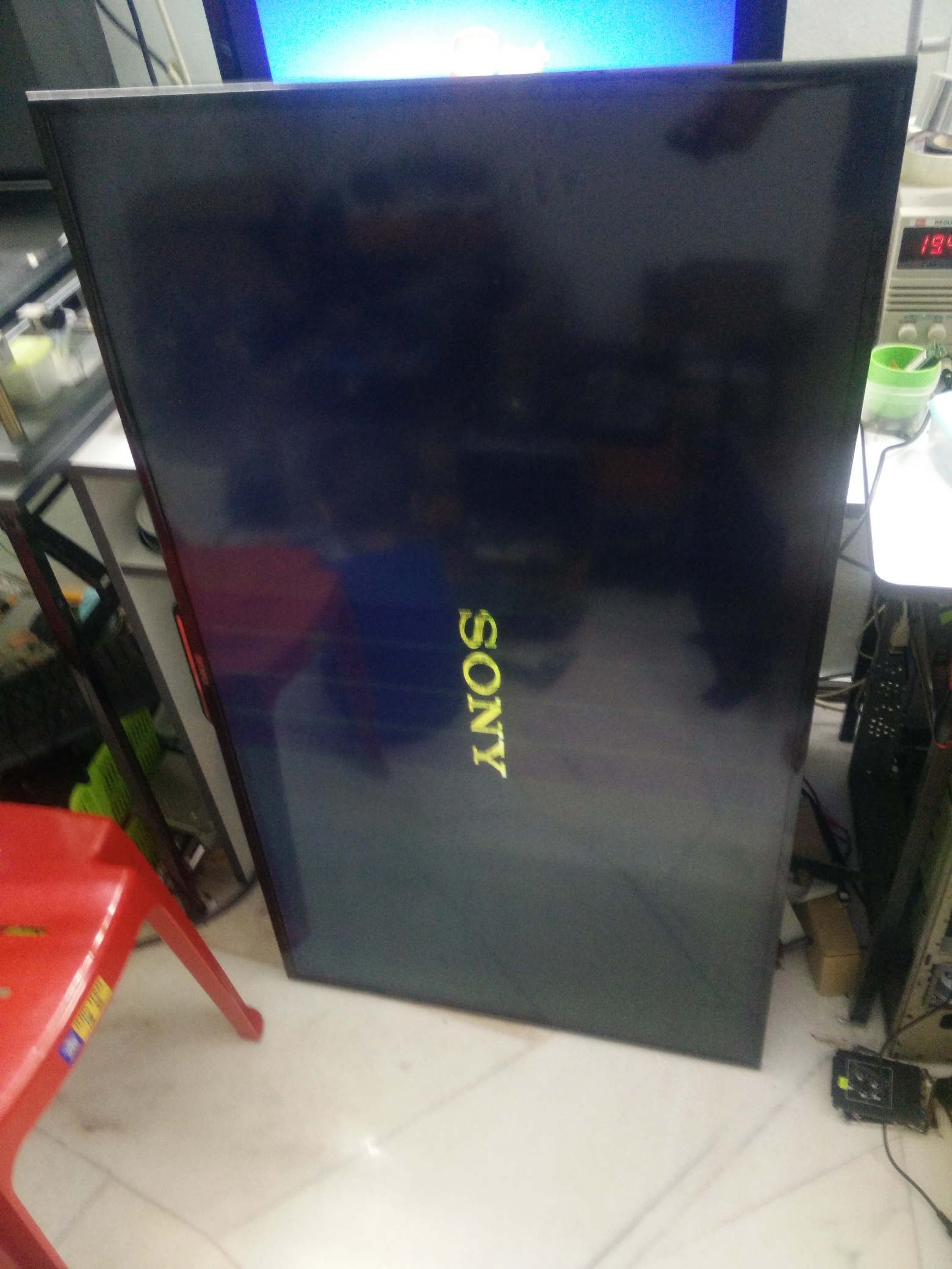

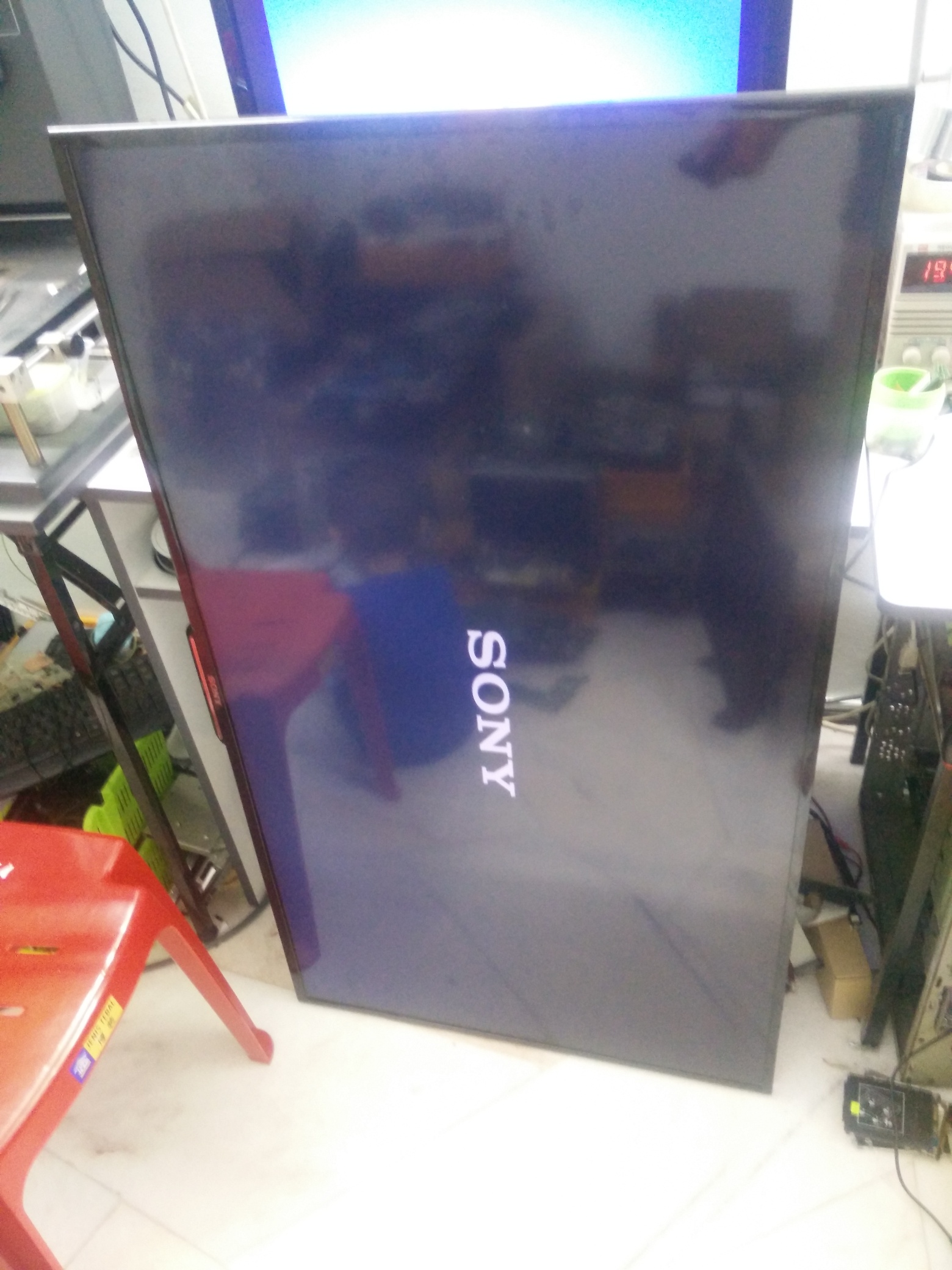

    I hope some experienced tech here can offer some advice.
    Is this TV panel failure?
    Starts up normal, with bright SONY logo. In about 1 second, the logo colour distorted and as can see in the picture, the whole panel have some artifacts and distortion. Then the screen is black without any picture. Have backlight, have sound playing from the HDMI input as long as I don't power off the unit.
    Here I attach 2 photo, which I tried my best to snap it.
    Thanks in advance.

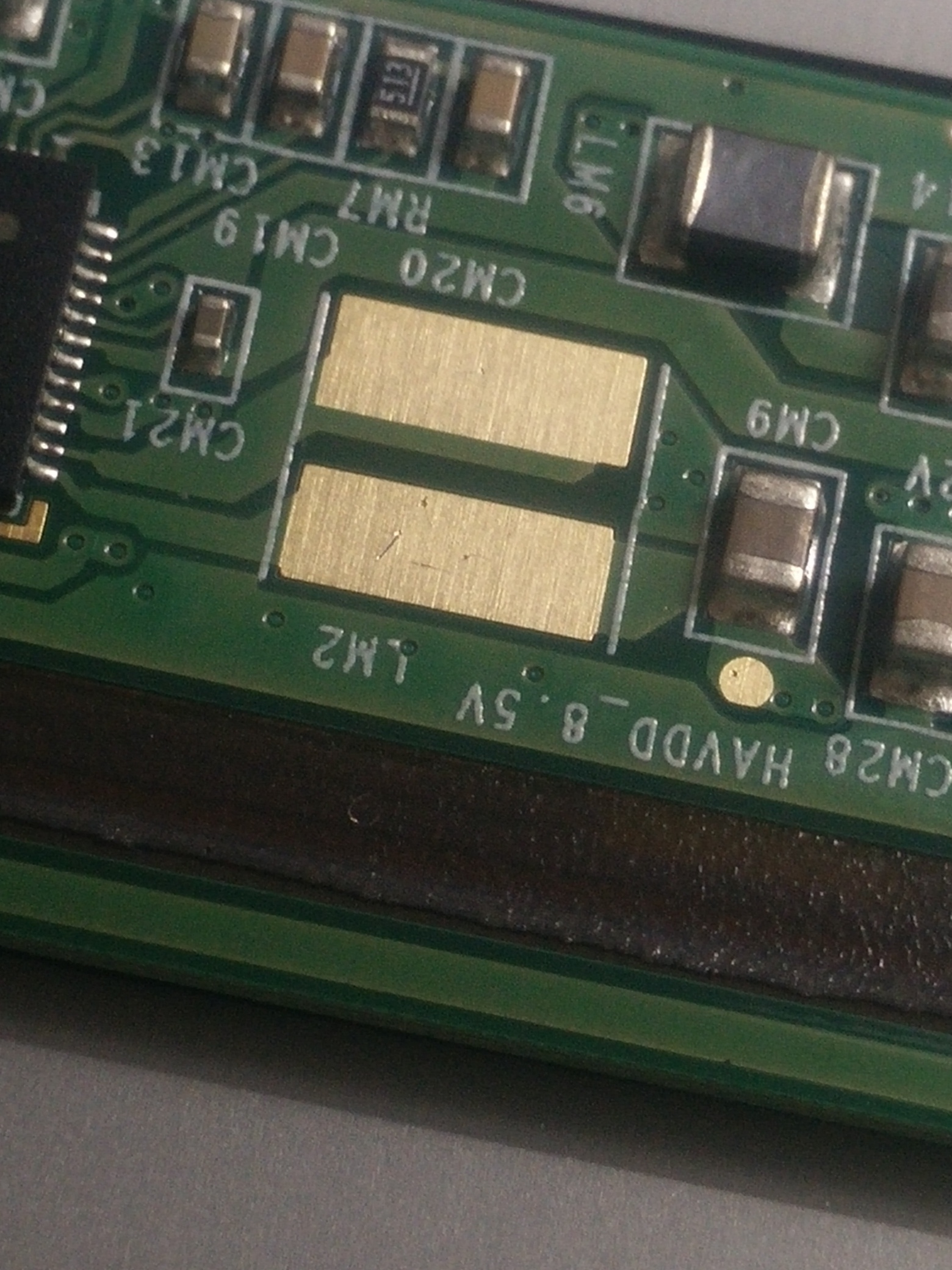

      TCON F1 fuse both ends have 11.98v (12v)
      One part, HAVDD_8.5V, this pad only have a supply of 8.5V when I was powering up the unit. In an instance, its gone back 0v. Something is not right here. Its directly comes from RT6929 (still trying to search the datasheet)
      Can enlighten me what is this HAVDD ?

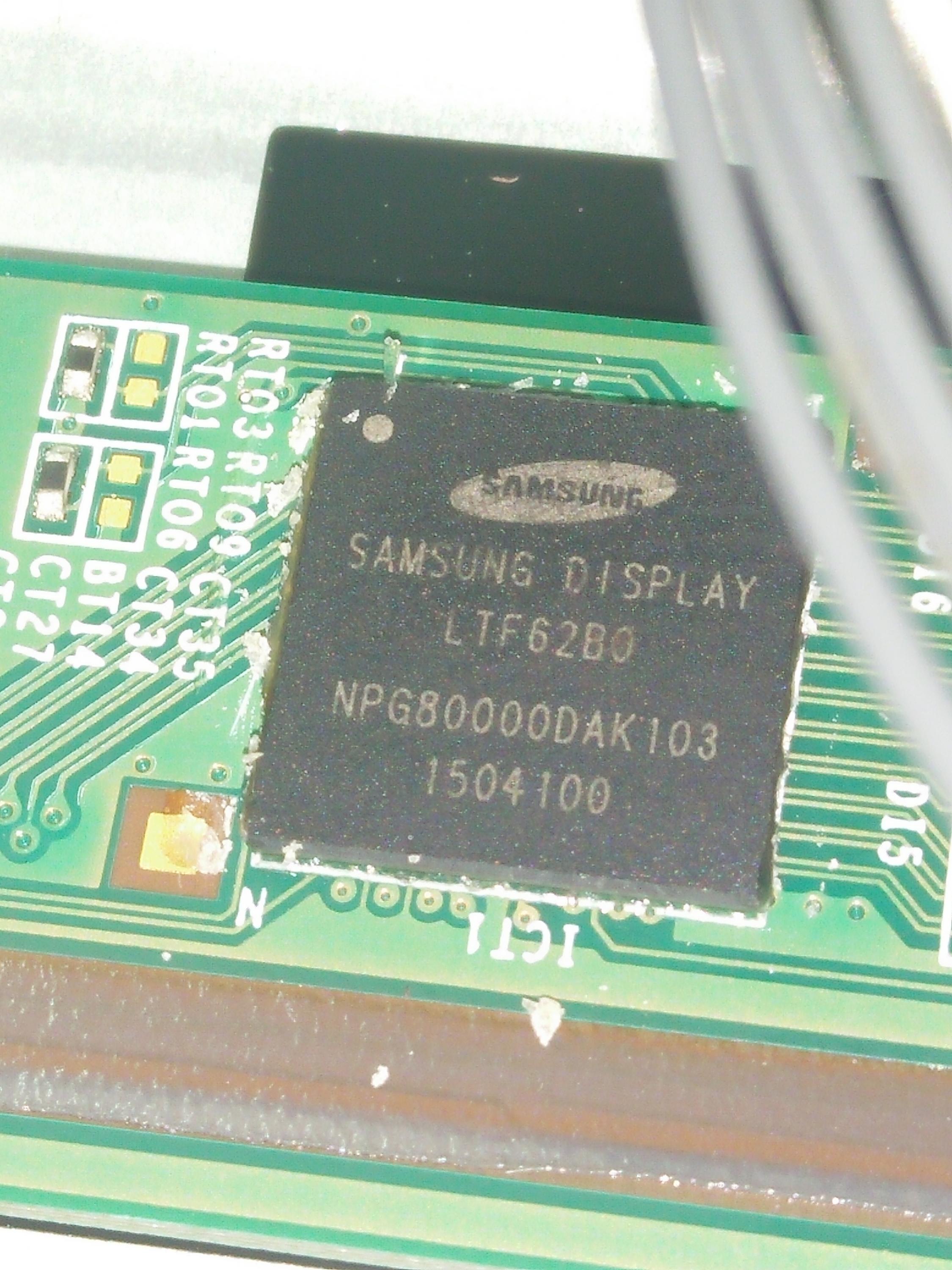

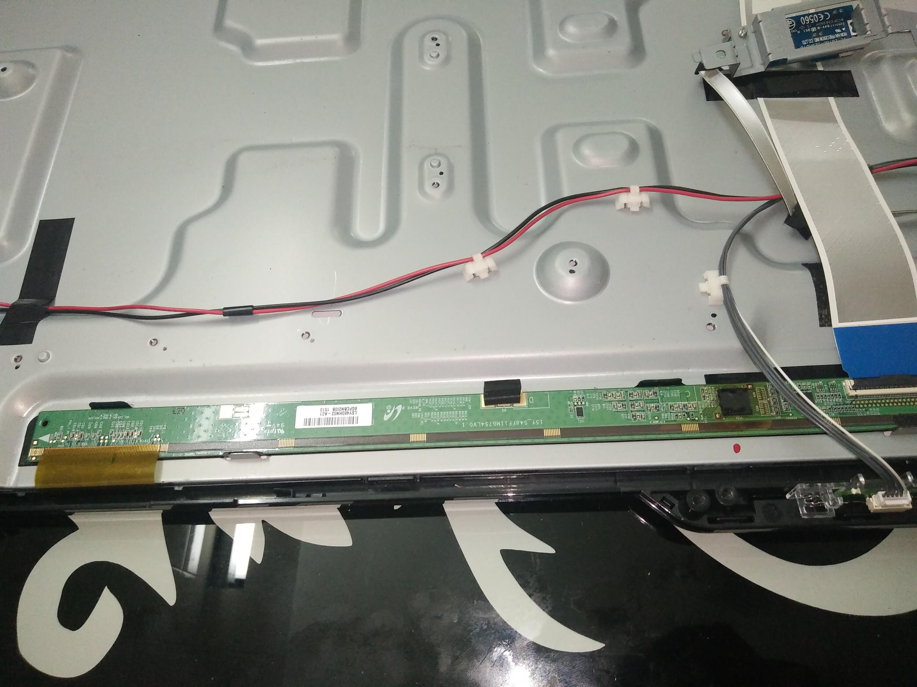

          Afraid have to locate and replace the IC. Here is the TCON for this model

              Suspecting RT6269 but cannot confirm at this moment. Didn't manage to locate datasheet and schematic.
              After powering up, the tcon have all power voltage. And lost some of it. Now I also notice the 28v also just available for a second or two, then cut off.
              This is not an easy job, as can't remove tcon from assembly. I don't have equipment to affix the tcon pfc back to the led panel.

                  On further investigation, I believe that TFTs within the Panel are shorting/defective as a result you are getting voltage drops/loss at those test points. So I will suggest irreparable unless you can access the exact Panel for replacement.

                    If I were you A would try disconnecting the ribbon cables from the tcon to the panel then measure output voltages and see if they stay high
                    It's they do try one ribbon cable at a time and see if the voltage is stay high and you have a good picture on 1 side I will be a definitive answer. I would say side tab gate drivers shorting

                        Ok, I am back at this TV after months. And found the problem. But it is not easy to replace the faulty chip. A FBGA. This LTF62B0. Going to buy from China about USD2, later I update once I fix and try it.
                          I don't have equipment to fix the pfc back if I pull it out

                            How do you found the faulty IC?
                              I think you misunderstand... feakaftr8 is referring to the "unclampable cables" not the solder / bonded ones.

                                freak is been clear, he don't noticed that jeremy can't unplug tcon output cables..

                                  Ok i see now. Tcon embedded on the FRC. Oh boy. Did you use heat or freeeze spray to find out that IC was bad?

                                    i have doubts that that big ic is the faulty part, usually central tcon ics have no control on power supply part of the board, so if havdd =half avdd = 17v/2= 8,5v is present only for few instants, probably some part of the pwr supply section is bad or panel is shorted.
