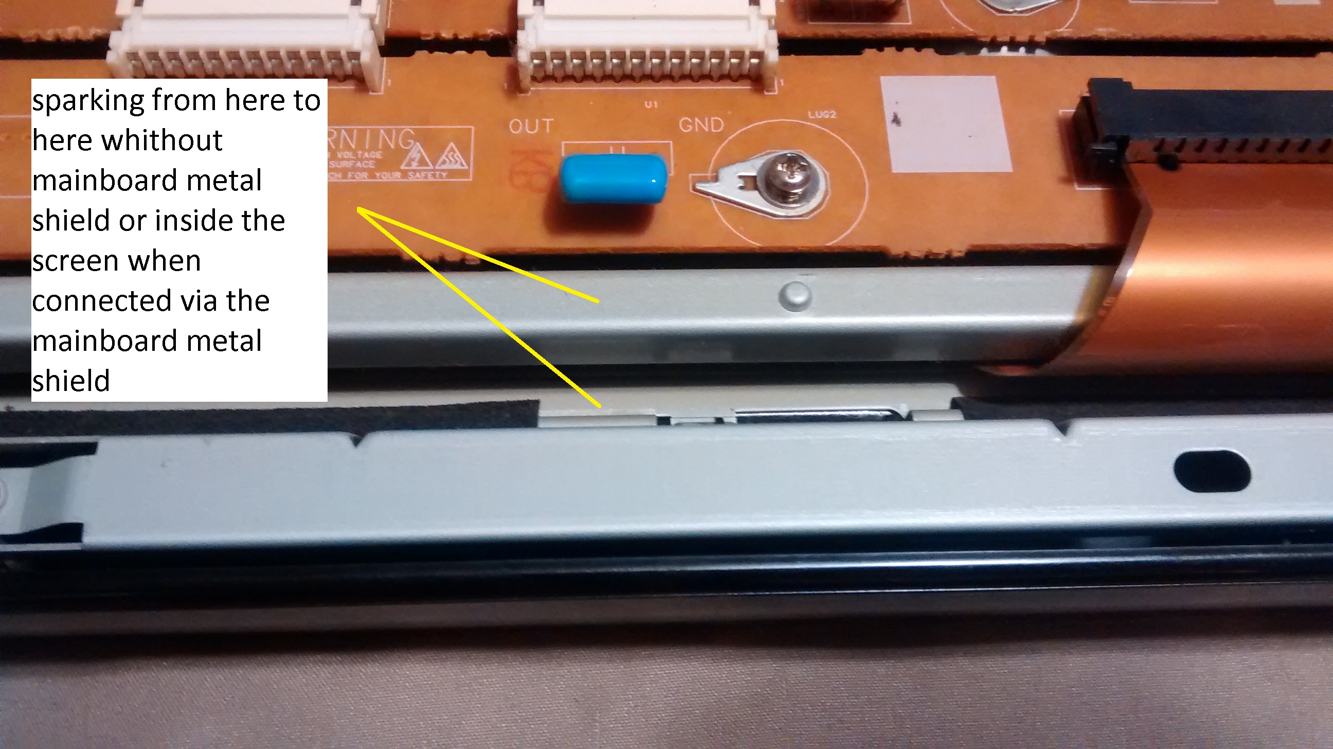

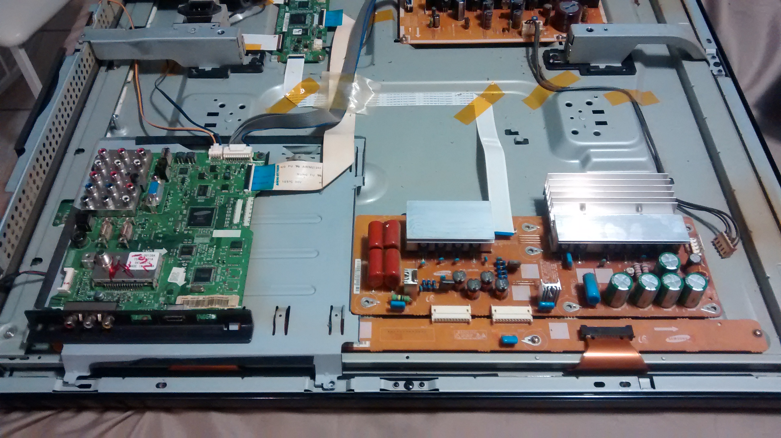

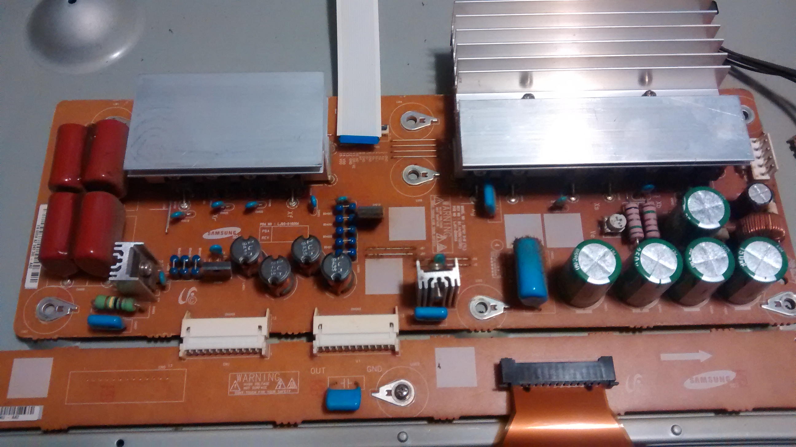

    Hi experts,
    I've never seen something like this before. There are sparks inside the screen near the X board. When I remove metal plate under the mainboard that connects chassis to outer metal frame the sparks occure between these two. Nice lightshow.

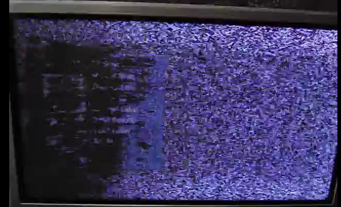

    There is a black shadow on the upper left corner (slow mow pixelisation effect) similar to the attached pic.
    VS/VA, 15V are ok. No cold solder joints, apparently no faulty component on x-main.
    What should be the signal like on the flatcables towards the screen? What can be measured there?
    Thanks for any ideas

    Re: Samsung PN50B450 sparking screen
    someone else had a similar problem once, but i can't remember on what model.
    he ended up replacing the insulated foam tape that goes on the inside of the outer glass frame and it sorted his problem out.
        It sounds like a very similar problem. I'll check it out.
        I still have the dark left picture though which looks more like a X-Main fault but couldn't find anything wrong with it yet.

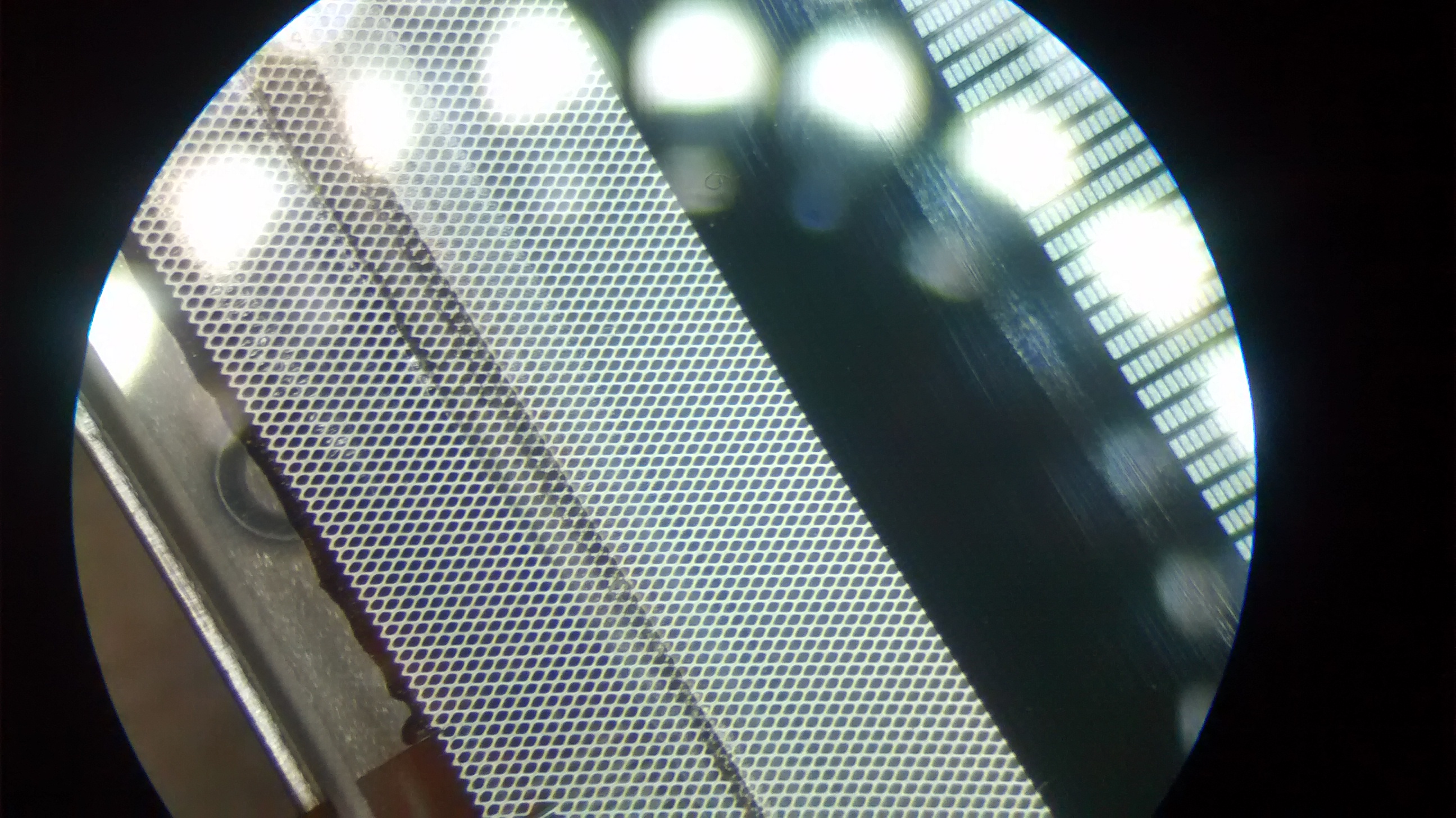

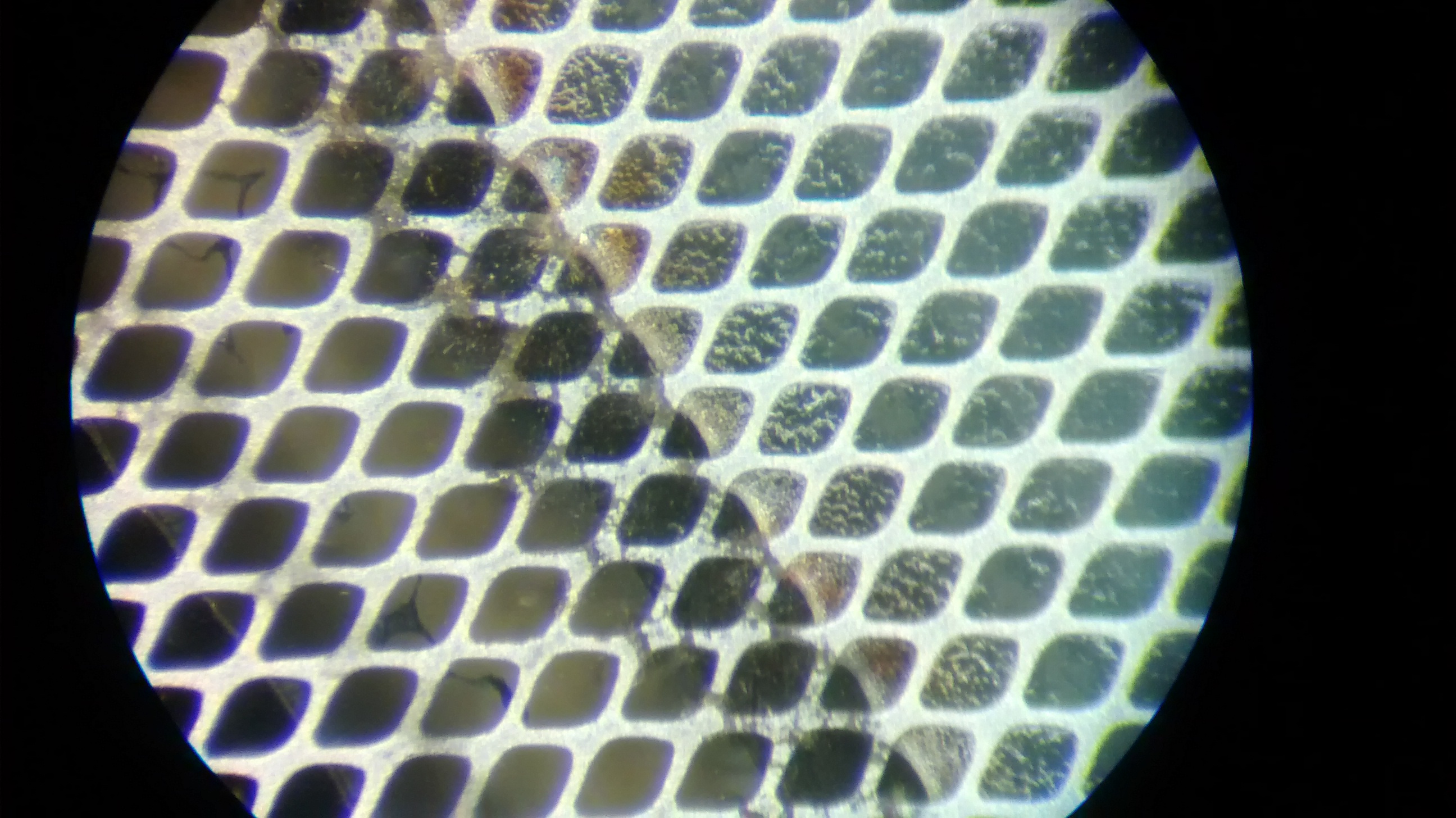

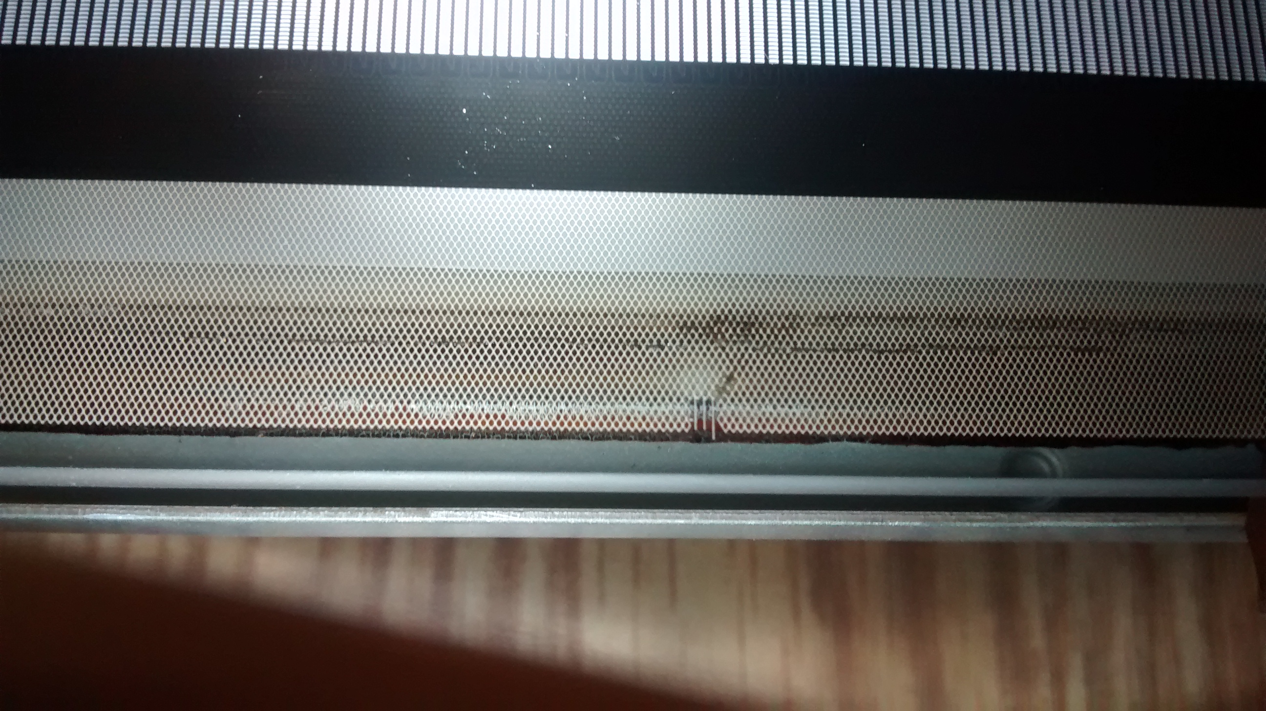

              The panel is toast. There is a conductive grid inside/underneath the glass where the flat cables from X-Main come. This grid is largely interrupted and this is where the sparks fly from one side to the other.
              At least I learned something, e.g. that the inside of the protection glass is conductive Could be used for some project maybe
              You can see it in the video here:
              https://www.youtube.com/watch?v=Zpm_oDCAUFk
                didn't know that was your youtube account.
                are you sure that you can't insulate it between the arcing points?
                  The X-main cables go to the grid, then the grid is interrupted, the other side of the grid not being accessible. There is nothing I can do unfortunately.
