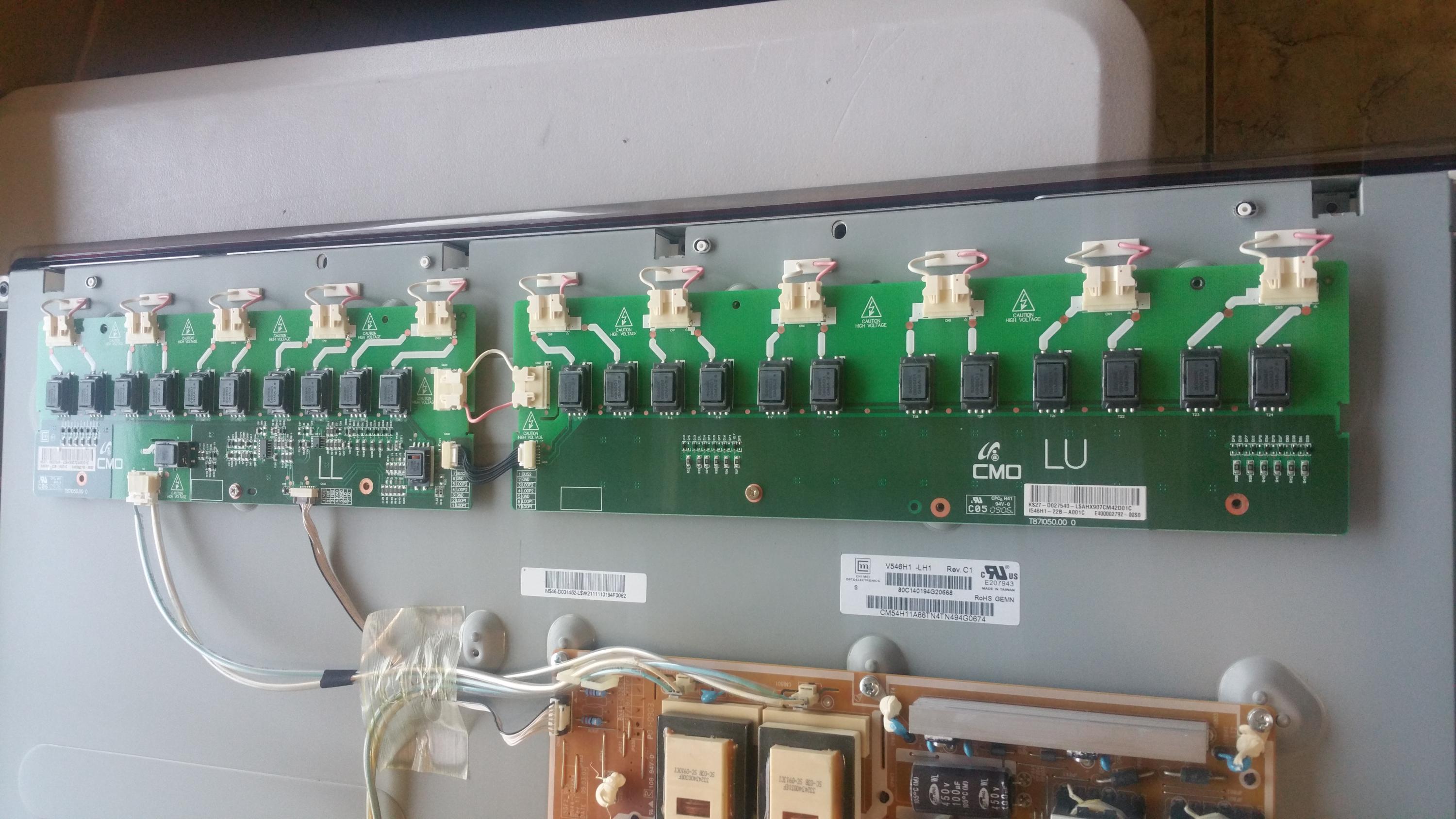

    TV have sound but no backlight.
    I can see image in the dark with a flashlight.
    If disconnect the main board - PSU cable nothing happen.
    LD: 12.35v
    FB1 and FB2: 0v

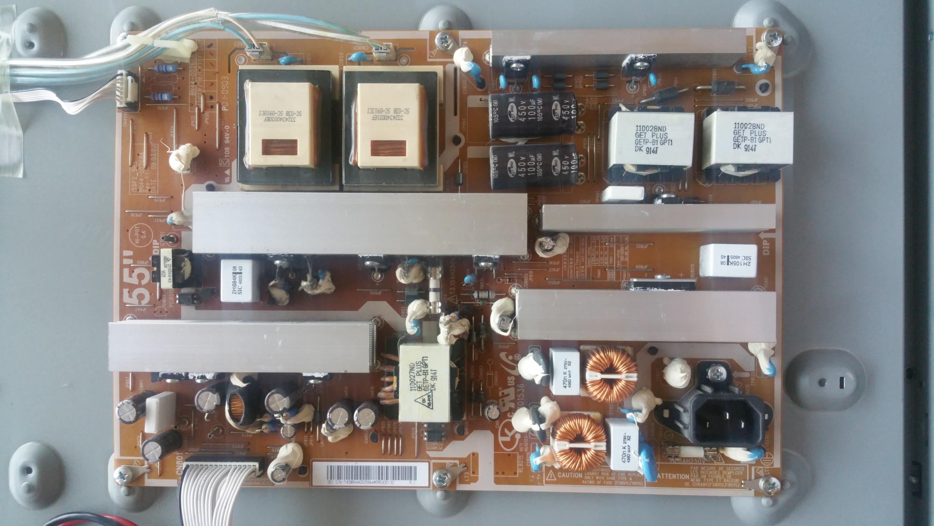

    1) Did you find out if you have BL-ON signal to turn on the backlights circuit or not?
    2) Do you have about 380~390vdc between the + and - legs of either one of the two main filter caps?
    3) The fuse in the middle of the board which is for the inverter circuit is good?
    4) Did you see the backlights even come on for seconds if you at the screen in the dark room?
    5) the white rectangular cap with 2h684K has the correct capacitance?

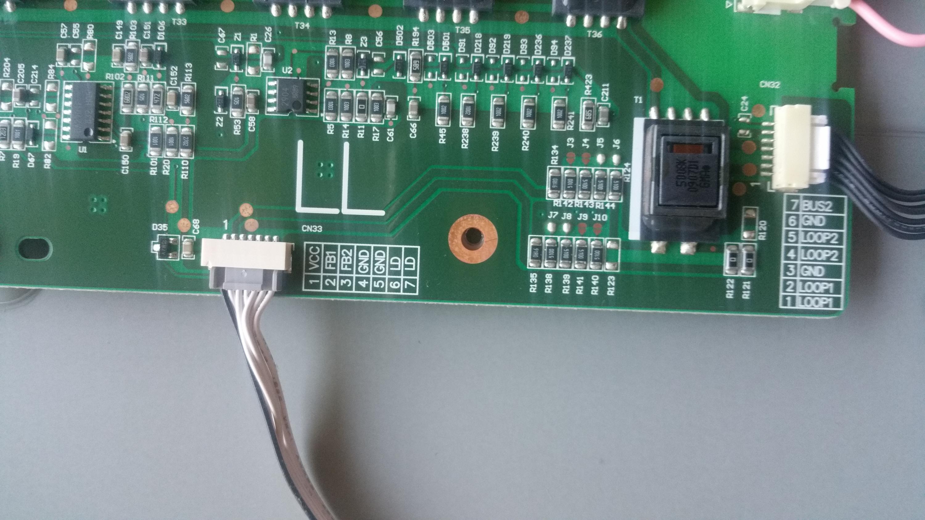

    LD Voltage is find, >11V = good, <10V = bad
    FB1 and FB2 are very low AC feedback Voltage, they are not present at this point because the backlights are not on.

      Re: Samsung LN55B650T1FXZA no backlight
      Inv-On: 5.1v
      Main Caps: 386v
      Fuse: Ok
      Backlight never come

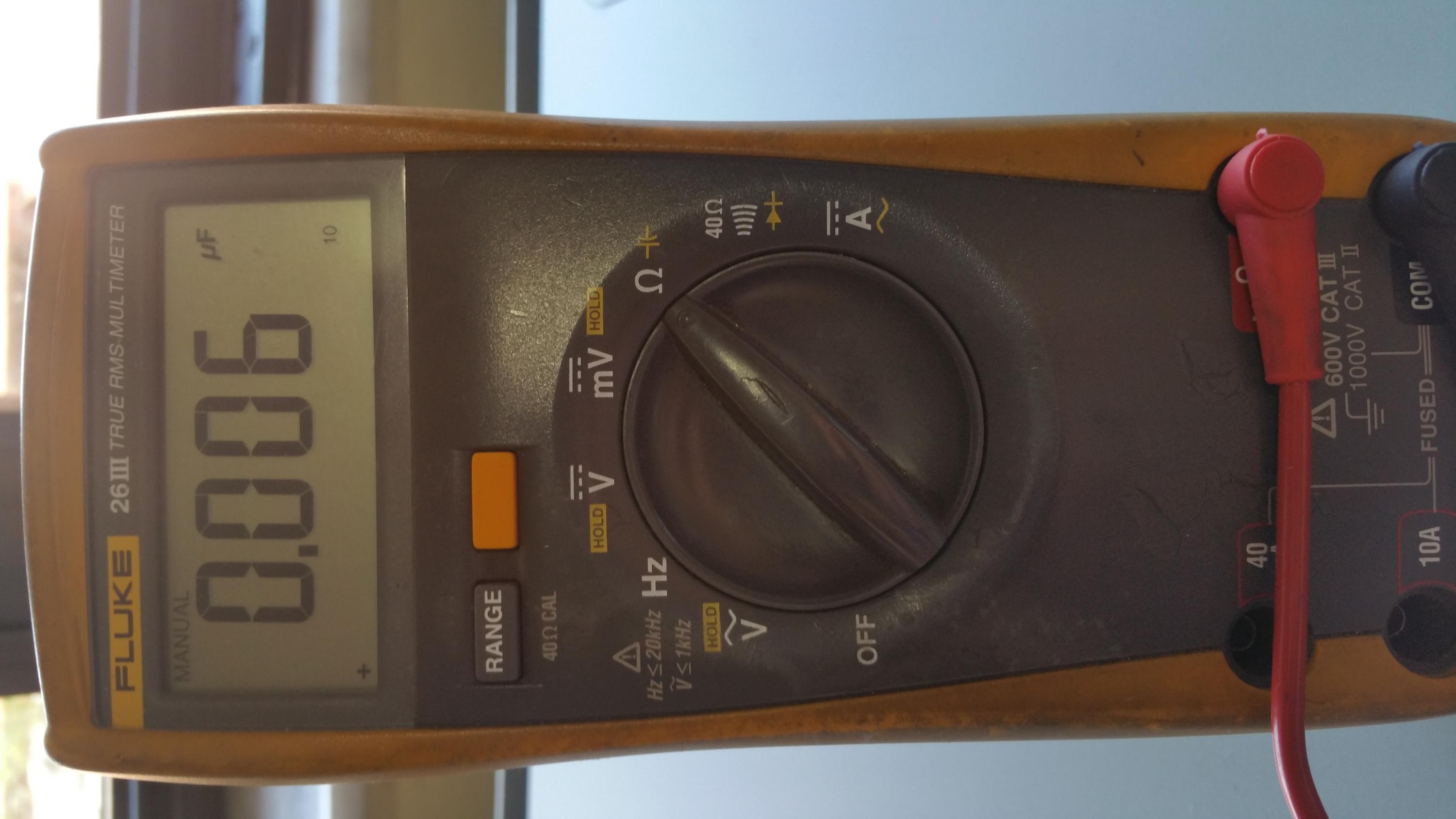

      Cap 2H684K: 9.5nf ?????
      Power Supply model: BN44-00268A
        684K = 0.68uF 10% tolerance
        Did you remove it and measure it off the board?

          I measured outside
            If that reading is correct then it's faulty and you need to replace it. Plenty on Ebay.
              Originally posted by alfredomfr1
              I measured outside
              Well, you found the cause of the problem.
                  Capacitor Replaced: TV working good again
                  Thanks budm and D Barton
