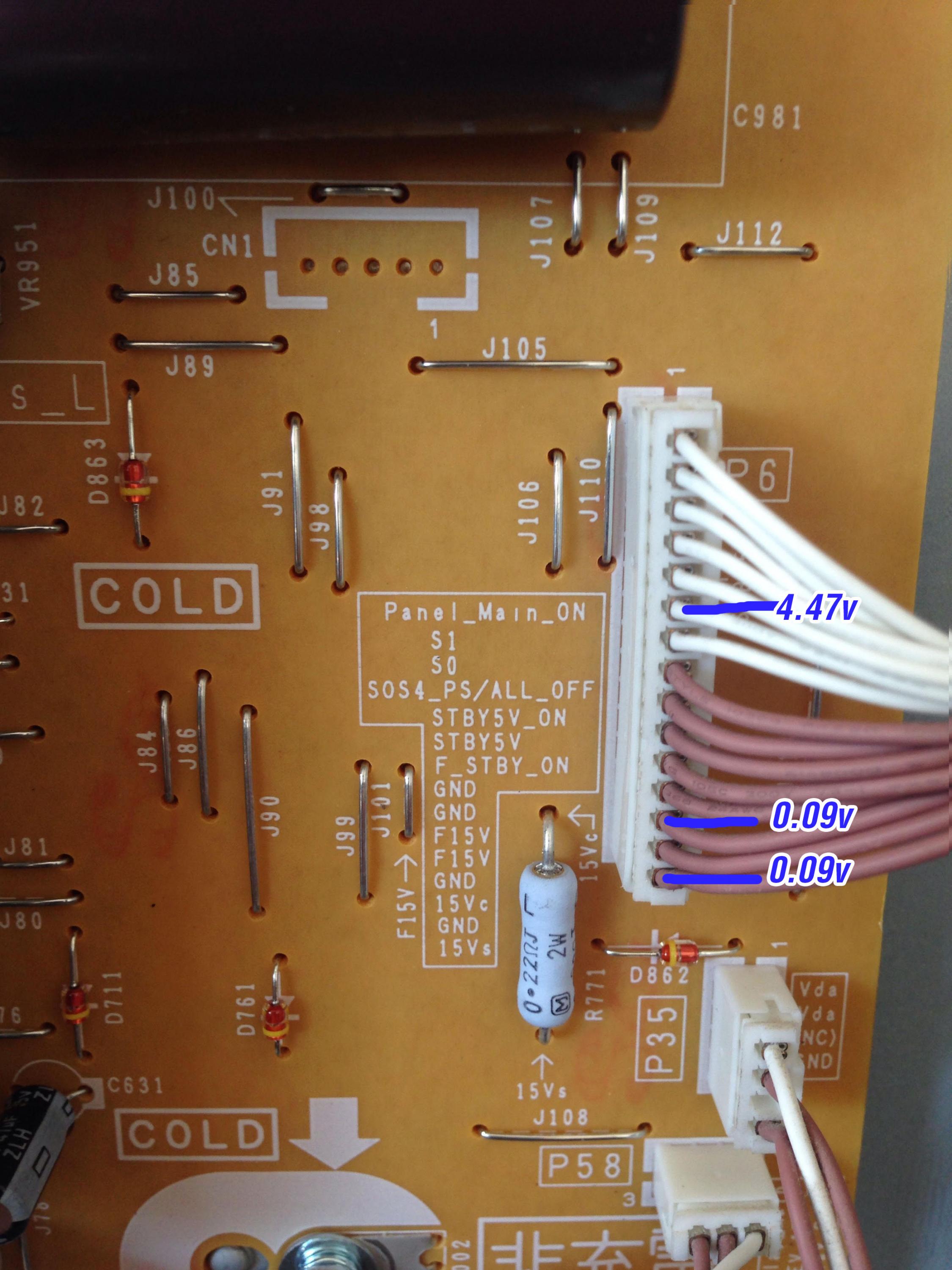

                Re: Power Supply only showing STBY 5V - What could this mean?
                Ok so when I run the power supply by itself i still get 4.47v, but now I'm seeing 0.09V at the bottom pins.
                When I have the all the boards connected and turn it on and quickly test the bottom pins they give me voltage, but slowly descends to 0 voltage.
                  The pin we need to test is pin 5, STBY5V_ON (STBY_SW_ON in the diagram).
                  • doug35
                    • May 2017
                    • 20
                    • New Zealand
                    #29
                    There is no voltage on that pin at all, whether the power supply runs by itself or with all boards connected.
                      #30
                      As explained in my post 22, the Voltage should be present on that pin to turn on the rest of the Standby power supply on the main board, that is my theory based on the diagram. So you have two choices, it is either main or power supply board unless some one else has the same power supply board to verify the Voltage at that pin 5 STBY5V_ON.
                      • doug35
                        • May 2017
                        • 20
                        • New Zealand
                        #31
                        The mainboard must be at fault then. I already replaced the power supply and get the same results.

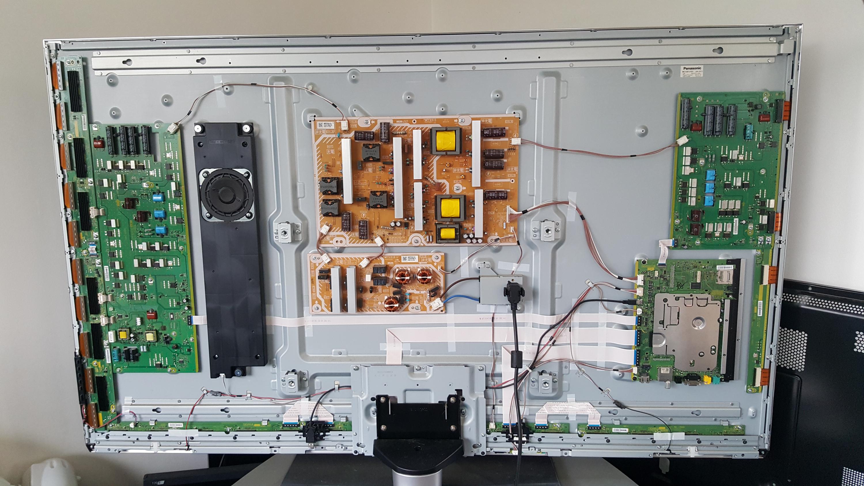

                                BTW, can you please upload the pictures of the whole backside of the TV showing all the boards?
                                • doug35
                                  • May 2017
                                  • 20
                                  • New Zealand
                                  #36
                                  Here you go.
                                    #37
                                    https://www.badcaps.net/forum/attach...0&d=1494552309
                                    The barcode sticker for your main board PCBA as shown in your picture has these numbers:
                                    TXN/A1PAUAVV60, THA3109AR2030015
                                    Your replacement board:
                                    TXN/A1NYUAVV, TNPH0988 (this number printed on the board is the PCB (blank circuit board) P/N.
                                    So it does not look like to be the same PCBA to me.
                                    The blank board can be stuff hundreds ways to create hundred PCBA (Printed circuit board assemblies) for many TV models.
