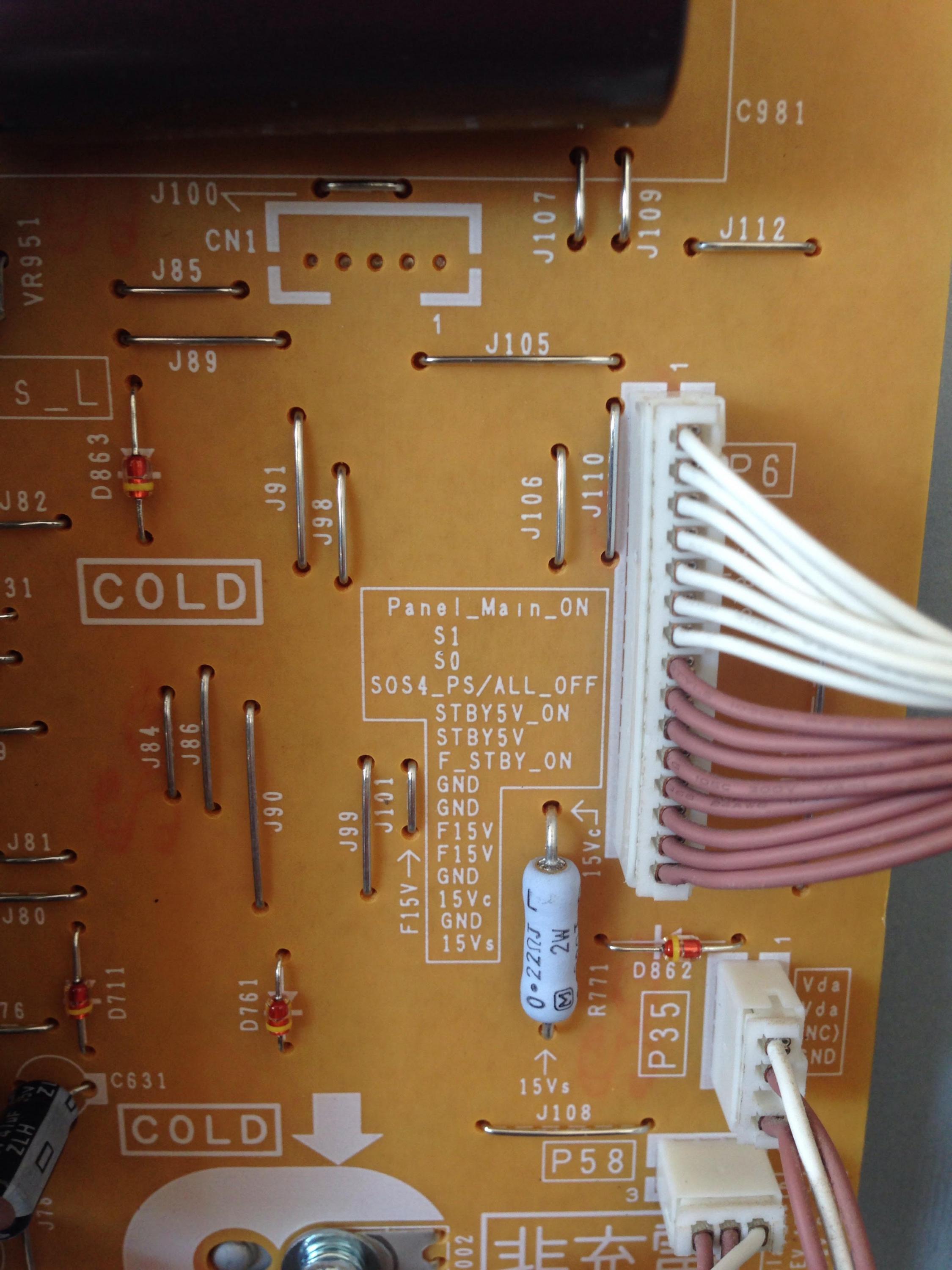

    I'm a newbie and would like to fix my TV myself.
    I get 4.47v from the standby pin. All other pin-outs to the Logic board have 0 voltage.
    Could anyone please help me understand what this may mean?

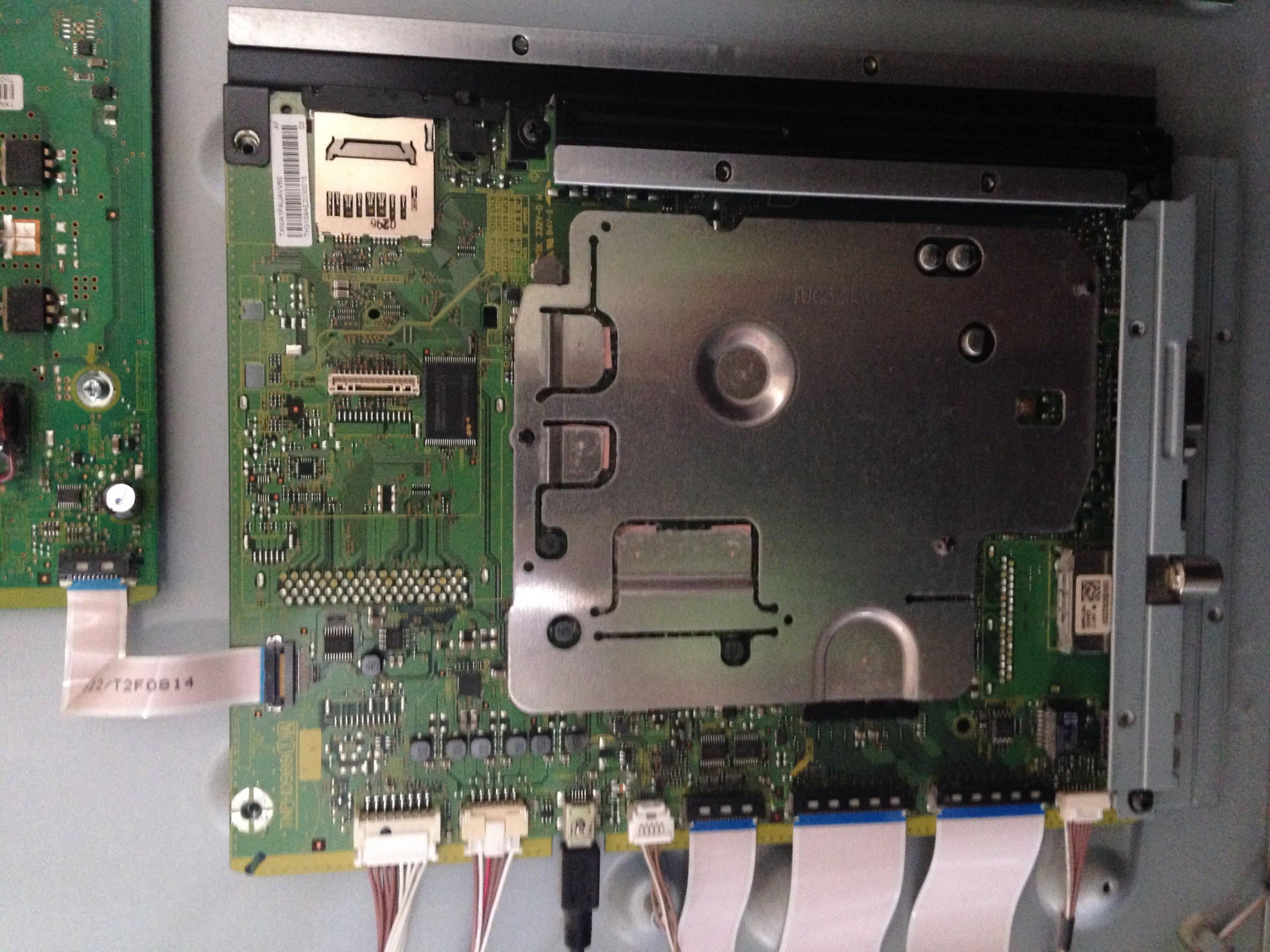

                      Maybe start by uploading some good clear pictures of the boards used in your tv one showing how all the boards are connected up, and then one of each of the boards

                        Re: Power Supply only showing STBY 5V - What could this mean?
                        5v goes into the mainboard to a small ic ( IC5000 if im correct ) which turns on the 5v STB ON rail and 15V rail. 15V goes back into the power supply and turns on the tv.
                        You got a bad mainboard , either because of heat or lightning/power surge.
                        Search for the TNPH0988 1A mainboard and watch out for the suffix sticker , it starts with TXN/....... otherwise you might buy a 50ST50 mainboard. ( Will work ).
                        • Hombre
                          • Jul 2013
                          • 231
                          • Croatia
                          Did you try to disconnect cable that is going prom P board to A board and then check 5V stand by?
                          • Moreno83
                            • Jun 2014
                            • 2008
                            • The Netherlands
                            I don't think it is the sub board. Mains go into sub board --> into power supply --> 5V is coming from the power supply and goes into the mainboard and mainboard turns on the led and 5V STB + 15v rail. 15v goes back into the PS and turns the rest of the set on , i had the same problem with my VT50.
                            Disconnecting the cable from the mainboard won't help because 5V will still be there. Its called EV5V and not STB5V so don't get confused!!
                            Please look in the service manual on page 30 and search for EV5V. This is the only voltage on the power supply when the mains are plugged in and its on P6 of the white connector.
                            3 blinks is the 3.3v error which is the mainboard. ( EV5V goes into IC8712 and turns on 3.3v ).
                            My feeling says its mainboard

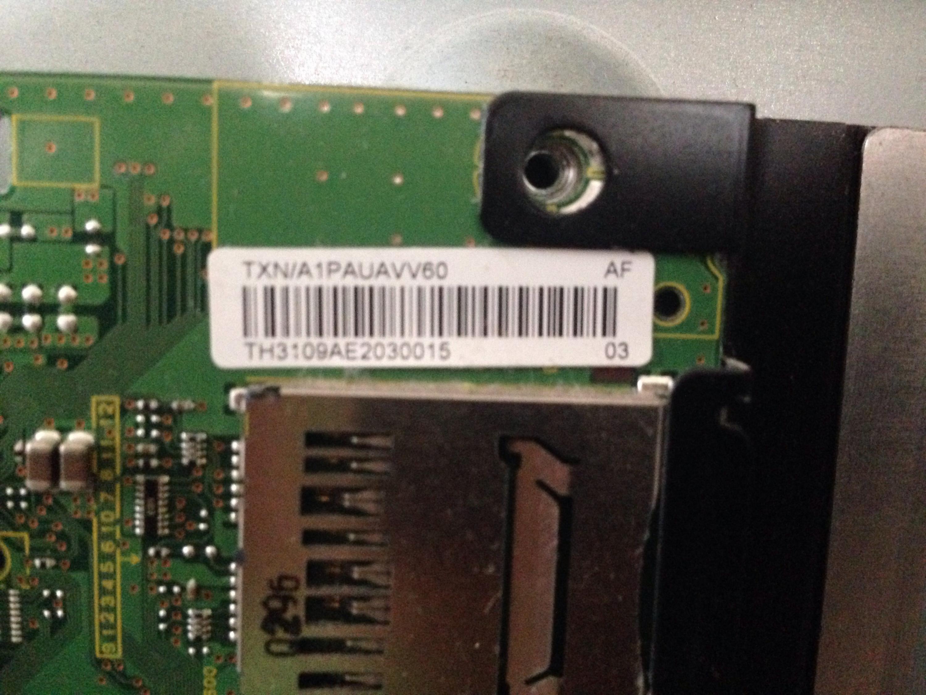

                                  Could you please take a picture of your mainboard? Especially the white sticker , it will say something like TXN/A ....
                                  This because the tuner in the board might be different and your board might not find any cable channels.
                                  So its best to get the exact board!
                                  • doug35
                                    • May 2017
                                    • 20
                                    • New Zealand
                                    Originally posted by moreno83
                                    could you please take a picture of your mainboard? Especially the white sticker , it will say something like txn/a ....
                                    tnph0988 1a
                                    txn/a1pauavv60

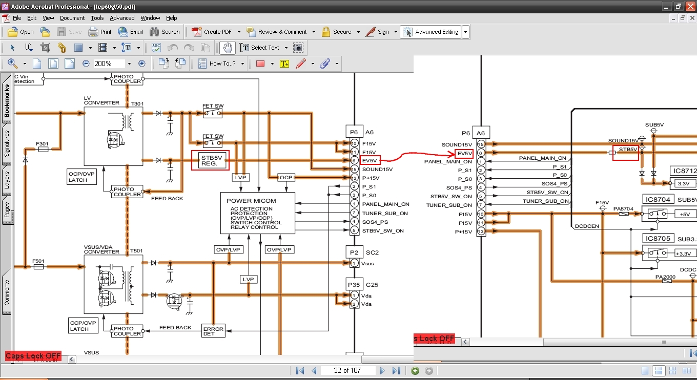

                                      If you look at the diagram STBY5V on pin 6 of the connector P6 is EV5V which goes to connector A6 pin 6 and it is then called STBY5V, so there is nothing to turn on the STBY5V because it IS the 5V standby Voltage which is always present on that pin 6 of P6 which is labeled as STBY5V on the board. Bottom line: STBY5V = EV5V= Always on 5V = It does not have to be turned ON.
                                      F15V, Sound15V and P15V are switched, they also have Low Voltage Protection (LVP) and Over Current Protection (OCP).
                                      Since other command signals on connector P6 are not present from the main board then you have to look at the main board, but you should run the power supply board by itself first to see if the Voltage on connector P6 pin 6 (STBY5V/EV5V) will come up to 5V or not.

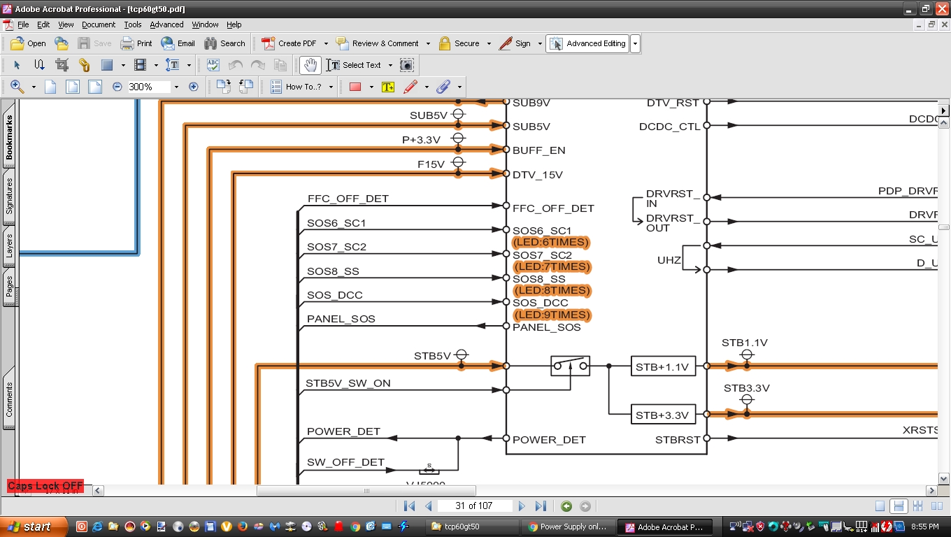

                                        If the POWER MICOM on the power supply board does not sense any problem then it should send out STB5V_SW_ON signal on P6/A6 PIN 5 to turn on the switch in side the IC5000 so the STB5V can feed the STB+1.1V and STB+3.3V regulators to produce those two regulated outputs which the main board will need to run.
                                        So you should find out if you do have STB5V_SW_ON signa or not, I expect it to be >2VDC.
