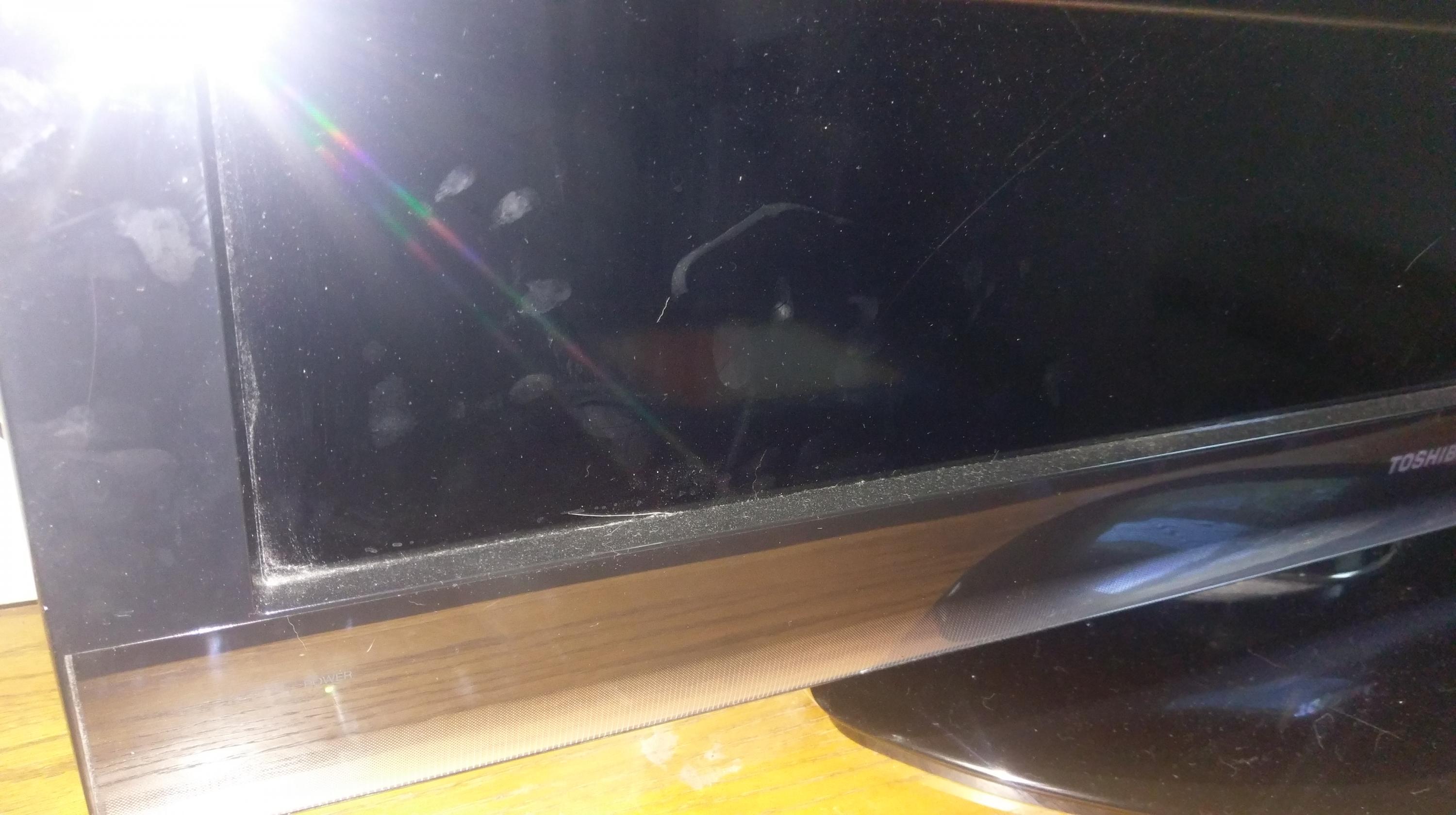

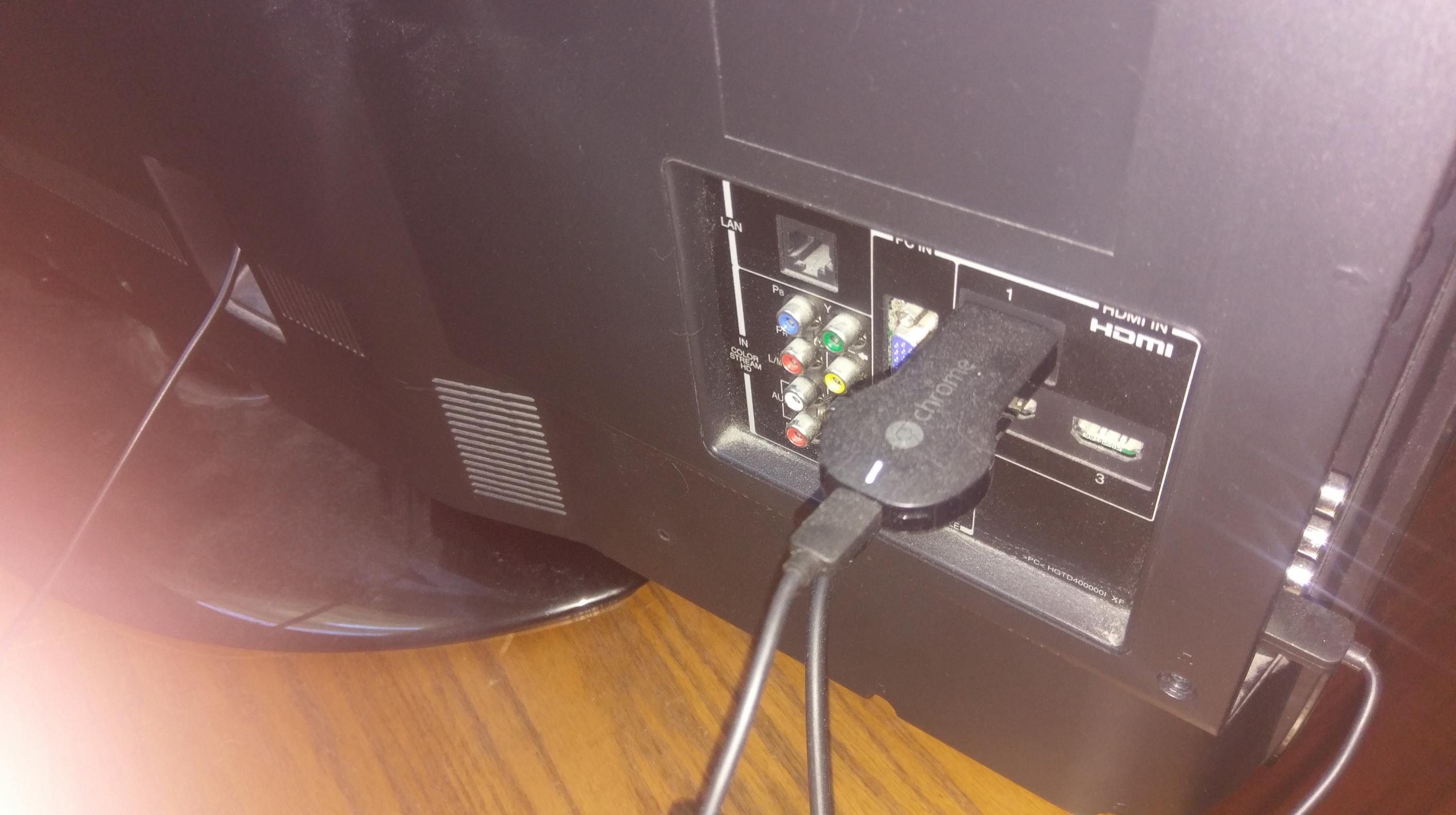

    Toshiba 46g300u3 screen turns off after hours
    Toshiba 46g300u3 screen turns off after about 2.5 hours. The power light stays on and the chrome cast I have remains powered. Sound does not continue also the backlight is off. The TV will turn back on immediately and stay on for another 2.5 hours. When it goes out the screen turns off followed by the sound 3 seconds later.

    Re: Toshiba 46g300u3 screen turns off after hours
    Sounds like something is overheating. When it turns off take the rear panel off and direct cool air on the boards to try and identify what may be overheating.
      My thought was if it was over heating it wouldn't come back until cool. It comes right back on no issues
        Do you still have all voltages when it turns off?
          Is there some kind of automatic power down setting in menu?
            maybe try a factory reset page 34 in the manual
              It's not automatically turning off. That setting is off. I'm not at home I'll get voltages then.
