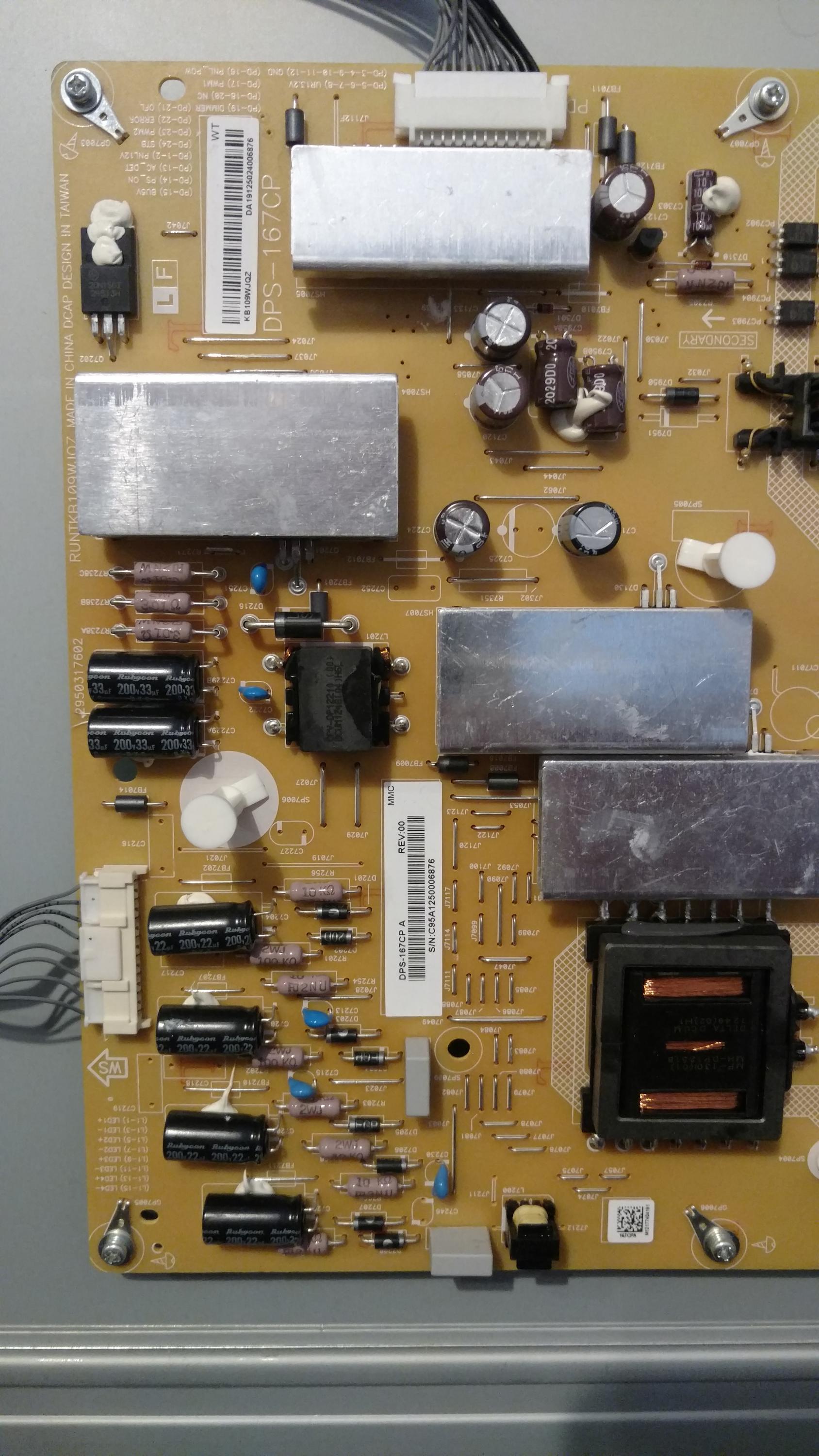

    I have been reading through a thread about another sharp that lead me to test quite a few different voltage outputs. I am reading 7.34 Volts from PO-1 and PO-2 (PNL12V). I just want to make sure I'm not crazy and that a bad power supply is probably what I'm dealing with.
    I'm asking because I was a little surprised how steady at 7.34v DC the reading was for both PO-1 and PO-2. If anyone knows the specific diode, capacitor, etc, that could be causing this, I would much prefer to replace those rather than purchase a new power supply.
    Also, I am having a difficult time finding a schematic for the Power Supply. Does anyone have access to that? (DPS-167CP, runtkb109wjqz)
    Thanks!
    -Benjamin

    Re: Sharp Aquos LC-60LE650U No Backlight 2 long 5 short
    disconnect the cables going from the tcon to the panel and see what the reading is there after.
          Your voltage for t-con may be routed through your mainboard. Are you getting 12v off your powerboard?

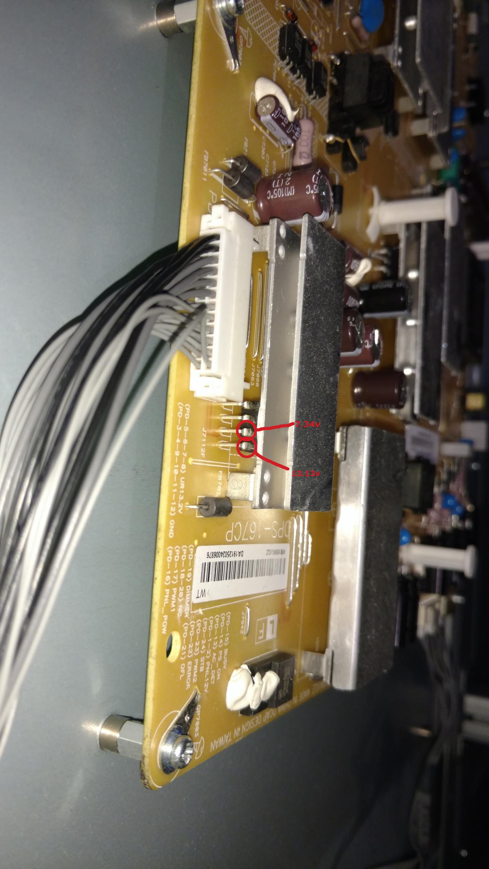

                      Originally posted by budwich
                      Of course, you are looking for the "7.3v" in your "meter tracing" as opposed to 12v which likely won't be anywhere... right?
                      further, it would appear that q7120 gets a "feed" from the UR13.2 "source" which you said is there.
                      Ok, I have attached two pictures that show what I believe to be the faulty voltage regulator. Is that what you were referring to with the q7120?
                      Is this an equivalent? Mouser Voltage Regulator
                      Thanks!
                      -Benjamin
                        Need to read part number. Mouser ic pin1 is input, pin 2 should be 12vdc
                          Thanks!
                          -Benjamin
                          you actually need to read / measure all of the pins.... plus as suggested find out what the device actually is.
                            Pin 3 seems to be ground (-00.2V). It breaks out to the screw on the corner of the board and down the center of the board to other grounds. Pin 4 (2.709V) is not so easy to trace. It seems to be heading to PD-16 (PNL-POW).
                              https://www.badcaps.net/forum/showth...602#post592602
                              KIA378R12PI ?
                                great hint!!!!! ^^^
                                You might want to buy a couple of them... as you potentially might have a panel problem that is taking them out. The panel maybe salvageable though it might take a bit of "testing" which may or may not blow that device.
                                  Is this your part number for Q7120 (KIA378R12PI)? If it is pin 2 should have 12v. Does it?
                                    Originally posted by budm
                                    Thank you for the link! I searched google so much for different part numbers, I didn't even think to search the forums. My bad.
                                    great hint!!!!! ^^^
                                    Indeed. I usually order parts in 5s and 10s.
                                    Pin 2 definitely is only supplying 7.34V, which it should be supplying 12V according to the board. I'll be pulling the heat sink and Q7120 tomorrow. I need to get a new wick. Once that is done, I should be able to verify.
                                    Thank you, all!
