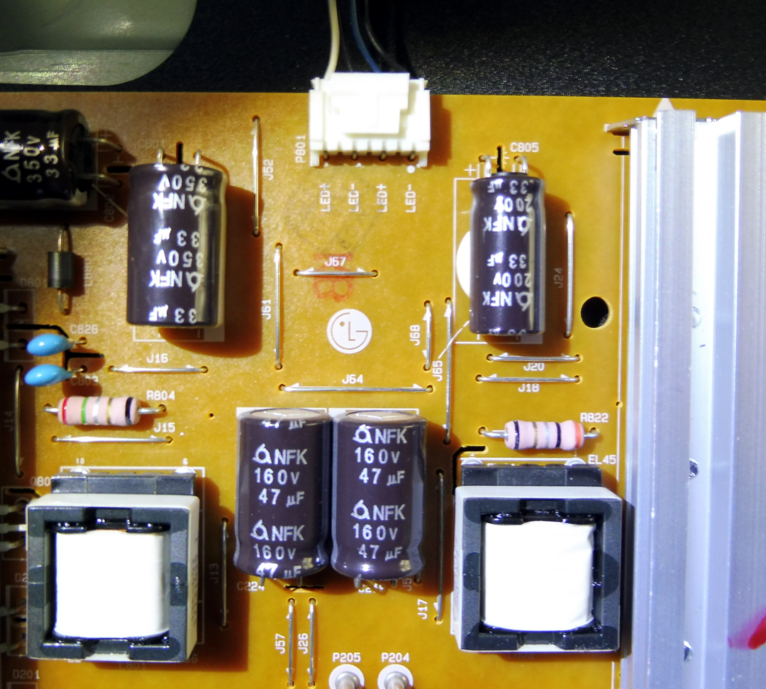

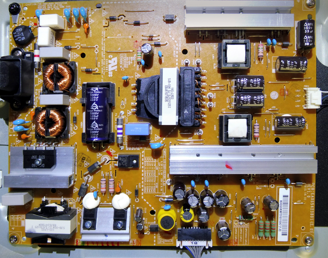

        So you have two LED driver circuits, and two LED strips.
        what DCV do you have for each set of the LED at the L+, L- of each set of the outputs with LED connector in place and without LED connector in place?

          Re: LG 55LB6100 Backlights flashing 4 second interval
          Thanks for the reply, BudM, I was hoping for you, I have seen some great posts from you.
          With the led strip connector plugged in and power on, between led- and led+ for strip 1, a varying voltage from 1.5 v to 22 v seems like open circuit, almost random. On strip 2 between + and - about 155v and 135v. It seems to charge up to 155v, the backlights flash very quickly and then it discharges to the 135 v or so and then charges up again.
          With led strips disconnected, Led strip 1 is varying from 50 to 60 v while strip 2 is varying from 90 to 110 v.
          Incidentally, with power connected and set not turned on there is about 90 v on the capacitors near the LED connector but the led + and - outputs are near 0
          thanks again, jim
              Voltages with respect to chassis ground,
              Power plugged in, power switch off, led strips connected
              Led strip 1, led - 1.4 v led + 90.0 v
              Led strip 2, led - 150 mv led + 90.2 v
              Power plugged in, power switch on, led strips connected
              Led strip 1, led - 1 to 12 v led + 111 to 115 v
              Led strip 2, led - 1 to 60 v led + 245 to 260 v
              Power plugged in, power switch on, led strips disconnected
              Led strip 1, led - 360 mv led +163 to 173 v
              Led strip 2, led - 380 mv led + 225 to 195 v slow drop as if it's discharging through
              voltmeter and then charging back to 225 v
                So if you only have LED strip 2 connected, do you see the backlights flash on for seconds?
                All 3 sets of the readings do not have have logical relationship at all.
                    You have two individual LED driver circuits. The LED connector has Black (Cathode, L-) and Blue (Anode, L+) wires for one set of LED strip, Black (Cathode, L-) and White (Anode, L+) wires for another set of strip.
                    So which set of wires that are hook up and give the backlights for seconds?
