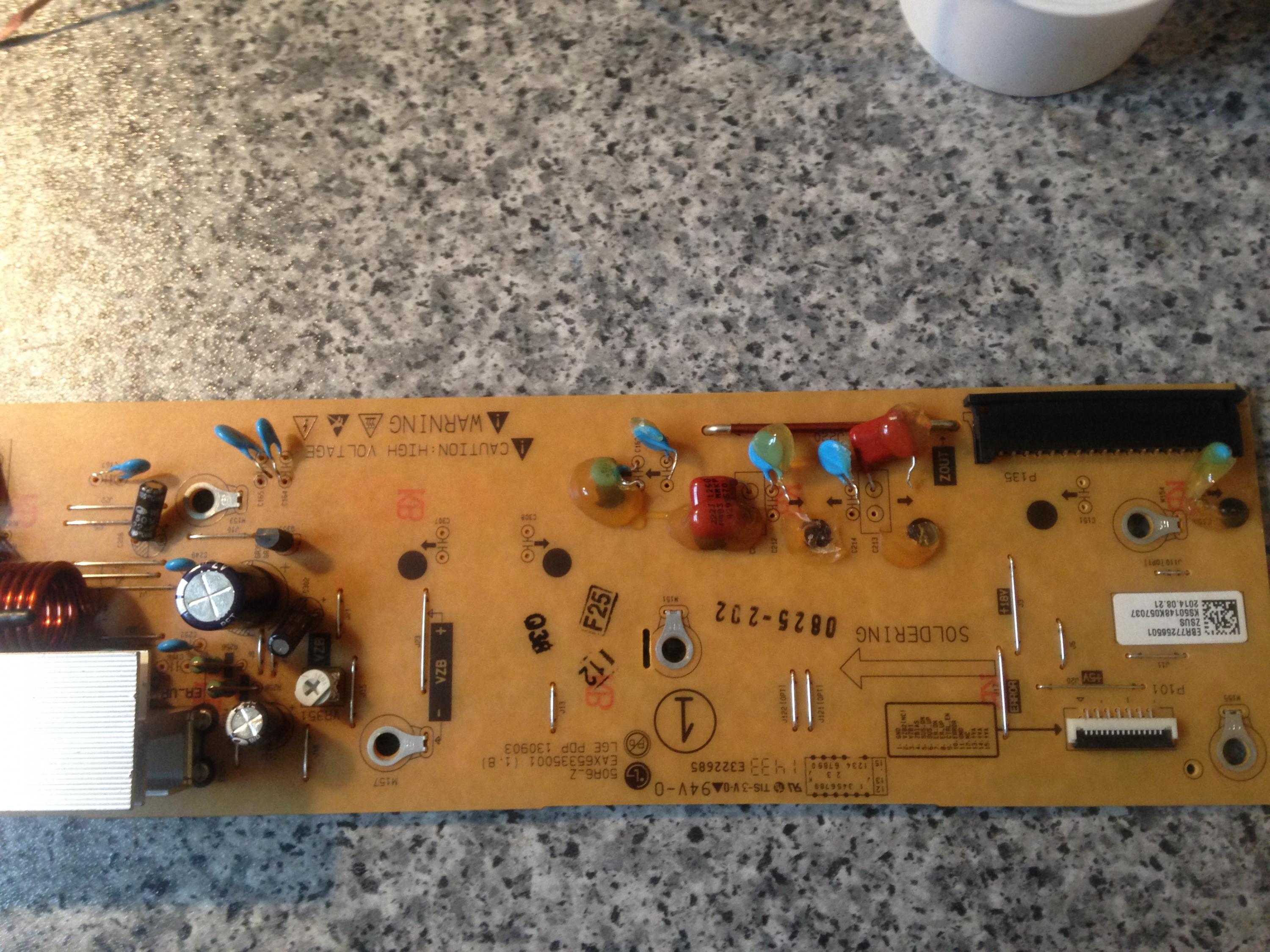

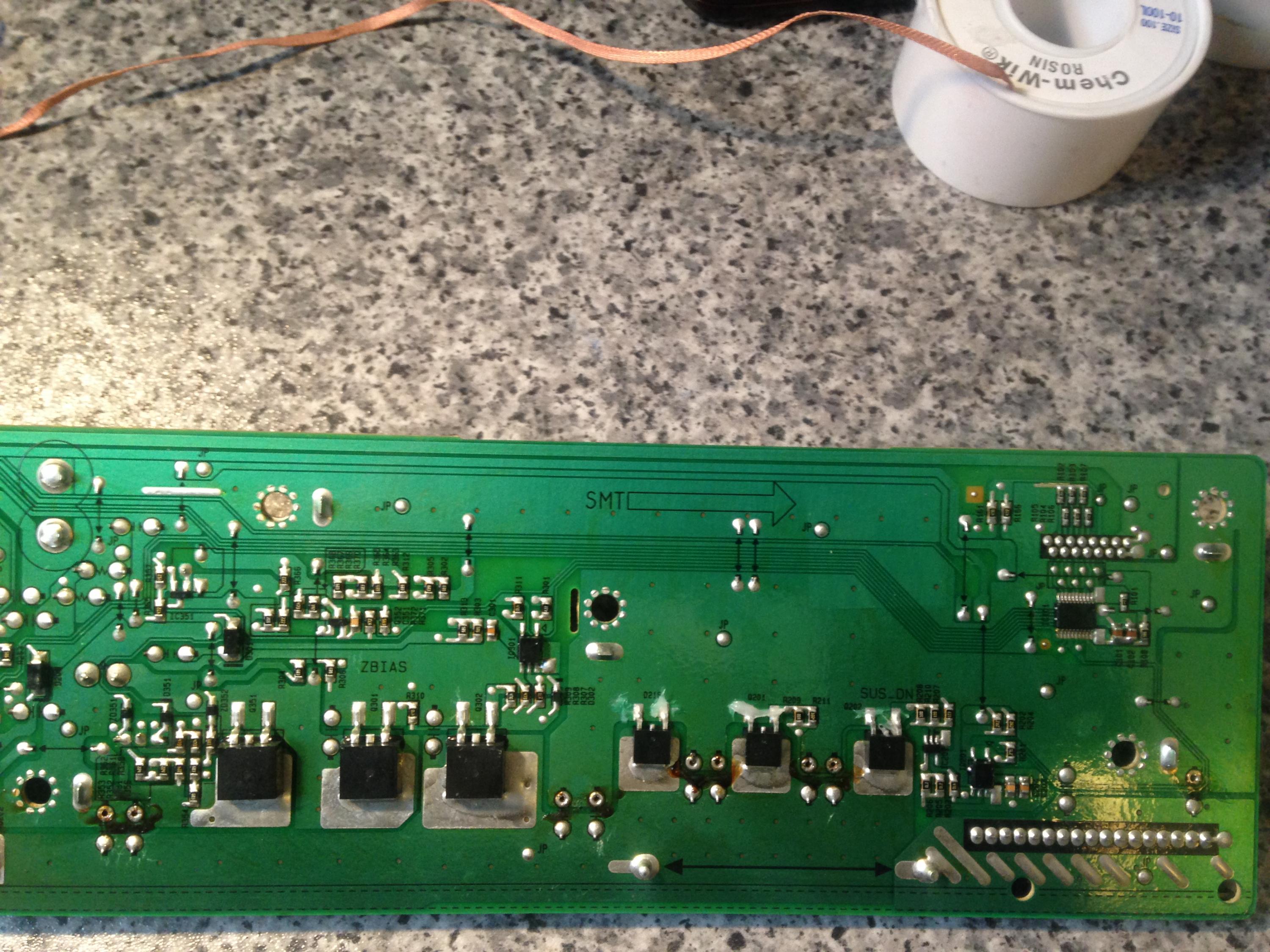

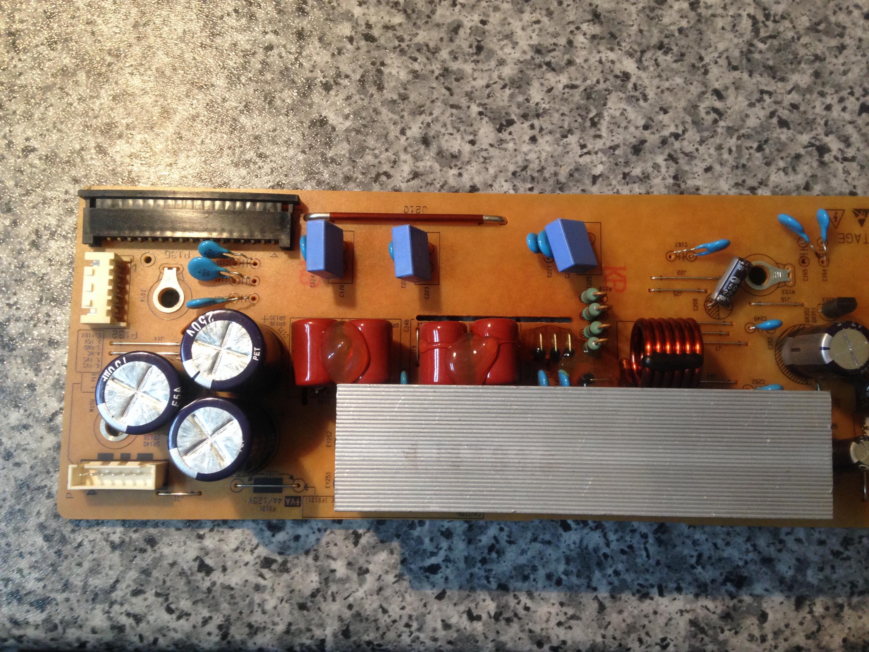

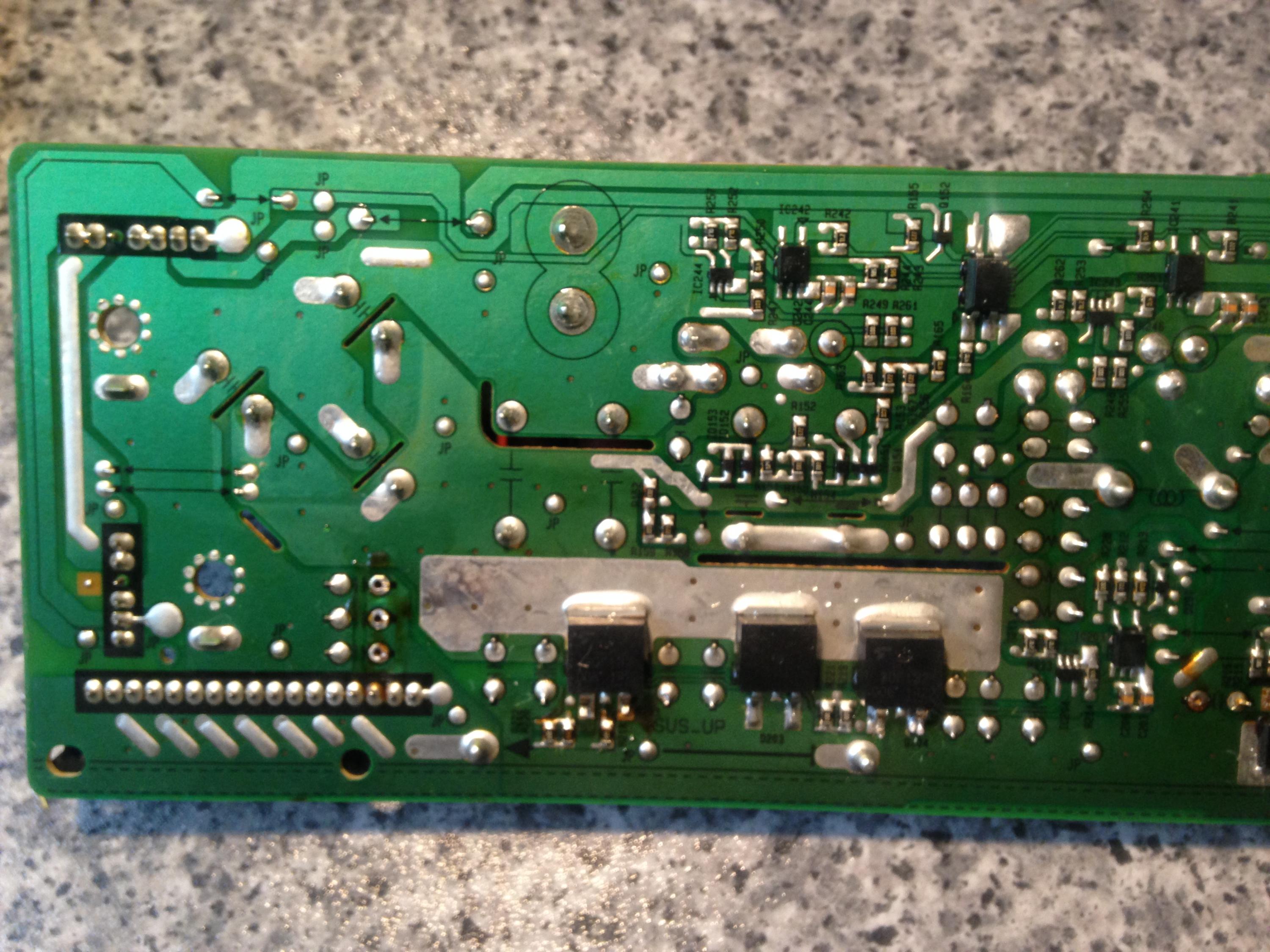

                    Well testing the ZSUS now, every single cap tests short! They're all on the same line so need to figure out if its a cap or something else on the line!
                    Any good ideas on how to find it without unsoldering everything? No visable damage, what about connecting a low voltage to see what heats up, I've seem alot of people do this on phones!
                    Cheers.

                      Re: LG 50pb690V Doesn't Turn on!
                      pictures will certainly help us one good one from top and one good one of the bottom of the zsus so we can see where the traces go to etc.
                      A lot of other members maynot/wont help/advise when theres no pictures etc
                          I've found the shorts on 4 transistors!
                          2 x GT30F132
                          2 x GT30F133
                          They are on ebay but it would be good if I could get equivalents off RS Electronics. I couldn't find the datasheets.
                          If anyone knows equivalents of where to find the datasheets, I tried google!
                          Cheers.
