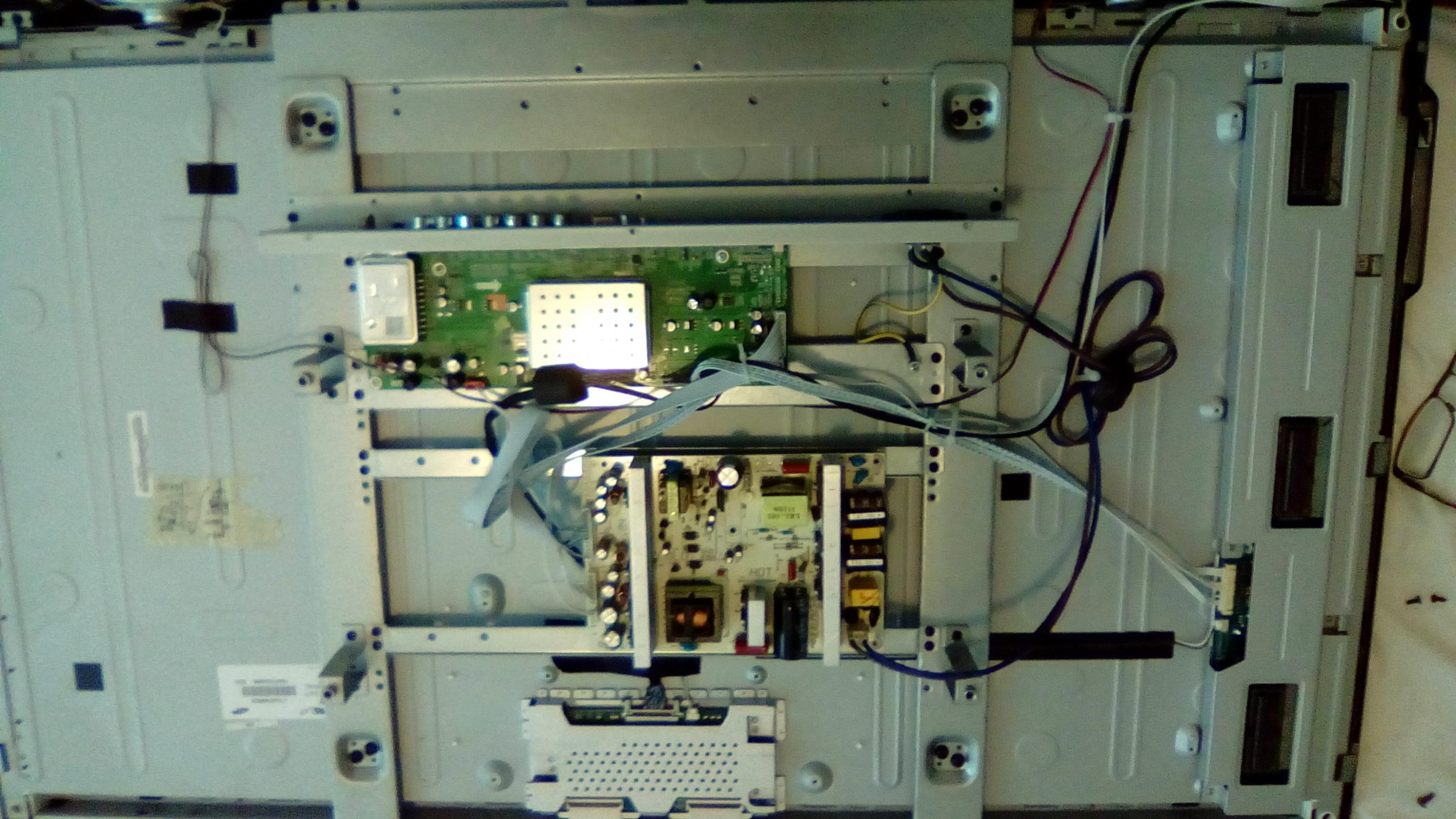

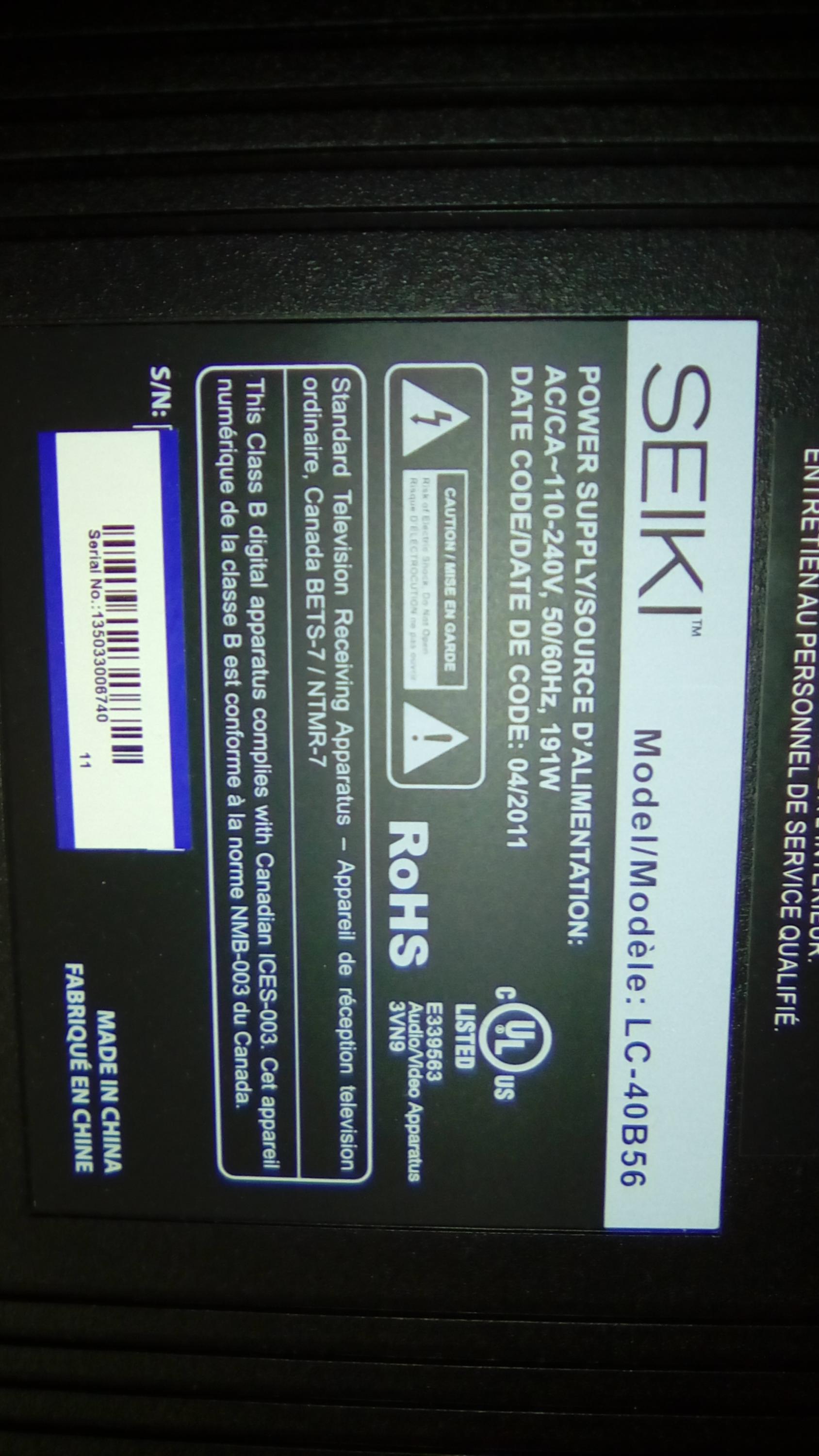

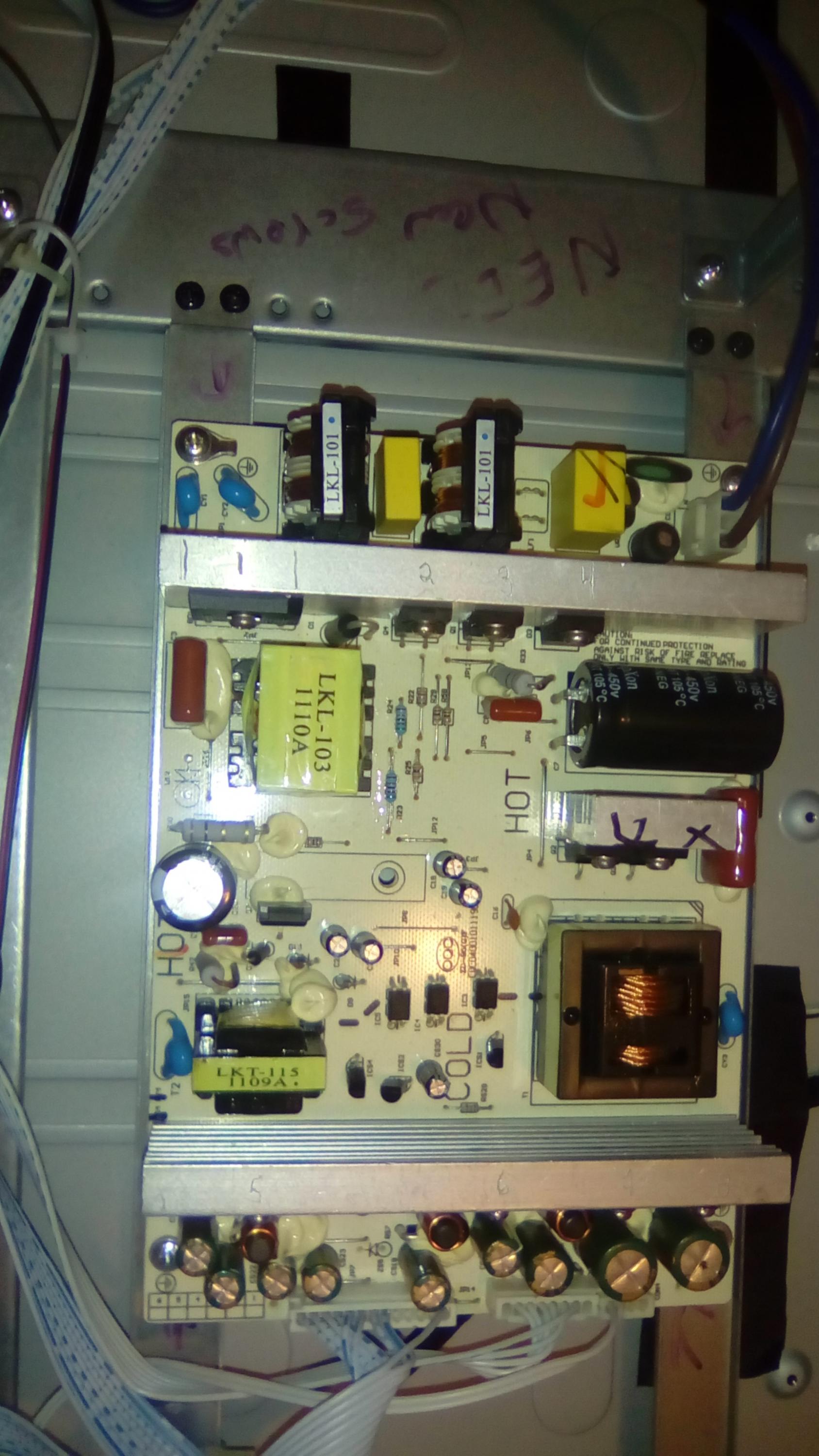

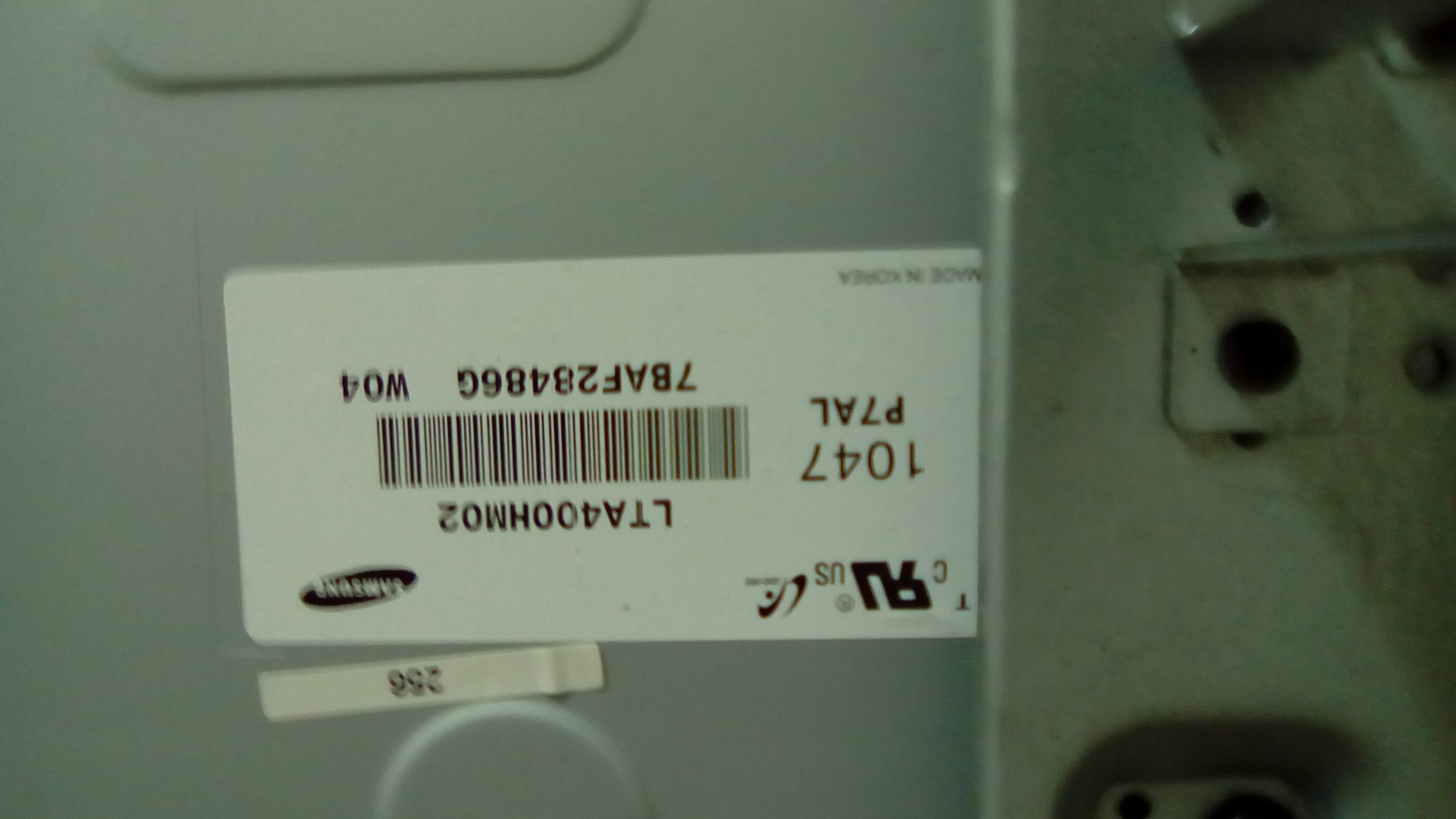

      here are some pictures of the innards of the Lcd Tv
      1) model number
      2)inside showing the various components
      3) showing where the set was manufactured I believe in Korea (Samsung)
      4) showing the power unit

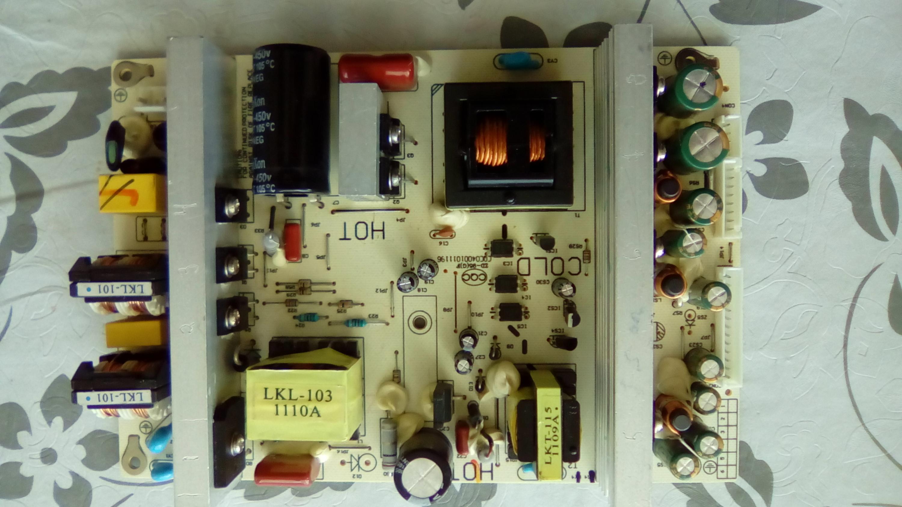

        Re: Seiki LC40B56 totally dead
        the power supply has 2 numbers ZD 95(G)F, CQCO4001011196 stamped on the item my question is what should I look at first and what is the consensus regarding these type of sets (Vestel?) brands and known problems
        thanks in advance John

          Will need some voltage measurements from powerboard to mainboard connector

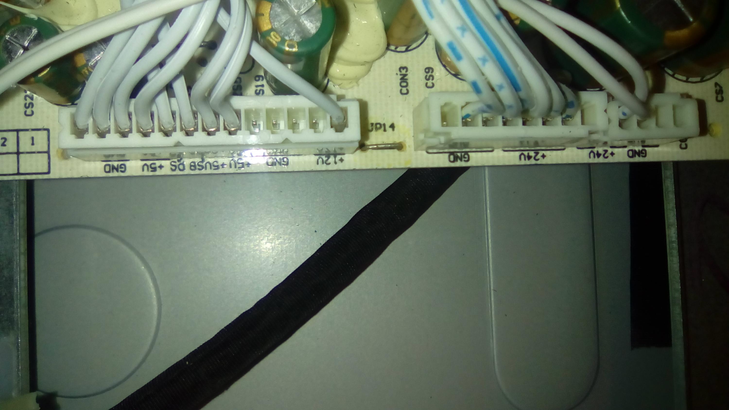

                  Sorry I was away due to family matters, I did take some numbers for electricity for the picture of
                  5v SB = 5v dc
                  PS = 5v dc
                  for the transistors on the hot bar ie (see picture number A) see the numbers on the heat sink ie 1,2,3,4 voltage values were between 69v to 71v. the large capacitor laying on the side was giving readings between 270 to OL and back again. The transistors on the cold side ( several not in view ) are 0 vts dc. I am getting 120vts ac coming it ie the blue and brown leads in the top corner
                  viz here for the items ie 5vSB and the PS
                  Any input would be helpful I would consider taking off all the transistors and capacitors if necessary to gain proper readings
                        ok I did make a mistake there is no standby led light at all
                        USB pin reads 5 v dc
                        PS pin reads 5.64 v dc
                        the large cap on the hot side reading the voltage it is jumping from the high 200 vts ac ie last reading was 285 vt ac to OL

                              sorry again But here is what i did put the red lead from multimeter on ground used the black lead on the different pins as in picture on bottom i dont know if this is correct but here it
                              5v pin = -5vts dc
                              next 5vt pin =-5vts dc
                              usb pin = -5vts dc
                              ps =-5vts dc
                              last 5vt pin =5vts dc
                              still no standby light though

                                Ok your readings are confusing. Here's what we need. Voltages from connector that goes from power supply board to main board. Will need pin#- PIN DESCRIPTION -Pin voltage in standby-Pin voltage when pushing power button and picture of connector on power supply board.
                                Format:
                                Pin# - Pin Description - Pin Voltage standby - Pin voltage power on
                                1 - XXXXXXX - XXv - XXXv
                                2 - XXXXXXX - XXXv - XXXv
                                3 - XXXXXXX - XXXv - XXXv
                                4 - etc.
                                Black probe goes to ground for above tests. Main cap is measured in dcv across terminals of cap
