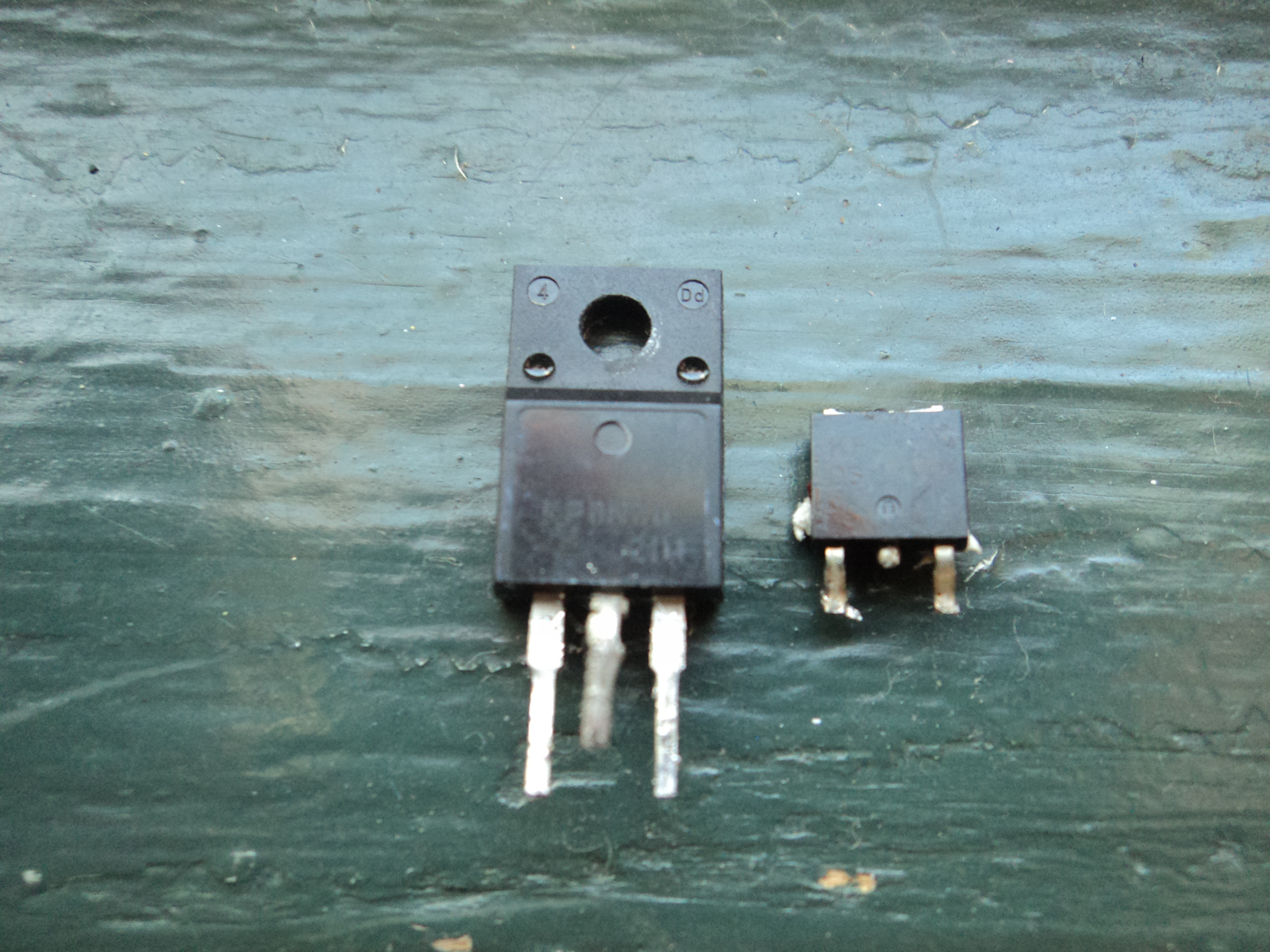

                Re: Vizio E321VL dead blown fuse
                Can you post photo's of the 2 devices.
                • ivtec
                  • Dec 2008
                  • 1967
                  Thanks dick_barton;here are the 2 devices
                  Is this same as KF5250?
                  https://www.utsource.net/Order/Cart?type=101
                  Also i found this page which has regulator,is any of these KNON60?
                  https://www.utsource.net/search.aspx...=KNON60&page=1

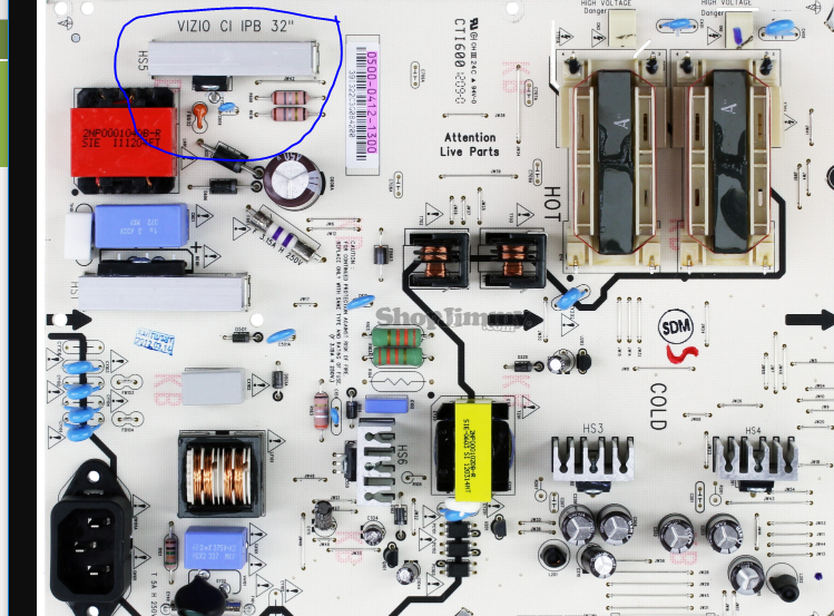

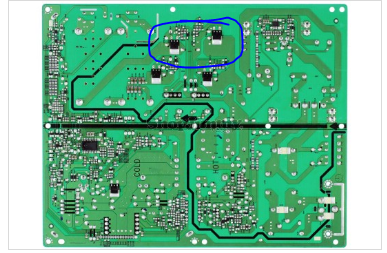

                    "regulator KNON60"
                    Those two devices are MOSFETs.
                    So both of them tested shorted?
                    • ivtec
                      • Dec 2008
                      • 1967
                      #30
                      Originally posted by budm
                      "regulator KNON60"
                      Thanks Budm ;You say KN0N60 is a mosfet! if so it's not short it's Open,i can't find it with that part #.
                      Is any of these good to replace KN0N60- https://www.utsource.net/search.aspx...0KN0N60&page=1
                      surfmount Mosfet KF5250 it's short

                        #31
                        Unfortunately I cannot identify the devices from the part numbers given. Perhaps someone can offer further advice.
                        • vinceroger69
                          • Mar 2012
                          • 6714
                          • uk
                          #32
                          I have been trying too identify the devices too from the part numbers given but cant find any info on them do shopjimmy etc do repair kits with these parts in as maybe your only option.
                            #33
                            MOSFET will show open circuit between Gate and Source, Gate and Drain.
                            Between the Drain and Source it will show the body diode.
                            That PFC MOSFET by that red PFC inductor will usually fail as shorted circuit and will cause the main AC fuse to blow.
                              #34
                              BTW, which fuse that was blown the F601 3.15A fuse for Boosted Voltage that feeds the Inverter section where the 4 SMD MOSFETS are?
                              Or the main AC fuse that blown.
                              You can lift one leg of the F601 to isolate the problem.
