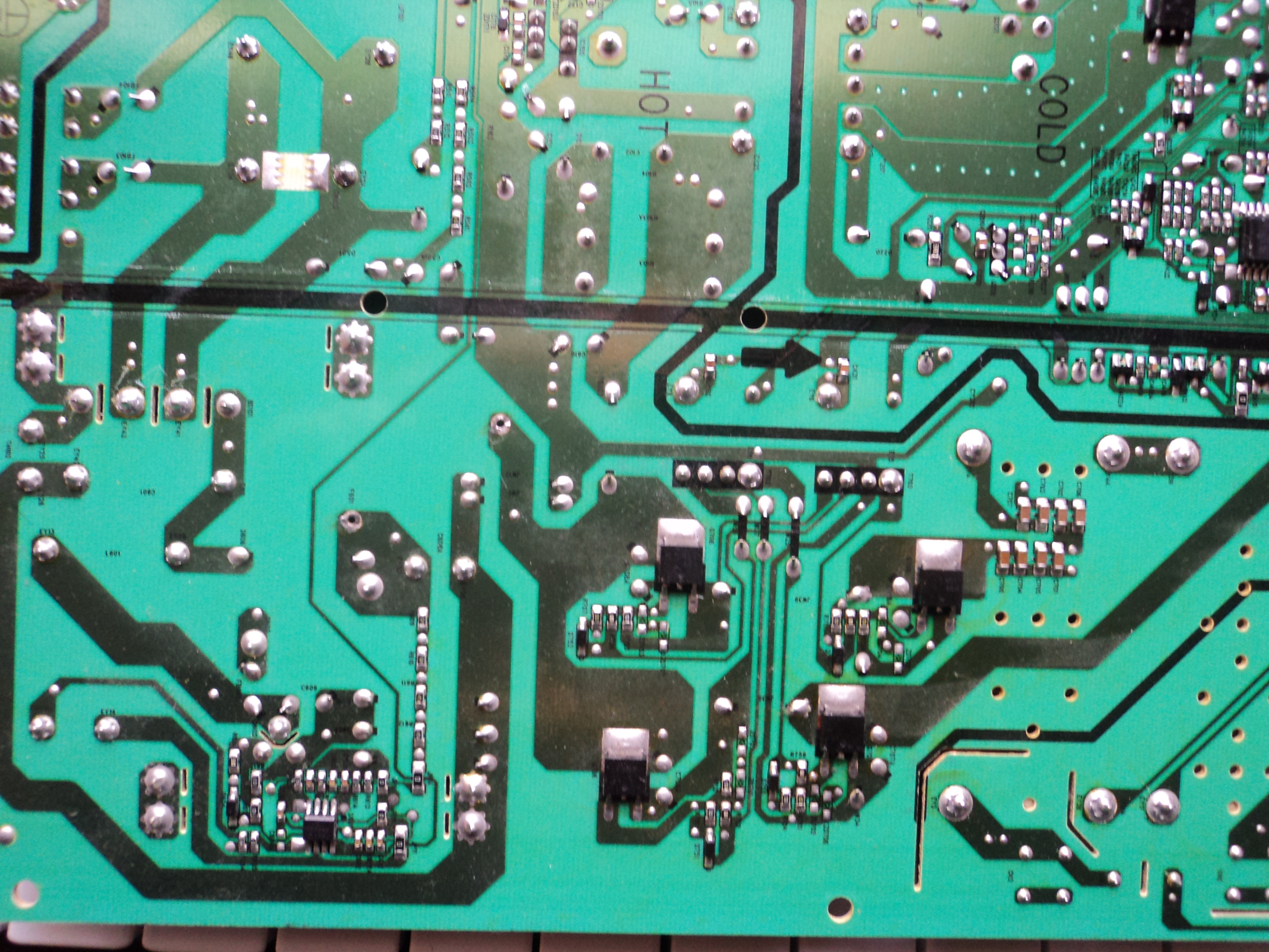

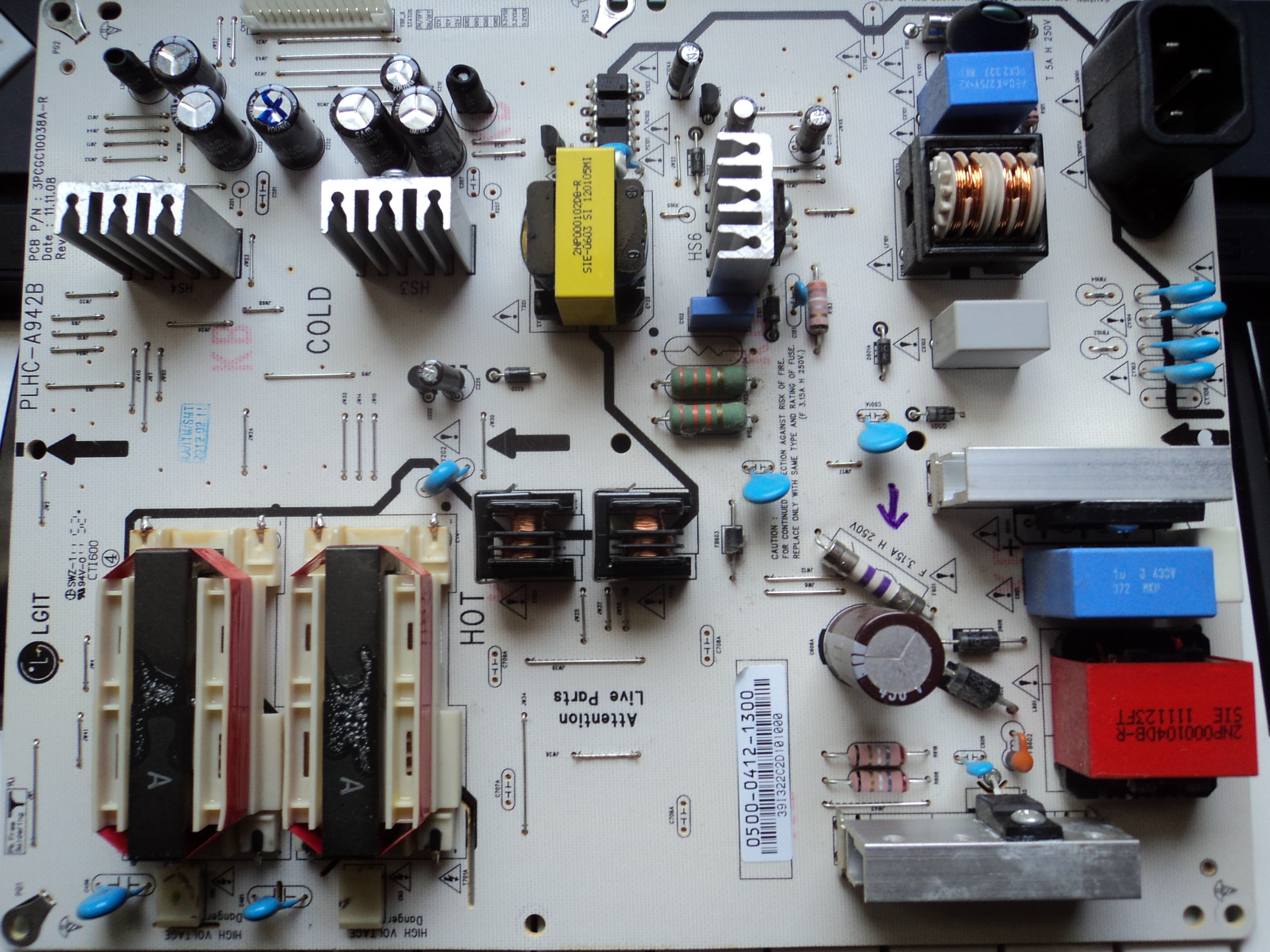

    Hi guys;i found this Vizio E321VL and it's dead no Vizio logo,opened it up and found 3.5 amp 250 v fuse blown,before i replace it, is there anything else that might gone bad with the fuse that i should look over?thanks ,

            Thanks guys:i've checked some components and seem to be ok, but there are 4 Mosfets KF5N50, the 2 i circled in the pic check short,
              Hi guys any suggestion why these 2 mosfets test short in circuit??

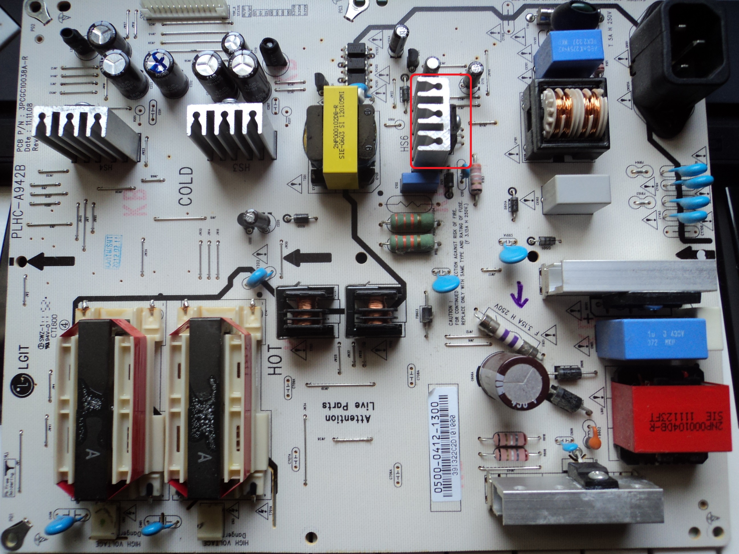

                Re: Vizio E321VL dead blown fuse
                Without a schematic it not really possible to say. However you could use your meter and check all the components the copper tracks from the blown Mosfets lead to and test those devices.
                What's the number on the part highlighted
                    Thanks dick_barton, that's a STR W6053N IC 150

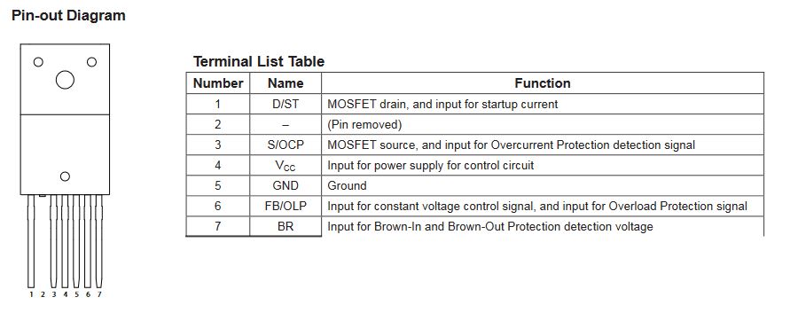

                      With the set powered off and plug removed from the mains set your meter to ohms and measure between:-
                      pins 1 and 3
                      Pins 1 and 5
                      Pins 3 and 5
                      for low resistance or short circuit.
                        pins 1 and 3
                        Pins 1 and 5
                        Pins 3 and 5
                        Thanks dick_barton;appreciate your time;
                        with power supply board out of the tv
                        pins 1 and 3=10.6 ohms
                        Pins 1 and 5=10.2 ohms
                        Pins 3 and 5=0.6 ohms
                          You need to carefully unsolder it. The readings indicate the internal mosfet (or maybe some component in parallel with it) is shorted. Once removed you can repeat the test and if identical you need to order a replacement.

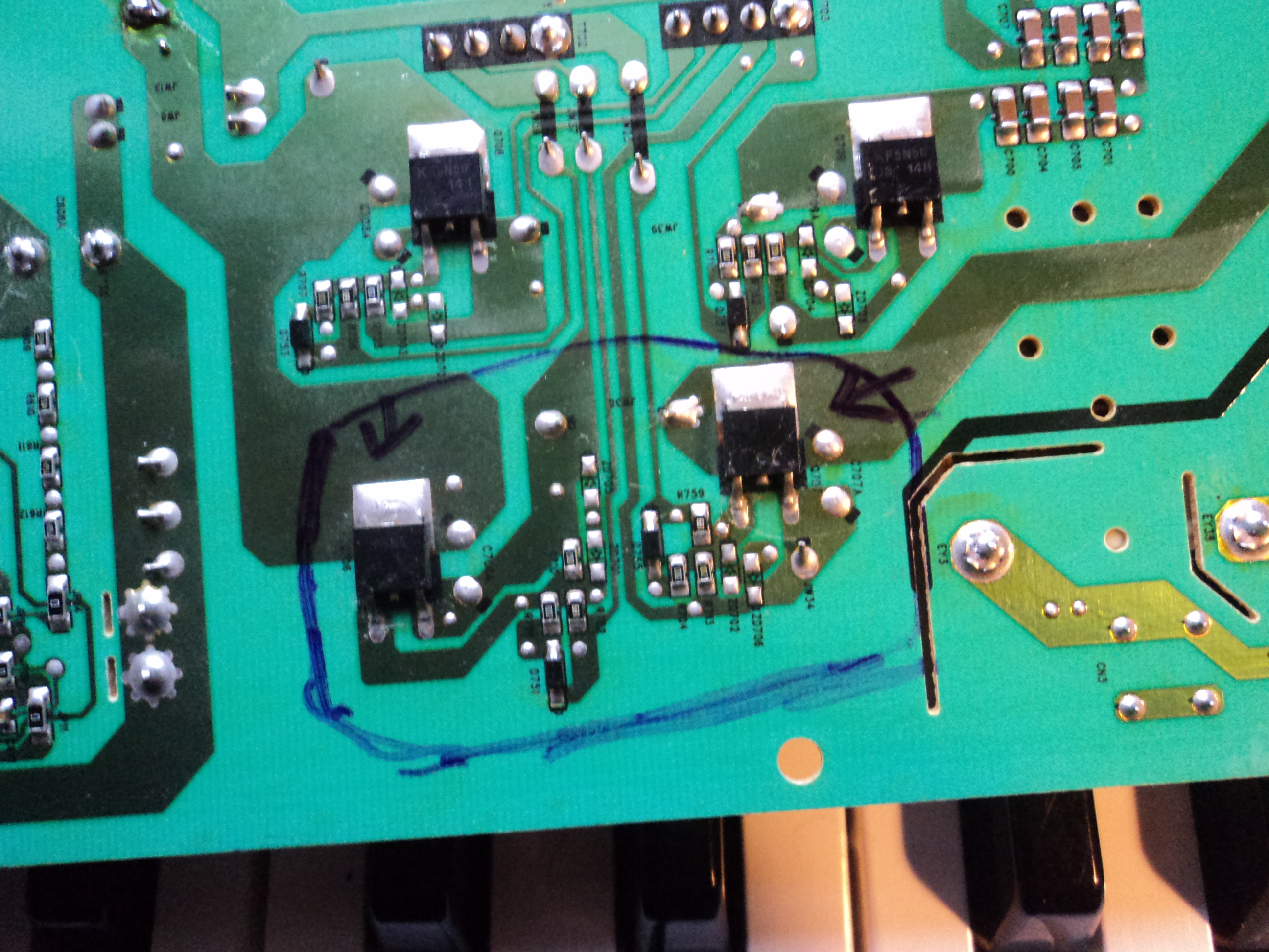

                            Thanks i'll do that,i also just removed these 2 mosfets and they both are short out of the board
                            https://www.badcaps.net/forum/attach...1&d=1587353358
                                there will also likely be bad gate drive resistors to hunt down .

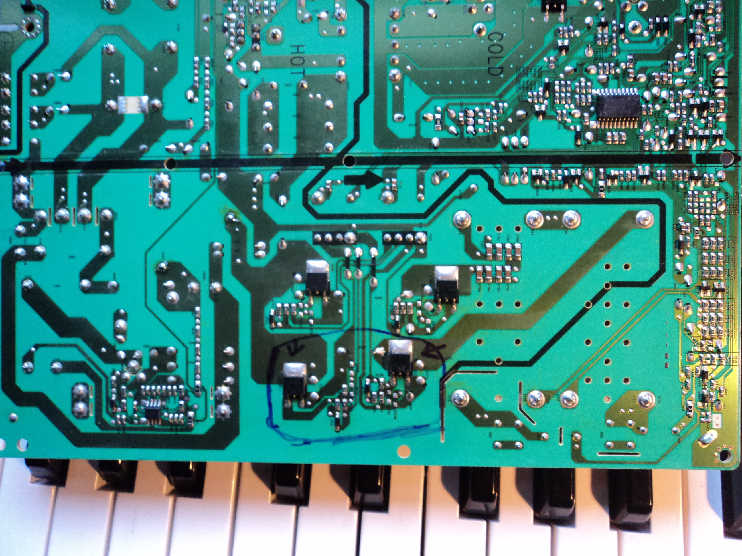

                                  +1
                                  Yes, you should check all the components around the two mosfets that blew. Luckily enough it looks like the circuits for the other pair of mosfets are identical so you should be able to compare the readings when checking the components with your meter.
                                    So the STR SMPS IC has Drain and GND resistance of 10 Ohms.\
                                    Then you also have two shorted MOSFETs out of 4, those 4 MOSFETs are for the Inverter transformer drive circuits.
                                    How about the PFC MOSFET mounted on the heatsink next to the red PFC inductor?
                                    To have that many failures are really bad, I just hope that I can trust your DATA you are providing.
                                      +1
                                      The other 2 mosfets are good in circuit.
                                      i just took out of the circuit STR W6053N and measured with ohms.
                                      with positive prong on 1 and negative on 3= OL
                                      + ----------------------1 and negative on 5=OL
                                      + ----------------------3 and negative on 5=0.673 M
                                      with Negative prong on 1 and positive on 3=336 Kl
                                      - ---------------------- 1 + 5=0.71M
                                      - ---------------------- 3 + 5=0.339KL
                                        Thanks Budm; i just took out PFC MOSFET mounted on the heatsink next to the red PFC induct-or?and it's also bad, Q602 =KN060
