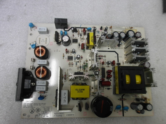

                      Re: Daewoo DLV-42C7LMB sometimes starts after LONG period
                      There's been some progress, but firstly let me answer those questions.
                      Yes, interestingly, there was about 700mV on the 12 VDC line, which falls away after mains is removed, so I'm confident some voltage is there (and not my faulty meter).
                      I too was wondering about the output capacitor? I haven''t got a facility to measure it at the moment, but I'll substitute another from a junked board.
                      I've grabbed a decent quality image of the board off the net. (Attached.)
                      So I ran a hot iron over all the pads around any component involved with IC2. It fired up and came to life. Controls were responsive. However the backlights were pulsing and the inverter boards (2 in this TV) were making a cycling ticking sound. I turned it on and off at the mains a few times and same symptoms. Then I used the side button control to shut it down and I couldn't bring it back to life. Switching on at the mains no longer works.
                      I might start physically removing a few components, check out of circuit and re-solder. I'm close and I think it's perhaps a mechanical fault somewhere rather than component fault.

                        Check Budm post 9 about C15. You might want to watch this video https://www.youtube.com/watch?v=L8nj3CpiEKY Different board same problem.
                        • dkneyle
                          • Dec 2013
                          • 441
                          Thanks dskall. I reckon you and Bud have probably nailed it. That video even shows the exact same voltage I was getting on the 12 volt rail.
                          Unfortunately I don't have a suitable part from my junk supplies and will have to order one in to confirm. I suspect the cap is right on the edge; sometimes enough can get through to power the set, sometimes, as with the backlight flickering, it can't sustain full voltages, and usually it just won't let anything much through.
                          Will update this post when I have changed over that capacitor.

                            Damn. I got my all-singing all-dancing multi-meter and measured the value of that coupling capacitor. Spot on at 33nF. Still on the search for whatever is wrong.

                              Checked a few other polyester caps and re-assembled. Still fails to start. Decided to play over the board with hot air gun. Be damned if it didn't start up in that flicker mode. Was trying to measure some voltages when it shut down as it cooled off. Beginning to wonder about those FETs? It seemed to me it might have been as I heated up the heatsink for one that it came to life. Going to change them out and see what happens.

                                I would be checking Q2 and Q3 and everything around IC2

                                  Well, it's working, but not before an almost disaster, and I'm still not really sure what the root cause was.
                                  I went back and tested again with the heat gun. Heavy handed- too much heat! The coupling capacitor C15 split and C13 completely exploded almost. C26 electro (which had been replaced) bulged. I replaced C26, used a small mica (?) cap of correct value for C13, and scrounged a coupling capacitor which was only 22nF instead of the original 33nf. I then went over most pads on the cold side because I'd had a sense that was were heat had worked to bring some life back. Powered up and it started first time!
                                  Ran for about 10 minute and the picture froze and non-response from the side buttons. All voltage checked out OK. Powered down, assumed a mainboard issue, re-seated all connectors. Been heat soaking and working for about 2 hours no probs.
                                  I will probably order a proper 33nF cap but otherwise I think I might have her going again!

                                        Replaced the coupling cap with a new encapsulated 33nF cap. Reseated a few connectors going to the inverters. No more signs of the backlight strobing problem at start up. Fingers crossed. Will be a free bee TV for a friend so I don't have a case of the guilts if it bounces.
                                        As for what the true original problem was? I suspect a bad joint somewhere. Nearly all the electro caps were bulged as well but replacing them still didn't get it to start. And the strobing backlight at start up (once it would start)? Hopefully a poorly seated plug and socket.
