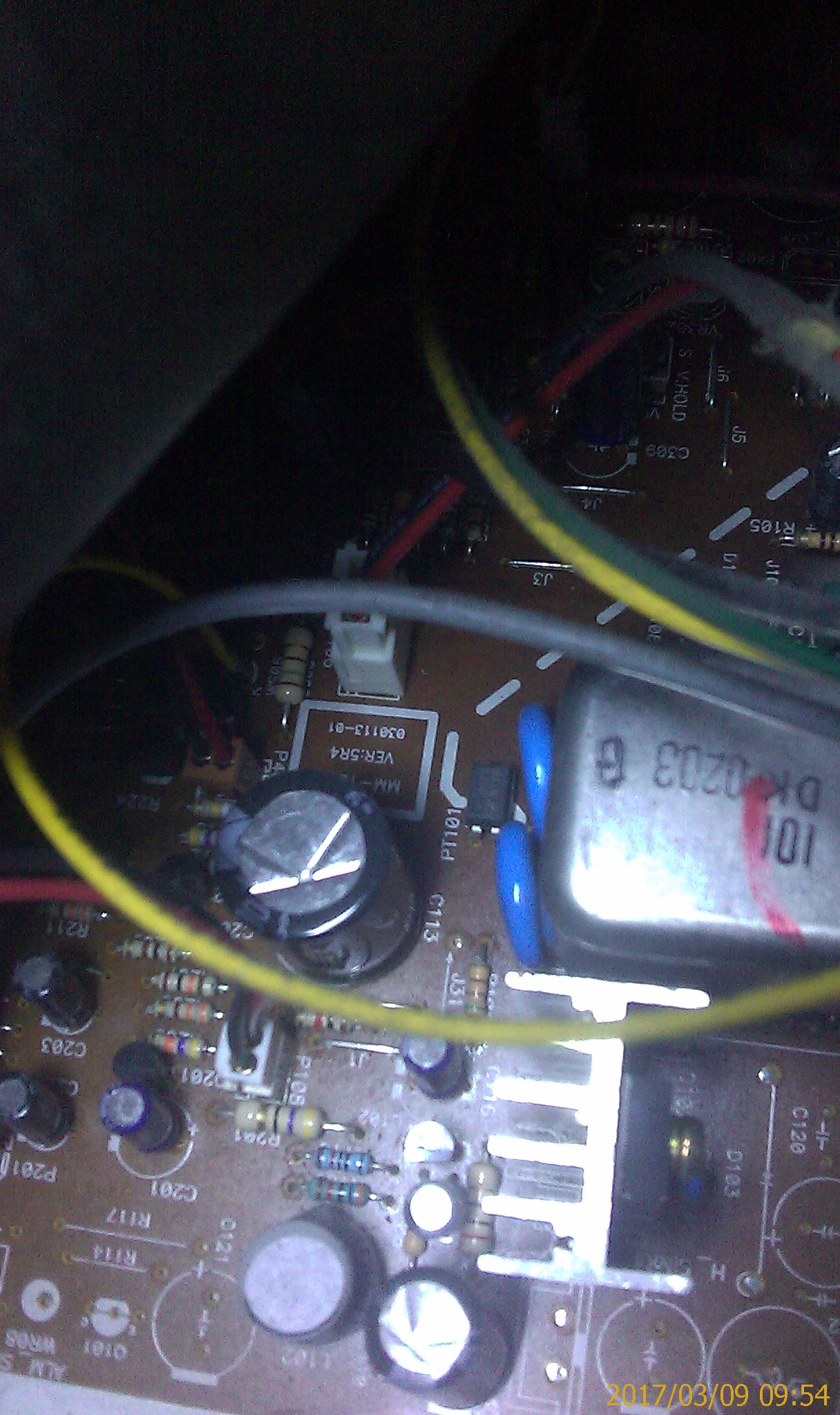

                                    and the pt101 looks like 2 legs are on the HV part of board and 2 legs are on the low voltage...there is a dashed line going through the middle underneath....
                                    am i seeing that correct?
                                      #38
                                      Re: samsung CRT security monitor wont power on model ssc-12
                                      Posting a picture would help but I believe it is. Two legs on the Cold side and 2 legs on the Hot side
                                          and my camera has no flash....have to use a secondary light which doesnt work well...shadows etc.. here is a photo of pt101
